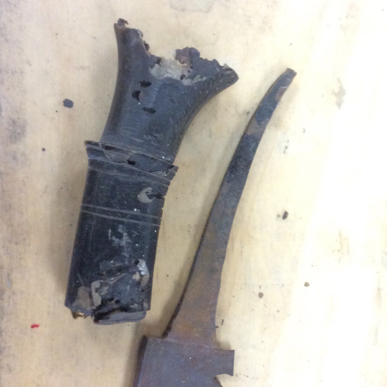

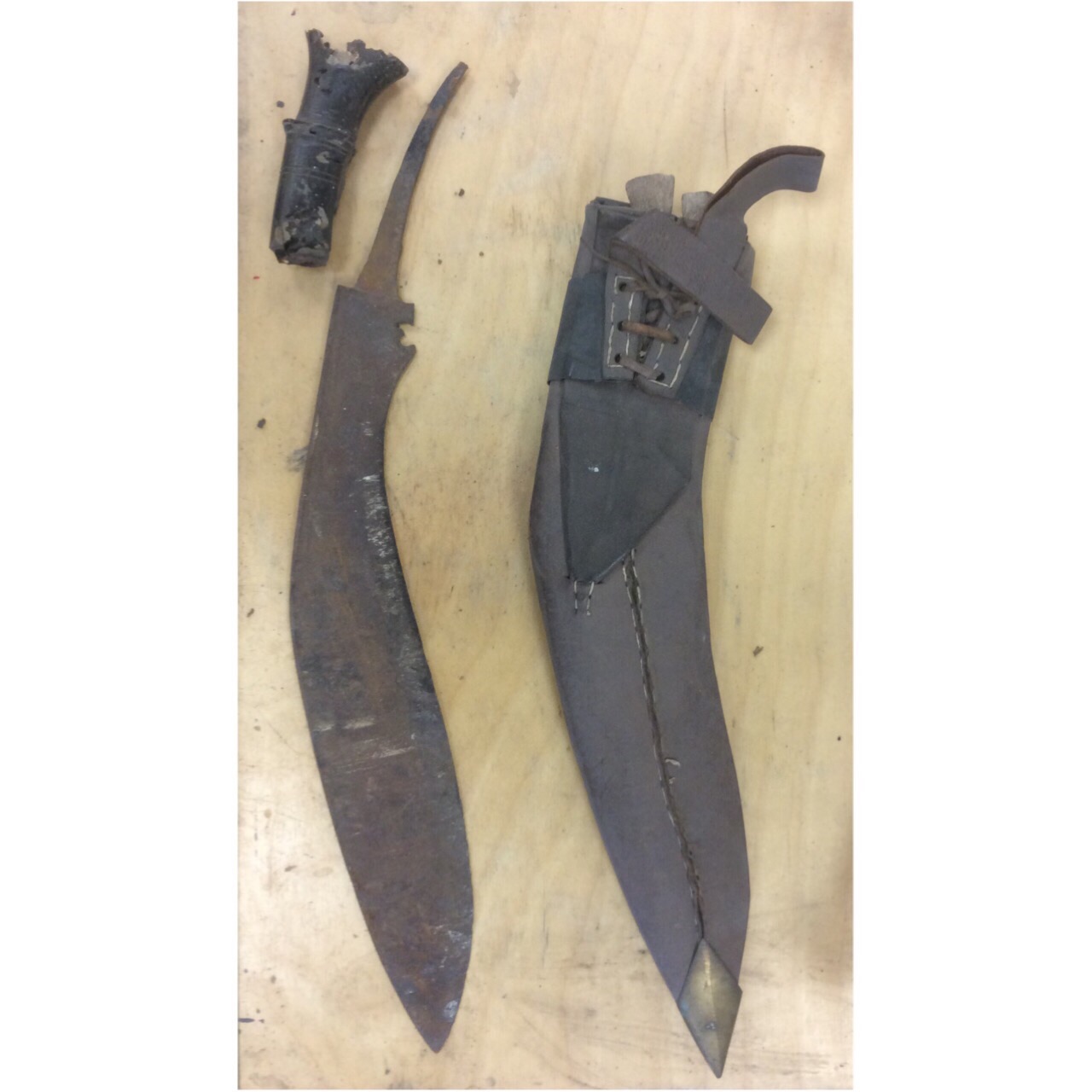

This came right out a sealed footlocker of a GI who was stationed in India during WWII.
The grip was loose and so eaten up it pulled loose when I tried to withdraw it from the sheath!
Since the friend who was his Uncle's Executor had sentimental attachment to it he asked me to see what I could do.

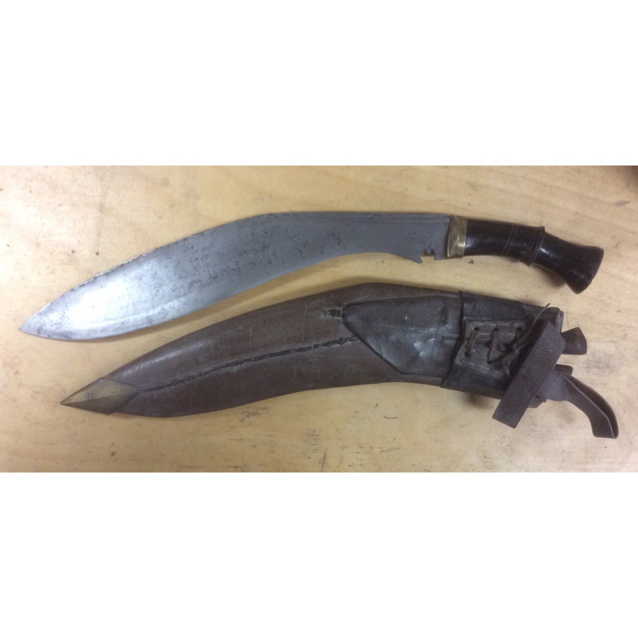

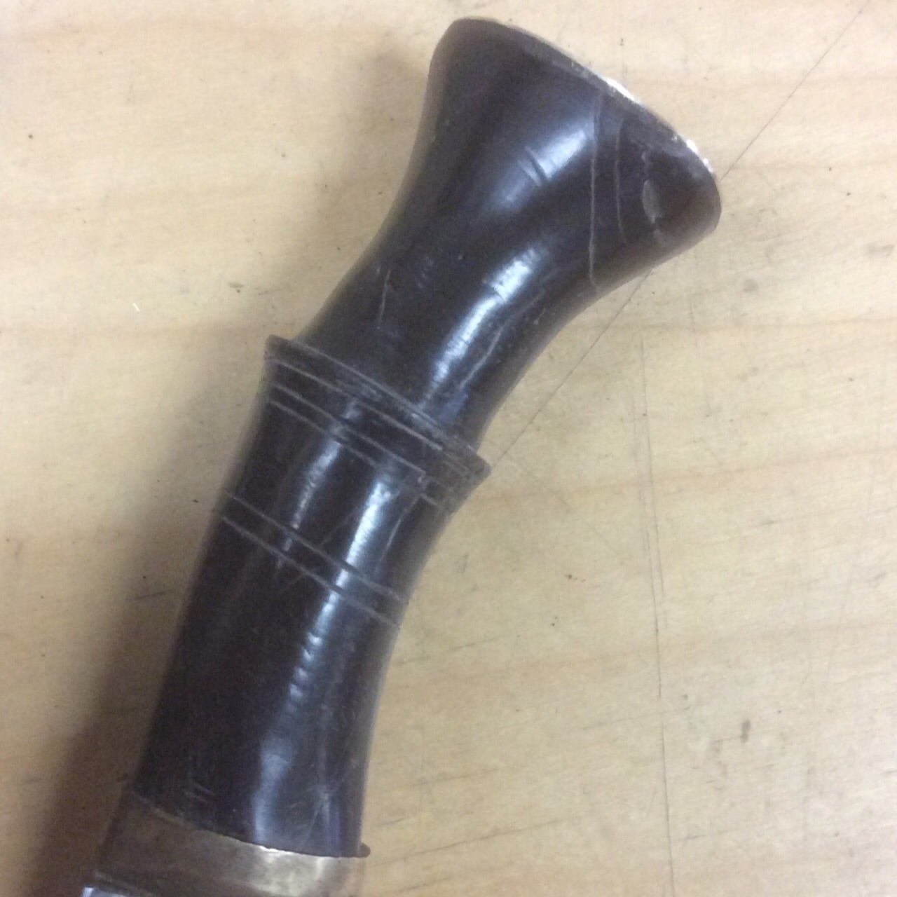

Thanks to Battera, I got a piece of water buffalo horn of suitable size and began whittling it to size and shape. I had to make a few allowances here and there because the horn was not quite wide enough, and had to salvage the tip and use it to splice in in a couple of places to remedy this best I could.
I even used the powder from rasping to fill in several voids and along an exposed internal cleavage.
The blade was cleaned the old fashioned way: a lot of elbow grease and successive grits of oilstone, and finally fine paper generously lubricated with fine oil.
Here are a couple of before and after shots.
All comments welcome.

Fantastic job! It seems like the spine of yours has some hammering marks;all of the real, good, honest working ones that I've seen have those same marks.I guess they used them for everything from fighting to pounding in tent stakes !

Can you tell me what it is like to work with buffalo horn
Is it reasonably hard to work with? Do you use rasps or chisels
Nice splicing of parts, what glue did you use

A typical private purchase kukri circa 1944 onwards, probably made in Darjeeling and sold in the markets and bazaars of India, wherever there were soldiers to sell them to.
The sheath and frog (which appears to be on backwards) seems to have held up well, considering the state of the original hilt. Was there anything in the khissa pouch?
