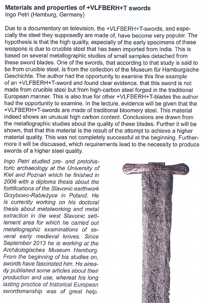

I think the geometry observations are still a hypothesis in development, but it appears that a fairly large number of swords are fitting the patterns. Remember that the swordsmiths were unlikely to have been working directly with the math, but from templates. As more collections are analyzed with this tool, I suspect confidence will grow (or wane if too many examples otherwise correct for the period do not conform).
(The +ULFBERH+T crucible steel hypothesis was under attack at the conference and we may see it falling from favor; similarly, some sword and hilt forms from central Europe may, in fact, be earlier than previously believed. A lot to digest and I greatly enjoyed the conference and exhibit!)

In due course a book with the papers presented at the Sword Form & Thought conference is expected to be published.
The presentation relied upon further radiographic studies of four of the swords examined by Dr. Williams that showed imperfections interpreted as indicative of forging from typical bloomery product. Concerns were raised on the (understandable) limitations in extent of metallographic sampling imposed on the original study by the owners of the objects and on interpretation difficulties for subsequent viewers from the images published without scale.
Here is the abstract from the conference program:
Old 12th December 2015, 12:32 PM   #10
Lee
Lee's Avatar
Posts: 996
Arrow More on the Ulfberht theme
You may also find this to be interesting.

Thanks Lee, both the abstract and the link were intriguing.
