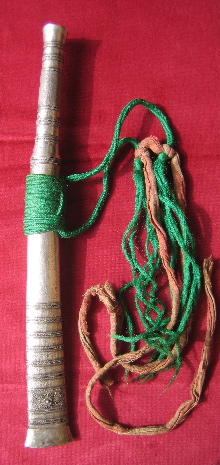

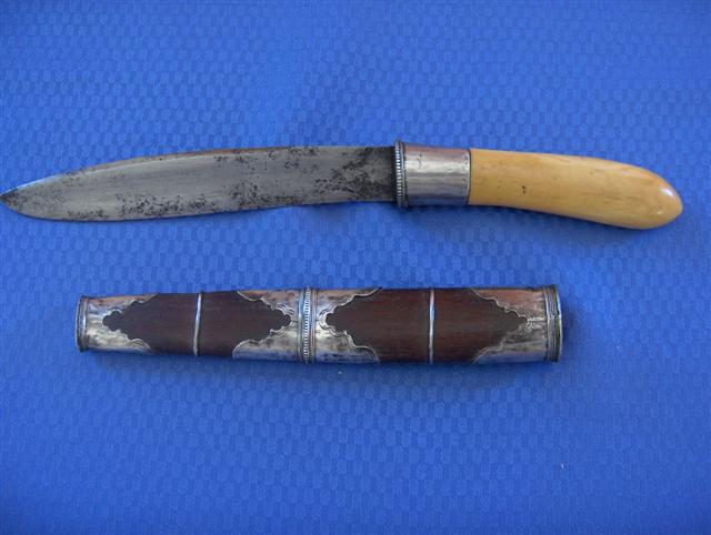

Hello forumnits,
Here are a few picture of a small dagger-size dha from Burma.
I'd love to hear any comment you may have (good or bad), age and origin estimation, etc.
Thanks!

Hi Guy:
Hard to judge age and provenance from pictures. I'm going to assume that the wooden hilt and scabbard are covered with thin silver plate, and then silver wire decorations over that. That would be pretty standard for these knives.
The primary area producing these knives is the northeast portion of Burma (Shan States), neighboring northern Thailand, Laos and Yunnan Province (China). It seems these are common decorative items, frequently worn at weddings according to a couple of people who have visited the areas mentioned. They are often attributed to the Shan and various "hill tribes" in the region.
Many of these appear to have been produced since the late 19th C., and I'm not sure they existed much before that time. They are still being produced today. The best source may be Colquhoun, Among the Shan, (1885) where he shows a dha mhyaung that has a silver-covered hilt and scabbard. That is the earliest reference I know of. There is no example of this style of knife illustrated in Egerton's book (published 1880), one nice example is shown in Buttin's collection and attributed to Laos (published 1933), and I can find no similar knife illustrated in Stone's Glossary (published 1934). Levine (2001) shows an example which he dates as late 19th C., and indicates the style extends to 18-19th C, but he includes other hilt styles (including ivory) in this period and it is unclear whether he believes that the silver-over-wood hilts and scabbards are that old. In any case, I think the older publications offer a better understanding of the age of these knives.
So, judging from general appearance, best guess for your knife would be early 20th C. or later. Hope that is helpful and I look forward to further comments from the dhafia.

I've very little to add to Ian's excellent post.
As Ian notes, the silver sheeting and decorative wirework is distinctive and is often seen accompanied by ivory handles. Paul and Elaine Lewis ("Peoples of the Golden Triangle", Thames and Hudson, Ltd., 1984) also attribute these silver knives (and, indeed, the similar silver swords) to ethnic Chinese and Shan craftsmen.
These weapons are probably valued as trade items, as they are evident in photographs of various other hilltribesmen, including the Kachin.
I've handled many of these, and the quality runs the spectrum. Some knives are spectacularly decorated with pierced and intricately carved ivory handles, and some are more pedestrian. The blades also vary greatly, with some sporting folded or laminate construction, and others demonstrating quite crude manufacturing.
Guy, in my opinion, your example is a fairly average example of the style, and I would agree with Ian's assessment of age. Cool knife.

Many thanks to Ian and Andrew,
I was indeed under the impression that this dagger wasn't really meant for heavy duty, unless in dire circumstances, but more for appearances (good ones at that, I'd say, I find it very elegant in shape and design), and you confirm that.
Thanks also for the references, which I'll try and look up.

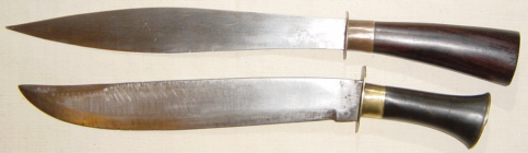

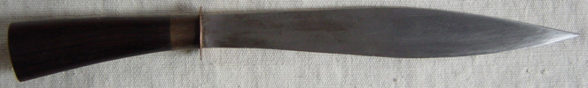

Puff, what do you make of this one. 26 cm blade, elegant and comfortable in the hand.

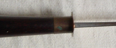

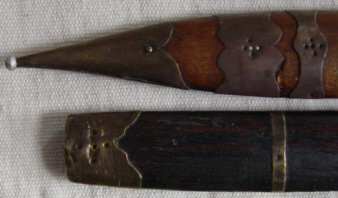

Old 22nd May 2006, 08:26 PM   #22
Posts: 6,024
These pictures of the brass work compered to that of a dha are quite interesting, hinting of a regional center of manufacture? Could this form also be found in Burma? I think this knife is from the late 1930s.

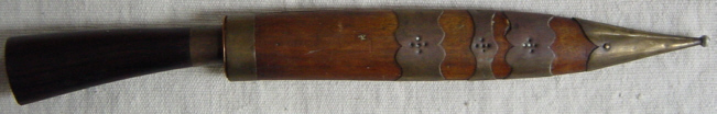

Posts: 6,024
What is going on here? could the spread of this form of knife be quite extensive? up to north western areas?
