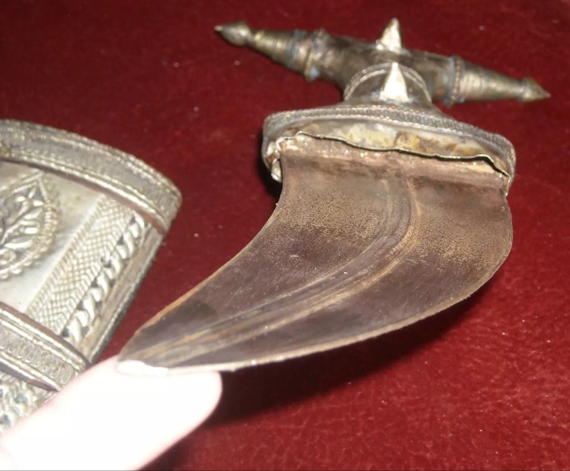

Default Jambiya blade mounted with pitch
Here is an example of what I am talking about. I find it diccifult to believe that the artist who made this knife, in all it's detail, would mount the blade like this. Personally, I think any Islamic weapon you find with a "pitch mount" is a weapon that has a replaced, or repaired, blade. I hope I am wrong about this.
Harry

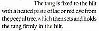

I have read that a substance called "lac" was used in securing sword hilts, the lac insect secretes a sticky, resinous material called lac which is collected and used for many types of art work etc.
A quote from Arms and Armour: Traditional Weapons of India By E. Jaiwant. Paul

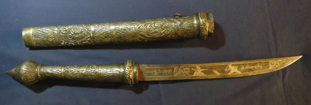

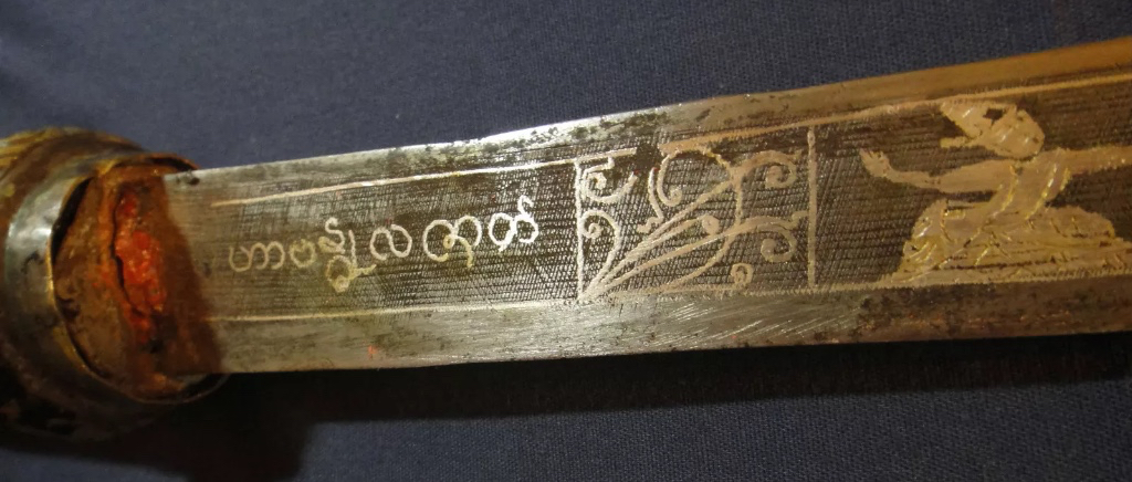

Hi kronckew,
Here is a Burmese Dha I have that may illustrate your point. Thanks for sharing this info. It helps!
Harry
