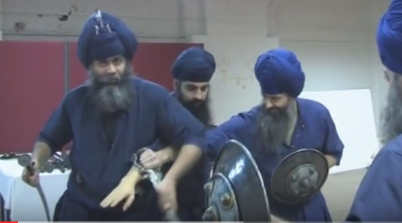

I've been following this guy's videos for a while now, he is going through a few swords and the only sword he holds with the index finger over the gaurd is a short sword in the left hand. It is in the 3rd video, but if you see the guys working with him they are holding their normally as well.
https://www.youtube.com/watch?v=pLTcVJGMBkQ

http://www.fioredeiliberi.org/phpBB3...hp?f=3&t=17821
Very confusing... It seems some argue that gatka has evolved (or devolved) into a points based fencing system fought with sticks and bears little resemblance to how Sihks fought two hundred years ago. What the fellow in the screenshots above practices is called shastar vidya and claims to be the "real" sikh martial art passed on to this guy from some last remaining master or something like that. Gatka practitioners consider shastar vidya to be illegitimate and vice versa. Gatka practitioners would argue against taking his method of tulwar usage as being historically accurate. Who knows what the truth is but it might be better to rely on the historical texts directly.
