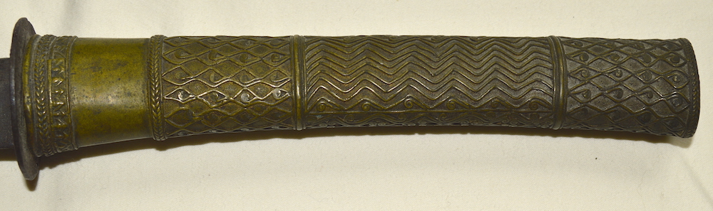

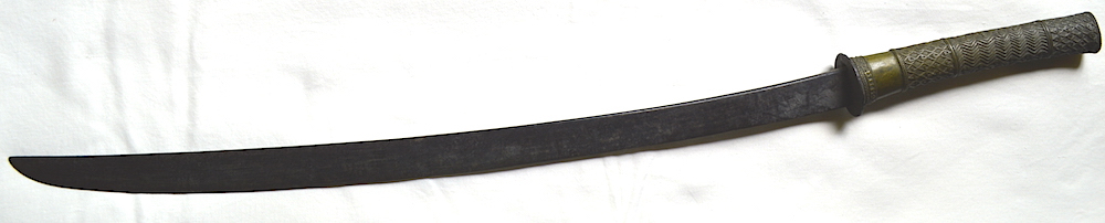

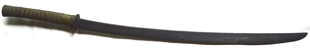

Question Brass hilted dha/daab for ID
This is a recent addition to my collection and has me a little stumped as to origin.
It has a brass hilt of elliptical cross section and a small guard. The hilt reminds me somewhat of the Japanese-influenced Thai daab from the Rattanikosin period in the mid-19th C. There are a number of high end daab in the National Museum in Bangkok that show this style of hilt in gold (some examples are shown in this link http://www.vikingsword.com/ubb/Forum1/HTML/002442.html). However, I'm not entirely happy with that designation.
The sword definitely has some age and might well be 150 years old. I'm not inclined to damage the patina on the blade or hilt at this time just to see what's underneath.
Thoughts about where this one may be from would be welcomed. I have my suspicions, and have talked with fellow forumite Nathan off line and he has some thoughts too. But I would like to hear from other dhafia as to where they think this one may be from.
Ian.

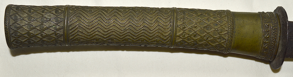

I have received a very confident identification of this sword in an email from an international sword dealer. The individual has asked not to be identified or quoted directly on this forum, so I will respect his wishes and summarize briefly what he has to say.
The sword is from the Lao kingdom of Lan Xang Hom Khao (Kingdom of a Thousand Elephants Under the White Parasol) which lasted from 1354–1707 C.E. This was the founding dynasty of what is today Laos.
The sword dates from at least the early 18th C. and is probably more than 300 years old.
The hilt is made of samrit bronze (or auspicious alloy) which is an alloy that includes copper and tin, plus small amounts of silver, gold and mercury, and the "secret ingredient" of burnt ashes of the bua bok creeper that was used to amalgamate the mixture. This samrit alloy does not turn dark green-brown with age (as you can see from the pictures here)--if cleaned now it would resemble gold (which was the whole idea in producing this alloy).
The style of hilt on the sword above and its samrit bronze construction predate the more familiar silver and bronze repoussed hilts of other Lan Chang daab (and swords in the Lan Chang style are still being made today). Consequently, this sword dates very closely to the time period of the dynasty and might be 17th C. or earlier--it is a very old sword according to this dealer who seems to know what he is talking about.
One final point. The hilt at some time has been remounted upside down. It should continue in a single graceful curve in harmony with the curve of the blade. The remounting seems to have occurred many years ago because there is no evidence of the hilt having been disturbed recently.
Take these comments for what you will. I don't like passing on information that cannot be verified readily and based on one person's opinion. On the other hand, I have no reason to question the accuracy of these comments.
If what he says is true, I really lucked out and found a sleeping beauty at an incredibly good price. What we all hope to find for our collections, right!
Ian.

Lovely sword Ian. Congratulations. Thanks for sharing. I would go for more southern Laos...Vietnamese borders...you can see the sino vietnamese influence on the blade shape. Unique handle design, oval cross section like a Chinese/ japanese sword...the samarit handle and wire overlay we have seen before but not in this pattern which imitates more of the flat braided handle wraps of japanese and chinese swords...very neat to see something in a variation not seen before! Awesome! Thanks for sharing!
Old 18th July 2015, 04:47 AM   #8
Posts: 4,469
Thank you Nathan.
I think we can also see the Chinese influence in the small disk guard, many of which were apparently removed by Lao and Thai owners who found them cumbersome (according to my international source).
Southern Laos would fit with the information that I have received.
Ian.

Far be it from me to argue with the opinions of Gurus, but just as a comment:
Down-turned handles are seen on nomadic sabers dating back to the 6-12 centuries and belonging to Enisei Kyrgyz ( see book by Khudyakov). Such a configuration amplified the cutting abilities of the saber and at the same time allowed at least some degree of stabbing.
This was preserved over centuries and found its way into Georgian palashes, the famous saber of Charles the Great, some Chinese sabers, Nathan Starr's sabers of 1812-1813 and even the very last model of the British cavalry sword of the 1908 pattern.
Perhaps, the handle was never remounted? Just a possibility.
Old 18th July 2015, 05:08 AM   #10
Posts: 4,469
Point taken ariel. Perhaps it was made this way, although it would be very unusual.
Ian.
Originally Posted by ariel
Far be it for me to argue with the opinions of Gurus, but just as a comment:
