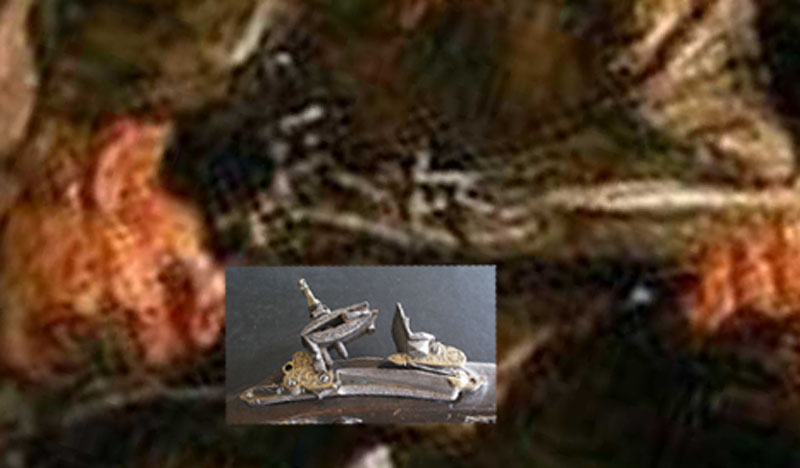

Fernando, as you may suspect, I am not a whiz at posting photos, so this one may be overkill.

Quizás quisiste decir: Hola, Miguelete Es imposible aventurar alguna opinion, pero te diria que no se trata de la agujet porque no se ve el gancho de seguridad, detras del cock, y se adivina un resorte doblado del frizeen. Para mi, el artista quiso pintar un miquelete clasico. Por comparacion hay algunos autores españoles, que han reflejado exactamente la agujet y el miguelete. En este foro, hay un post iniciado por Matchlock, con la agujet en una pintura, hay una pintura de Francisco de Goya, Carlos III cazador, con una escopeta de miquelete Afectuosamente. Fernando K P: He escrito agujet sin la A final por problemas con el traductor
Hello, Migueleter
It is impossible to venture any opinion, but I would say that is not the agujet because there is safety hook, behind the cock, and a bent spring frizeen guess. For me, the artist wanted to paint a classic miquelete.
By comparison there are some Spanish authors who have reflected exactly the agujet and miguelete. In this forum, there is a post initiated by Matchlock, with agujet in a painting is a painting of Francisco de Goya, Carlos III hunter with a shotgun miquelete
Affectionately. Fernando K
P: D: I have written without the final A agujet problems with the translator

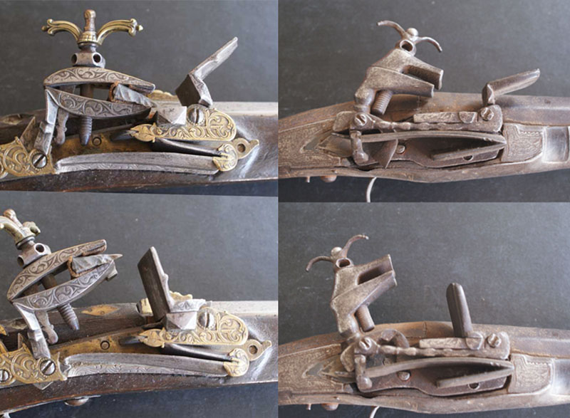

A comparison with one of our Algerian toe locks shown cocked and viewed at a similar oblique angle . Surely it has to be a toe lock which is one of the simplest and probably earliest form of snapping type locks . Competitive with the Miguelet in Spain , contemporary with the wheelock in Italy, widely distributed though Russia and primitive versions are still being used in Tibet.

In any case the plate is extended in front of Frizen, which does not happen in the agujet. In addition, there are some migueletes that cock pole is tilted, not straight or depends on the position (half-cock, full-cock)
However, the image can not hazard a review

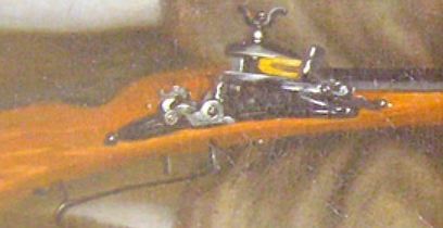

p.s. -i'd posted (as attachment) a large screen capture of the hunter so we'd have it available in case Miqueleter's link broke. i have since found a much larger image of the whole painting to cut the hunter from & attached it above instead.
p.s. - don't think that helped much, still too little detail of the lock.

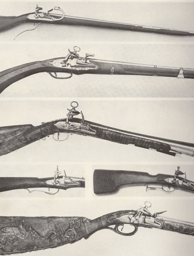

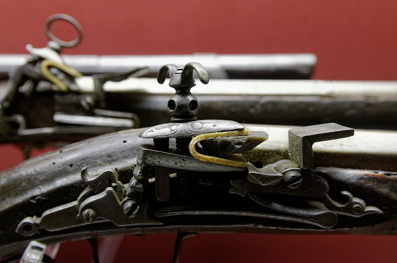

Sorry to labour the point . If we are going to assume the diagonal line across the lock plate is an external mainspring then in both miquelet and toe locks the mainspring starts being roughly horizontal , that is parallel with the barrel . Or in some migulet's slightly up hill . In the Minqulet since the spring acts on the rear of the cock at full cock it points either downhill or roughly horizontal . in a toe lock at full cock the mainspring points uphill which I think is what is shown in the painting . Yes, the miquelet shown is Albanian but the principles the same . Anyway , to help people make up their own mind here are a couple of aqujetas ; sorry I have lost the source of the painting but I think its Spanish and the other possible candidates which are italian locks .
For clarification the aqujeta was the Spanish version of the Italian toe lock or romanlock and may have been introduced from Italy. The defining characteristic of the aqujeta is the dog catch behind the cock used to resolve the half cock problem. The cock is pulled back beyond the full cock position and the dog catch pushed forward to engage with the cock . Pulling the cock backwards slightly automatically disengages the catch and the cock drops onto the horizontally moving full cock sear which engages with the rear foot of the cock .
