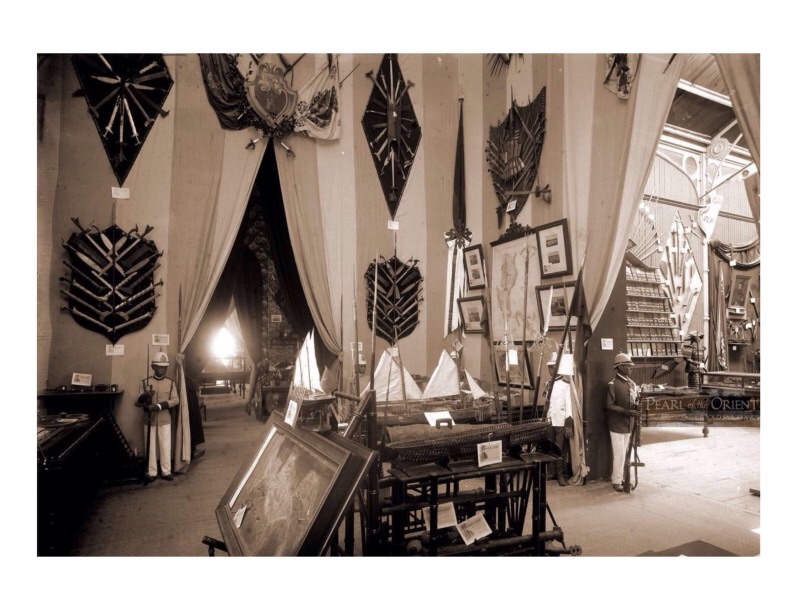

Carlos, Is this the wall plaque of weapons that you are referring to?
The keris is at 3:00 o'clock.

When it is this wall plaque Carlos referring to and my eyes are good enough I would think that this is a Bugis keris. The Bugis are a seafaring nation and since the Philippines not far away from Sulawesi I am not surprised to see this keris at this old wall plaque.

Yes !!
This is the plaque.

This is not a really great photo to tell from, but it looks like those might be Indo-keris at 11 o'clock and 1 o'clock on either side of the kampilan at noon as well.
Without any context i couldn't really say what made the person who created this wall display include both Indonesian and Moro weapons. While i would not be the least bit surprised to learn that someone during the Moro insurrection or before in the Philippines has and perhaps even used an Indonesian keris in battle i would say that it is unlikely that the practice was all that pervasive.

I snagged this amazing photo from Filhistory, migueldiaz's Facebook page.
Enjoy.

Yes, this is the picture !!

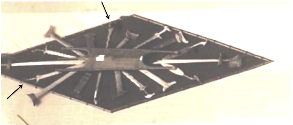

Thank you for finding and posting this extraordinary image. I have taken the liberty of altering the contrast and size of the cropped image that you posted to show the wall plaque with possible Indonesian keris.
I rotated the image so that it would not need to be scrolled and showed the two kris/keris that David identified as possibly Indonesian with arrows.
To my eye, the ones that David identified at 11 and 1 o'clock in your original post look like Moro kris (I think there is a single baca baca on the one with the arrow). The other sword, shown at 3 o'clock on Kino's original post and with an arrow at the top of my rotated picture, is harder to discern and could be Indonesian or perhaps Bugis--the hilt is indistinct. However, based on this picture, I cannot rule out an older form of Moro kris for this one.
Inspection of enlargements of the other plaques did not show swords that resembled Indonesian keris to me.
