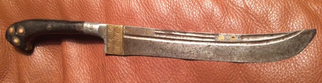

Hello all,
Here is a knife I recently acquired, advertised as "Ottoman". I would put it into the bichoq family, but the shape of the upswept tip and a slightly concave back gives me pause.
Any thoughts?
Best Regards,
Dave A

Hi Dave
Again a strange stuff, the forte looks like these Saharian daggers.
The blade looks like an Ottoman bishaq. And the hilt is a mix of North African and Balkans. It's the reason why I will say Algerian or Tunisan bishaq. You didn't mention the size...
Old 3rd June 2015, 09:37 AM   #3
and same decoration on the tabuka...

Thank you Kabur! I love a mystery.
Regarding size, this knife is 10 ¼ inch overall, the blade 6 ½ inches. The width is precisely 1 inch at the forte and ¼ inch thick, tapering distally to the tip.
I will post some better photos soon after I clean it up a bit.
Best Regards,
Dave A.

I cleaned it up a bit. Here are some close up photos showing more detail.
Old 4th June 2015, 09:19 AM   #6
it's a nice piece!
My feeling is that the blade was made in the Balkans or in the Golden Horn then the handle and forte were added in Tunisia.
It happened frequently with swords and pistols.
But maybe I'm completely wrong and it's a pure North African knife.
I hope you will have more comments from the forumnites.

I would agree that the bolster plate with the four petal motif (a common Berber element found deep into the Sahel) is probably later than the blade. Certainly looks like the decorative elements belong in the North African sphere.
A lovely piece, I really like the blade style.

It is Uzbeki Pichok ( P'chak). There were multiple varieties of these knives, from different localities and with different local sub-names indicatiing different purposes. The ones with the upturned point ( forgot its local moniker:-)) were allegedly unsuitable for stabbing and were therefore used ( or classified) as utility knives.
It is rare to find an old one like that. The market is awash in modern productions, partly from Uzbekistan, partly from Ujghur area of China. But this one is a keeper.
Good eye and good buy!

I know the Soviets confiscated many of these knives in usbekistan in an effort to stamp out local culture, and as a result the old ones are quite scarce. I have two other pichoq, one from Tashkent and one from Chust, good steel, but both more modern in style and unique in their own way. So my eye was tuned! Nevertheless, I have not seen this shape before and so I am glad for the feedback.
I'm fascinated by how this style is found in very similar form and name from N. Africa to the Balkans (bıçak) to Uzbekistan (pichoq) to India ( pichangatti).

As for me, it's not Uzbek and definetly not African. I see here typical Uyghur knife from Yangissar city
Devadatta is offline   Reply With Quote

I'm very interested in why you are sure about this attribution. I know nothing of the Uyghur and will greatly appreciate any insight you can provide regarding the Uyghur and knives such as this one. Thank you.

I have both contemporarily made Uygur and Özbek knives (bıçak) in my collection. Those knives are basically exactly the same, just like the Özbek and Uygur tribes of Karluk subbbranch of Turkic people those "bıçak"s come from. Basically a tomayto-tomahto situation IMHO

google 'uighur knives' (or 'uyghur knives') & select 'images', brings up a multitude of the knives they are famous for making right up to the present. many of them look like yours to greater or lesser extents. nice knife.
