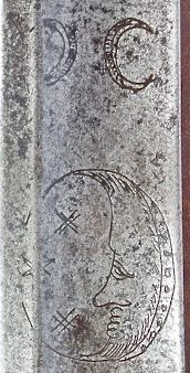

In a concurrent thread on basket hilt swords, the subject of markings of paired crescent moons placed at the terminus of shorter right and left fullers in a central three fuller configuration came up on an Anglo-English basket hilt c.1740s.
The character of these paired 'man in the moon' faced markings are not commonly known on European blades, however they are extremely common in North African blades used in takouba and kaskara. According to Lloyd Cabot Briggs in his article on these blades (JAAS, 1965) his exhaustive research on European, typically Solingen, blades imported into these North African spheres, these 'paired moons' were inherently native applied. While considerable numbers of these blades were indeed European, it appears that native armourers used them on the blades they made as well as possibly applying them to imported or acquired foreign blades .
It has been well known, as described by Oakeshott ('Records of the Medieval Sword') and other instances, that broadsword blades, often of Solingen or Sudanese make, have been mounted in some cases in authentic medieval European hilts and in other cases in other hilts of varying form and age.
The objective of this thread is not to discredit examples of swords with these types of markings but to establish and authenticate the earliest use of the paired moons in Europe on blades so as to determine the origins of their use in North Africa.

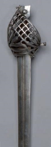

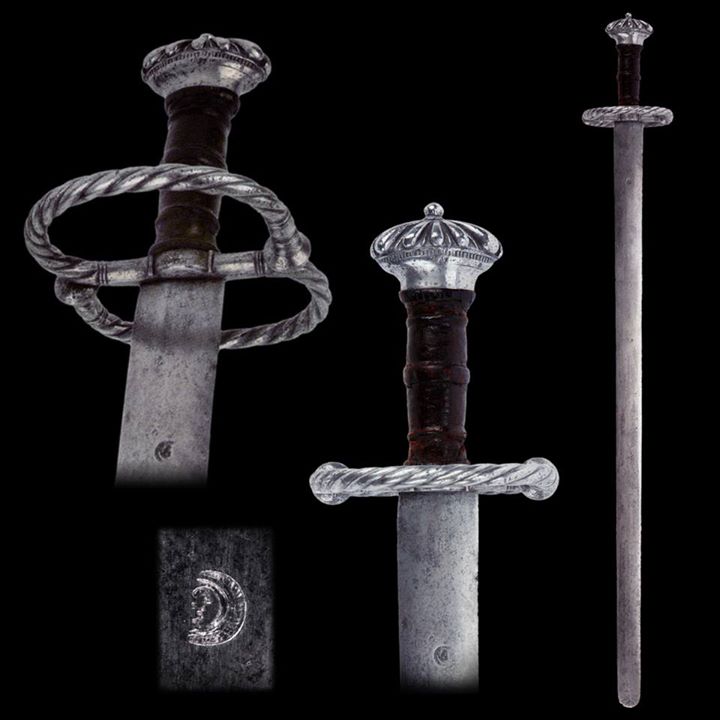

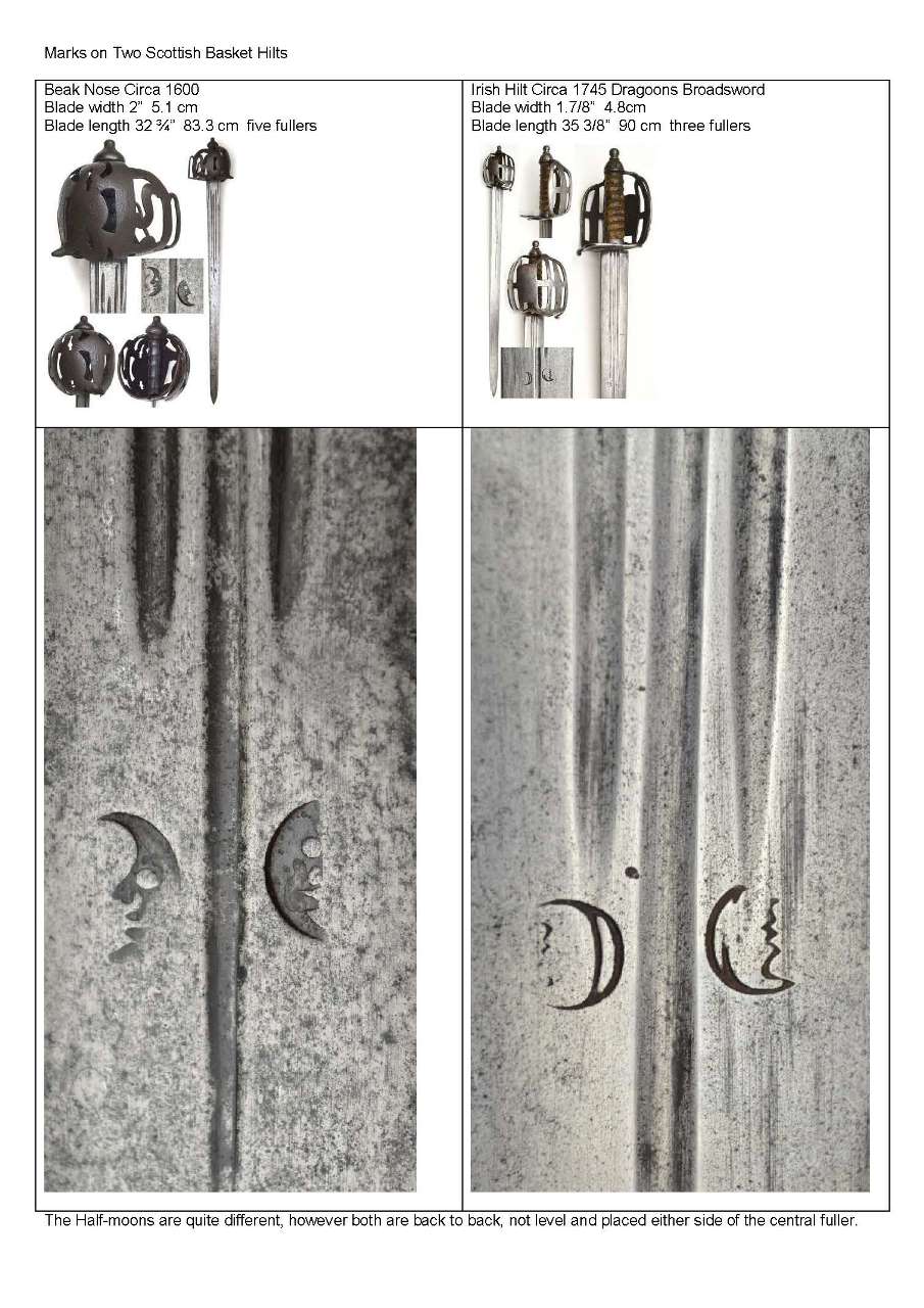

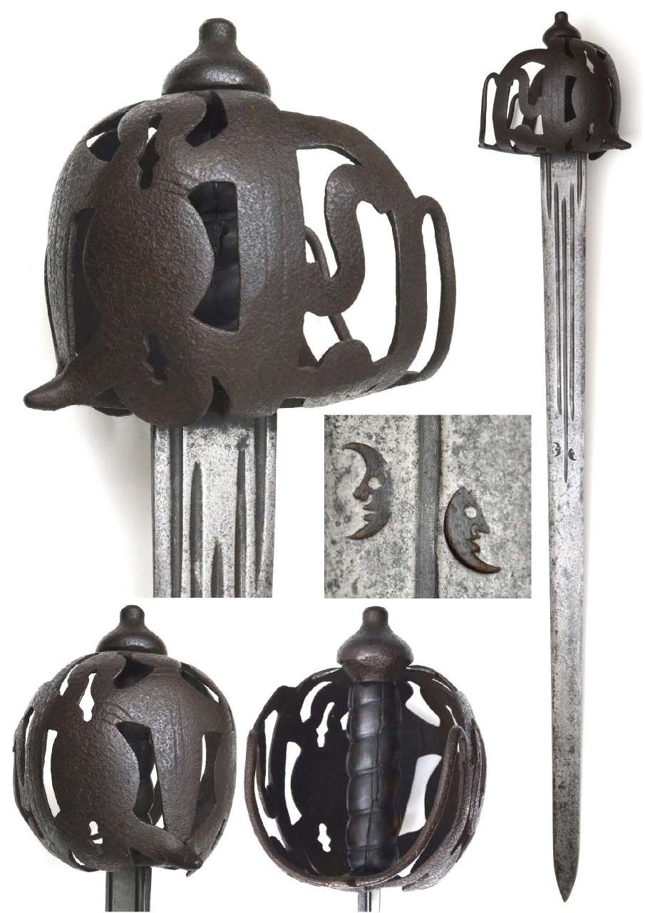

In the images I borrowed from the other thread, on the left is a basket hilt with triple fullers and paired moons c.1600 posted by Cathey. In my opinion this is one of the strongest cases for European use of these moons. It will be noted that at the blade root flanking the central triple fullers are two flutes. The moons are more in the character of European astral images used in motif, and blade is entirely of early Solingen types destined for Scotland.
On the right is a basket hilt c.1745, also shown by Cathey, an outstanding Anglo-Irish hilt. The blade however has paired moons more of the character seen on North African kaskara blade examples. While there is of course the possibility this is a German blade, the markings are atypical for Solingen forms known, and both degenerated, almost stylized geometric in form.

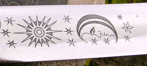

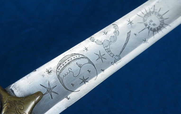

The blade example below posted by Iain illustrates the nature of the variations of these moons and fullers on kaskara blades. Many of these are produced in North African locations and blades with the moons are termed 'masri' (Rodd, 1928) with the moons termed 'dukari' and placed for magical and talismanic purpose.
I am hoping that possibly we might look into the use of crescent moons on European blades, and especially instances of their occurrence in pairs facing away from each other as seen here.
We know that the man in the moon type devices occur, usually with other cosmological themes , but looking for the paired examples.

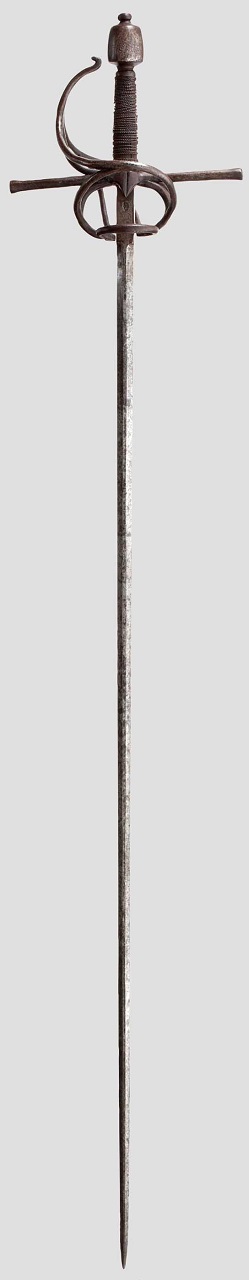

Hi Jim,

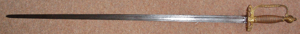

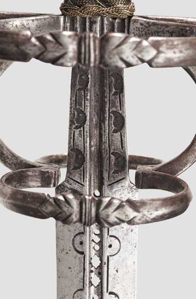

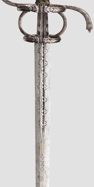

in auction 69 in Hermann Historica there was a late 16th century German riding sword with six moon stamps on the ricasso, though not facing away from each other, this provides a good idea of the shape and dimensions of old European type of stamps.
Kind regards
Ulfberth

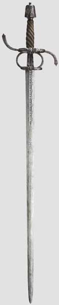

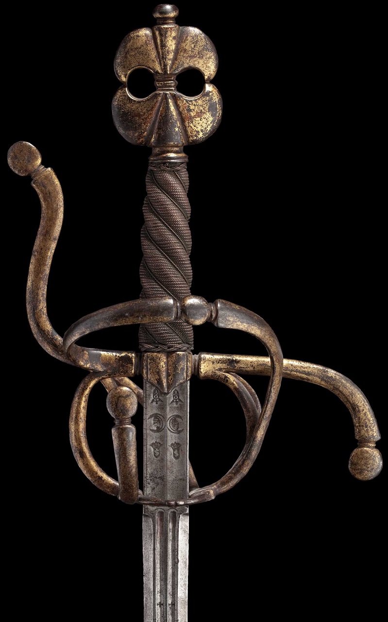

and this one with the moons faced away from each other, discribed as:
A German gold-plated rapier circa 1580
Double-edged thrusting blade of flattened hexagonal section. Both sides signed "CLEMENS STAM" within the double fullers and struck with six marks on the ricasso.

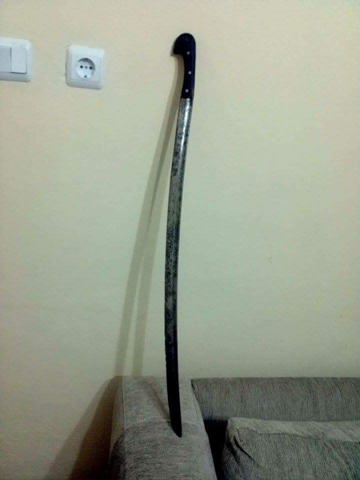

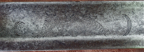

single moon engraving:
Austro-Hungarian Hussar Sabre of General Andreas Hadik c.1760

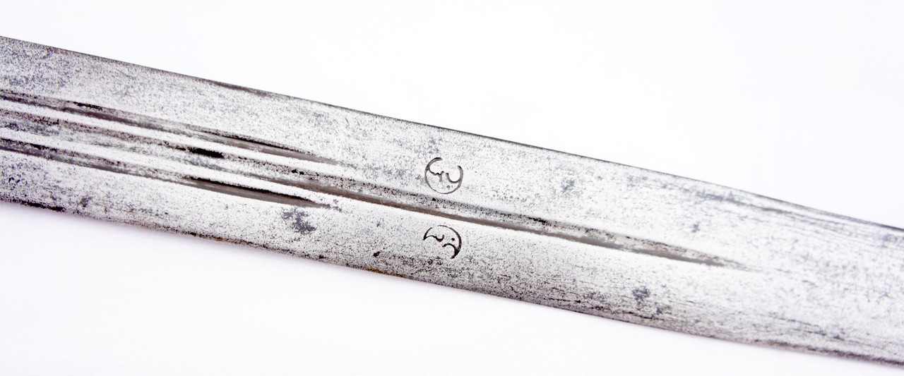

I'm also including a Katzbalger with a stamped variation of the crescent. But it's a singular.
Regarding the application of the marks themselves, my understanding is that these would be stamped hot. Meaning that in a non-European context this would be not easy to achieve without destroying the temper of the blade. Briggs is a great source, but he could well have simply got it wrong.
To be clear, the example of mine you posted is 100% produced in Europe, it is an older example and from the 18th century I am 99% sure.

Kronckew, excellent example of the cosmological motif which became popular on blades in the 17th through 18th centuries in Europe. These images became the prototypes for various native interpretations because of the prolific import of trade blades bearing these.

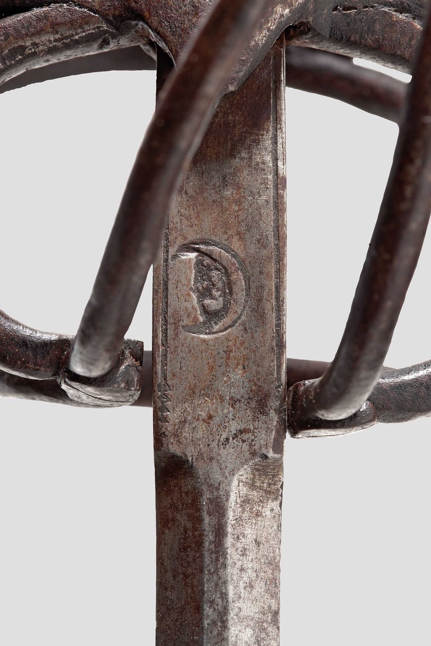

Here is another one German from the beginning of the 17th century.
It seems that famous blade makers also used the moon mark as a quality stamp, amongst other stamps.
Described as: A military rapier, Munich, circa 1610/20
A thrusting blade of flattened hexagonal section struck on both sides with Wolfgang Standler's crescent moon mark on the ricasso

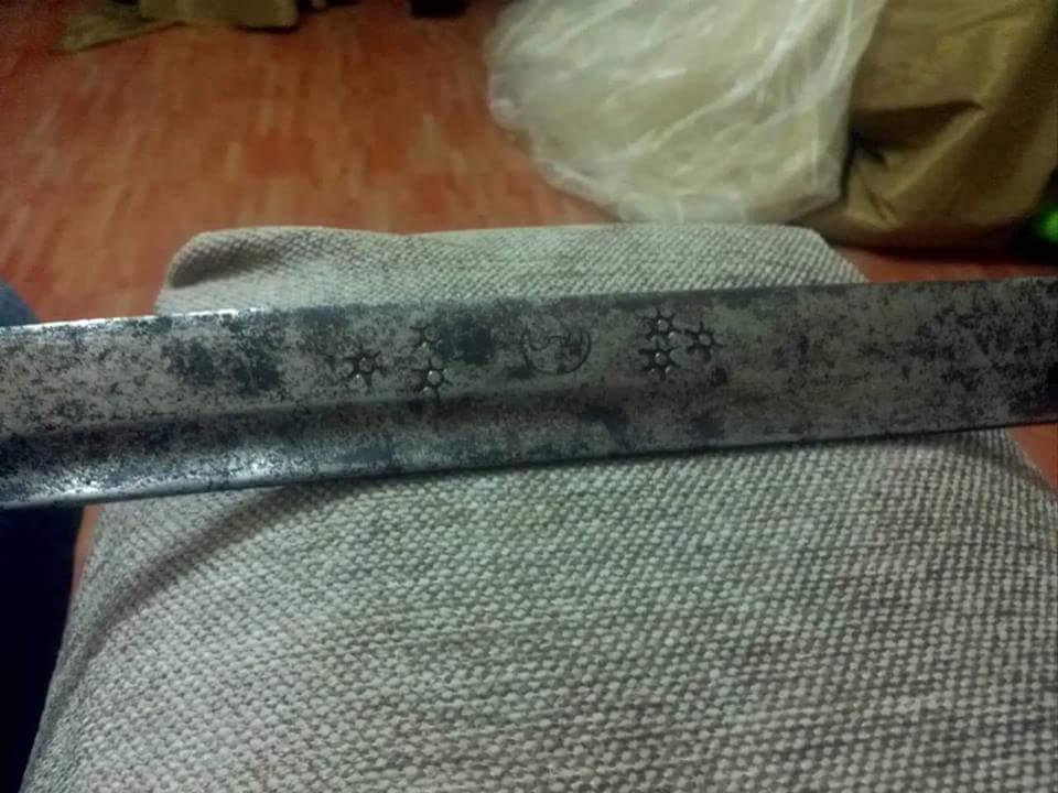

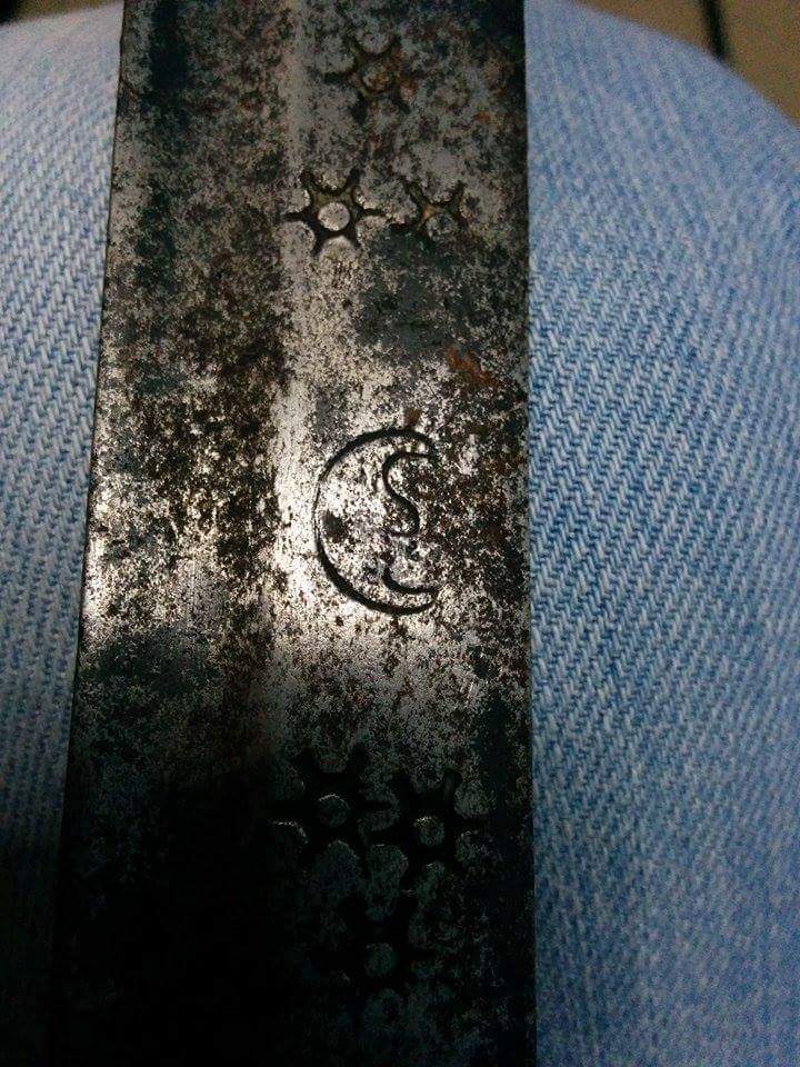

new poster just posted links to another austro hungarian blade with similar markings to the one i posted, HERE see the link for the 1765 infantry hanger.

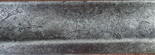

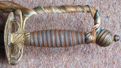

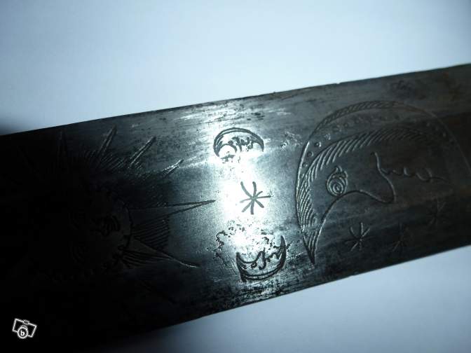

Paired crescent moons and a big'un on a small sword hilted spadroon of mine with Solingen blade 2nd half 18thC.
Norman.

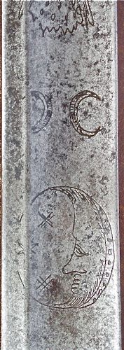

Hi,
More scattered crescents on other parts of blade.
Norman.

I thought possibly this image with the paired crescents may be applicable.
My Regards,
Norman.

Old 21st April 2015, 08:10 PM   #28
peserey
Join Date: Apr 2015
Posts: 4
There are a Shasha of my family. I think the solingen it is. far as I know in my family 200 years. What do you think about this?
peserey is offline   Reply With Quote
Old 22nd April 2015, 07:58 PM   #29
Welcome to the forum, peserey .
Very nice old shashka with suggestive marks.
It will be interesting to know what the members say about them.
Old 22nd April 2015, 09:21 PM   #30
peserey
Join Date: Apr 2015
Posts: 4
Thank you . yes I am also very curious.
