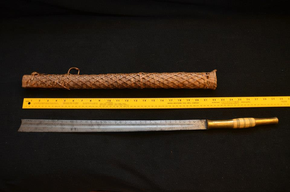

1. full picture of blade and scabbard, again I do not think scabbard is meant for this blade, it fit very poorly and essentially cut all the rattan because its "horns" on the tip of the blade stuck out of the scabbard from top to bottom

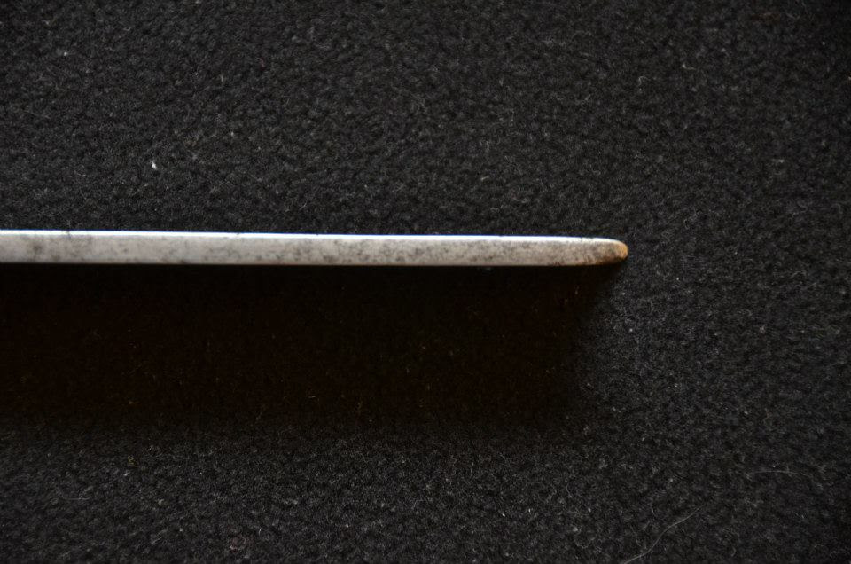

2. this sword has zero distal taper, one of the reasons I love it

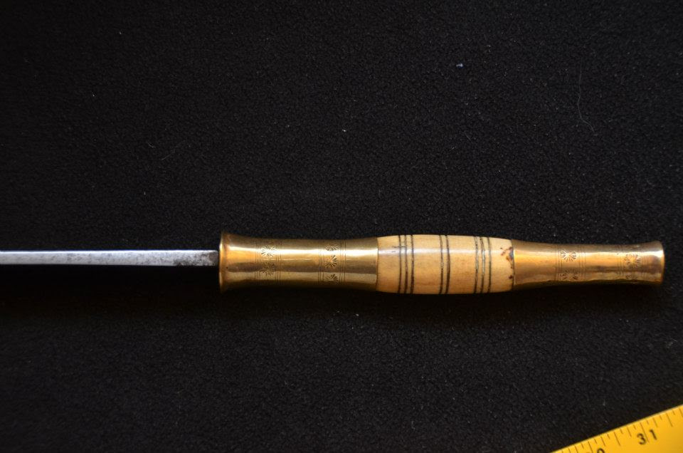

3. eyeballs say there is zero difference between tip and grip on thickness, does this tell us anything?

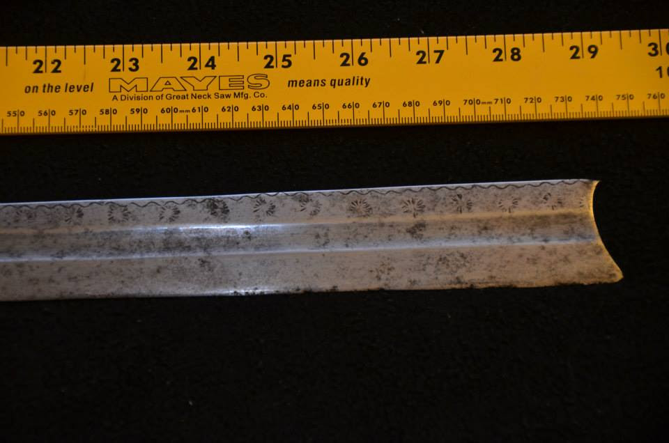

4.handling in the past without cleaning perhaps by a previous owner a generation ago, or even the owner himself-- clear fingerprints in the corrosion of the blade here, I still love the sword, would love any more thoughts you guys would like to offer.

The blade looks to be in good condition to me and reasonably clean.
The lack of distal taper is intriguing, how's the balance and feel in the hand?

if I had to carry a sword it would be this one, it feels massive like a tool but has finesse, its short enough that it does not get in the way , the balance is better than you would think, it fairly spoiled me when I look at distal taper as I am always looking for a solid forged line with a minimal taper or almost none.

As an aside, in the Nova documentary episode "Rat Attack" (about how bamboo flowering leads to a rat plague that devours nearby crops and produces famine) (link to video on YouTube), you can see how flat-ended dhas are used in planting fields in the Indian state of Mizoram by the Myanmar border. The pictures are scattered throughout the early video, but you can see it fairly clearly at the 19:40 mark.
They use the square ends of their dhas as digging sticks, and I'm willing to bet they don't have a distal taper on their blades either. The lack of a distal taper may be functional.
