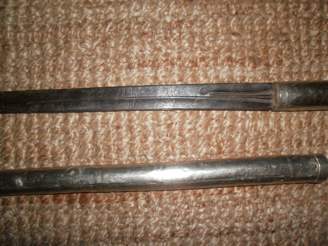

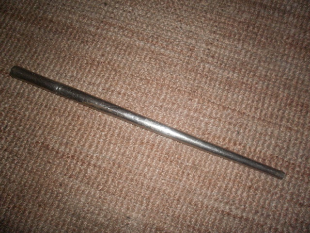

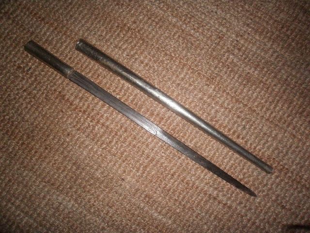

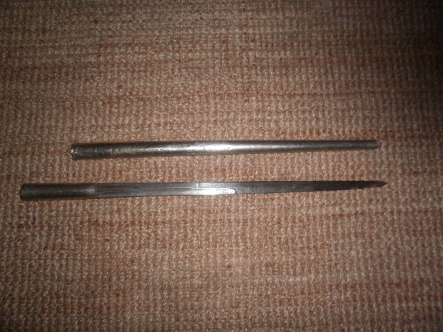

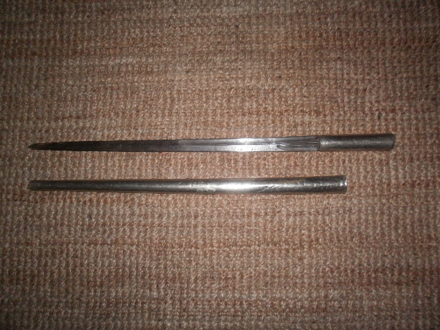

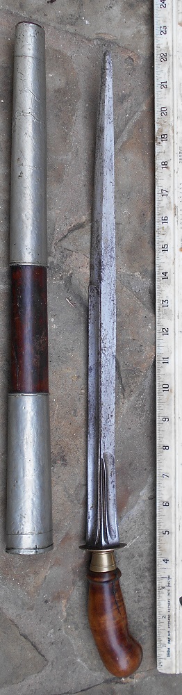

Hello all,
I get offered this weird sword which is clearly Indonesian, my guess would be Bali or Lombok, 2 ft 5 ins long, with nice pamor blade. The blade shape remember me to some Lombok cundrik I've seen and handled but the handle and scabbard with either silver or german silver sheet covered is very unusual. I have the permission to post the pictures here. For the blade shape of Lombok cundrik have a look here: http://www.vikingsword.com/vb/showth...hlight=cundrik
Have someone seen something similar before and will be able to name this sword and know the origin?
Thank you in advance,

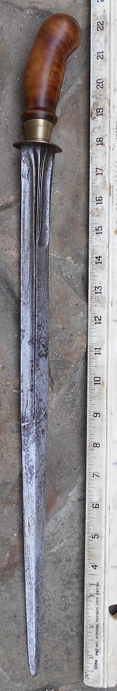

Same blade form just a little shorter.

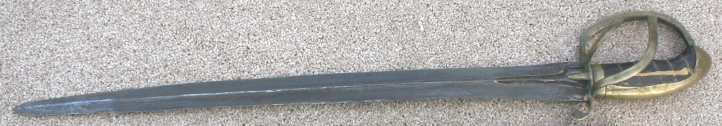

Have a look at my post of the 22nd Oct 2008 - the scabbard is similar.
The "sabre" in this photo has a similar blade. Always assumed it to be from Java or Sumatra.
Thank you Tim,
yes, very similar blade shape! This would confirm my guess that it is a cundrik in unusual mounts.
Roy

Old 26th October 2014, 05:43 PM   #6
IT LOOKS LIKE A SWAGGER STICK WITH A BLADE INSIDE. SWAGGER STICKS WERE POPULAR AND OFTEN SEEN CARRIED BY OFFICERS AND SUCH AT LEAST THEY WERE IN THE MOVIES. PERHAPS ITS A INDONESIAN VERSION OF SWAGGER STICK, BATON, WHICH DENOTES RANK AND CAN SERVE AS A WEAPON IF NEEDED.
Hello Barry,
thank you for this very good suggestion! This make sense, again very good suggestion!

Just a guess. On the van Zonneveld book page 61 (fig.185) there is a similar one quoted as KASO.
Paolo

Hello Paolo,
have thought about this as well but the blade shape and also the handle is quite different. And a kaso is also longer, look what is written there about the use of a kaso.
I think that the suggestion from Barry that it could be a swagger-stick is a very good one.

It is probable that this weapon is of Lombok origin where it would be known as a tempius or a sendirung.
The designation of "cundrik" --- or perhaps more correctly "cunderik" --- seems to be a very confused one that can range all the way from klewang type weapons to small daggers that women hide in their clothing. However, the item that Tim has shown in post #2 is definitely identified as a cunderik by Djelenga.
But Tim's item is significantly different to the item Detlef has posted.
If we are prepared to accept Djelenga as arbiter, this is probably more correctly either a sendirung or a tempius --- at least on Lombok.
As an aside, I've never really been able to understand how the designation of "cunderik" can be applied to anything other than a small weapon. As a dhapur the word refers to a small type of keris, but an even greater argument against the application of "cunderik" to something large is the fact that Indonesian and Malay languages tend to be very onomatopoeic, in other words the sound of a word is very often , perhaps usually, indicative of the nature of the thing it describes, thus little things sound little, big things sound big, and in at least a Javanese sense, the word "cunderik" sounds little.
Long ago I asked a member of the family of the Mangkunegara exactly what a cunderik was, I met him in the museum attached to the Mangkunegaraan, and he took me across the room and showed me a display case full of extremely elegant women's(?) daggers, quite small, and very expensively mounted. To him, these were cunderik.
