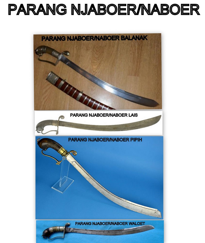

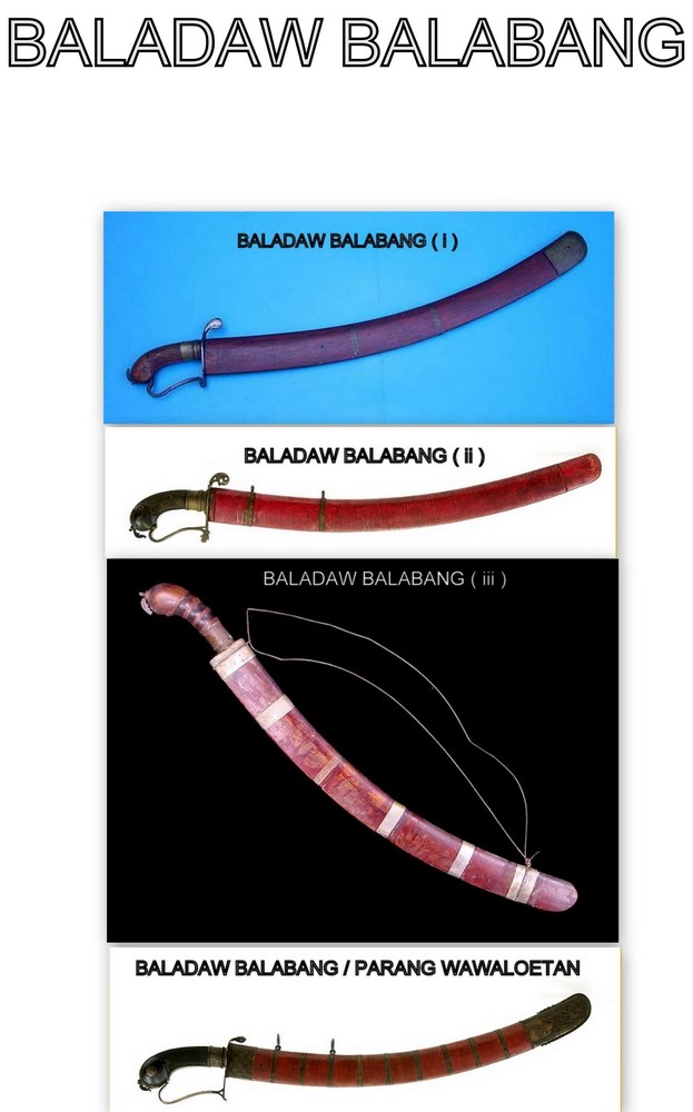

Hullo everybody!
AND YET AGAIN, I have been asked the same type of questions.
This post is an attempt to obviate such a recurrence.
I have reconstructed charts I made when I was still starting out.
'THANK YOU' to all you (involuntary) contributors for providing the pictures.( My apologies. I hope I haven't annoyed you too much by not first seeking permission to use them.)
The following is based on basic shape:

Basic types based on general overall appearance:
Old 25th October 2014, 07:35 PM   #3
Amuk Murugul
Amuk Murugul's Avatar
Join Date: Feb 2007
Posts: 484
Default NOTES
Notes:
- There is no standard for curvature or length.
- Parang Njaboer Balanak, aka Parang Toeso'.
- Parang Njaboer Lais, aka Parang Soedo'.
- Parang Njaboer Pipih, aka Parang Patjat Gantoeng.
- Such parangs generally aka Parang Pamangkas or Parang Kemoedi Singkir.
- Prior to c.1860, red-painted parang-njaboers ( Baladaw Balabang ) were worn by outer-perimeter palace-guards.

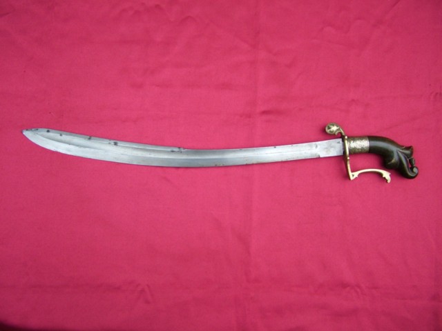

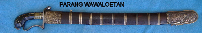

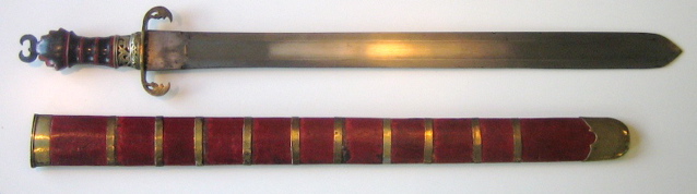

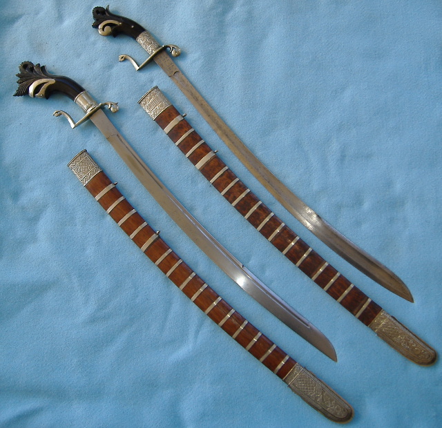

Just for the sake of completeness:
Pedang Salin Alai Waloet & Pedang Salin Alai Balanak respectively:

Amuk,
It's interesting to see all slight variations of the same sword in one thread but what is the purpose of that you are giving each variation a modern Indonesian name?
I am also a bit perplexed that you are using the general term "Parang Njaboer" for some of them. From where does this term come and what does it mean?
What is the difference in your chart between the "Parang Njaboer" and the "Baladaw Balabang", except dress materials and (mostly) age?
"Prior to c.1860, red-painted parang-njaboers ( Baladaw Balabang ) were worn by outer-perimeter palace-guards."
Could you please develop this interesting information - which palace, what source and why prior to 1860? Did they stop making them after c. 1860, so the scabbard is an exact age indicator?
Why haven't you included the Banjar Jenawi in this list (enclosed)?

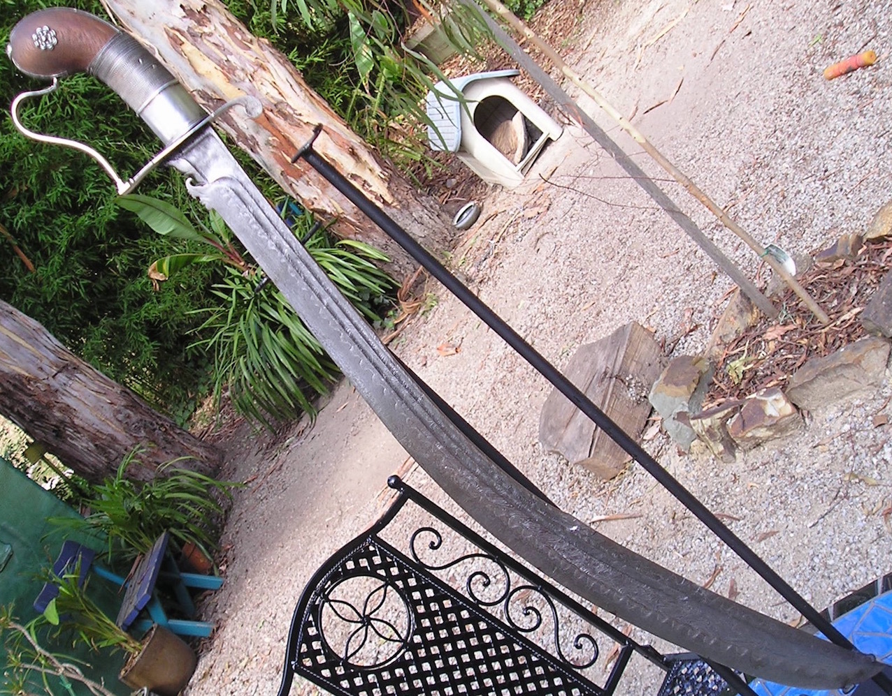

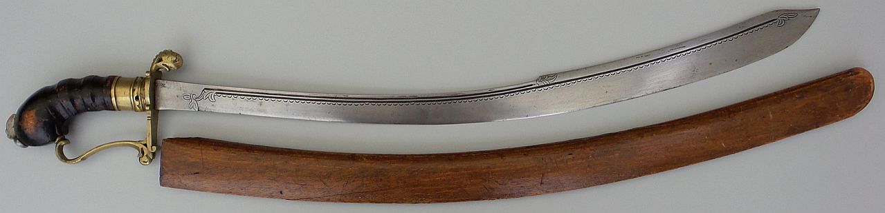

Default A PRECURSOR .....
Hullo everybody!
Pedang Parang Lais (c1800):
LxOALxWxT=46x57x2.06x1.09cm.
Enjoy!

I might be missing a point, but what was the basis of such a classification?
Size? Handle? Contour of the point? Contour of the blade? Color of the scabbard?
What " differences in the basic shape " are important? Are we talking about real issues of construction or just about local monikers of the same sword?
I do love Parang Naburs and would love to really understand them.

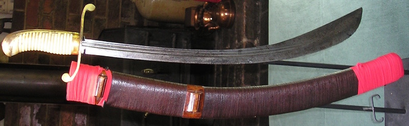

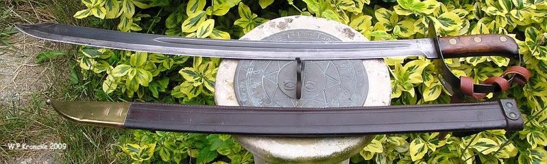

my parang nabur (Beladah Belabang)
Old 15th November 2015, 08:22 PM   #10
asomotif
asomotif's Avatar
Join Date: Nov 2006
Posts: 2,238
Nice example. In dutch terminology this could be called :
"Krom zwaard met gemene scherpe punt en bloedgeul"
A lot of dutch would call it "sabel" or "klewang".
This terminology is fully regardless of size, curvature, shape, age and espcecially regardless of colour.

Old 15th November 2015, 08:28 PM   #11
Krom zwaard met gemene scherpe punt en bloedgeul="Scimitar with a nasty sharp point and blood groove". (really. no such thing as 'blood grooves', they're 'fullers' in english, a device to lighten a blade without losing rigidity.
in the words of the immortal bard, crocodile dundee, that's not a dutchy sabel/klewang, THIS is a dutchy sabel/klewang: .
the dutch ARE fond of the clipped points on their sabels.
premise: jim bowie (boo-ee) was a dutchman. discuss.

Hi Amuk,
Could you please spend some time in answering Michaels questions, as I also would like to know and am curious about the names you use in your "recognition chart"?
I suppose you have the names from the Leiden database, as I noticed some years ago that they use names like you are mentioning for these beladah belabang types from Negara/Bandjermassin area. Or are these later terms they are used to call them nowadays?
Maurice

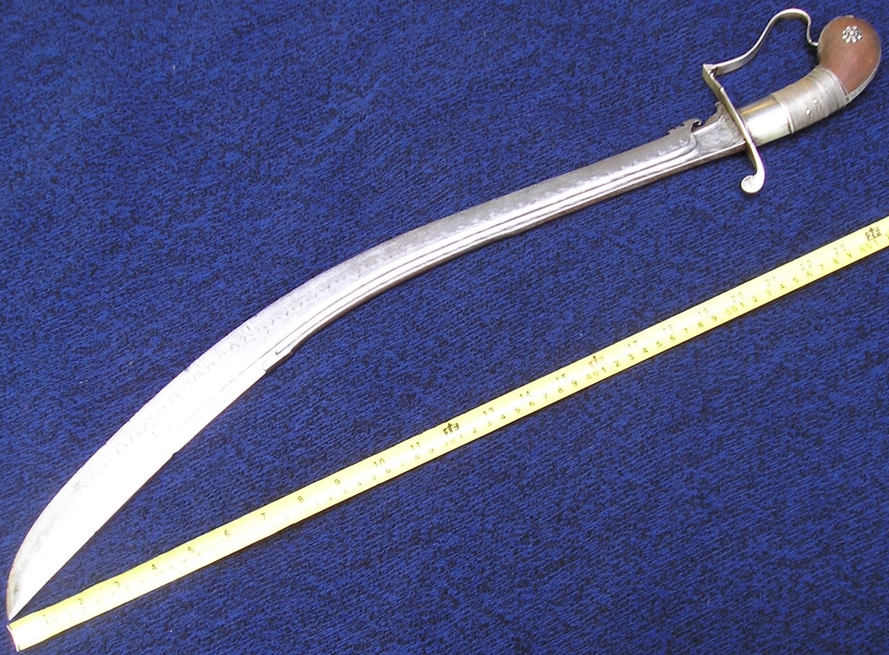

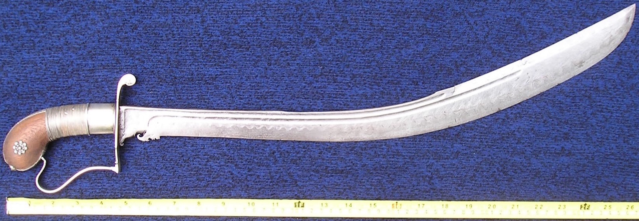

Default Old School: ..... a CLASSIC!
Hullo everybody!
To share, for your enjoyment/info.
Type: Parang Tjarangasoka.
Blade: LxOALxWxT=56x68x4.75x0.99cm.
Handle: Wood w/ silver ftgs.
(Before anyone asks; it IS a Lais)
Synonyms: Parang Nyabur , Parang Nyabor , Parang Niabur , Parang Nabur

Maurice,
-'I suppose you have the names from the Leiden database, as I noticed some years ago that they use names like you are mentioning for these beladah belabang types from Negara/Bandjermassin area. Or are these later terms they are used to call them nowadays?’
I do my own research to my own satisfaction. ‘Beladah Belabang’ is not a term I recognise; it is meaningless to me.
Michael,
- 'It's interesting to see all slight variations of the same sword in one thread but what is the purpose of that you are giving each variation a modern Indonesian name?’
While the words may look Indo, they aren’t; after all, Indo is a derivative of a much older language.
- 'I am also a bit perplexed that you are using the general term "Parang Njaboer" for some of them. From where does this term come and what does it mean?’
I use the term for all the above parangs; the exception being the Pedang Parang, which is a parang-like blade kitted as a pedang and thus much lighter.
Njaboer comes from the old word ‘aboer’, meaning panic/desolation. Thus Parang Njaboer is a parang which causes a state of panic/desolation/confusion resulting from war.
- Baladaw Balabang means ‘knife of red soldier/guard-house’.
When one speaks of Parang Njaboer/Naboer, it implies southern Kalamantan and the Bandjar.
- Bandjar Djenawi is a pedang, not a parang.
