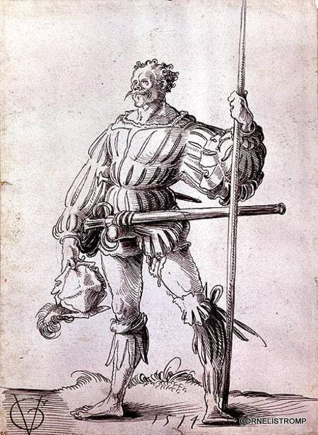

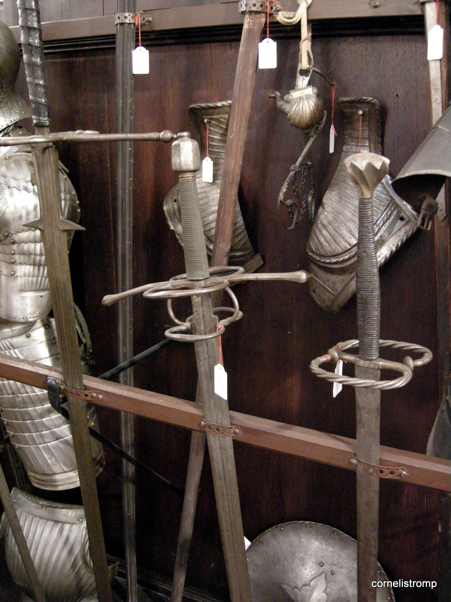

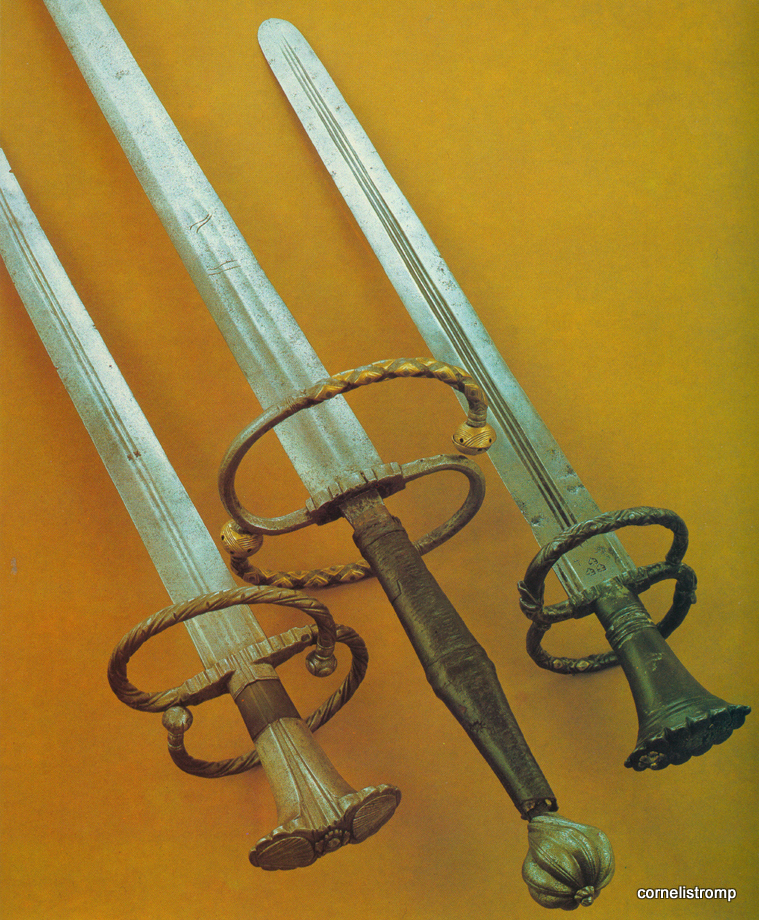

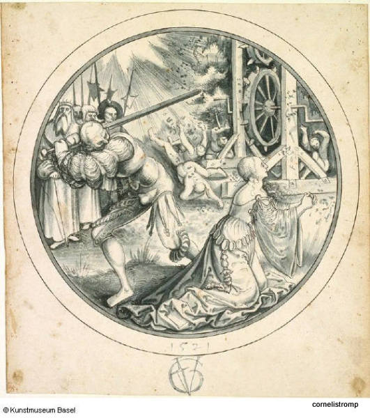

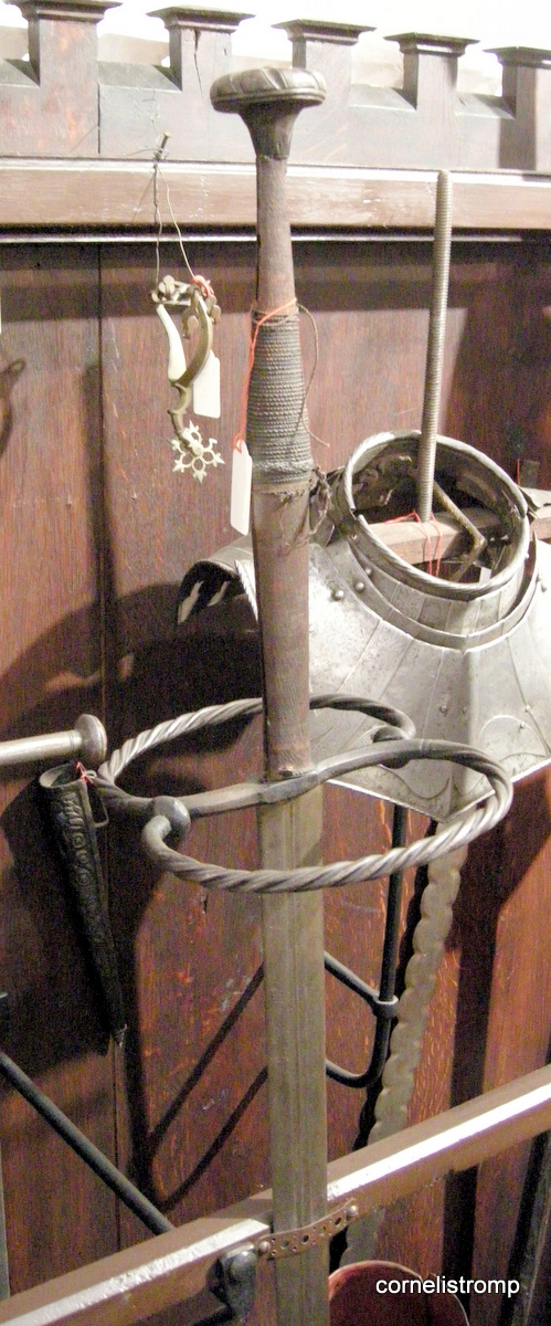

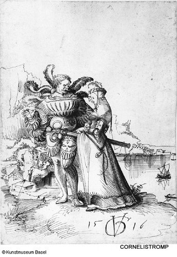

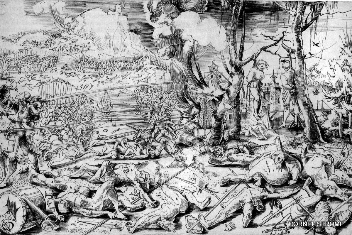

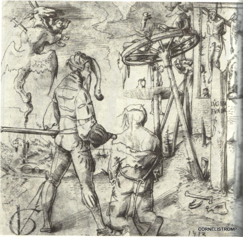

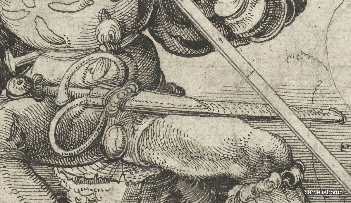

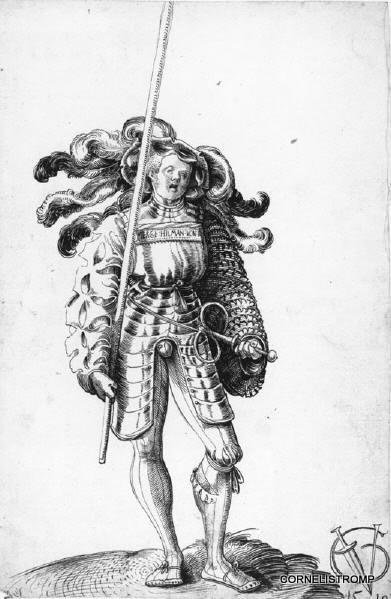

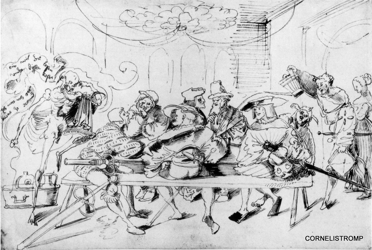

this will be a very short thread, since there are practically no examples left.
rarer than the already extremely rare Katzbalger is the two handed Katzbalger.
At landsknecht art from the 16th century, this type occurs frequently, nevertheless there are only very few real two hand Katzbalger preserved in collections and museums.

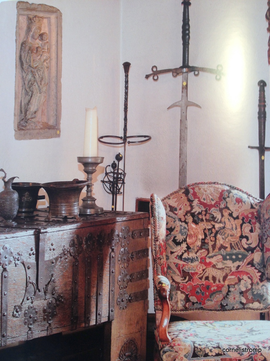

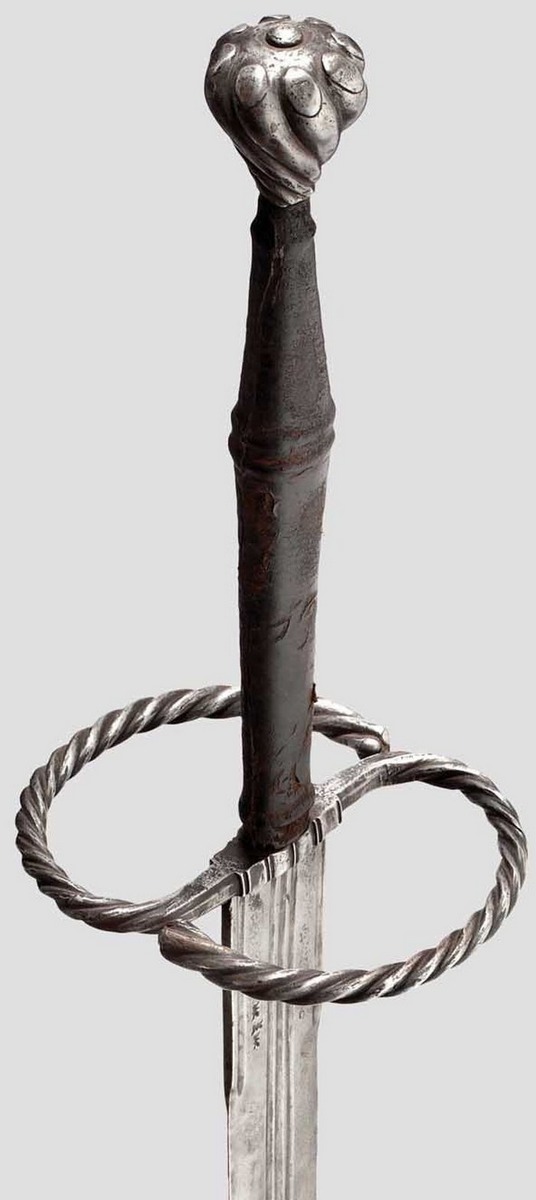

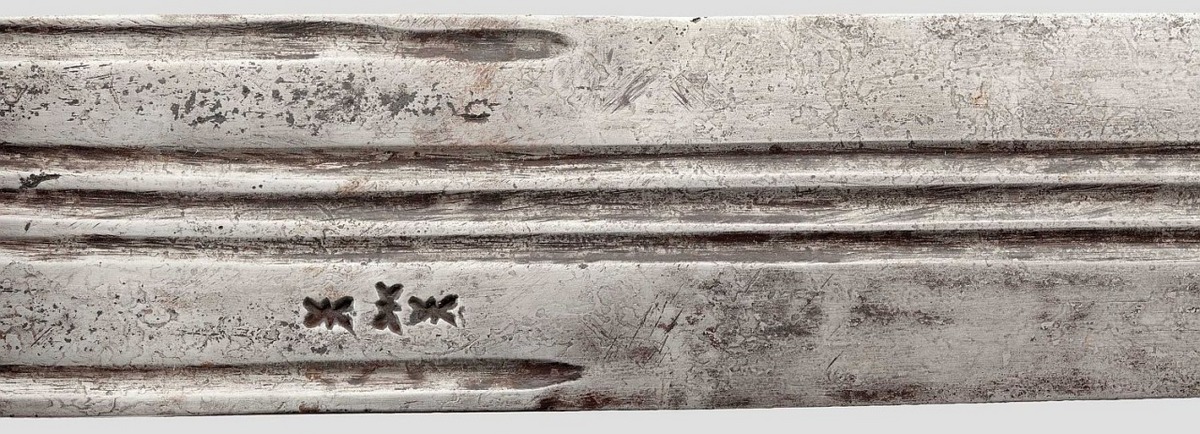

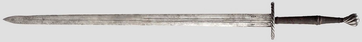

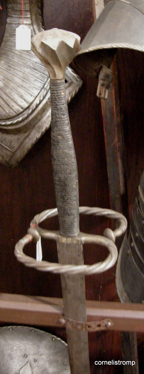

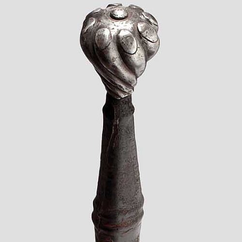

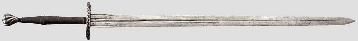

Two-handed Sword
•Dated: circa 1530?!?
•Culture: German
•Measurements: overall length 138.5 cm. Blade 106 cm
The sword has a broad double-edged blade cut with a series of narrow fullers both on each side and over the ricasso; the latter is also stamped with three small marks on both sides. The iron hilt is fashioned in the Landsknecht style, with moulded and bold spirally fluted S-shaped guard, matching plummet-shaped pommel, and moulded leather-covered grip.

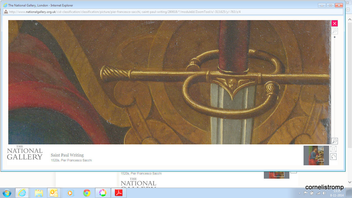

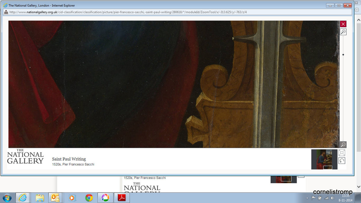

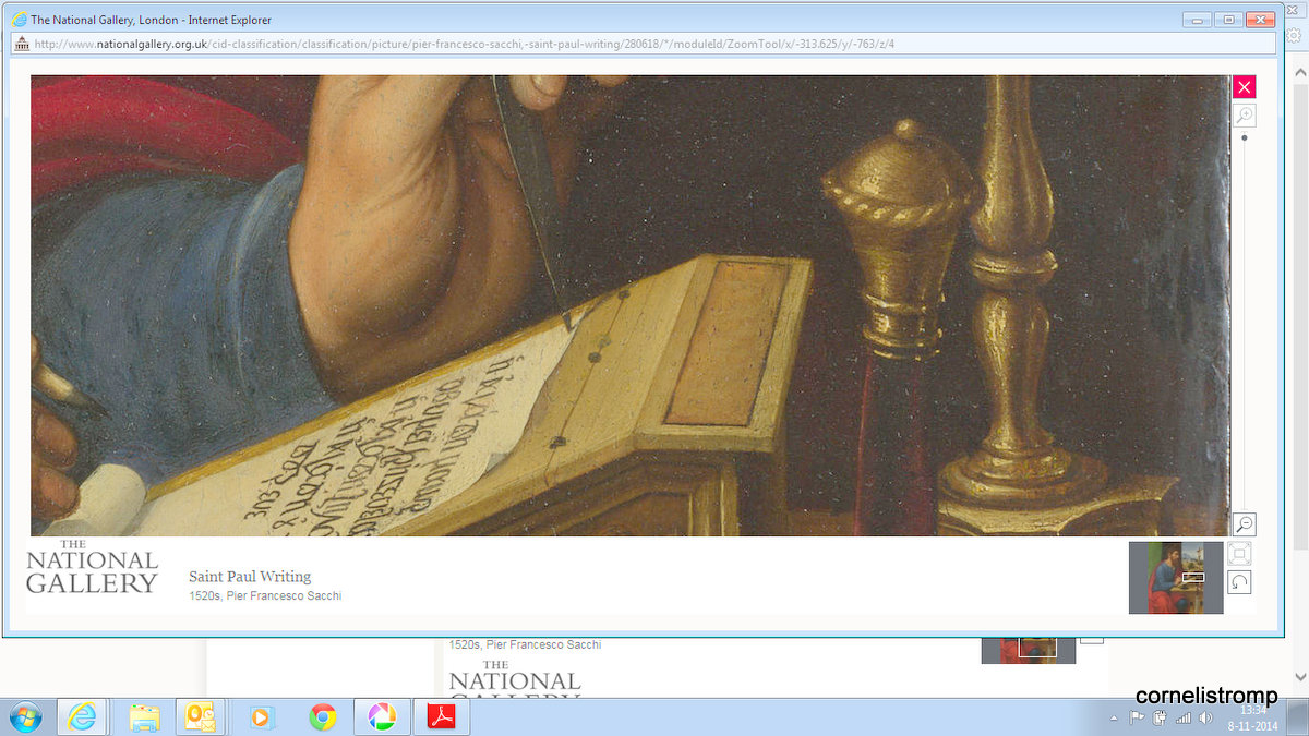

the sword of St Paul in a painting by Pier Francesco Sacchi 1520.
National gallery in London No 1523
it's a two-hand sword with side-rings mounted at the center.
the side-rings are in the form of a Katzbalger 8 shaped guard and are not closed.
closed ring guards you do not you see before 1515 at sword hilts, my theory is that those closed side-ring guards are originally developed from the Katzbalger hilts.
The sword of St Paul's beautiful example of a transitional type.
Also there were around 1520 parry hooks and a Velvet grip clothing with decoration.
