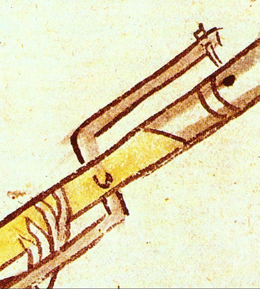

Hooks acted as a recoil stop, and made aiming safer. A forked rest slanted forward against the hook must have worked out fine, as depicted on 15th c. illustrations. Hooks do not turn up in contemporary historic sources before ca 1430, though, but rests do.
The simplest, and therefore oldest, solution obviously was resting the gun on a solid stand, and the next step most probably was to pivot it - in order to move its muzzle vertically and/or horizontally, for a quicker and safer aiming.
As the oldest sources of illustration depict, various solutions must have existed, and been tested, side by side, for at least decades.
The earliest dated sources that have been detected and published so far are miniature illuminations found in two manuscripts by Walter de Milemete, England, dated 1326 and 1327 respectively; and they show the simplest rest of all, from the very beginning, seemingly a table:
top four attachments

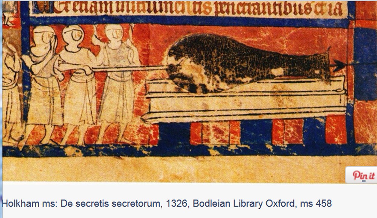

The author is convinced that, with the growing digitalization of codices preserved in libraries all over the Western world, it will only be a matter of maybe a decade or two before an earlier source will turn up.

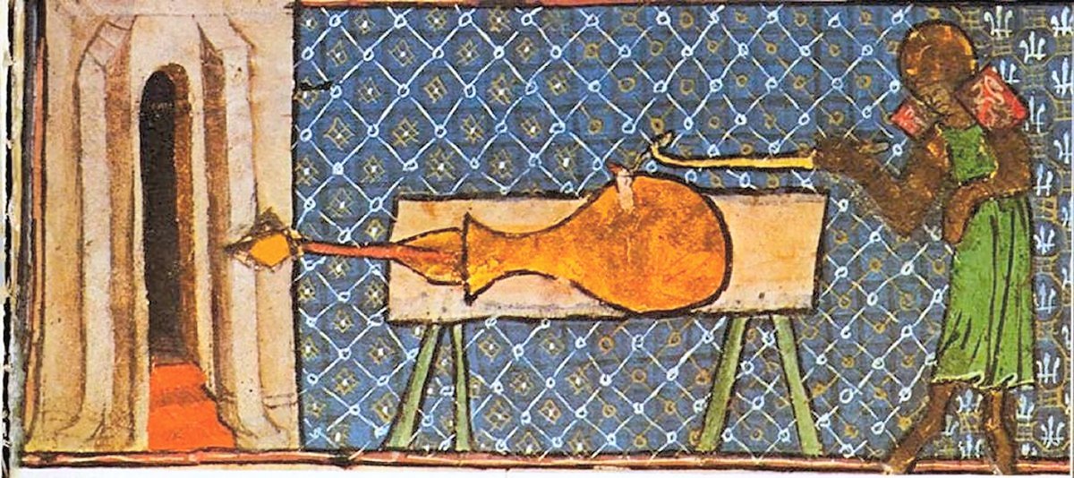

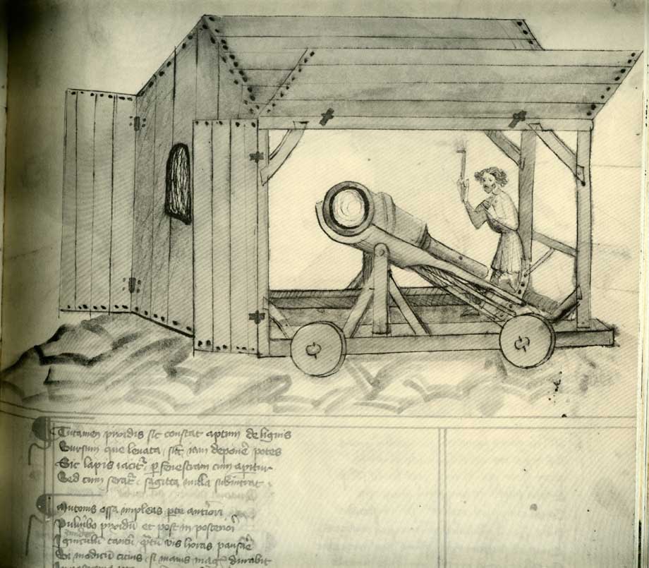

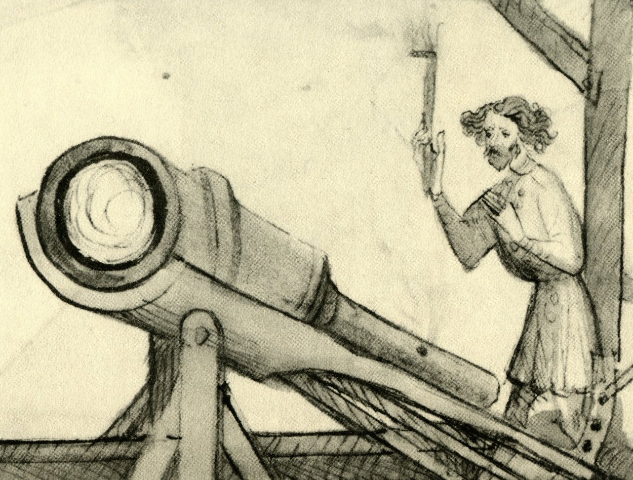

What Walter de Milemete depicted as a table actually represents the prestage of a stock, a wooden casing for what was just a barrel - of cast bronze like a contemporary aquamanile, although the latter were often made of clay still in the 14th century:

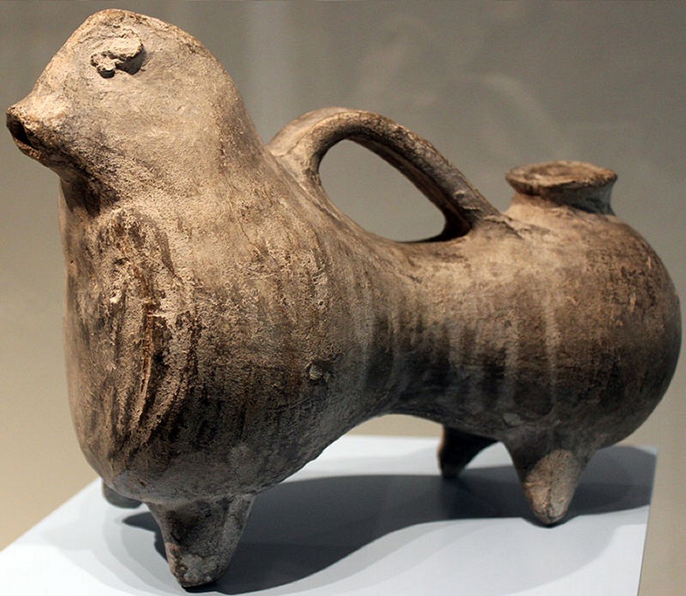

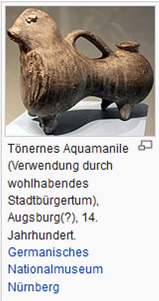

attachments #5 and 6

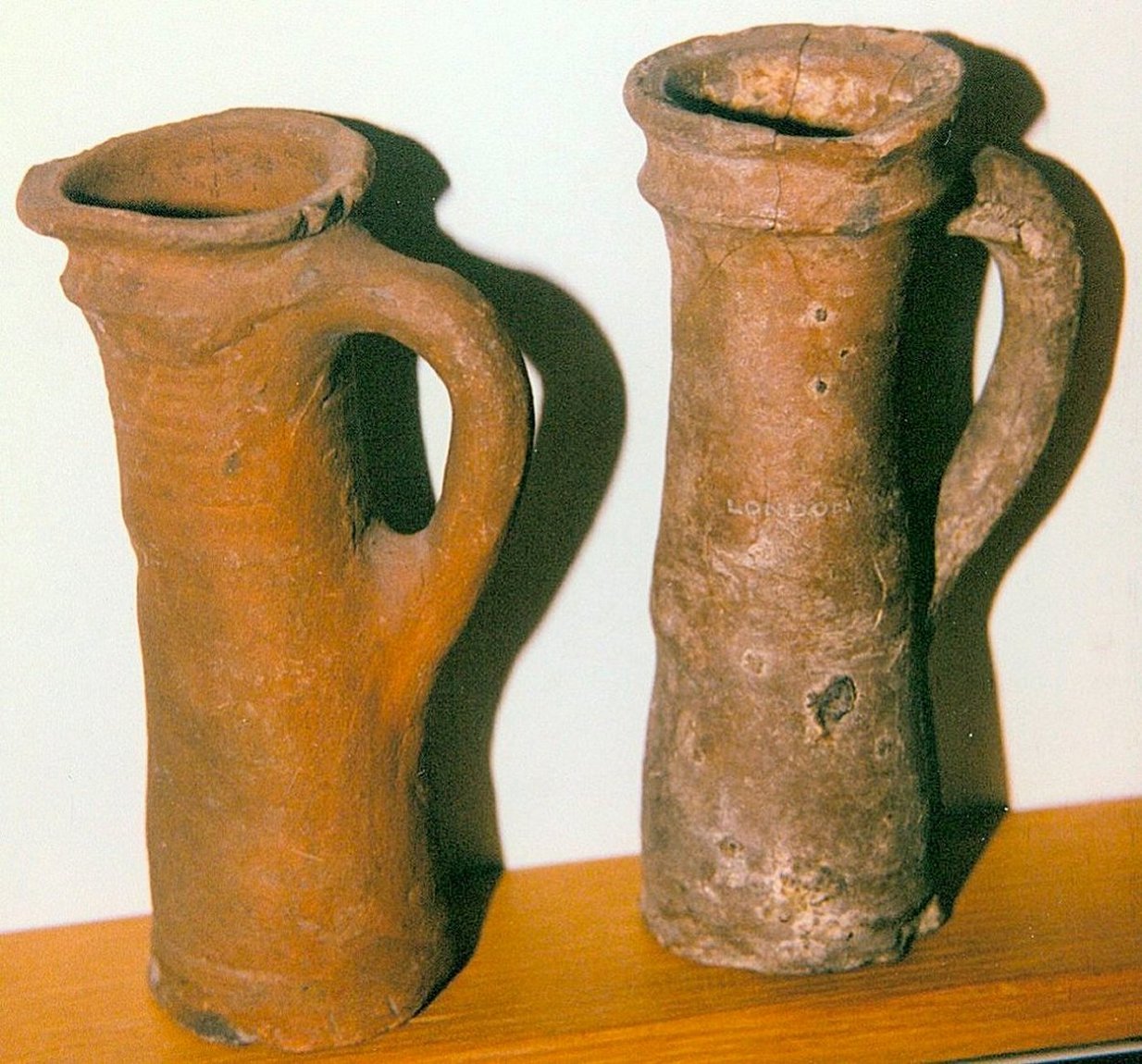

showing a 14th c. German Gothic clay aquamanile
Neglect the handle, and the tubular and bell-mouthed shape of a contemporary jug
becomes evident;
attachment #6:
author's photo of two late 13th c. clay jugs in the Museum of London
This is also the basic form of the de Milemete, and
the Loshult barrels of ca. 1300-1350, the latter see
attachments #7-11.

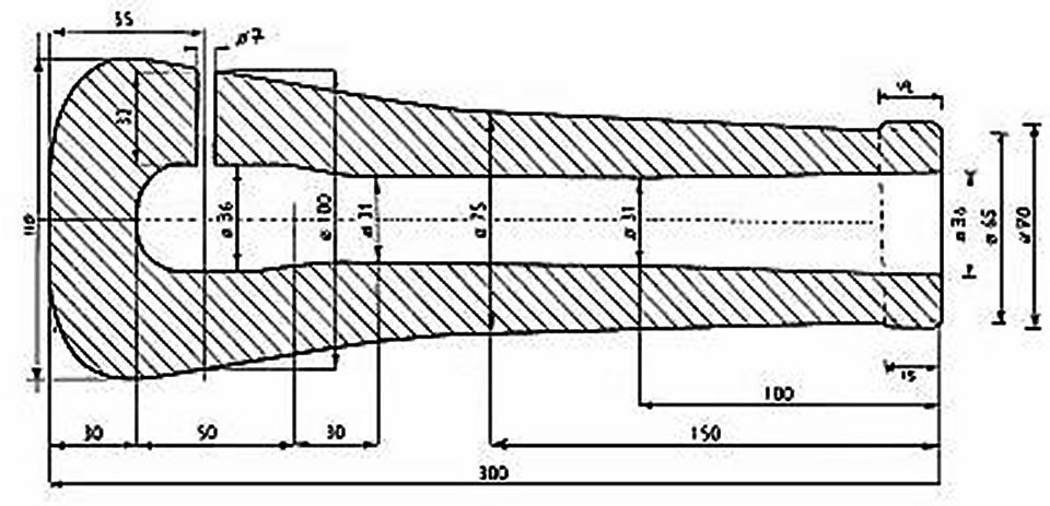

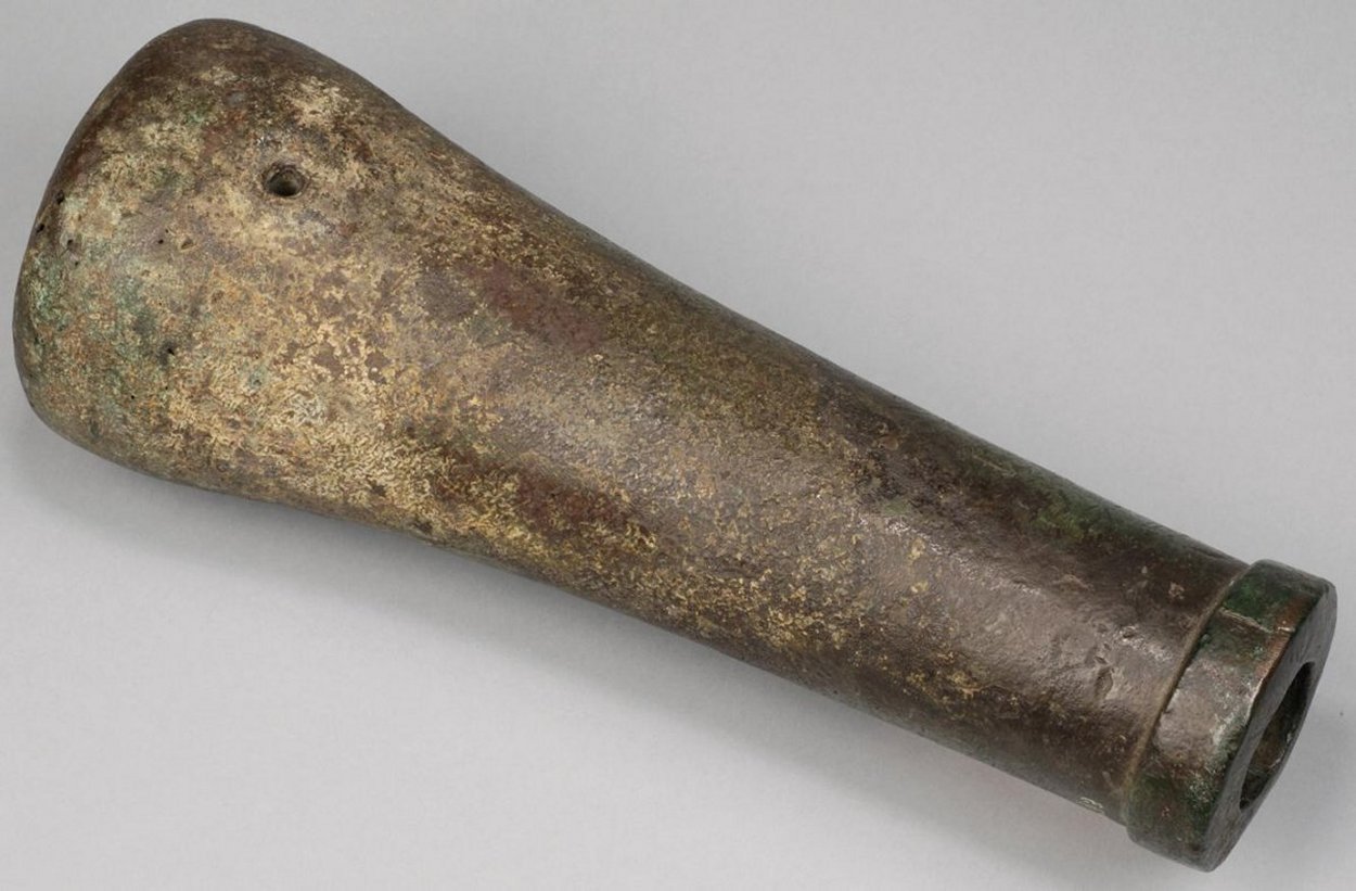

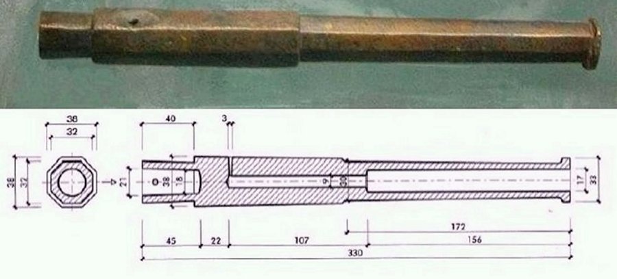

The data of the Loshult barrel:
Length 31 cm, bore 36 mm at the breech (German: Pulversack) narrowing to 31 mm at the muzzle - corresponding to the diameter of the rear end, cord binding, of the gun arrows it fired; weight 9.050 kg.
The first firearm barrels adopted the shape of a tubular vessel of everyday use, apt to keep things like water or milk, but also delicately grained powder-like substances such as meal, sugar or salt. The earliest guns were shaped exactly like the average contemporary 13th to 14th c. household clay mug or jug (neglecting the handle), a can or a bucket made of wood, hammered brass, or iron.

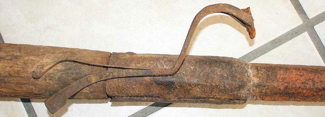

- a very similar and contemporary barrel retaining one of its originally two iron stock bands, preserved in The Michael Trömner Collection:
http://www.vikingsword.com/vb/showth...ht=barrel+1400
post #15

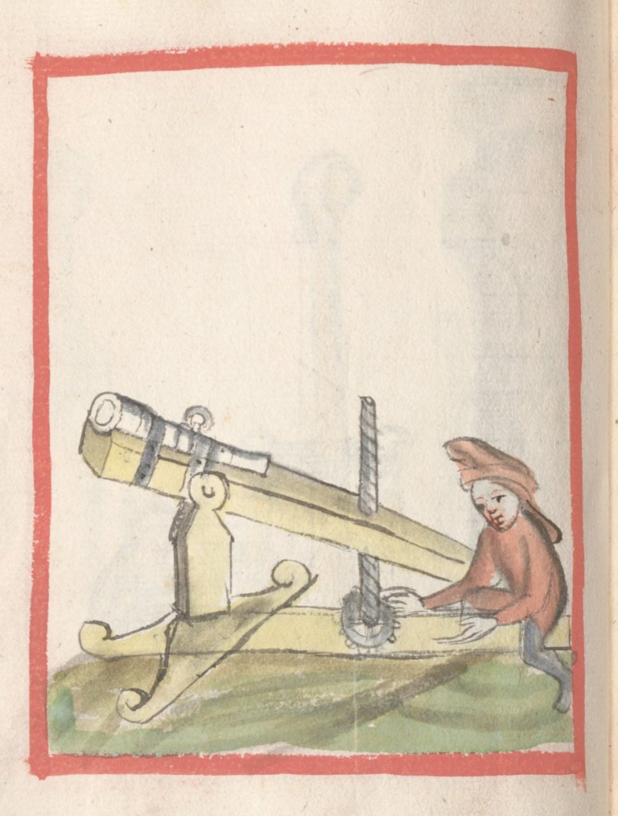

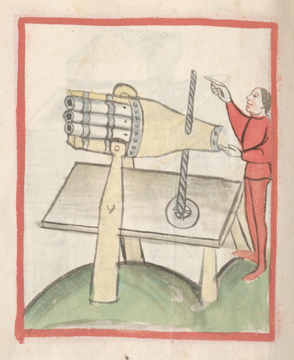

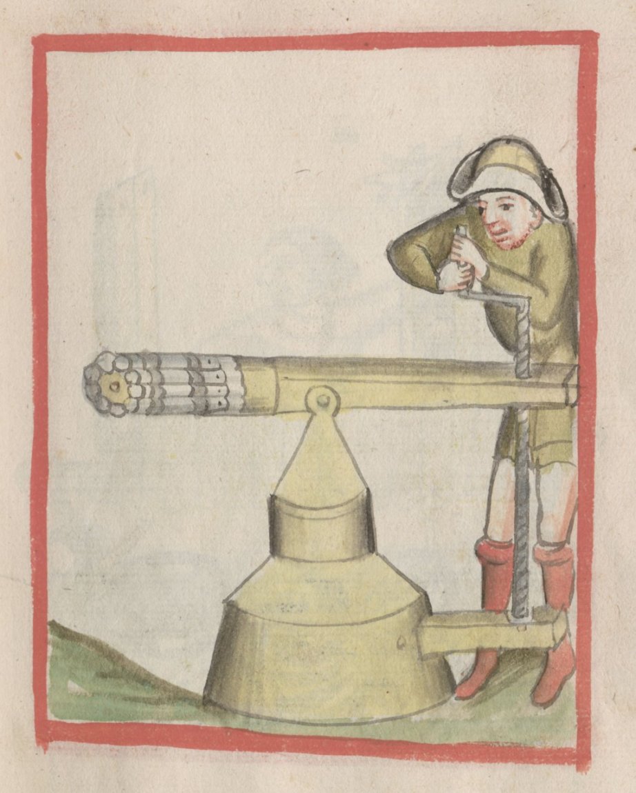

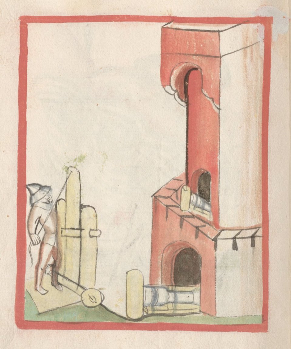

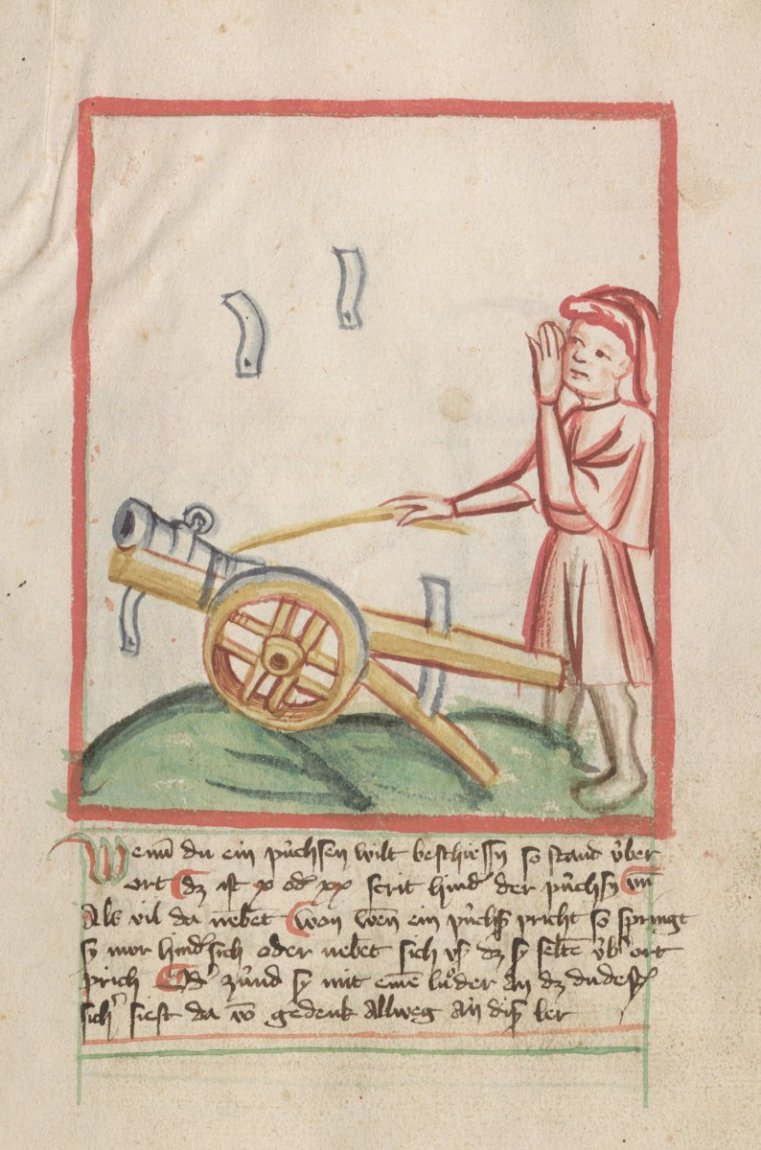

In the second oldest dated/closely datable source of contemporary illustration, in Bellifortis (German: der Kriegsstarke; the strong one in war), written and illustrated by Konrad Kyeser of Eichstätt, Bavaria, ca. 1405, later on we will detect the earliest picture of a High Gothic tiller long gun being fired, obviously fitted with a wrought iron edged .. and socketed barrel reflecting the Gothic taste, and a much longer wooden tiller stock; the barrel is rested on a wooden fork.
In Cod.vind. 3069, ÖNB Wien, dated 1411, there are studies of a remarkable variety of methods, all being experiments how to rest and adjust guns at the turn of the centrury. Two watercolors illustrate the use of a thread, some show the guns pivoted, some represent early stages of a forked rest, and the last depicts a gunner firing his tiller arquebus at short distance, and through a slot is his targe which he uses as a rest:
see attachments #1 through 11,
depicting fols. 20r, 10r, 26r, 18v, 24r, 33r, 20v, 25v, 24v, 19v;
appearing in order.
Regarding the proportions of persons and objects, the fact should be considered that before ca. 1490, and ingenious painters like Leonardo da Vinci and Albrecht Dürer, who were both influenced by the break of dawn of the Modern Age starting with the Renaissance period in Italy, illustrations were not correct representations of reality, neither in terms of perspective nor actual dimensions.
Consequently, Medieval artists pictured every person and object which they felt were most important to point out to viewers, much bigger than lesser persons, or everyday objects widely known.
Looking at Kyeser's illustration from this aspect, we are able to imagine the actual dimensions of both the gun and the forked wooden rest. In fact, both were quite small and thin, when compared to the gunner. Kyeser made these objects look so big because the fork was obviously quite a new invention, a fact that he wished to point out to his fellowmen.

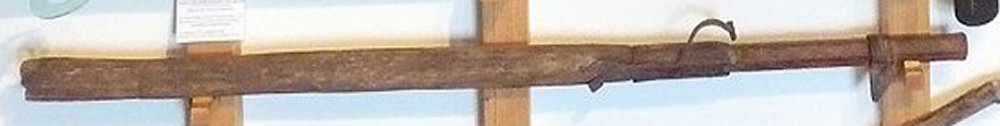

A surviving contemporary of Kyeser's period is world's oldest known surviving long gun, ca. 1390-1410, preserved in The Michael Trömner Collection:
http://www.vikingsword.com/vb/showthread.php?t=7077&highlight=1410+earliest+olde st:
Bottom attachment
To be continued in follower post.

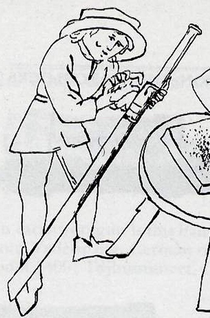

The actual dimensions of the earliest completely preserved gun of ca. 1390-1410 closely compare to three very similar contemporary guns, illustrated in
- Cod.vind. ?, dated 1410, ÖNB Vienna
top attachment
- Cod.vind. 3069,
by the same artist,possiblyJohann Hartlieb, dated 1411, ÖNB Vienna
(see 11 atts. to previous post)
- Bellifortis, 1405,
atts. #2 through 5,
incl. a self portrait of Konrad Kyeser

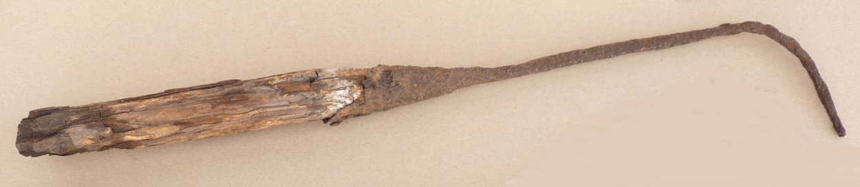

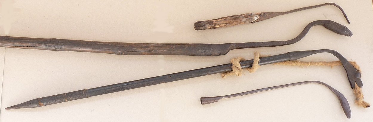

Please also note the earliest representation of an igniting iron, depicted rectangularly curved, and very delicate overall, especially at the tip.
the author's thread on igniting irons and linstocks, as well as the oldest actually existing igniting iron recorded,
http://www.vikingsword.com/vb/showthread.php?t=10029&highlight=igniting+irons:
att.
- earliest igniting iron in author's collection, for comparison

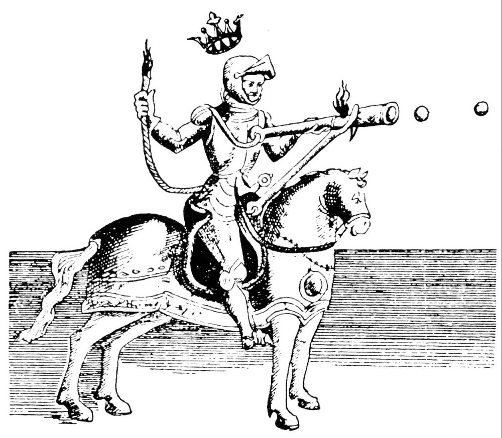

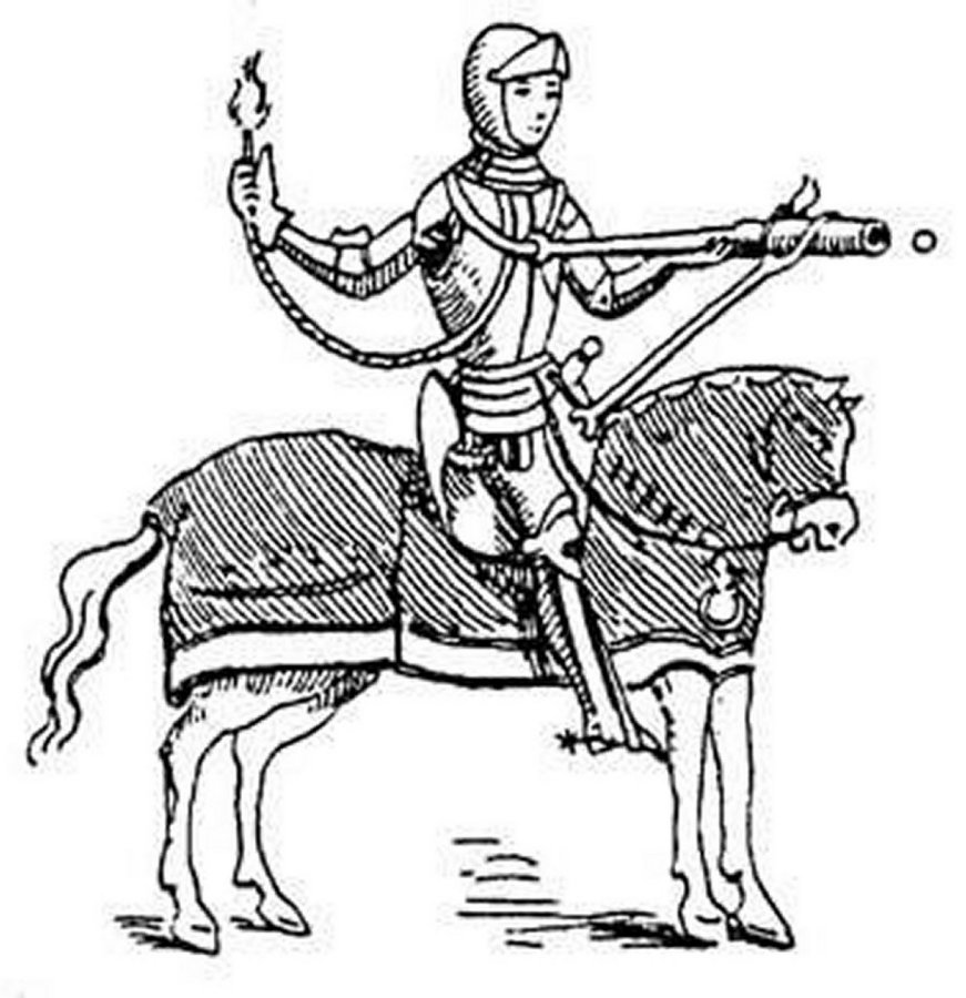

is a representation dating to ca. 1460-70, of a gunner aiming a short firearm on horseback, the gun rested on a fork.
The illustration copied from Wendelin Boeheim: Handbuch der Waffenkunde. Leipzig, 1890, p. 445, fig. 522.
A variant of that drawing is also attached.

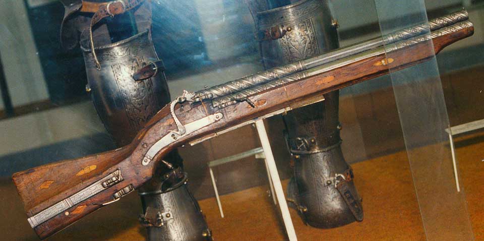

By the early 16th c., and inspired by Maximilian I., who spent more money on firearms and war than he could actually raise, the Innsbruck artist Jörg Kölderer illustrated one of the 'Maximilian' arsenal inventories (Zeugbücher) in 1507, depicting a highly unusual three barreled gun with wrought-iron barrels, and the highly figured stock painted light green, which was characteristic of the Late Gothic/Early Renaissance period of style. The snapping tinderlock mechanism was most probably released by a

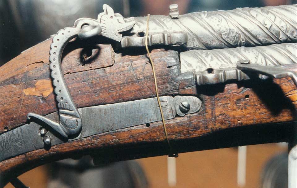

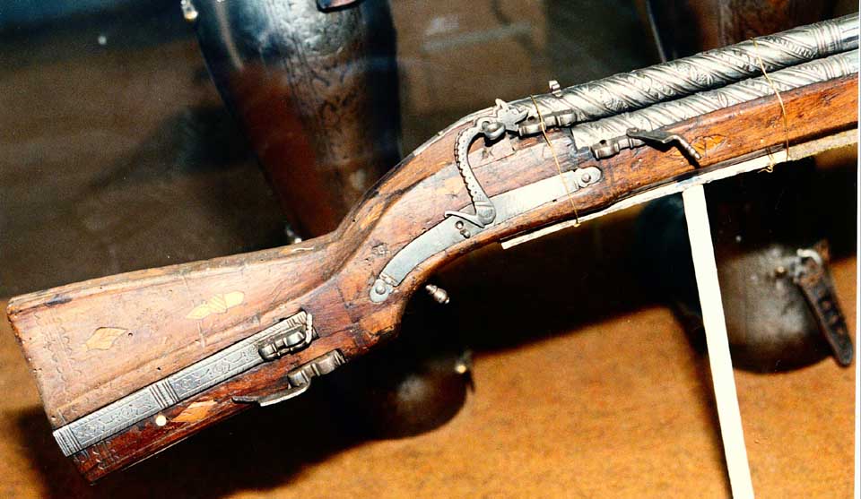

laterally mounted push-button trigger; the zoomorphic (serpentine) tinder holder is shown cocked, with a piece of tinder clamped in its jaws. It would only ignite the powder on the pan of the right one of the two short barrels, though; the remaining two had to be set off manually.
The author photographed a similar but seven barreled! snap-matchlock arquebus, Northern Italy, ca. 1525-30, in the collections of the Army Museum Prague, located on the Hradschin fortress:

I has to be said Michl, this thread and you are amazing
Hopefully i am not too forward posting these pictures. They mainly depict the heavier guns/cannons of times long gone.
Attachment 1: One of the simplest ways to support such a heavy weapon was by means of wooden beams. Also on a side note, the archers shoot with what appears to be incendiary arrows!! from: A fortified town under siege. From the Swiss Amtliche Berner Chronik of 1483.
Attachment 2: An aimable cannon with stand and a smaller cannon on a simple but very widely used plank with wheels. Quit a lot of the manuscripts i see have this second design. The Hague, KB, 128 C 1 I fol. 403v Book 17: Chapter 1 Siege of a city (can't find the date on this one)
Attachment 3: Similar to the second picture, but this time the witnesses go bananas and look in fear. As Michl pointed out earlier in this thread, firearms where feared on both sides of the barrel . Jean Boutillier, Somme rural, Bruges ca. 1471 (BnF, Français 202, fol. 15v)
Attachment 4: A rider, similar to the ones shown earlier, with gun and rest mounted on the horse/saddle. Mariano di Iacopo [Jacopo] (aka Mariano Taccola; and also referred to during his life as the 'Archimedes of Siena') (1381-1453 and in this instance after 1430).
Attachment 5: A town under attack, two soldiers with stocked hand guns (and one with a faint hook?). Note also the ignition iron (?). It is glowing red hot. http://gallica.bnf.fr/ark:/12148/btv...=%20Le%20Livre

[QUOTE=Marcus den toom]I has to be said Michl, this thread and you are amazing
Thank you so much, Marcus,
Those sources of illustration you've found are at least as amazing as the ones I gathered together over four decades - they're just great, and so are you!
You have been doing very fine, and your're learning so fast.
It makes an old Landsknecht veteran of weaponry, like me at 61, so proud of you!
Best wishes, my friend,
Michl

Furthering on this thread of Michl, i found these ignition irons
Some of them are show redhot, either straight or with a little pick/hook at the end.
Not many would have survived or can be identified i fear.
