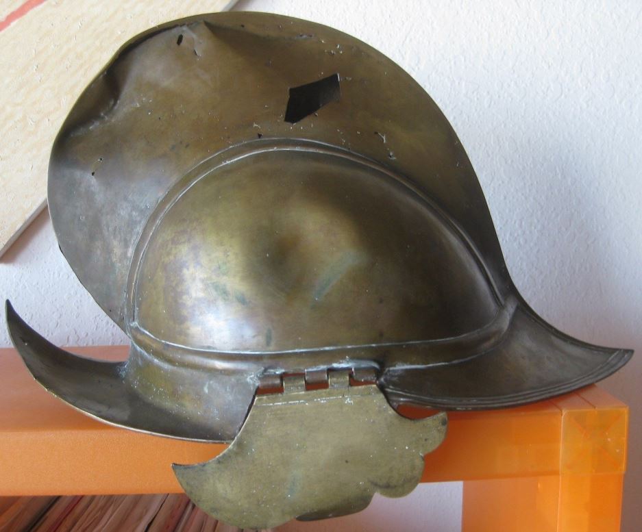

The opposite side of the helmet has some unusual damage, almost like puzzle pieces missing from its comb. I wonder how that type of damage could occur...almost looks like thay were punced out. Perhaps these were weaker areas of the forged brass??

On the first picture you can see two old repairs at the ridge, maybe there has been a similar repair which break out again!?

Charles, the fractures look that way because the helmet is composed of brass-- although whether it is made up entirely of castings which have then been braised together, or is partially wrought, is not clear from the pics. In short, the fractures run along the boundaries of the microstructures in the metal:

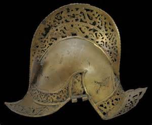

Here an other example for comparison.

Incidentally, this is what Charles is referring to:

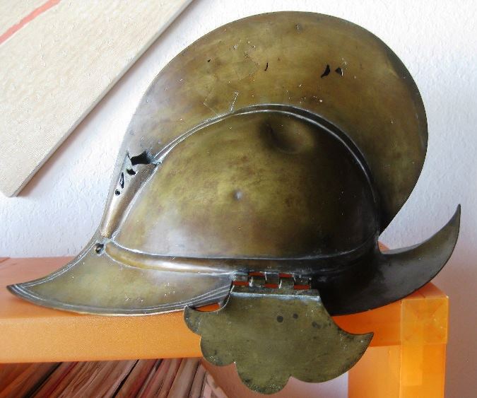

This is not the best angle for study, but this is a very similar, if not identical, helmet.

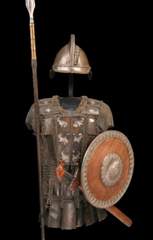

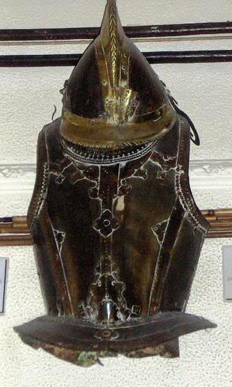

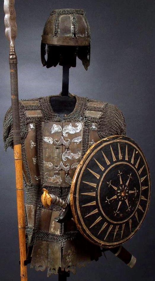

Here are three Moro armors. The first two should help contextualize the solid brass helmets a bit. The last pic is also brass, but made of mail and brass plates.

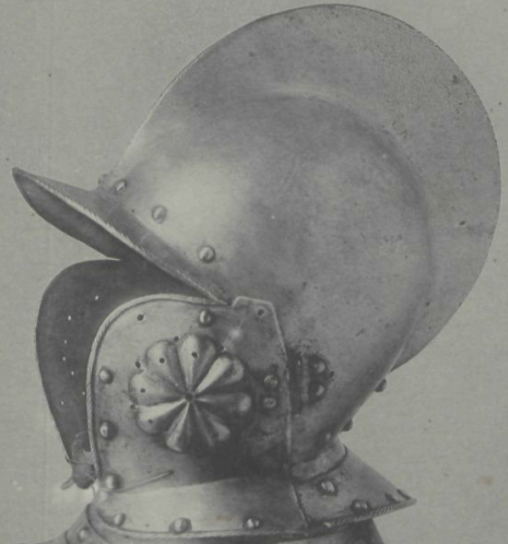

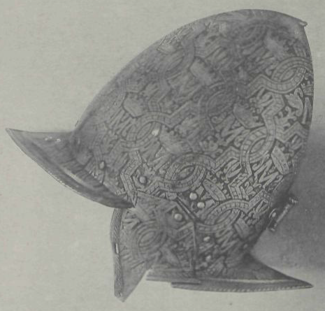

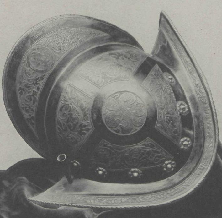

Oliver not minding, i am here attaching a few images of the original stuff for your perusal, presumptiously assuming that these are not so easy to find out there.
An woodcut of a European Captain of War (collection R. Daehnhardt) and a set of pictures of the period of Spanish King Philip II, both from the XVI century.
