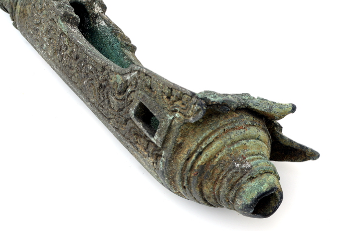

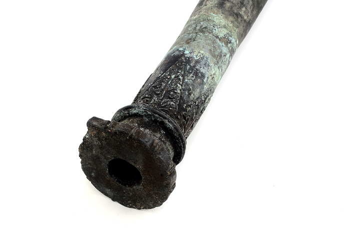

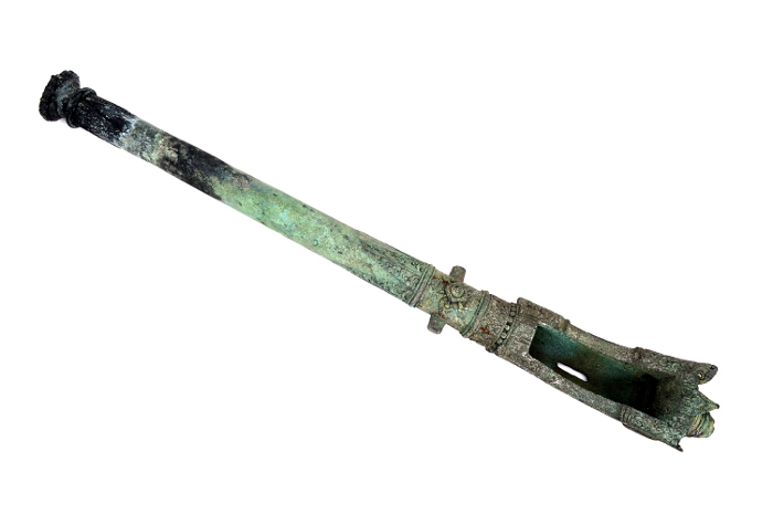

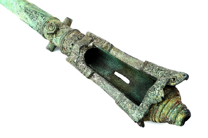

I don't know a lot about breech-loading swivel guns / cannon. This one appears to be of the type that were made in (or for use in) the East Indies.
After photographing the cannon last week, I misplaced my measurements. But it seems to me that it was about 50 inches long. I will measure again when I visit the storage unit.

A breech loading 'berço' in a lantaka dress.
Whether made in the West to trade in Asia or made in Asia with a Western touch.
Either an 'aged' non operational item for international trade or local home wealth, or (hardly) the real thing. These devices are a bit tricky to classify.
Experts needed.

For stylistic as well as formal reasons, this breechloading bronze cannon barrel is closely datable to ca. 1530-1550; many of these are of Portuguese manufacture - now, does this give you some patriotic satisfaction, Nando?
The zigzag ornamentation cast in high relief and contoured by chiseling, is highly unusual for Asia, while characteristic of the Nuremberg Early Renaissance style.
If made in a Nuremberg foundry, it should be dated to ca. 1525-40.

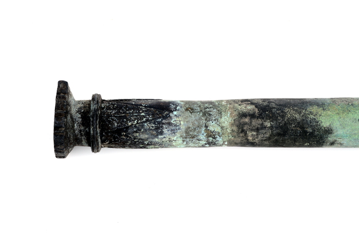

Thanks for your comments Michael. Your thread "Breech loading 1450-1550" is one of my favorites here at the forum. It should be required reading.
The muzzle and forward portion of barrel looks like it has been in a fire.

May i disagree or confess that i am in the least confused ?
The zigzag (bamboo shoot ) motives are in low relief and are usual for Asia. This would be one of the common components of a Lantaka decoration .
http://www.vikingsword.com/vb/showth...hlight=lantaka
I agree, as i first mentioned, that the breech loading style is that of a 'berço', a term implying that this would be of Portuguese nature and of the date suggested .
I wouldn't recall the date the lantaka (with such decoration type) appeared but, apart from that and if i may, i still suspect that this whole set may well be a knock off, either for (not so transparent) Web selling purposes or, as often happens, for local use, like for home decoration, wedding dowry, trade currency, etc.
Nowadays artificial ageing of things is far from being discerned by those non initiated, myself for one. Perhaps some solid data on its provenance might help clarify.
Exactly!

But when they appear on cast-copper alloy barrels (brass or bonze), it is only on items after ca. 1550.
The reason is that they started importing barrels with that zigzag ornament from Nuremberg from the early 16th century. By and by they must have started taking over, and copying, the appearance of those barrels they called lantakas - that "magic" zigzag decoration included.
Very soon, though, their native Indonesian stylistic elements seem to have prevailed, and this, in my opinion, is why you can tell apart an early 16th century barrel from a similar but Indonesia made, within seconds.
Originally, the zigzag ornament goes back to the early 14th century, when it became known as der fränkische Rechen (the Franconian rake), and consequently characteristic of identifying, and representing, the Franconian region by its official coat-of-arms.
Nürnberg has always been the capital of Franconia, as well as the important political, cultural, and economic center.
So this is what that zigzag ornament originally stood for, and was meant to convey to people on far-off continents: the power and unparalleled leading quality, as well as the topic stylistical taste, of all goods that were made in, and exported from, Nuremberg, Franconia.

Your cannon looks like Javanese-pre Islamic cetbang cannon from the late Majapahit period (that ended in 1527). Javanese were making cannons from 14 century after as they have mastered mass-production of bronze.
Portuguese came to Indonesian archipelago in 1511, so probably Javanese improved their design under Portuguese influence (or vice versa?).
Decorations look like from the late Majapahit, they look like pre-Islamic period. Islamic period started in 1527.
I think that you have a very valuable piece. Lantaka, somehow similar cannon but not breech loader, was mass produced, however, cetbangs are quite rare, especially decorated like this.
https://en.wikipedia.org/wiki/Cetbang
http://fotosulawesi.blogspot.com/201...-kerajaan.html
centurion is offline   Reply With Quote
Interesting. Thanks for the info and link.

Another similar cannon is in Istana (Royal Palace) Panembahan Matan in Muliakerta, West Borneo, Indonesia.
http://picdeer.com/media/1467774107953559456_692286653
