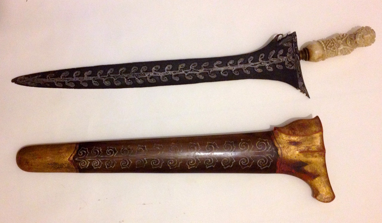

I just received this Cirebon keris but I am not sure which pamor it is (or is it a mix of bonang rinenteng and mayang mekar)?

This blade displays very clear evidence that it was produced in the Sumenep area of Madura.
The entire keris may, or may not be of Cirebon origin, but the blade was not made in Cirebon.
I cannot name the pamor, I believe it to be an artistic innovation.

Thanks Alan,
I am a bit surprised that it is of recent (?) origin based on its supposed provenance.
Could you please develop the main points of evidence for it being Maduran?
Anyway, if it is an innovation it explains why I had a hard time to find the pamor.

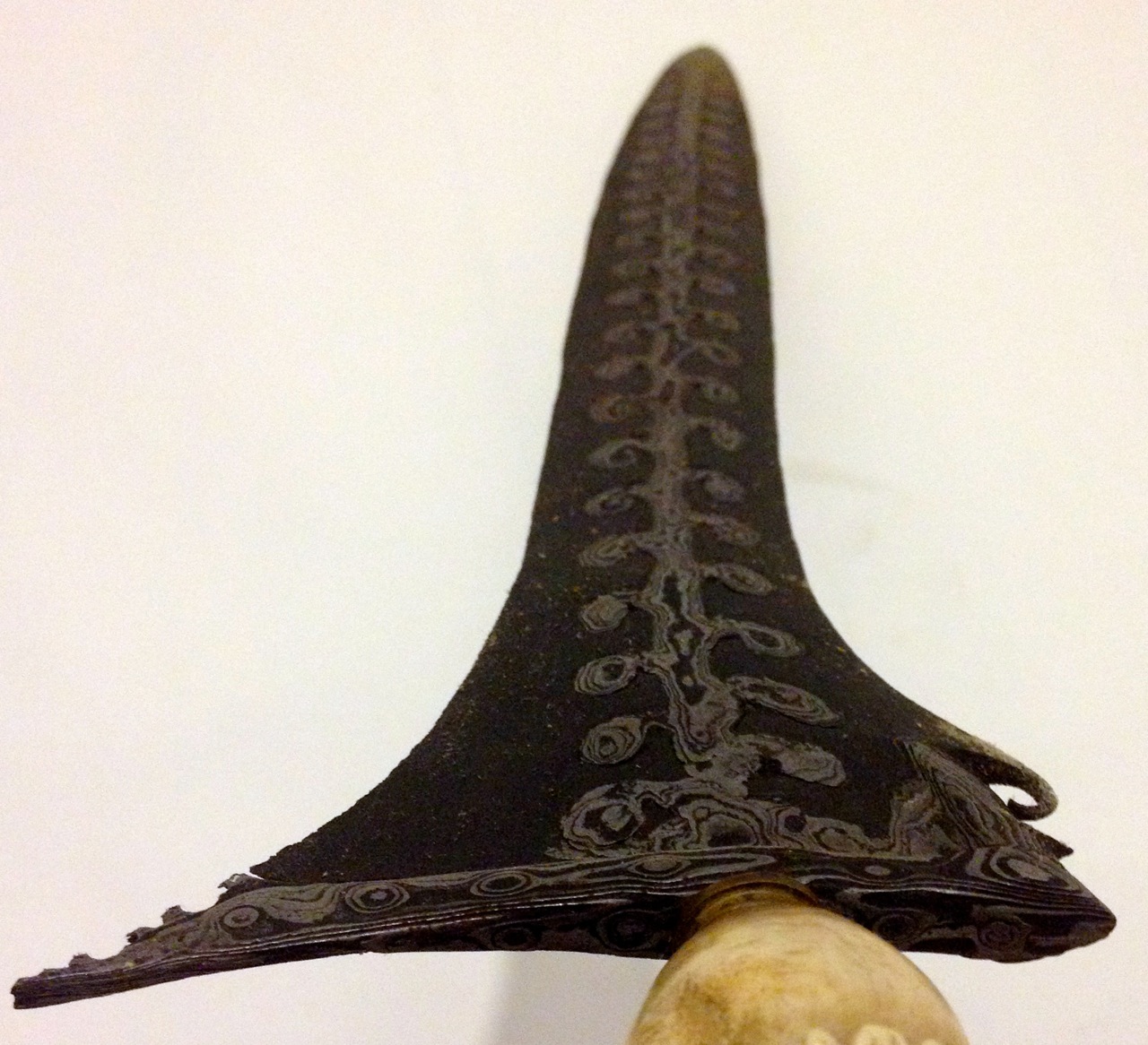

I cannot say with any certainty that it is recent, that is, recent in the sense of since 1980 --- I would need to handle it to give an opinion on that, but the gandik and kembang kacang are very typical of Madura, the rondha is a form frequently found in Madura keris, and this style of pamor work is also common from Sumenep, both pre-WWII and since the revival. It is very difficult to assess iron from a photo, but that too has the appearance of iron used in some Madura keris.
I note that Semar has suggested sekar lampes, but I do not think we can accept that, because sekar lampes is a pamor miring, not a pamor mlumah, and this keris is pamor mlumah with manipulated surface.
Recently there seems to have been a lot of interest in Cirebon keris, and I have seen a lot of photos and heard stories of keris of "Cirebon" tangguh --- its almost as if Cirebon keris have become much more plentiful than they have been for the last 30 years or so.
I would most humbly suggest that before anybody nominates a blade for tangguh Cirebon that they might do well to look at what Ngabehi Wirosoekadgo has to say about tangguh Cirebon in "Serat Panangguhing Duwung", and then to spend a little time with "Silsilah Keturunan Empu Tanah Jawa".
There is no problem at all in nominating a complete keris as Cirebon, but almost invariably that complete keris will have a blade from some place other than Cirebon.

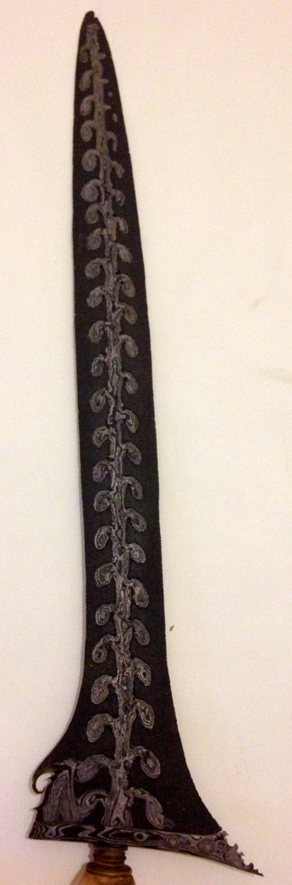

I am not sure, but it could be a not perfect executed or variant of bonang serenteng.

Regardless of age or origin i must say that i do like this keris. The pamor mimicking etch on the front part of the gander is a nice and elegant ensemble touch.

Yes, agreed, it is a nice keris, not a thing wrong with it, but the blade is not what it is presented as, ie, Cirebon.
