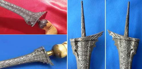

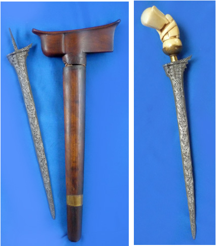

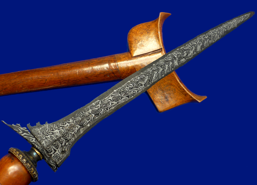

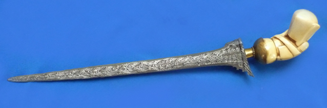

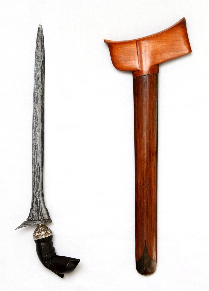

Dear all,
I got this small Bahari blade with excellent Lar gangsir pamor (correct me if I am wrong) just recently but it was dressed up in a semi-new fantasy style Minang sarong with a Panjang handle! Surprisingly well balanced pamor but differ a bit on both sides of the blade and towards the tip ( slewah and / or dwiwarna?). Never saw a Bahari blade with such a clear pamor, extraordinary? The size is small with 25,5 cm ( without peksi). I am puzzled by it and wonder which sarong is proper for it.
The brown sheath ( sampir looks like Gowa / old Makassar style?) could do? Have exchanged the Tapa Kudah handle for the small ( but slightly to fat) Jawa Demam ivory handle. Better? Any comments / suggestions welcome.

Beautiful pamor!

Has anybody seen another specimen of a bahari blade with such a complex pamor? This reminds me of the balinese kris recently posted by Henri and with a similar pamor pattern Lar Gangsir.
I only have one bahari/ anak alang blade (from Malaysia?) with a common pamor pattern which was surprisingly revealed after warangan.

Dear Klungkung,
Keris panjang, and also the much sought ‘bahari keris’ from Sumatra, is usually pamorless. Though not all pamorless. The iron they used, usually blackish gray iron. Or all black iron (in Jawa, they used to refer it as "hurab iron"). Sumatran people refer to it as "malela iron". You may see, at some peculiar Lampung traditional weapon, "badik kelingi", the very specific south sumatran badik with its triangular form of blade. Kelingi, usually all black...
Should be careful, if you get ‘keris panjang’ or bahari keris with pamor. This what my sumatran friend said.

It's impossible for me to tell from pictures if it's an old, neglected blade, or a new, artificially aged. Yet old Keris Bahari with this Pamor do exist. I know of three blades, one of them old for sure, one which looks old and one which I have seen "in person". They all have more complete Greneng and blade shape than this one. Becouse of the state of preservation I cannot say about the quality of pamor work, yet it seems to be better at least on two of the other blades.
Actually I always was tempted to see these (old ones) as products of one workshop, becouse of the rarity of this pamor and superficial similarity of the blades. I also think, none of them is older then the very end of 19th cent/beginning 20th cent. Of course, it's an oppinion of a not well informed person.
I don't think, these blades were made by Minang - your scabbard is Minang. A Saribulan would look better.

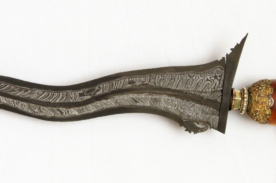

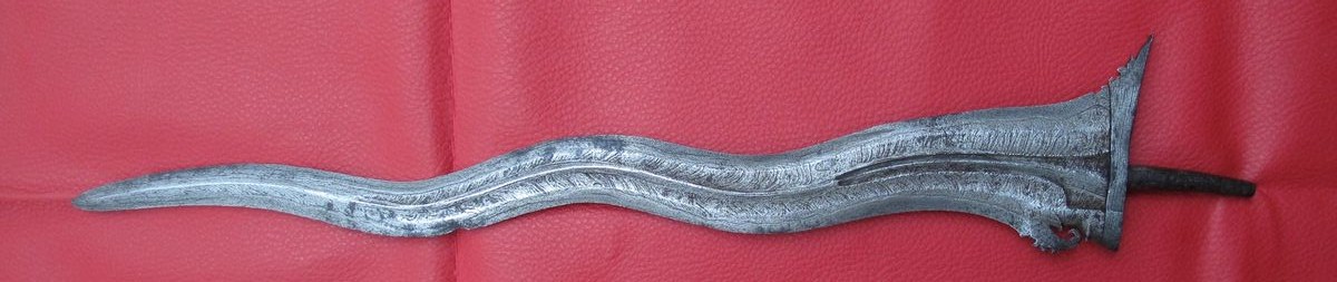

Dear Klungkung,

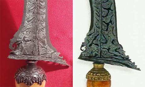

May I combine images of your interesting Sumatran keris, please? Incidentally six months ago, I was taking pictures at a keris exhibition at National Monument (Monas), Jakarta, a Bugis keris with beautiful largangsir pamor too. I was reminded of this Bugis keris, when you upload similar pamor of your keris panjang. Or at least, almost similar pamor....
Recently, I have seen quite a lot of bugis kerises with complicated types of pamor, such largangsir, blarak, etc.... Just for your comparison.

Pak Ganja,

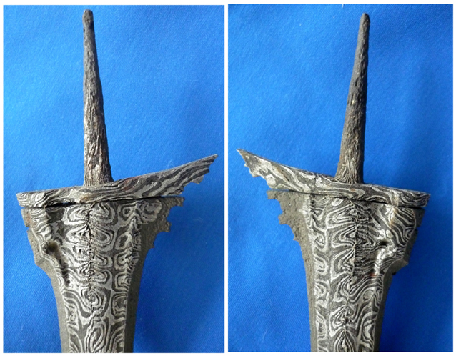

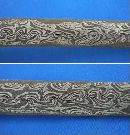

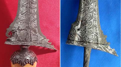

Very similar pamor pattern & iron colour indeed, from the same maker? What do you know about this Bugis kris?
According to the book Senjata Pusaka Bugis this pamor exists in Sulawesi and is locally called Tebba Bunga and I have one old blade with this pamor, see pictures before and after warangan.

Default Polojiwa
Dear Gustav,
You are right, the same blade as shown on the page you mentioned. But not all the kerises shown, are old samples. But the two special ones, "Pejanggik-Gowa I" and "Pejanggik-Gowa II" of course they are the very special heritage. Not comparable to this one....

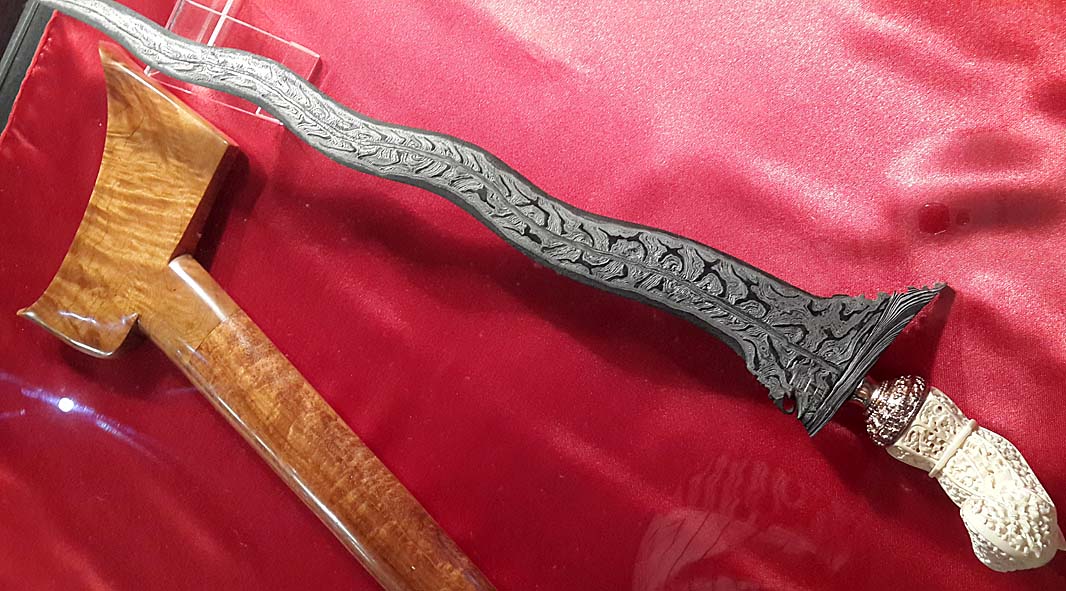

I took this picture at Monument Nasional, Jakarta last year. A "polojiwa" (three luks) of 'tebbabunga' (largangsir) blade....
Ganjawulung

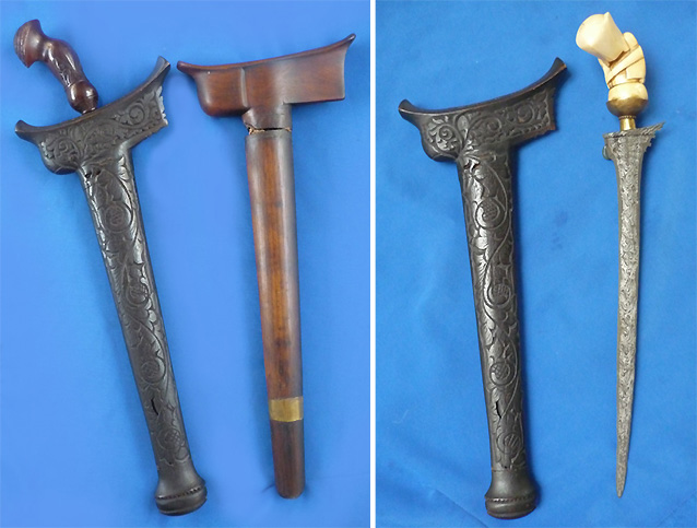

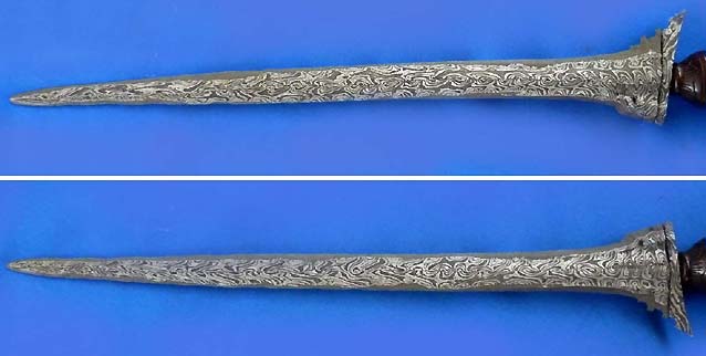

Posts: 205

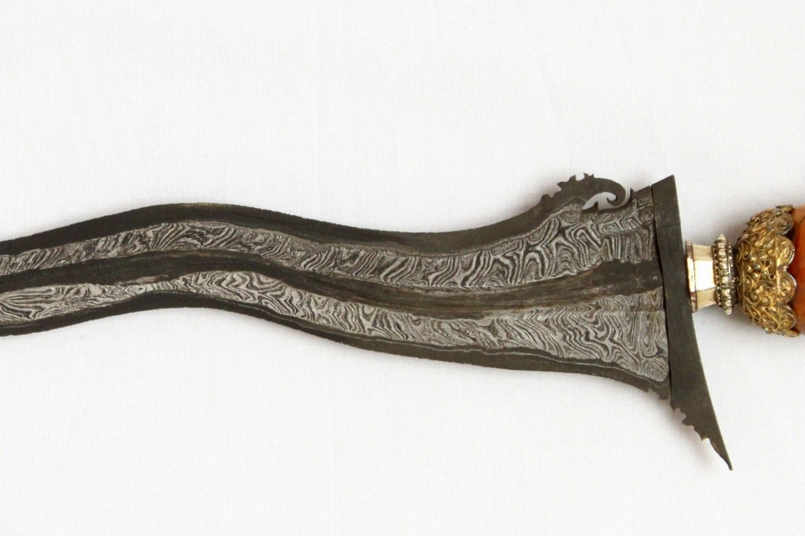

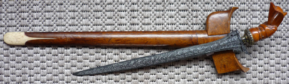

In addition to post1 I can add this quite similar keris. Remarkable resemblance.

That's a beauty Paul!
