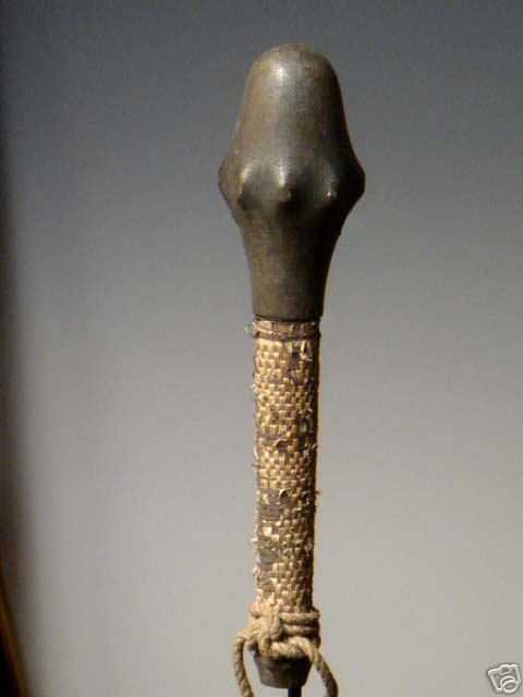

Default Solomon Islands club opinions?
This looks very nice. Does have some age.

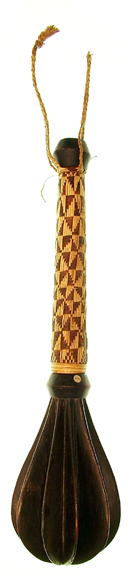

Old 9th March 2014, 07:30 PM   #3
A VERY NICE EXAMPLE AND IT DOES SHOW SOME AGE. THE ONES I HAVE SEEN ARE USUALLY ATTRIBUTED TO RENELL ISLAND IN THE SOLOMONS. ALL OF THEM I HAVE SEEN HAVE BEEN SHORT CLUBS USUALLY AROUND 15 INCHES GIVE OR TAKE. I DON'T KNOW IF THIS IS AN ANCIENT FORM OR POST WW2 OR IF IT IS CEREMONIAL IN NATURE OR FOR WAR USE. I THINK THE BLADED HEAD IS A MORE MODERN FORM AND THUS CEREMONIAL BUT THATS JUST MY OPINION NOT SOMETHING BASED ON RESEARCH. NO MATTER A VERY ATTRACTIVE FORM EVERYONE WHO LIKES CLUBS SHOULD HAVE ONE.
RECENT MADE ONES SHOW UP ON EBAY SO I THINK THEY ARE STILL BEING MADE FOR THOSE WHO TRAVEL. YOUR EXAMPLE IS OLDER THAN WHAT I USUALLY SEE. A FEW EXAMPLES OF SIMULAR FORMS OF SHORT CLUBS FROM THE AREA.
#1. A 11 IN. RENNEL ISLAND CLUB OLD FORM
#2. 36 CM. L. SAID TO BE 1930'S
#3. 44 CM. l. MILNE BAY AREA
#4. RENNEL. IS. SOLOMON IS. RECENT MANUFACTURE
#5. #6, #7, 45 CM. SOLOMON IS.
#8. SOLOMON IS. WW2
#9. SOLOMON IS.

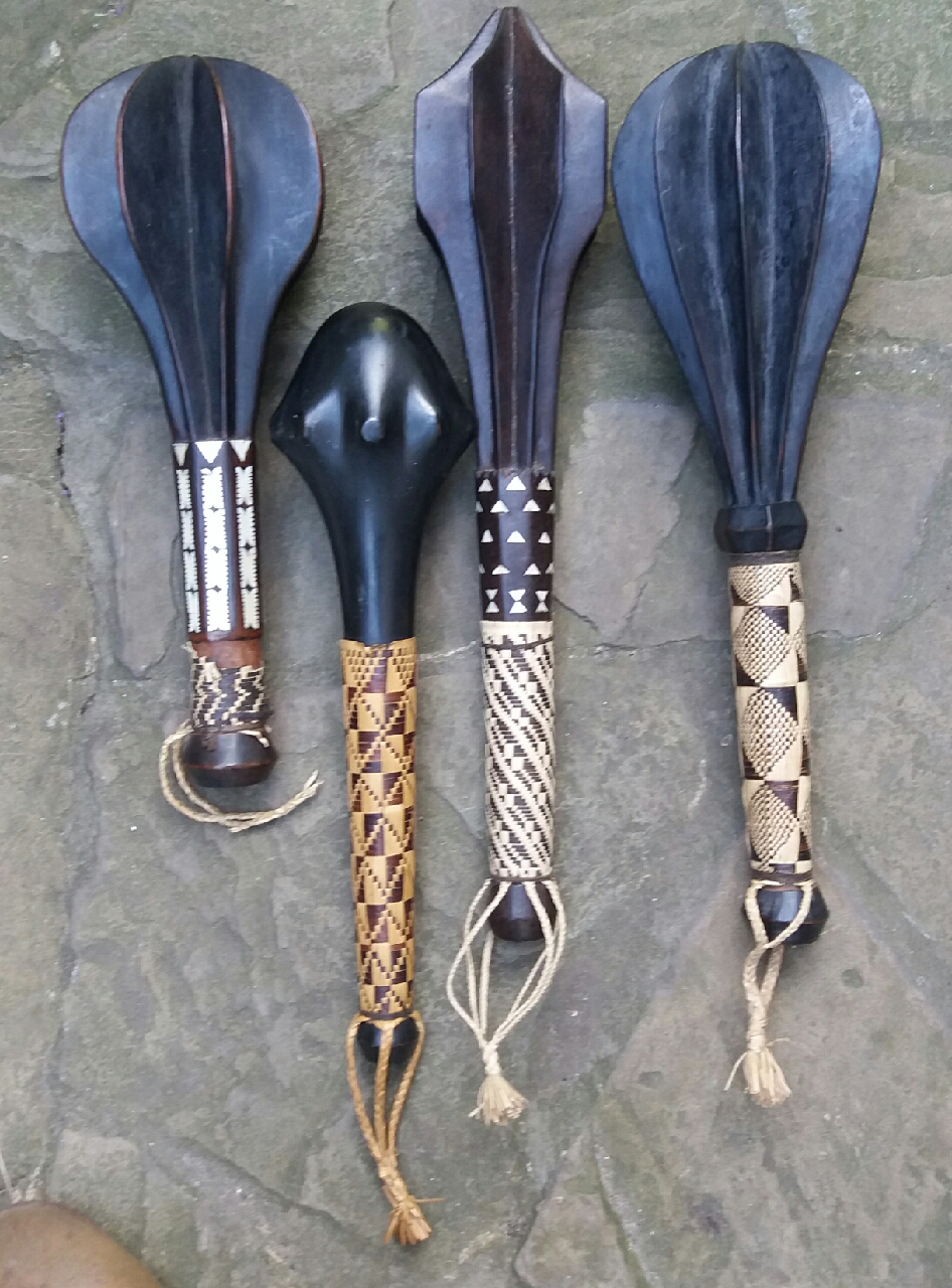

Posts: 5,998

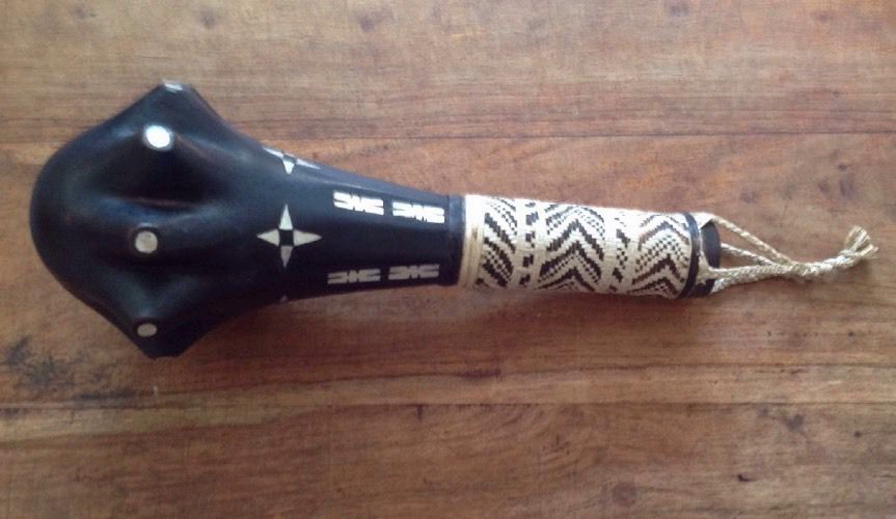

Thank you, it is rather eye catching. I have to wait for arrival. In the meantime I have made a rough picture percentage size difference with one I already have, 47cm long and 37cm long. Although shorter, the new one is more chunky and about the same weight 1kg+ I could believe them both to be from around the first quarter of the 20th century. If items are well curated they could be possibly be earlier. When I have it I shall continue with more follow up information.
Old 17th March 2014, 07:24 PM   #5
Posts: 5,998

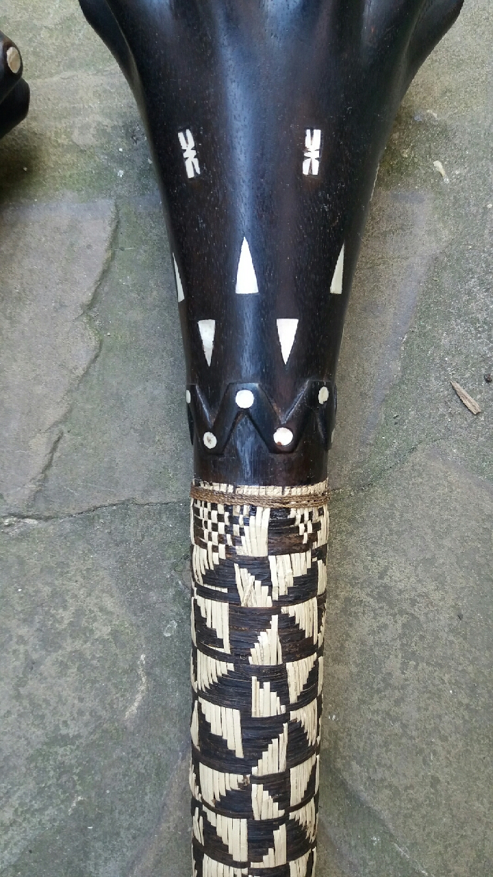

It is here and I have to say it is quite nice. It has excellent balance in the hand. Much better than the larger item in the earlier thread, which is 130 g heavier being 1.092 kg
It has good age but some damage to the grip which is a real shame. If one was of a mind too, this could be sorted in some way. I am adding some information only snippets but enlightening. The figure carvings are added to show contrast between the new and traditional styles. The postcard is circa 1910. Headhunting ended around 1900. The decline in value of traditional culture meant some decline in artworks and the development of others. No long relevant much traditional artwork, along with new tourist market productions was sold to help fund missions and other projects. All these pictures {basic I know but lets keep it simple} have come from " Melanesia Art and encounter, the British museum" The black and white diagram relates to the axe in the afore mentioned publication and my new club. Also the picture of a chief, perhaps small Solomon clubs are not all made for suitcases.

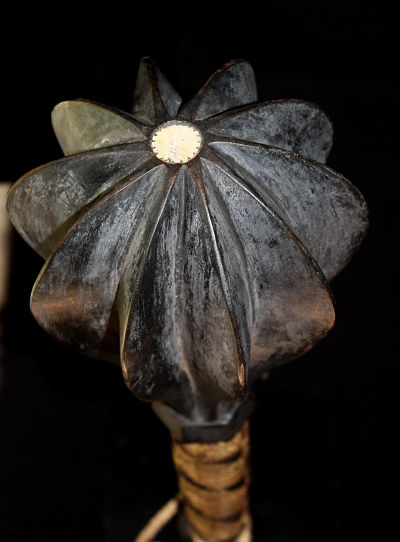

I WISH THERE WERE TABLE TOP SALES LIKE THAT AROUND HERE. TWO VERY NICE EXAMPLES OF THE FORM. CONGRADULATIONS. I RESIZED A PICTURE OF THE CLUB TOP WITH INLAY OF A CLUB PICTURED PREVIOUSLY IT LOOKS A LOT LIKE YOUR LARGER EXAMPLE.

I do not know how significant it may be but the mother of pearl pattern on the handle of my clubs does correspond to the earlier ritual pattern form shown in the diagram in previous post. That and the apparent age of the club makes me rather hopeful that it is indeed a cultural artifact. The account of the Malaita Massacre 1927,

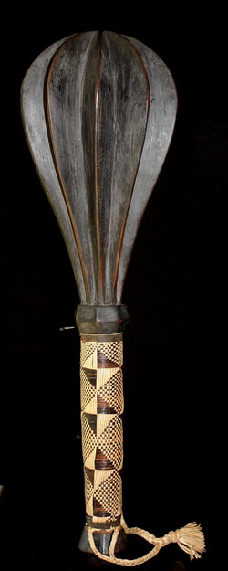

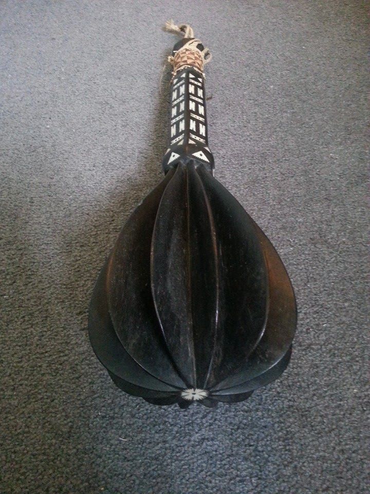

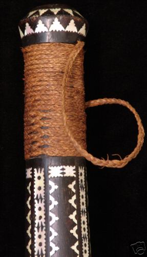

HI TIM,HERE IS MINE FROM THE RENNEL ISLANDS
KIND REGARDS RAJESH

Very nice and appear to have some age. There is a big difference between these and the modern tourist clubs. When I get home I can show the difference by examples.

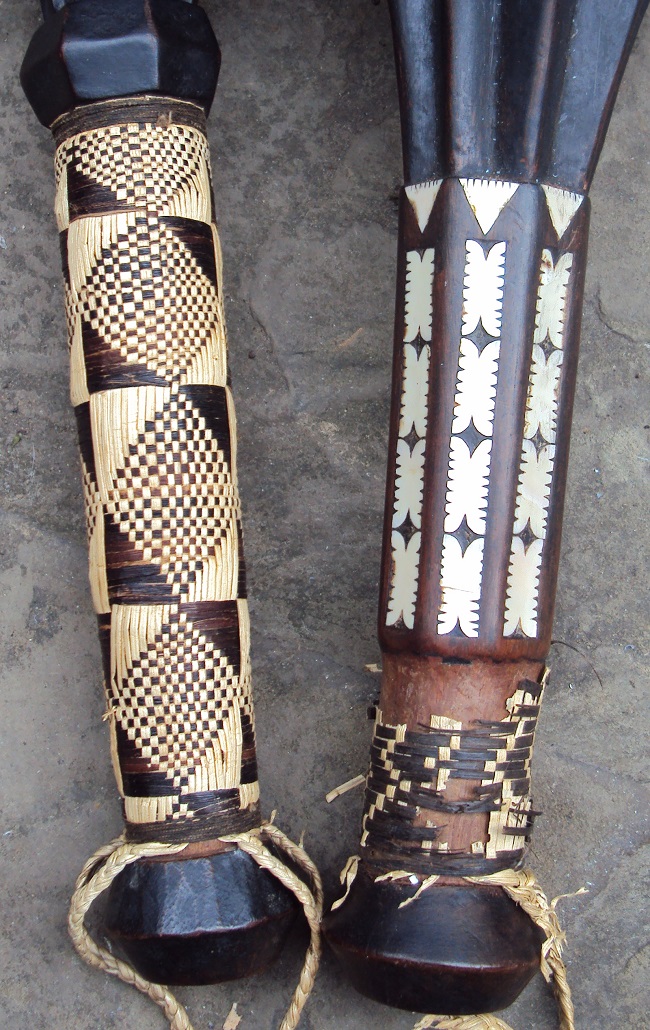

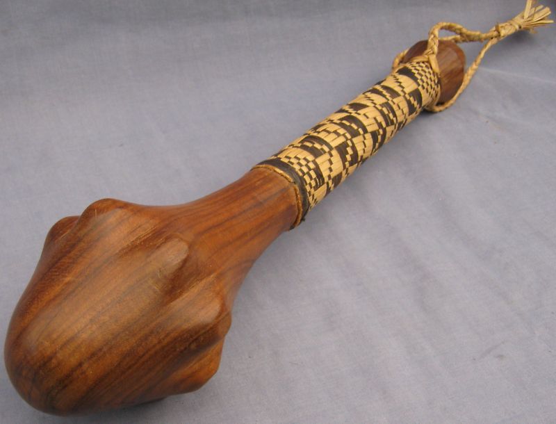

The difference between the right kind be that fighting or ceremonial clubs and tourist souvenir versions is plian to see here. The vine weave is a different colour that one might think looks old.

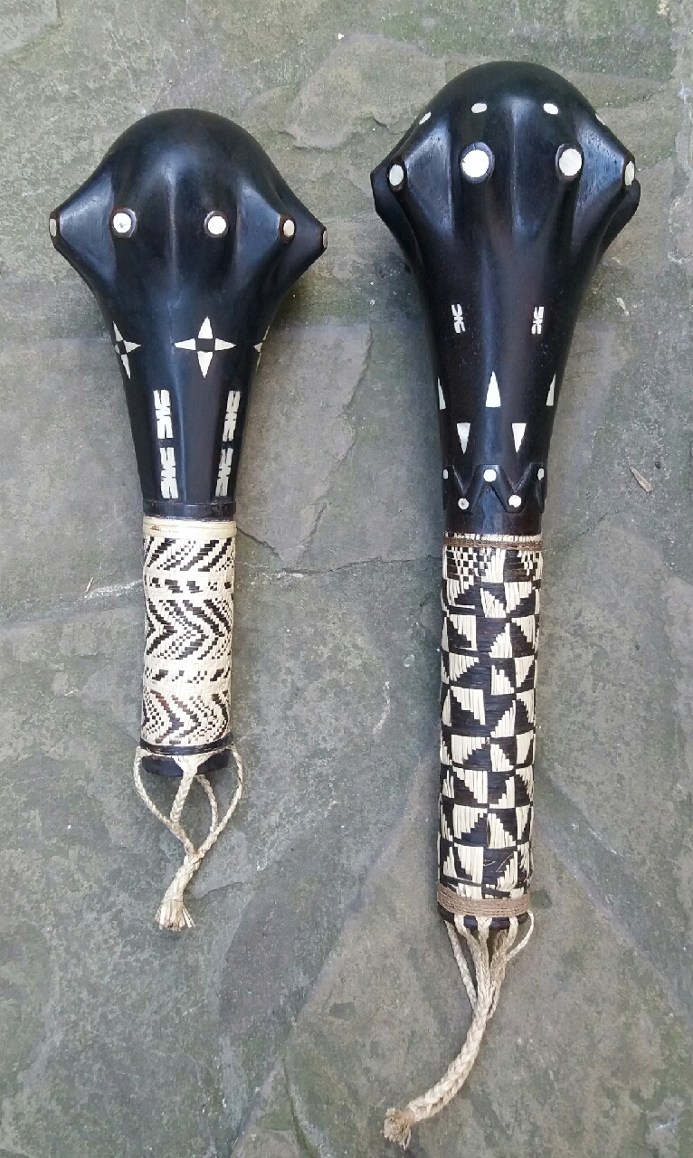

Two more add to the collection probably not the oldest, however the same dimensions as these two posted earlier.

Tim Nice picture,looks like a fishing spear.Please could you roughly tell me age of my club,thanks Rajesh

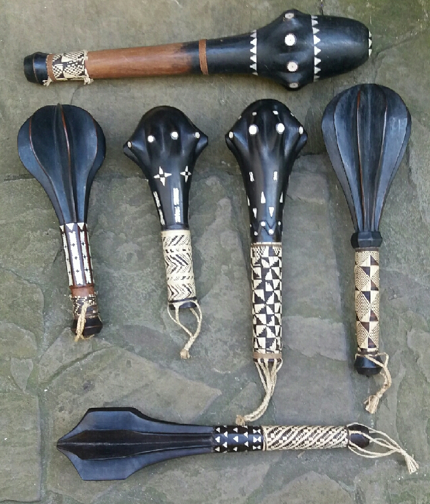

Rajesh, I would not like to say a definite age for your or my clubs of this type. The two new acquisitions of mine do have some age and patina. I have smeared mucilage glue on the top binding of the larger example as it was very fragile. I do not think it too optimistic to suggest a date of 1930s but that does not mean they are quite possibly older? around the first two decades of the 20th century. The biggest cultural changes are after the 40s. I must say I like your club very much with 12 fins, mine has 10 on the big one and 8 on the smaller club, fin envy. I am showing the new pieces against the tourist piece for comparison. They are multiplying . There seems a mix of styles, note the handle ends, perhaps from different Islands? even variations from the same Island?

Am learning a lot from you in this thread,my Club came into New Zealand in early 70s from the Solomons .This man had lived and travelled to many countrys in Micronesia and Polynesia as he was a Captain of a private yacht for a Rich man .I bought some ethnic items from him including this lovely Club .Best Regards Rajesh
