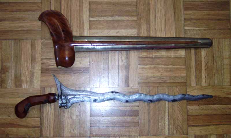

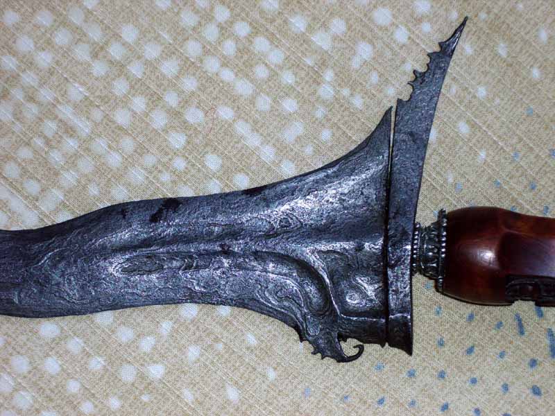

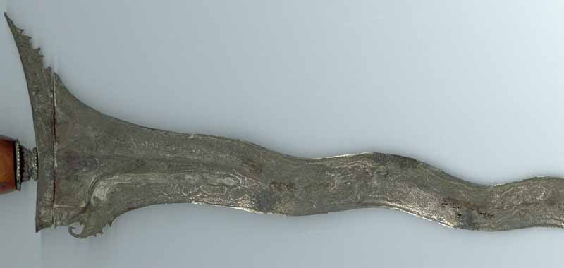

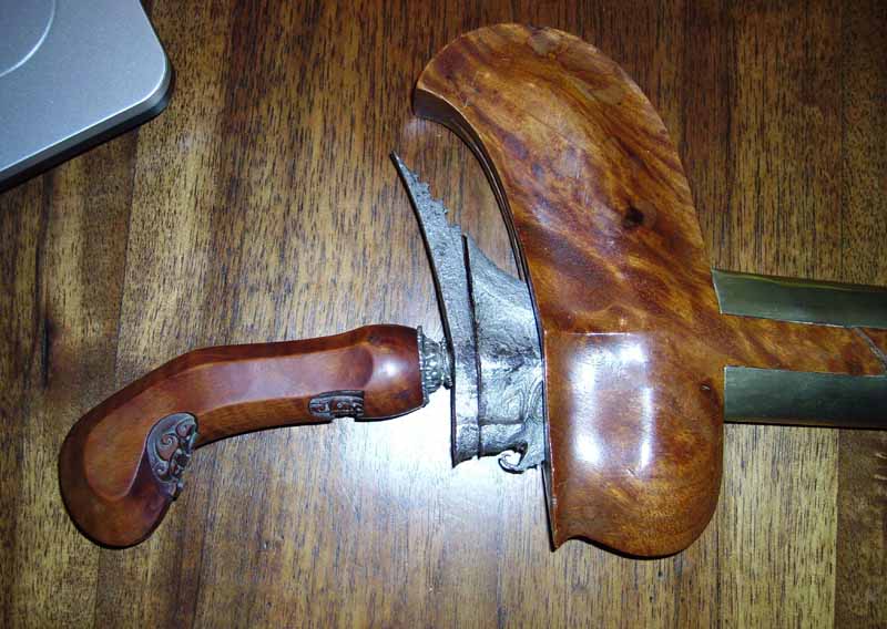

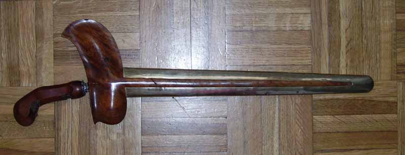

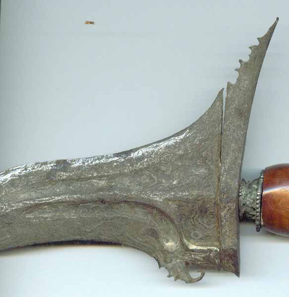

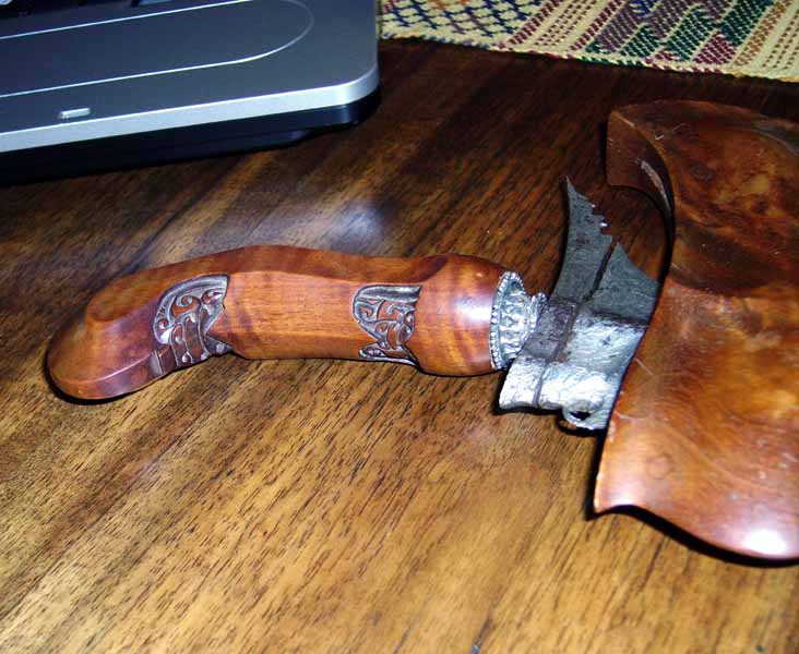

Hi all. I have just got this keris from a swap with a very respectable member of this forum. This is my first keris and i like it very much.
Now, the keris doesn't show rust but the blade is quite opaque. I have already read other threads on how to clean keris (also in old forum), but now i want to ask you if is it so wrong to use iron wool on keris with oil (like i usually use on african weapons). The first two pics show the blade of my keris, the others show how i'd like that my blade was (the third and the fourth one are taken from another thread and is a Lew's keris {sorry Lew }). Thank you

Flavio
I use #0000 steel wool to remove any loose rust.
Poor, poor Flavio, there is no going back now. You are a kerisoholic!

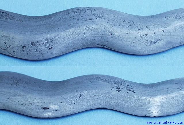

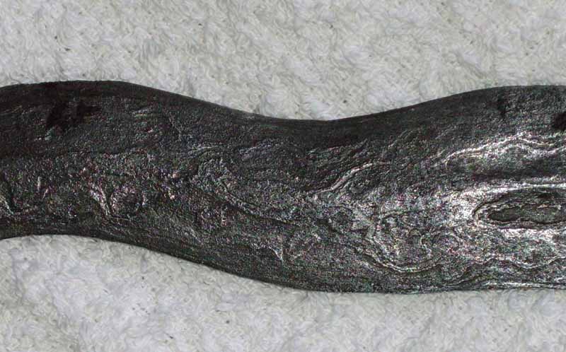

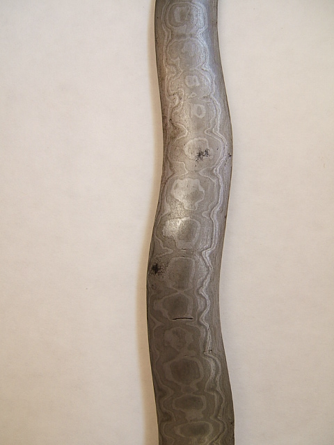

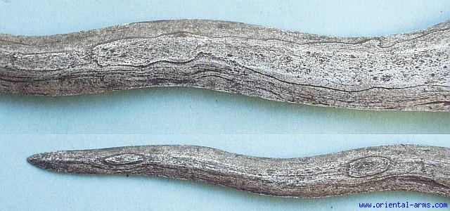

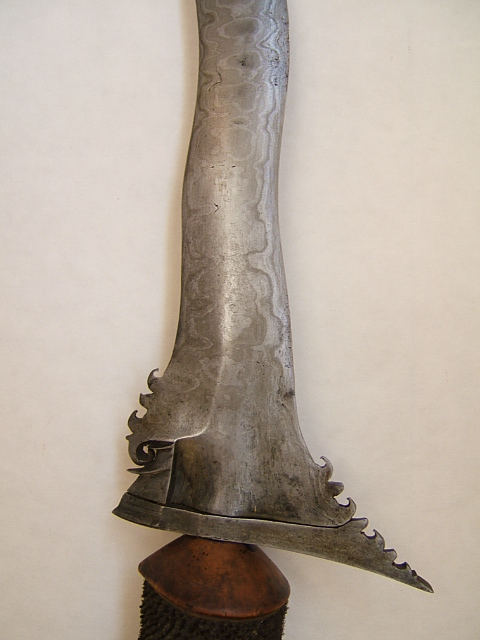

About this keris and how you would like to see it. I think it is very important that you understand that the 3rd and 4th examples (and possible the 5th and 6th as well) are Balinese keris while yours appears to be of the Javanese variety. The smooth finish on the Balinese keris is tradition to keris from this island, but it is NOT presently the style of finish on Javanese blades which generally have a deeper etch with a rougher finish. So i wouldn't think to much about trying to make you Jawa keris look like Lew's Bali Keris.
That being said, i agree with Lew that a #0000 steel wool is not likely to do damage to your keris and may help loosen some dirt and rust from it. You might also try soaking it in pineapple juice for a few days with a frequent brushing over with a toothbrush.
Hi,
Nice keris, Flavio. Congrat. !
To remove the rust and clean the keris, you can use the Coconut water. Get the ripe coconut. Put your keris into coconut water then waiting for 1-2 days. It can take 3-4 days too, dependt with the rust which patched at the blade. Cleaning the blade with shoap every 6 hours.The rust will remove and you will get the pamor pattern.

Flavio, what the coconut water and the pineapple juice will do that the stell wool never can is to actually etch your keris to help bring out the pamor pattern. Then, if you are adventurous, you can try applying arsenic and lime juice to darken the iron further and allow the pamor material to really stand out. None of that is capable with steel wool, which will merely help to remove some of the dirt.

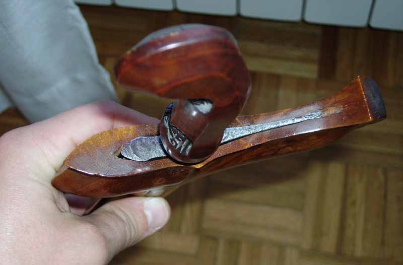

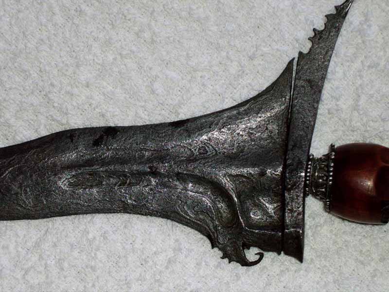

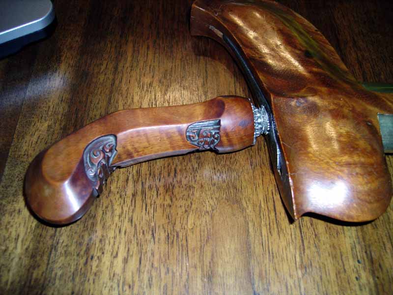

This is the keris cleaning.
Well, I have studied a little, tell me if i'm right or completely wrong
Dapur: Carita (11 luk)
Urikan: Solo Yudo Winatan
Gayaman: Yava solo
Pendok: Lewehan or Slorok (Yogya)
Pamor: (maybe) Kulit Semangka
So the keris would have to be Javanese (as necheshalready told me).
Sorry if i wrote some stupid things.

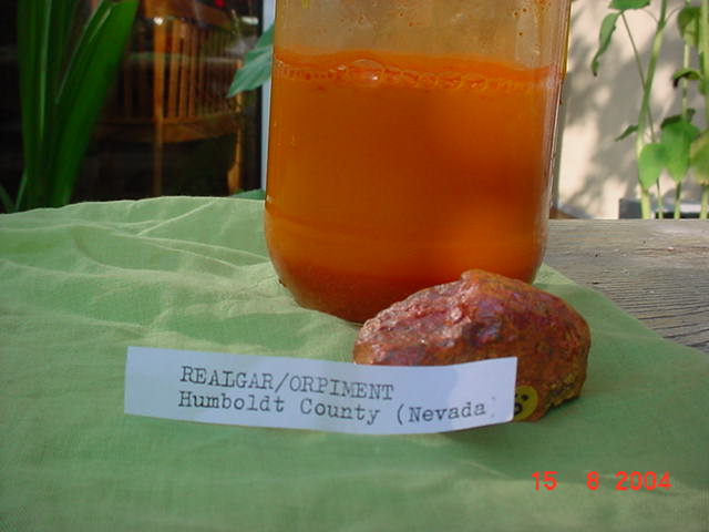

Hi guys, about the arsenic thing...where to find them?Tried to search at D.I.Y shop they don't know a thing.

Default hard to get but not impossible
Because its a poison its very hard to find indeed. You could try a different way: At a mineral / stones selling (saw it lately on ebay too): buy Realgar ; This(orange colored) Mineral stone contains arsenic. You have to pulverice it and make a mix with lemon juice.
Patience is needed, cause you 'll have to wait for about a month to let the arsenic kristalise with the lemon.
The mixture needs the sun as kathalysator; A nice sunny day.
...Always be carefull, only use outdoor, with protection of gloves and something for your mouth.
