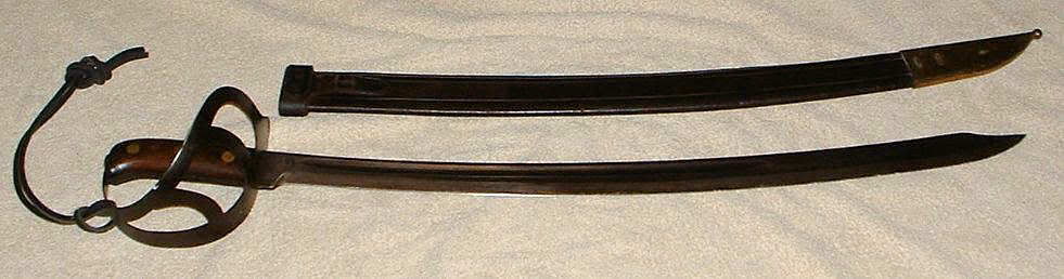

Posts: 9,573
Here some new pictures of my Timor sword. There is a marking "Hembrug" on the blade. I have acquired this sword some years ago via ebay, see the link in up. When I get this sword the marking was covered by rust, so I think it's an original marking. But sadly nothing else is known about it's provenance but I don't have doubts about it's originality.
Old 16th February 2014, 09:12 PM   #9
Posts: 9,573
Just get the information from a member that a Hembrug blade isn't a VOC blade, so my sword don't add any information to this thread. VOC blades are much older as this Hembrug blade. Sorry for any confusion!

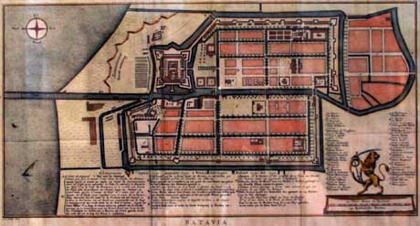

Before we are looking and discussing at the VOC stamps on swordblades, it might be usefull to look on what other items these marks are found.
I've added some images: A VOC latern, dated between 1700-1800; A longgun with the VOC stamp of Amsterdam, dated between 1725-1798; A pistol, dated around 1780, with stamp VOC IH or HI; A VOC canon, stamped VOC A, dated 1667; A lawchair used in Ambon in 1709, with VOC A stamp and date 1709; on VOC coins; Chest with VOC and date 1728 at the back; On boxes, like we can see at the drawing ca. 1770 of a Chinese trading store; On little boxes as seen on a drawing of a cabin on a VOC ship, dated 1785-1786.
PS.: all are from a Dutch museum, and not from some kind of private collections!

Salaams Maurice.. Great pictures like yours are a pleasure to see on thread.. and underpins an awful lot of research and interest... thank you. I note several points which you will probably be aware of ... The wonderful Dutch Chest which we see several similar in Oman...and the box containers marked VOC with A over the top meaning Amsterdam. The odd dish hanging on the doctors ships cabin wall being for shaving thus the shape and oriental floral design from the Dutch Chinese or Japanese connnections.... Batavia meaning the present day Jakarta marked on the coinage.
The early example of a lion with sword carved into the chair is "interesting."
Ibrahiim al Balooshi.
