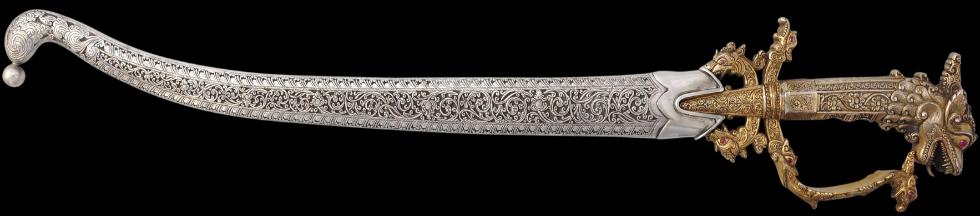

Salaams Jim ~ What a splendid idea to open this thread. You questions are very interesting and echo your final paragraph which I certainly endorse.
I wondered what the best way would be to enter this particular discussion and have decided that people may better get a grasp of the broad time-span by focusing on the three invading countries presence in reverse order i.e. The British, Dutch and Portuguese periods.
One aspect of all three periods is in fact The Kastane ...worn by one particular group of Sri Lankan dignitaries in what was practically a development of the landed gentry..an upper class Caste almost; The Mudalyars. I refer Forum to http://karava.org/other/mudaliyars for in depth detail on the subject and further reading;
Quote''Mudaliyars
Mudaliyar is a South Indian and Tamil name for ‘first’ and a person endowed with wealth. References to the traditional Mudalis of Sri Lanka are to be found in historical literature such as the Rajavaliya, Mukkara Hatana and also Portuguese and Dutch colonial records. In feudal Sri Lanka Mudali was a military title and as such was borne only by the Kshatriya warrior caste. They were royal military officials.
The 18th century Dutch rulers appointed a few migrant Tamil Vellalas as Mudaliyars . The British who succeeded the Dutch appointed large numbers of Mudaliyars from several castes and communities in the 19th century by enlisting natives who were most likely to serve the British masters with utmost loyalty. Most of them eventually formed a caste identity called Govigama and created an interlinked family network. They called themselves Hamus and their homes Walauvas.
This class resembled English country squires, complete with large land grants from the British, residences of unprecedented scale (Referred to by the Tamil word Walauu or Walvoo) and British granted native titles - which their descendants now use as surnames. They had a uniform consisting of a Somana cloth, a long coat with decorative buttons, a sash and a short ceremonial sword called Kasthana (a corruption of 'Katana' a type of Japanese sword blade)"Unquote.
(An interesting last comment but one which is generally not agreed with here.)
Here below is a Mudalyars Kastane and a series of men given the tittle..shown wearing the weapon.
Ibrahiim al Balooshi.

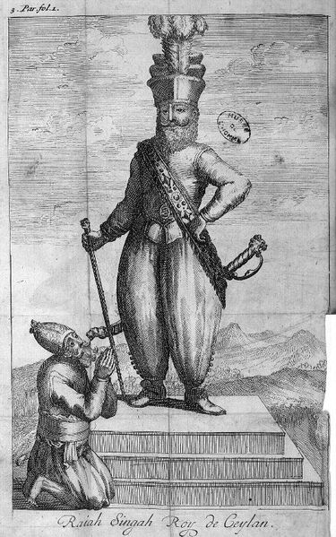

Salaams all Note to Library;
A vast amount exists pertinent to Royal Workshops at;
http://www.craftrevival.org/Extralin...ageCode=P00014
http://www.craftrevival.org/CraftArt...aftCode=003531
This description below from http://members.tripod.com/~images_of_ceylon/arms.html struck me as pertinent though there are many others and it is important to realize that dragon may mean Gargoyle, Lion, Deity or anything conjured up broadly related...
For another superb example of a described and illustrated blade please see http://www.caravanacollection.com/?p...kasthane-sword not shown here.
Kastana (or Kasthane) http://members.tripod.com/~images_of_ceylon/arms.html
Quote''The national sword of Ceylon. Typically a short curved single-edged watered blade, double-edged at the point. The hilt comprises a knuckle-guard and down-turned quillons, each terminating in a dragon's head with large in-set eyes. The dragon's head is usually decorated throughout with gold or silver panels and the pommel with tongue is formed from a piece of wood or red coral. The dragon's mane trails down the grip and is decorated with silver and gilt repousse floral designs. The entire hilt is often made of silver or gold and even inlaid with jewels. The blade close to the hilt is decorated with floral or thatched designs. The scabbard is made from wood and is covered with embossed and chased silver worked with flowers with leafy borders and richly ornamental.
The swords were intended to serve as badges of rank. Rev. James Cordiner in 1807 wrote that everyone in office wears a sword with a silver hilt and scabbard. These swords were made in the Royal workshops known as the "Rankadu Pattala" or "golden sword workshop" and the quality of the piece always depended on the rank of the wearer."Unquote.
Thus positive evidence supporting the theory about badge of rank status of this weapon coupled with the Mudaliyar detail in the previous post linking back through the 3 separate invading groups. It is however quite tantalizing that pre-Portuguese history continues to beckon since much of the detail in the Kastane is related to early religious design influence.

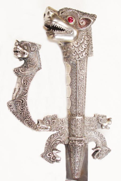

I'm not seeing the word 'Dragon' anywhere in the description given:
This especially fine kasthane has a silver pommel chiseled as a typical simha (lion) head with a prominent crest made up of an entwined liya-pata motif covered in sheet gold. A narrow, pala-peti design is around the mouth and this too has been covered in sheet gold. The gaping mouth has an orange agate or carnelian tongue that projects right out of the mouth and rows of especially sharp and naturalistically-rendered teeth. The snout on each side has a characteristic 'S' scroll. The eyes are large and distinct and comprise pink sapphires in gold mounts and with magnificently scrolled eyebrows. The ears are prominent and in leaf form.

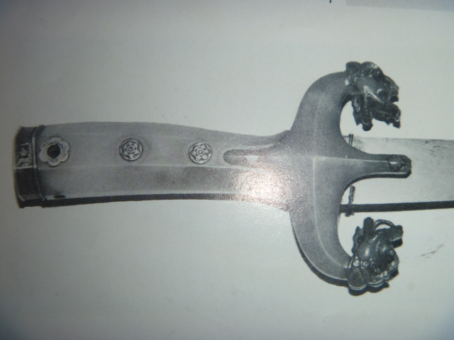

Salaams Rick No I didn't say that though the wording in my badly constructed sentence could be misleading and I have corrected the mistake thank you..I have placed the web coordinates for the Caravana item as you have written but the one I write at length about is a different quote of which there are lots...for example and by typing into web search Kastane Dragon masses of similar detail is supplied....such as:
From The Victoria and Albert Museum see http://www.vam.ac.uk/users/node/17494
Quote"Sword and sheath (kastane) with a dragon-headed pommel
Steel, chased and embossed gold sheath
Travancore, Kerala, India
19th century
Museum nos. 2573:1,2(IS)
The kastane is the national sword of Sri Lanka. It typically has a short curved single-edged blade, double-edged at the point. The hilt comprises a knuckle-guard and down-turned quillons, each terminating in a dragon's head. The swords were intended to serve as badges of rank; the quality of ornamentation depending on the status of the wearer.
The establishment of European trading contacts with South Asia by the late 16th and early 17th century led to these swords becoming fashionable dress accessories among European gentlemen. A kastane can be seen in an equestrian portrait of Colonel Alexander Popham at Littlecote House in the care of the Royal Armouries Collection.''Unquote
I'm not in the business of issuing edicts on whether this was a cat or a lizard, a lion or a Makara since it could well be down to artistic licence and as you may know some deities morphed through several phases; The Lion even taking on Elephant form and the Makara or other deities vaulting from one design shape or imagined mythical style to another and at best very easily confused with each other. I leave that with the experts!
One part of the design I did like was the humano/crocodile face on the handguard...most peculiar! Perhaps we can address design features as we progress..and many thanks for the question about the dragon.

This description struck me as pertinent though there are many others and it is important to realize that dragon may mean Gargoyle, Lion, Deity or anything conjured up broadly related…for another superb example of a described and illustrated blade please see http://www.caravanacollection.com/?p...kasthane-sword
Well, i can see why Rick might have been confused by your post Ibrahiim. You write "This description struck me as pertinent…." and then end that sentence with a link before quoting from a completely different source which you do not credit. While i do not wish to imply that you were being purposefully deceptive here i do hope you can see how this might seem misleading to some.
It should also seem obvious that simply because one can find numerous references to the kastane hilt as a "dragon" does not in anyway prove that ANY of these hilts were ever intended to be dragons or anything other than a lion. How many times misinformation is repeated on the internet does not in turn make these misinterpreted statements "facts" and they cannot really be used to support any theory that the pommels of kastanes are meant to represent anything other than a lion. Even one of your "dragon" descriptions goes into detail about the mane of the "dragon", not a detail usually ascribed to dragons throughout various cultures. The stylized manes on these creatures should be a clue that these are indeed lions being depicted on these pommels. Certainly there is some "artist license" involved in the depiction of the lion which is proofed out by the variants that we find in existence, but i seriously doubt that court artists would be permitted to change the actual symbolism of the hilt by depicting some completely different creature than what is traditionally designated for the form. I have yet to see a true kastane pommel that cannot clearly be seen to be meant as a stylized lion head.
Old 5th February 2014, 08:50 PM   #7
Ibrahiim al Balooshi's Avatar
Posts: 4,408
Salaams David, Certainly no deception on my behalf. I simply illustrate that learned bodies such as The Victoria and Albert describe the hilt in different ways and it is not my intention to go into why they think a dragon has a mane.. After all you may view the hilt as a lion like shape but many other specialists use a different explanation including prestigious museums etc.
As I also point out I prefer to leave the discussion about Lion or whatever else it may be to the experts unless you know for certain that it is created from a Lion..and when such an interesting side topic exists as yet to be unfurled as we analyse the pre Portuguese period and look into the swords historical and religious influences.
What is also interesting about Ricks quote from Caravana is the part that is missing .. The Bibliography... which mentions a certain king whose Kastane is now in museum in Sri Lanka but which is unclear as to which king?... and that turns out to be the 7th in succession in power; at the same time as the Portuguese early period. http://www.rootsweb.ancestry.com/~lkawgw/gen3000.html King Bhuvanaikabahu the 7th.
I do, however, agree that my sentence structure was open to misinterpretation and I have corrected that mistake and though I had lost the reference I have now checked my notes, discovered the reference and placed the quote correctly using as close a professional structure as I can; I think near enough to the Harvard Referencing system as we need apply.

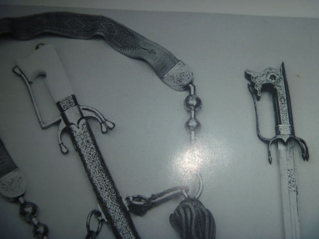

Salaams David, The specific parameters of this thread are indeed outlined at #1 and in each of the three categories of recommended study,(Its Development, Decoration and Symbolism) the design features are dominant.
Naturally when viewing the key area of early European involvement it is important to realise that there are three prisms to look through ... one for each invading nation. Getting beyond the 16th C is in itself wrought with inconsistency not least because of the socio-political nature of the beast.(excuse pun)
The Lion Makara debate has been modified; replaced by a more carefully considered, balanced overview and in sympathy with the religious and cultural traditions of Sri Lanka. The fact is we don't know what form the artists were considering at the time nor whether the artists were working alone or with Portuguese artisans on these Kastane. Can you say that it is a Lion? Can you say you are sure what the artisans were doing in the Kotte Royal Workshops 500 years ago? If so, please do prove it.
It may be noted that simply viewing the hilt from the western ideal of Zoomorphic fails to address the full story since some of the Deities are half humanoid; take for example the little face on the hand guard (half human half crocodile at #2 above) thus they take the form more of the demi-god..though that is also a generalization and since many of the deities transform, change and re enter the equation as a completely different monster type... depending upon what phase they are depicting.
Another half humanoid monster "Kirtimukha" sometimes decorates the Kastane Rainguard see http://www.vikingsword.com/vb/showth...=indian+armour at #56.
Nevertheless the in-depth study of pre 1505 AD Portuguese involvement has yet to be administered on this thread but research and notes are well in hand. What form the hilt actually is may be impossible to absolutely determine but eventually this may be part of the intrigue and only really possible with the insight of some Guru and historical master specializing in Buddhist/ Hindu religious expression.

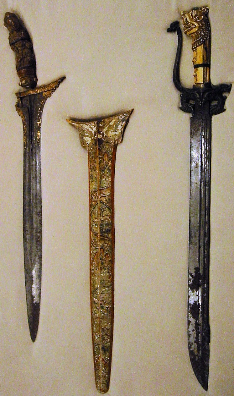

The Sendai (Hasekura) example (Keicho Mission) for Date Masamune of Japan has proven most interesting with the question of exactly where it was obtained by Hasekura. While it was speculated that this sword was acquired from Philip III of Spain while the mission was in Madrid, it is now my understanding that this was probably acquired in the Philippines in the two years Hasekura was there. Rather than being a 'presented' item, this seems to have been more an acquired item along with the kris with it. This seems more in line with the lack of documented narrative concerning these items.

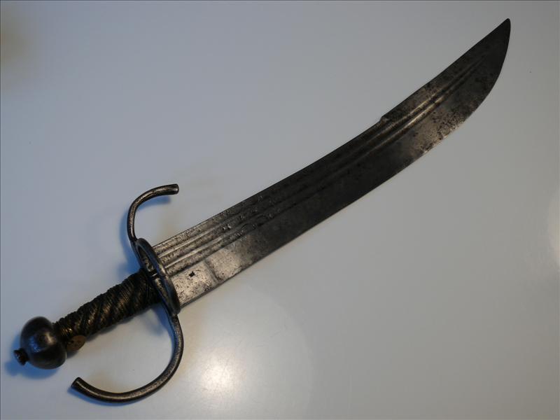

The questions which intrigue me on this particular kastane are more toward the interesting blade, of somewhat falchion form and with the 'monster' head at the blade peak which indeed does correspond to similar creature detail on a glaive type Chinese blade posted by Vandoo. We know of course that the Philippines as a trade entrepot had presence from Sri Lanka, China, Indonesia and of course the major powers .
Could this kastane have been mounted with this blade in the Philippines and been acquired by Hasekura as an interesting novelty to present to the Date?
These are the questions I hope to follow here. The dialogue on the artistic representation on kastane hilts is always interesting, but I think that its subjective nature often creates a certain volatility. Just the same, these figures are of course an integral part of the history of this weapon, and should be approached with a great deal of patience as differing views are examined.

There is an interesting background description to the Kris at forum on http://www.vikingsword.com/vb/showth...t=kris+kastane by A.G. MAISEY that is essential background reading and from which I have recovered the picture below.
Wikepedia carries the same artwork and under it states that they were "acquired" from The Philippines. Please see http://en.wikipedia.org/wiki/Hasekura_Tsunenaga
See also http://www.japanartsandcrafts.com/8212.html Indonesian kris and Ceylonese dagger (acquired in the Philippines), presented by Hasekura to Date Masamune upon his return;

Readers may wish to update on the epic voyage of Hasekura Tsunenaga at http://en.wikipedia.org/wiki/Hasekura_Tsunenaga with particular reference to weapons (see my previous post) he presented to Date Masamune, the Daimyo of Sendai on his return to Japan one of which forms one of the earliest Kastane preserved today...in the Sendai Museum in Japan.
Using the finest library on Ethnographic weapons, (our own) and web searches; No proof seems to exist that these two weapons were either obtained together or that they were presented, however, some persuasive detail exists already detailed at my previous post that they may have been procured in the Philipinnes. In addition, logically, had they been presented by King Philip III would there not have been more exacting supporting evidence?
The blade appears similar to a Storta and naturally therefor similar to the Falschion yet also rather similar to the Chinese form...and what is more ...the fullers are remarkably like Chinese style as shown in the spear head and fullers below .The monster at the blade tip is very much in the style Makara as shown in the attending Makara detail..for comparison.
* What blade style is this and how did it arrive in the Philippines??
* Is this a Kastane hilt form following in the imaginative mythical and stylistic Lion design with accompanying Deities over a typical Kastane hilt formed around a hand and cross guard with "apparent" quillons in the Vajra style and the remains of a Vee shaped rainguard?
* Why is it that no scabbard seems to exist?
* Could Hasekura Tsunenaga have modified his coat of arms to include a cross and have had that stamped on the Kastane (hybrid) blade? (He was, after all, converted to Christianity, baptised in Spain and had a European name; "Francisco Felipe Faxicura.")
Old 7th February 2014, 06:42 PM   #15
Posts: 10,872
Excellent Ibrahiim!!! I had overlooked that letter of 1619 and its content, which of course mentions Hasekura 'shopping' (the letter now in Sendai Museum) and is on display with the kris and Ceylonese 'dagger' (actually a kastane). While we assume these were acquired in the Philippines, there is as yet no supporting narrative to accurately provide that provenance.
We note the curious blade of the kastane and the mythical beast feature and its remarkable similarity to Chinese weapons and such features. While we remain compelled to consider the acquisition point of this kastane to be the Philippines, that would seem to favor those regions with the strong trade presence of China there. Naturally many other regions are represented there as well.
The hilt style does seem to correspond to those of the kastane of course, but the blade is remarkably atypical. The scabbards on many forms of edged weapons in these regions seem less than durable in most cases, and these arms are often refurbished with new scabbards many times in their working lives. The fact that this one does not come with a scabbard en suite would suggest to me that it is less than a 'presentation' weapon, and far more likely to have been 'acquired'.
If the kastane and the kris were sent back to Japan prior to Hasekura's return and with a letter to his son, perhaps these items were at that point simply novelties meant for his son or his own keeping. The portrait of the Pope does not seem included in that transport back to Japan precluding his return, so it would seem that was specifically intended for Date Masemune
These edged weapons on the other hand, acquisitions seemingly less than presentation grade, were perhaps included as second thought to Date along with the portrait.
These circumstances might better facilitate the idea that perhaps Hasekura might indeed have adopted a heraldic arms in European style to reflect his status as a baptized Christian, which was of course powerfully important to him . It remains unclear whether these stamped devices on the blade may have been applied in this regard, but the possibility is interesting .
Returning to the broader scope of our discussion, one of the reasons for such interest in the 'Hasekura' kastane is to establish a provenance example of the kastane form hilt has been to establish a time frame for the development of the hilt style.
While there has been considerable discussion on what zoomorphic creatures are depicted in the decorative motif on these hilts, the very nature of these depictions remain quite subjective and notably debated . Naturally since the artistic license inherent in depictions of mythical creatures as well as stylistic renderings of actual ones is often profound, it is difficult to accurately analyze these figures . It does have certain importance in the possible reasons for variation or exactly what creature is represented however.
For example, and treading carefully into sensitive matters, is it possible that the lionhead (Sinha) is indeed represented on all distinctly Sinhalese examples of the kastane, and that the variants might be provenanced from other ethnic origins? Naturally I implore complete objectivity here, and offer the suggestion only as a possible accounting for the variations in style.
I do not believe that the styling of these zoomorphic hilts was directly resultant from European collaboration, however it is known that beautifully carved ivory hits were produced in Ceylon for European markets as early as 16th century. The work of these artisans certainly had considerable bearing on Europeans fascinated with the exotica of these faraway places, and I believe there was likely considerable cross diffusion in place through the colonial periods.

Salaams all ~ Note for comparison. There are several sword groups that may have influenced the Kastane design and viable evidence suggests who may have delivered similar sword forms throughout the early years and encompassing(and bracketing) the first Portuguese arrival in 1505. I turn to "Islamic Arms" by the late Anthony North for two such swords for comparisons. The vehicle for such cross pollination in styles are possibly the famous sea traders of Sri Lanka; The Moors. (see note below*)
The weapon displaying quillons with remarkably similar dragon style finials from the above "Islamic Arms" is Quote"The hilt of carved jade mounted in gold, the blade of watered steel Persian, late 15th century Topkapi Palace, Istanbul".Unquote.
The weapons known as Nimcha are equally intriguing as to potential design influence where Moroccan style may have been transmitted.

These are outstanding references Ibrahiim, and thank you for the interesting link to the online reference on the Sri Lankan Moors, which indeed adds some important perspective to understanding some of the ethnic and colonial complexity of Sri Lanka.
As you have well noted, Anthony North does address the potential influences of Venice and Northern Italy on these swords, and specifically cites the distinguished French arms historian Charles Buttin:
"...Charles Buttin, who had a considerable number of Moroccan swords in his own collection, and published a paper on them, detected a number of influences in their very individual hilts. He pointed out their similarity to the indigenous sword of Ceylon, the kastane, and discussed their relationship with European swords".
(from "Les Poignards et Les Sabres Marocains', C.Buttin, Hesperis, TomeXXVI, 1939, p.1)
In this the distinct similarities in the guard systems of the hilt are noted, and in his closing comments, North states, referring to the North African hilts, that "...at least one of the influences of these hilts-and perhaps the strongest-came from North Italy-possibly as early as the 15th century".
from "A Late 15th Century Italian Sword" , A.R.E.North, 'The Connoisseur, December , 1975, pp.238-241)
It would seem clear that the influences of Venice in their powerful trade networks almost certainly introduced their weapon forms and styling into many cultural spheres . In this case it would seem that this style hilt configuration quite likely was filtered into Sri Lanka through the Arab traders who populated the Sinhalese littoral in their ports.
The guard and quillon configuration was specifically placed on the original Italian swords to correspond to their unique style in fencing techniques and as part of the developing hand guard systems of these swords. It would seem that this quillon arrangement was adopted by Arabian and of course the North African regions noted in more of a stylistic sense.
In the case of the kastane, while the hilt form is of course stylistically similar, it has become even more vestigial in the downward quillons next to the blade, and the terminals of the guard and quillon are vehicles for the subordinate beast heads.
The identification of the key figure on the hilt, the zoomorphic on the pommel, of course remains a quandary, and it seems in most cases must be considered specifically with each example as there appear to be numerous variations. Naturally in the scope of journalistic references the pommel beast is described by authors in much variation, which seem to reflect whatever sources they may have used in their research.
In one article for example, a kastane in a news item from 2008 is described as "..an ornamental sword that was the symbol of office of the Kandyan Lords, Kings, Adigars and the Dissawas" . The head on the pommel is described as a makara, and in the photo, I must note that the creature does appear to have a snoutlike feature, very much like the architectural makara figures I have seen.
This particular article was written for the Sri Lanka Express by Emmanuel Silva (April 5, 2008) and expressed great concern for these valuable antiquities being dispersed in auctions, flea markets etc.

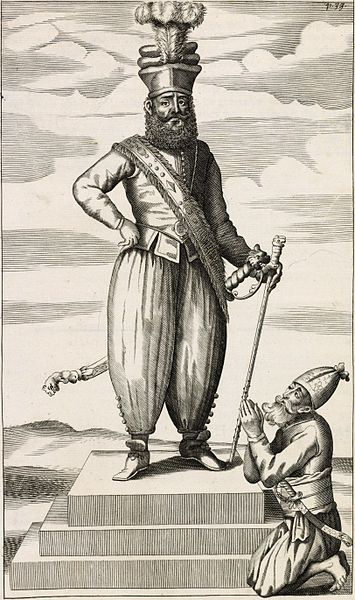

For interest below ~ Portrait of King Rajasingha II of Kandy (1608-1687) (Reign 1635 – 6 December 1687)

Salaams All... I am in more or less parallel agreement with the post above..(Thank You Jim !) indeed I find it extremely difficult to separate the design and workshop artistry involved in both Kastane and Piha Kheata in that I cannot imagine the Portuguese being involved in either... or put another way... if they were involved in one they must have had a hand in the other. The description of Royal Workshops mentions the same divisions being responsible for both weapons but no mention is alluded to Portuguese involvement in either.
Whilst some caution may be needed in viewing sketches of the period and since there are so few.. it seems the responsibility for such designs were purely down to Sri Lankan artesanship.
Where a difference evolves in the subject of the main hilt could it be that one Kingdom applied/favoured Lions and the other Makara? Perhaps it may simply be stylistic licence.
Oddly, whilst there are blade marks attributable to The Dutch (VOC) it seems there are none from the other invading powers and apparently none from the EIC though several reports speak of such marked blades.

Napoleon, I very much agree! Those out there with examples please post them, we really need to see a range of examples so that we can look more into variations in the pommels and other features.
Very good question on the attribution to certain makers or schools. As far as I have known, these were invariably unsigned and produced by artisans who combined their skills on various elements of the swords.
We know that of course, the larger number of these seem to likely be from the Kandyan workshops. However, a great deal of consideration must be made toward variations of these swords possibly produced in other parts of the island.
I believe the interpretation of the style and form of the creatures, the pommel head in particular, may reflect either sinha (lion) or makara in various instances. It is always interesting seeing descriptions and captions in either auctions, catalogs or references often using the term makara in a rather collective sense where typically the lion head is what is actually depicted .
As far as I can see, the makara has a sort of trunk or projecting snout, where the lion of course does not. Again, it is extremely hard to identify what mythical creatures are represented
Ibrahiim, I believe you are spot on in your view that the variation in interpretation of the creatures may well be due to cultural, ethnic or politically oriented circumstances.
You bring up a very good point on the blades on these kastane. It seems unclear where the early blades came from but as previously mentioned a large number of Dutch VOC blades appear to be mounted in kastanes.
These were typically marked with the VOC blademark and a date, most seem to date in the 18th century (for some reason 1760s seem prevalent).
I don't believe Ive ever seen a Portuguese blade on one of these, nor British for that matter. Naturally these would be hard to identify as the majority of blades of these types were often Solingen produced . As earlier noted the English EIC did not mark sword blades, only firearms.
