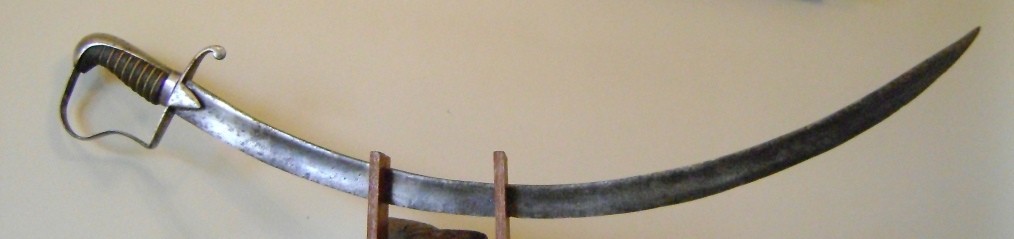

Default Cavalry sabre with a parabolic blade

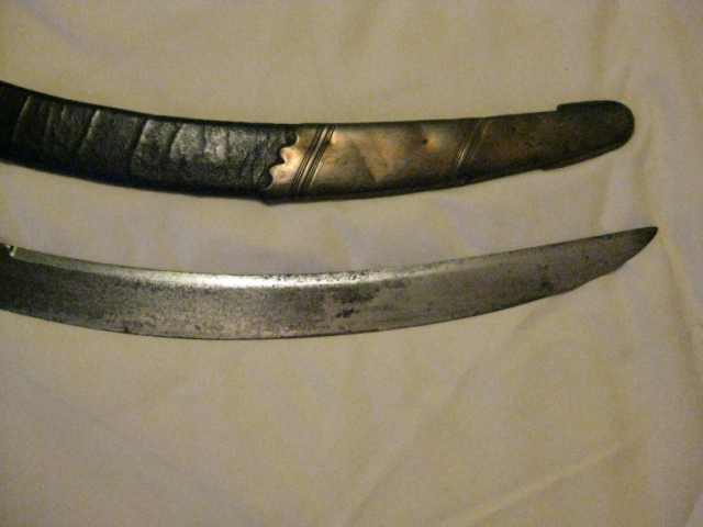

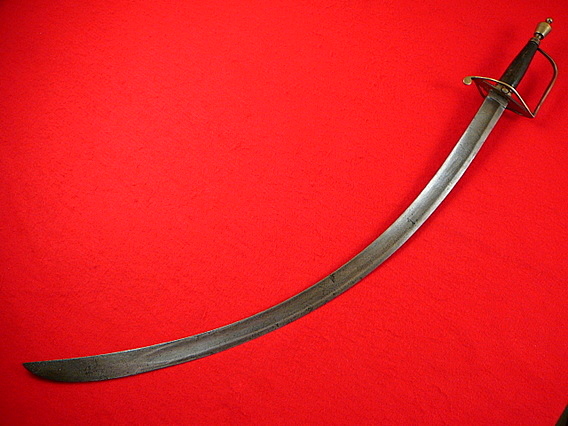

I have been chasing one of these for a couple years. Finaly i managed to convince this guy to trade the best (or less bad) of two examples he had.
Having (poorly ?) restored its grip with a new leather cover and wiring, he settled for a swap plus a few Euros.
Its blade curvature may not be the greatest out there, but is already within the not practical but exhibionist range. I wouldn't be surprised if the owner had this one for showing off in the streets and palace corridors and used a more 'reasonable' example for going into battle.
Judging by the stirrup hilt and all, this could be Portuguese, dated beg. XIX century, like from the Peninsular War period, i would risk; not an early example i know, but i had to have one of these bizarre blades in my in significant collection.
Any comments will be more than welcome.

It looks like a flankers sword to me, but not being an expert I await for the experienced guys to give their views.

Hi Nando,
I think Sirupate is spot on, as it seems flank company officers did seem to favor in many cases these deeply parabolic blades, though it seems that may have been incidental. I have seen the familiar M1803 lionhead brass hilt forms (for infantry officers but also flank company officers)with the slotted guard with these kinds of blades on occasion . I have stirrup hilt sabre with deeply parabolic blade and unusually canted hlt which has been regarded as a variant M1796 ( I will see if I can find photos).
Whether your example was originally mounted in M1796 stirrup hilt (before restoration) is unknown. However that blade does seem to be with some slight resemblance to fullering of 1796 light cav, though obviously not remotely like the hatchet point blade.
The 1790s was a most innovative period for British cavalry swords as great interest was centered on the effectiveness of various sword forms, as LeMarchant introduced the first regulation patterns in 1796. Although the M1796 light and heavy cavalry forms were pretty consistant, there were still variations as many forms of blades were considered, even one case of a M1796 light cavalry sabre with recurved yataghan type blade (carried by the commanding officer of 10th Hussars at Waterloo).
Beyond the testing and prototypes regarding the most effective blade forms (which included tulwars, kilij, and of course the European forms, some with yelman) in this period, there was also a profound obsession with military fashion. While the colorful and often somewhat dramatically overdone clothing was part of the obsession with image and status, in many cases the swords also were rather exaggerated. The fashion for some time was to have the sabre low slung so that the scabbarded sword would effectively drag along (the reason for the 'drag' fixture at the chape). This added to the 'swagger' effect along with the colorful headgear, tunics etc. I would note here that even the much fabled ' Beau Brummel' was for a time in one of the British cavalry regiments and around this time.
It seems quite possible that these considerations might have had some bearing on the use of these dramatically parabolic blades, as the deep curve does not seem to have had any particularly pragmatic reason otherwise.
So I suppose this blade may have been either a prototype in this period, or perhaps the selection of a fashion conscious young officer. I cannot say whether this might be Portuguese or British, but as you know in many cases these were closely connected.

Thanks for your comment Sirupate; and thanks for your extensive lines, Jim.
Far away from me to contradict your precious observations, but let me dare telling what i think this sword is not ... or apparently is not.
I have seen the grip before being restored; only the leather cover and wiring were added. Not objecting that the original hilt was a different one, this makes it more remote.
I wouldn't say that the blade was a 1796 one; this one lacks the sharp lines of its back, the hatchet point, the heavy weight look and all, having a more legere (thinner) and roundish appearance. I know that the overbending of a standard blade tends to somehow distort its lines, but still; the 1796 weighs well over 2 pounds and this one weighs less than 1 1/2 pounds.
Also i wouldn't call it a prototype ... at least a 'one and only' prototype; the guy i got it from had another example, with precisely the same curvature, although with a narrower blade. I would rather go for the swagger version, as you also well suggest.
And to finish with my is not catharsis, agreeing with you in absolute on what concerns British and Portuguese weapons having followed a paralel path, i think that, in this specific case, this is local work.
On the other hand, i find the term flanking very suggesting; confessing i never heard of it, i will look for its correspondence in Portuguese cavalry formation.
Thank you.

Good observations Nando, and what I was noting was a remote similarity in the fuller, at least what I can see of it, and not that it was actually a M1796 blade.
Excellent approach which I think is always prudent in examining an item, observing exactly what that item is 'not', using a rational scope of similar possibilities and process of elimination.
I know that you are of course extremely well familiar with both British and Portuguese cavalry swords (in fact much I have learned on these parallels has been from you). I agree that this is likely to be local work, particularly that you have more than one example to corroborate the idea. In the case of prototypes, it is not uncommon to have more than one of a unique style or form but what is noted would be considered rather 'not of an established or regularly seen pattern'.
What I was thinking of was the number of 'prototypes' in terms of the British swords on this early period, i.e. the yataghan blade example, a number of blades on M1796 officers sabres with yelman, and the shamshir type parabolic blade but with pronounced 'pipeback' rib etc.
The 'flank' companies were (at least in British battle order) units for the infantry regiments, which is why it is so interesting to see the use of these sabres.
I think we are pretty much on the same page, and this is likely more the 'swagger' situation during this time of flamboyant military fashion .

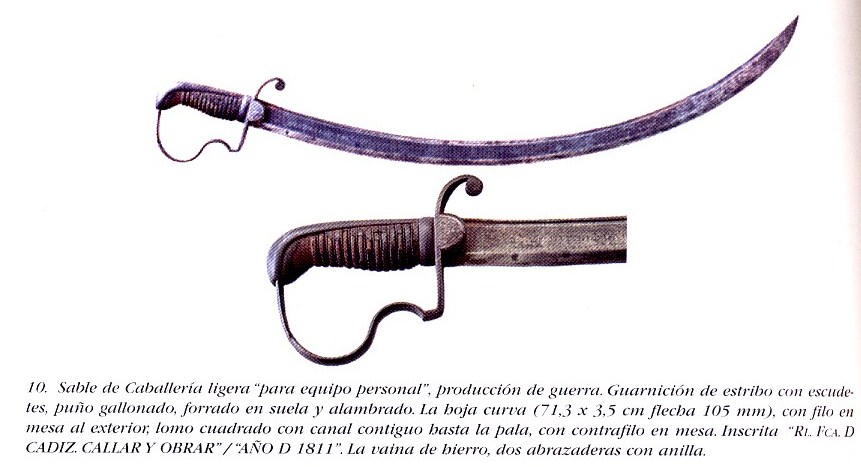

Now, look at this one.
So called Light Cavalry Sabre for Personal Gear, War production.
From the work ARMAMENTO ESPAÑOL EN LA GUERRA DE LA INDEPENDENCIA 1788-1814 de Juan L. Calvó Pascual.
(Don Calvó has once offered me a copy)
This example, marked and produced in 1811 (Cadiz), with more 2 cms. length and less 5 m/m flecha (bow) has almost the same curvature as mine.
Could it be that this Spanish model inspired the making of mine ... in such case not a freelancer but a regular weapon ?

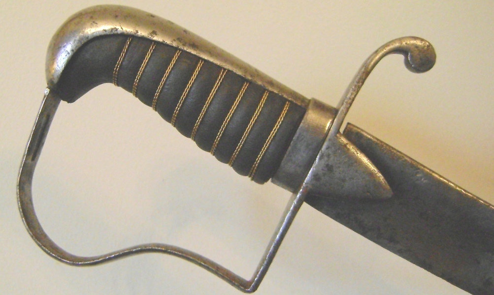

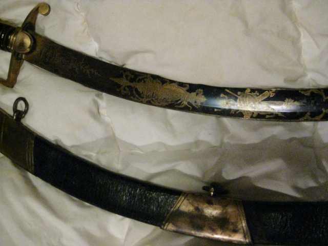

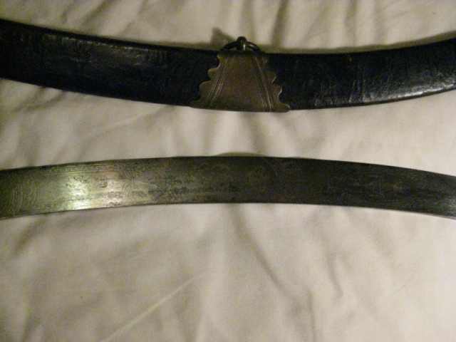

Hi Guys , This is my Flank officers sword .
graeme gt is offline   Reply With Quote
Old 8th January 2014, 05:20 PM   #16
graeme gt
Join Date: Sep 2008
Posts: 97

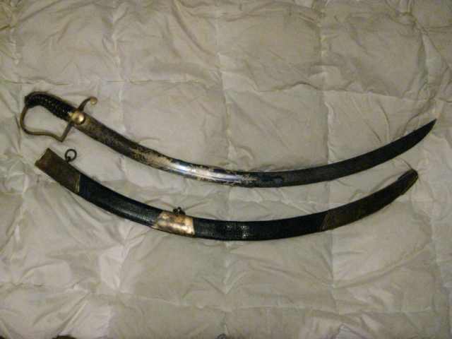

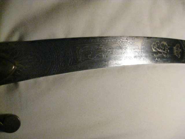

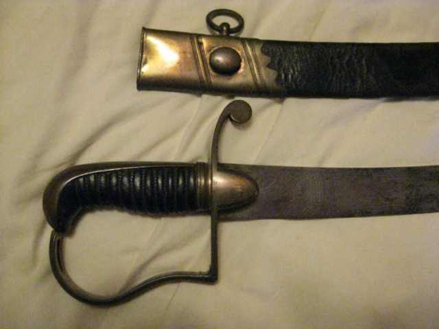

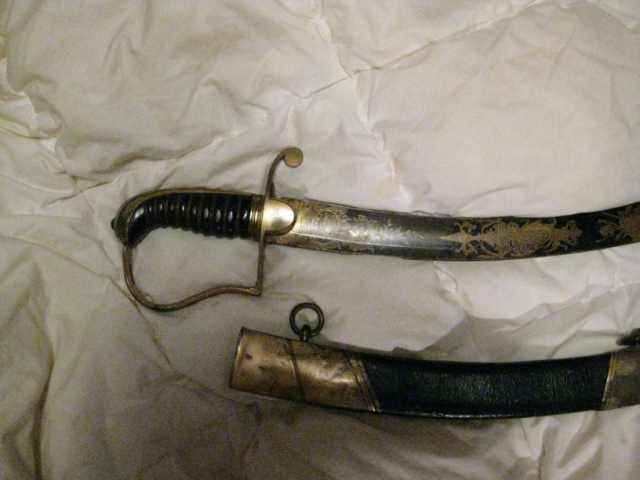

Sorry about poor pics here are some more .

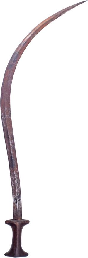

Old 9th January 2014, 07:11 AM   #20
Hotspur
Hotspur's Avatar
Join Date: Jul 2009
Location: Nipmuc USA
Posts: 543
in my files, Russian?

Old 9th January 2014, 12:23 PM   #22
Yes, present in a thread familiar to this one:
http://www.vikingsword.com/vb/showthread.php?t=17929

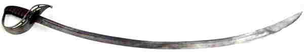

British example.
