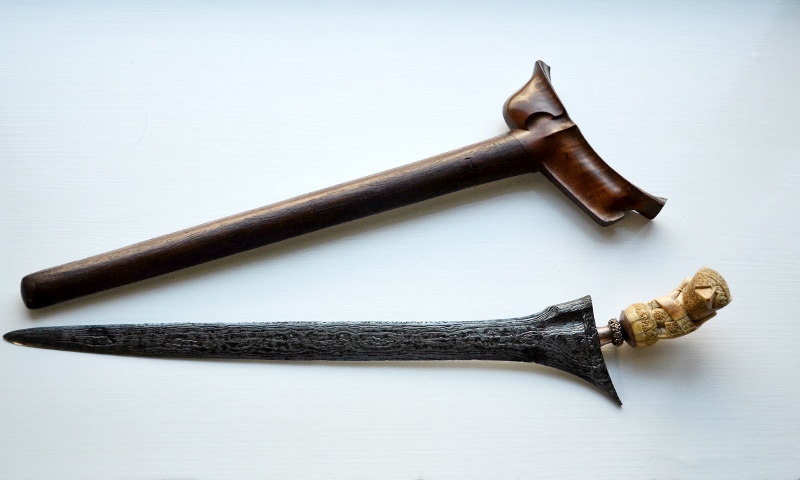

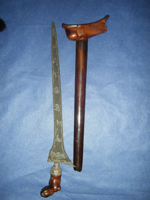

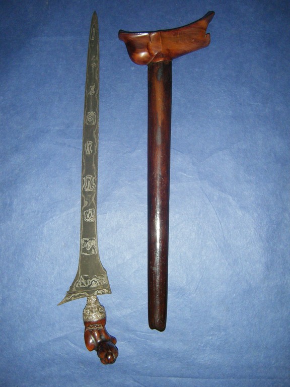

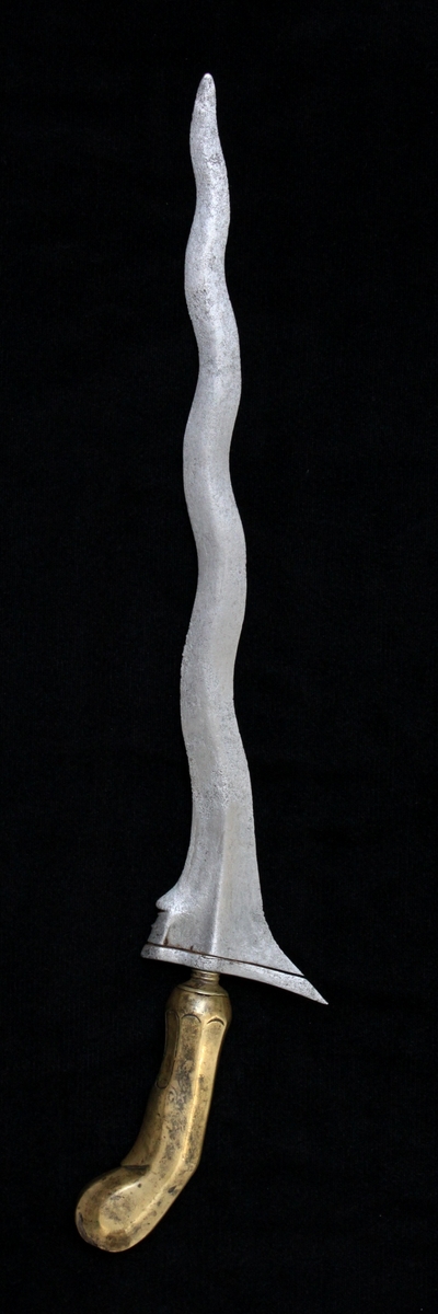

Happy Wednesday! After a brief technical glitch (thanks Lee, Rick and David for resolving this) I am back! Several members have made the suggestion to break up the keris in the post "Recent Additions" by type/area...honestly I needed help with this...so thanks to Kai and David we will begin with the first offering... Two Palembang keris.

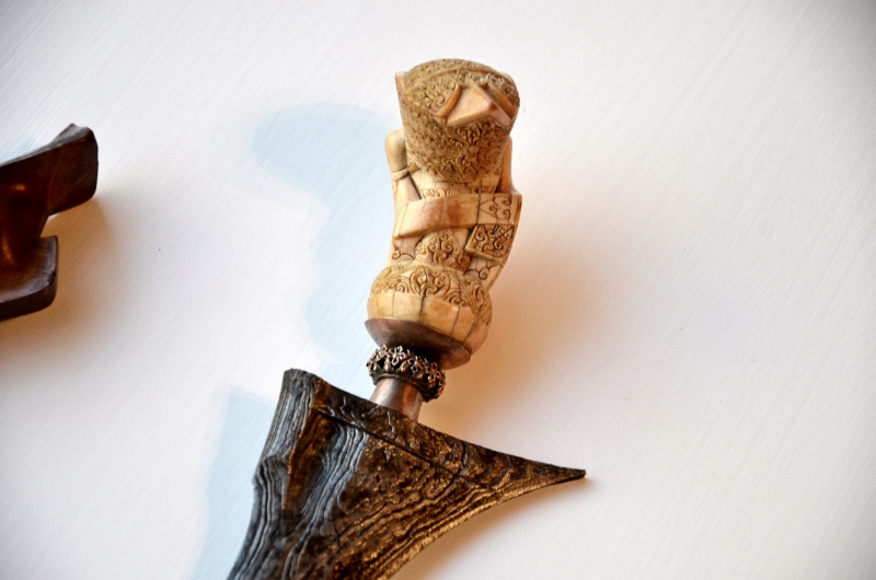

The first features an ivory ukiran (absolutely marvelously carved), a medak/selut of suassa(?). The length is 15" (all measurements from the gandik side of the blade from the top of the ganja).

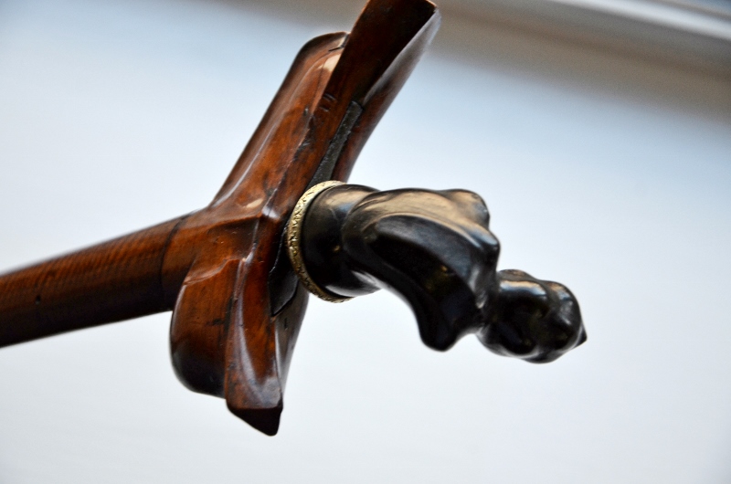

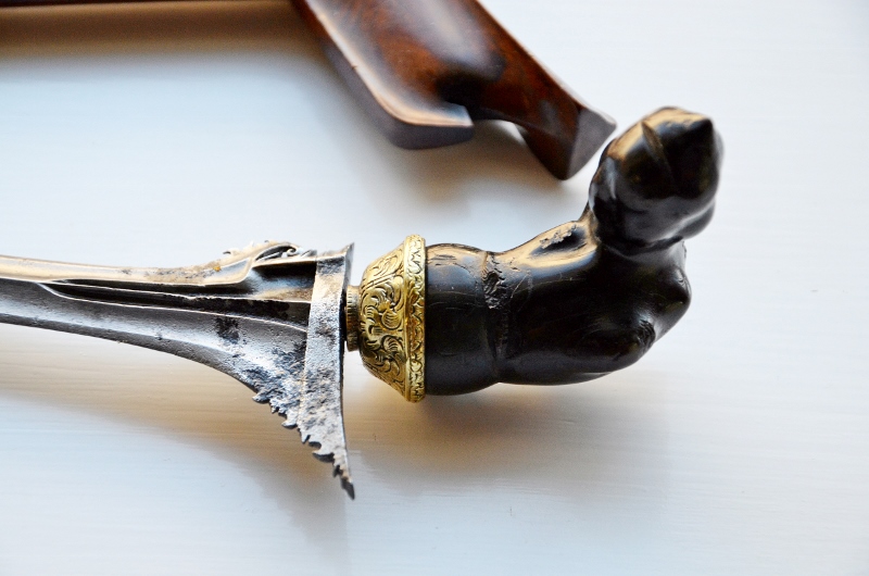

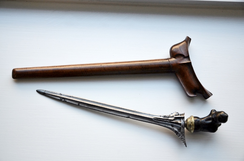

The second offering has a ukiran of horn, medak/selut also a suassa (?). 12" in length.
As I post these over the coming days, I'd humbly as that you'd please help me to understand more about these wonderful blades. Example; are these called Palembang due to the type of sheath/wrangka they are housed (one of the only commonalities I see)? Is Palembang the area they are found?
I appreaciate all of your patience, assistance and expertise...but enough of that...lets see some keris!

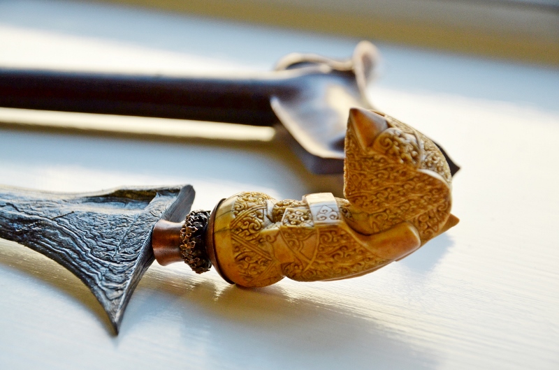

John, I think you might find that the hilt cup on the second keris is brass, possibly gold plated or gilded.
Palembang is in South Sumatra, it had and has long time political and cultural ties with the House of Mataram in Central Jawa, and was also influenced by Banten. Because of these associations the keris that come from Palembang very often have features that resemble either Banten keris, or Central Jawa keris.
"suwasa" (ngoko) or "suwaos"" ( krama) is low content gold alloy, supposedly anything under 14 carat. There are a lot of ways to spell this word, and there are other words for the same alloy. There is another alloy that is also called suwasa, and that is what we call in English "pinchbeck", the only way to tell the difference between pinchbeck and low carat gold is to get it tested by a jeweller.
Old 20th November 2013, 09:16 AM   #3
Jean
Join Date: Jun 2009
Posts: 1,740
John,
Your first kris has a blade with ganja iras (integrated with the blade) which is very common in South Sumatra. The ivory hilt is in one of the specific Jawa deman styles from Palembang and a masterpiece indeed.

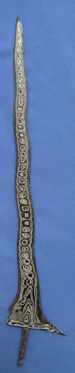

The second kris has a rare hilt in gana style which apparently originates from South Sumatra also although I saw some specimens fitted on Javanese krisses.
Both blades would benefit from cleaning and staining.

[QUOTE=A. G. Maisey]John, I think you might find that the hilt cup on the second keris is brass, possibly gold plated or gilded.
Thanks Alan for the information...my first instinct on the second keris hilt cup was brass, but I truly wonder if it is plated...no tarnish, no evidence of tarnishing.
"Both blades would benefit from cleaning and staining."
Jean, thank you for your comments as well. I have read several things on this board about cleaning/staining keris blades...where does one get this done? Surely no place in the States? As far as the cleaning (nontraditional) once I received them they where all cleaned to stop/remove any active rust, wood and ivory all hydrated. They weren't horrible, but they hadn't been given any "love" for a while.
Thanks again for the information!

I don't see any need to clean/stain the ivory hilted one.

Well, the pictures are not very sharp but I seem to distinguish some black rust spots on the sorsoran and at the tip especially?

two very nice keris you have there, agree with the others about the origin. But like David I don't see any need to stain both blades. The second blade you can try to stain it with hot vinegar but I doubt that there will be seen a similar pamor like by the first one. The blade is very very nice, just stunning. I have a Palembang keris with a similar handle like yours, at weekend I will post some pictures. But yours is much better.

So, if I look at these keris that John has shown us, my inclination would be to do almost nothing.
The ivory hilted one I would probably give a good soak with WD40 or some other penetrating oil, then gentle selective cleaning with picks, a hard toothbrush and maybe a little bit of steel wool wound around the end of a sate stick. Wash with mineral turps and toothbrush, dry with hairdryer, drench again with WD40, allow to dry, then apply a long term protective oil and store in plastic film.
I find it advisable to use a 2X or 3X jeweler's loupe when doing this sort of work.
The horn hilted one I'd probably use a small acid brush and just apply the acid to the corroded areas. I'd probably use hydrochloric and I would not leave it to work and walk away, I'd be watching it while it worked. Then I'd pick the loose corrosion out of the pits and repeat and repeat until I got down to hard metal. When the corrosion was 99% gone it would get a light cleaning with vinegar or citric acid, get rinsed well, WD40 over night and protective oil and plastic film. I would not stain this second blade. Not if it was going into my own collection I wouldn't.
I've used a few "probably's" here. I've done that because if I handled these keris my opinions might change, but from what I can see the above is how I would proceed.

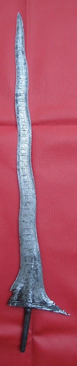

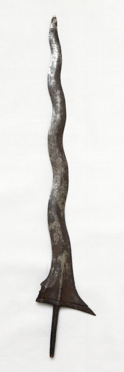

John, I attach the pictures of a Sumatrese blade before and after cleaning & staining so you can better appreciate my position.
Best regards
Old 22nd November 2013, 09:33 PM   #21
Posts: 7,255
I've never experienced this problem Jean --- the brighter areas I mean. I have no idea why you have, and why I haven't. This spotting thing is something I've done for as long as I can remember, where the occasion demanded it.
EDIT
Jean, I've just gone back and had a close look at your blade. How was this stain job done? My guess is that it is probably a stain done either by the soak method or by the brush method that I myself recommend for beginners to use. When I've spotted a blade it would have been one that I stained myself, and I do not use either of these methods to do a stain.
My recommendation for John's keris was to use the spotting, then follow on with picking the rust away, by doing it this way you are using the acid to loosen the rust, but not dissolve it, that's why you watch the job, you don't want the acid to start eating away too much of the hard metal, you just want it to fizz a little bit, when the fizz dies down you leave it there a bit longer, wash it and go to work with the pick, its not a matter of leave it there and forget, you use it just like you'd use any tool.
I also recommended only a light vinegar clean when the rust was gone, and the purpose of this would be to get rid of any other dirt and possibly allow the metal grain to be seen.

The horn hilted blade bears many features that would permit it to be classified as Surakarta, however, it is impossible to give it this classification from a photograph, bearing in mind the long term association of Palembang with Central Jawa, it is more likely that this keris is a Palembang copy of a Surakarta keris.

Jean, as far as I can see the horn hilted keris has no pamor at all...seems to be mono steel (or skin over a core)...very uniform all the way around. The black/stable-now rust really bothers me on this piece but I want to take the less evasive route possible as I have not done this before (and I am guessing this blade is at least 19th century). I have others in my collection that you can tell were stained at one time...this one doesn't ever appear to have been stained...I could very well be wrong. BTW Jean, beautiful keris!
I have one pictured in the other post with a monkey hilt...that piece has a beautiful pamor...I can see the reason for staining that one and others like it.
EDIT
There are a lot of processes and ways to approach a blade clean.
Hello Alan,
As I said I was too hurry and rough with the stain removal procedure.
The staining was done by the warangan master Herman in Solo, he uses the soaking method as far as I know. One may find that the pamor contrast is too high but I like it like that and it can be attenuated if required and with time.
I appreciate what you recommend and agree that a light vinegar soak will correct any difference in brightness and colour of the blade.

Thanks Jean. Yes, I thought it had been done that way.
Jean, the soak method of warangan is what is used for cheap commercial jobs. You can do a lot of blades for a low cost.
To get a truly good warangan job you need to use the massage method, where you brush the fluid on, then pinch and massage the blade with your bare hands. Not many people know how to do this properly, and even less are willing to do it, but the big benefit is that you can even out variation in the stain colour, and the stain itself will last virtually forever.

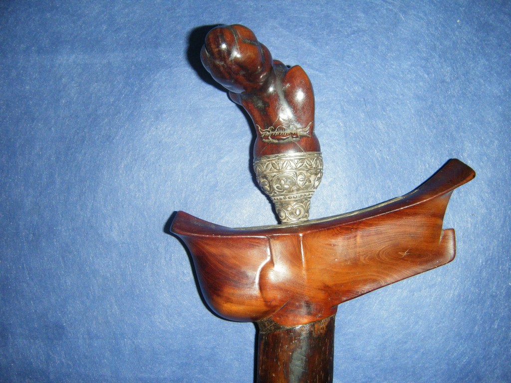

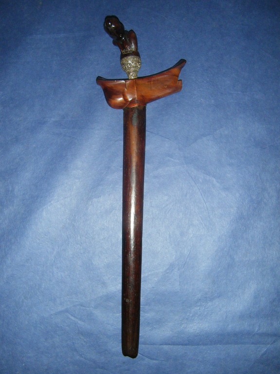

Originally Posted by jwkiernan
Thank you Sajen as well...looking forward to seeing your keris.
Hello John,
here some pictures of my Palembang keris with wooden gana hilt.

Originally Posted by Jean
Hello Chandra,
If you experiment the electrolytic rust removal method, please give us some clues about the solution used, source of DC power and voltage, approximate treatment time, etc
Rust spots will turn to pits anyway as the rust eats away the bare metal.
Best regards
Jean
Hello Jean,
If pineapple juice does not work because the rust is too thick ,I move on to electrolytic derusting using:
- any battery charger in the 4 amp to 20 amp range will work. (The lower the current, the longer it will take to get the job done)
Connect the Negative lead to the part that you want derusted!!!
-for the solution: About a tablespoon of household / washing soda to a gallon of water. (Fine bubbles will rise from the object when cleaning is in progress)
-after some hours scrub with Scotch Brite , rust scale is loosened and can be easily removed. Un-rusted metal is not affected in any way.
http://www.vikingsword.com/vb/showth...cleaning+blade
sirek is offline   Reply With Quote
Old 23rd November 2013, 05:33 PM   #30
jwkiernan
jwkiernan's Avatar
Join Date: Nov 2006
Posts: 37
Detlef, thanks for posting the pictures...very nice keris indeed! The hilts are very similar indeed! Again thank you for the look! Have a great weekend (to all)!
All my best,
John
jwkiernan is offline   Reply With Quote
