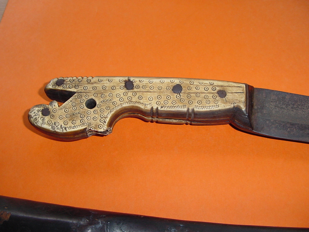

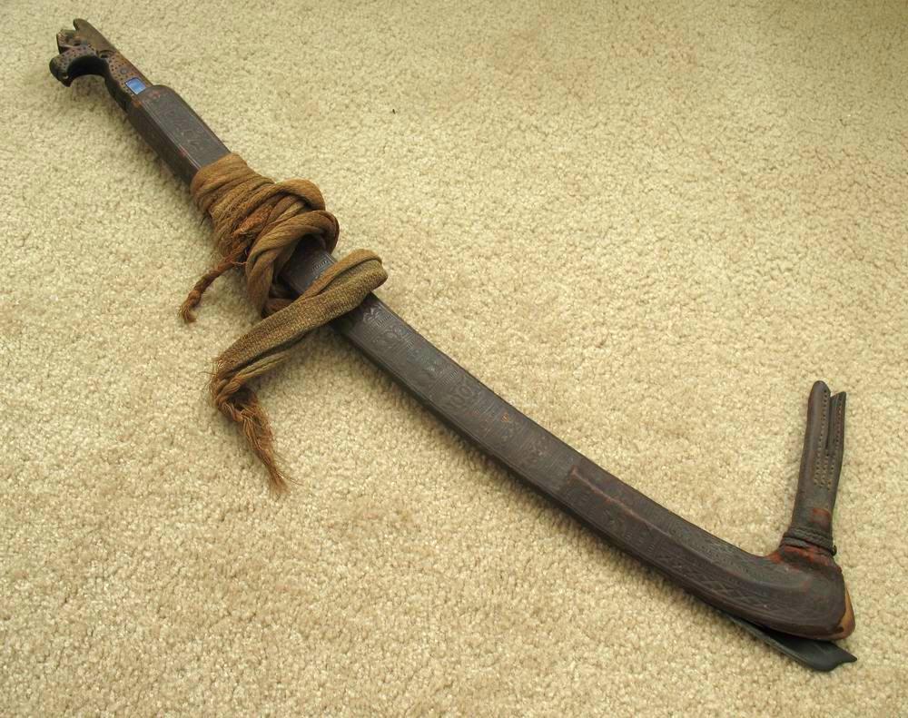

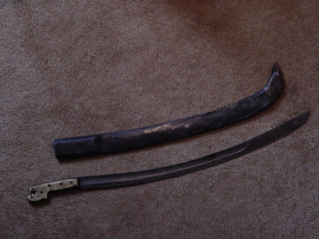

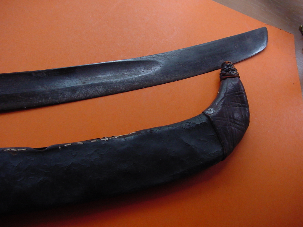

Appears to be an unmarked, or copy of a British 1796 cavalry saber, is it?
The 29 inch blade looks like a huge old fashioned straight razor. If it is as it appears a fairly scarce item with a sheath with an intacked toe. Sheath has a wood insert on one side only, seems odd. Horn?? layered grips have a break across the bottom of the grip. Any information will be helpful. Thanks, Steve

Interesting sword that has been the subject of a great deal of talk here in the past. Most common attribution I have seen is Berber but I have seen others talk of them as Morrocan, Spanish colonial, Carribean, and Mexican or south American. Jim I am sure will be able to offer some insight when he sees this
Old 4th June 2013, 01:42 AM   #3
Posts: 2,833
Default Maybe Algeria???
Hi Steve,
Another interesting piece. My pick would be Algeria, based only on the hilt decoration. Many Khodmi knives from that area have similar decoration.
The blade could have originated almost anywhere. It could be an original European blade or a locally made copy.
Nice item IMHO.
Regards Stu

Nice sword archer.
We have indeed discussed these mysterious swords at great length in the past. To me their attribution is unclear, but I have two of them with Spanish mottos: one the standard "No me saques..." motto, the other one "Para Los Valientes Dominicanos", likely referring to a particular event in the history of what is now the Dominican Republic. I am yet to see an inscription on the blade of this type of sword that is NOT in Spanish.
Therefore, to me it appears that they must have been used somewhere within the Spanish Colonial Empire. Assuming a 19th century attribution to these swords, the Spanish Empire at the time was limited to the Caribbean, the Philippines and a few areas in North-Western Africa. Maybe add a significant portion of South America and all of Central America, if they date to the very early decades of the 19th century. Of all these options, I am leaning towards Central America and the Caribbean for two main reasons:

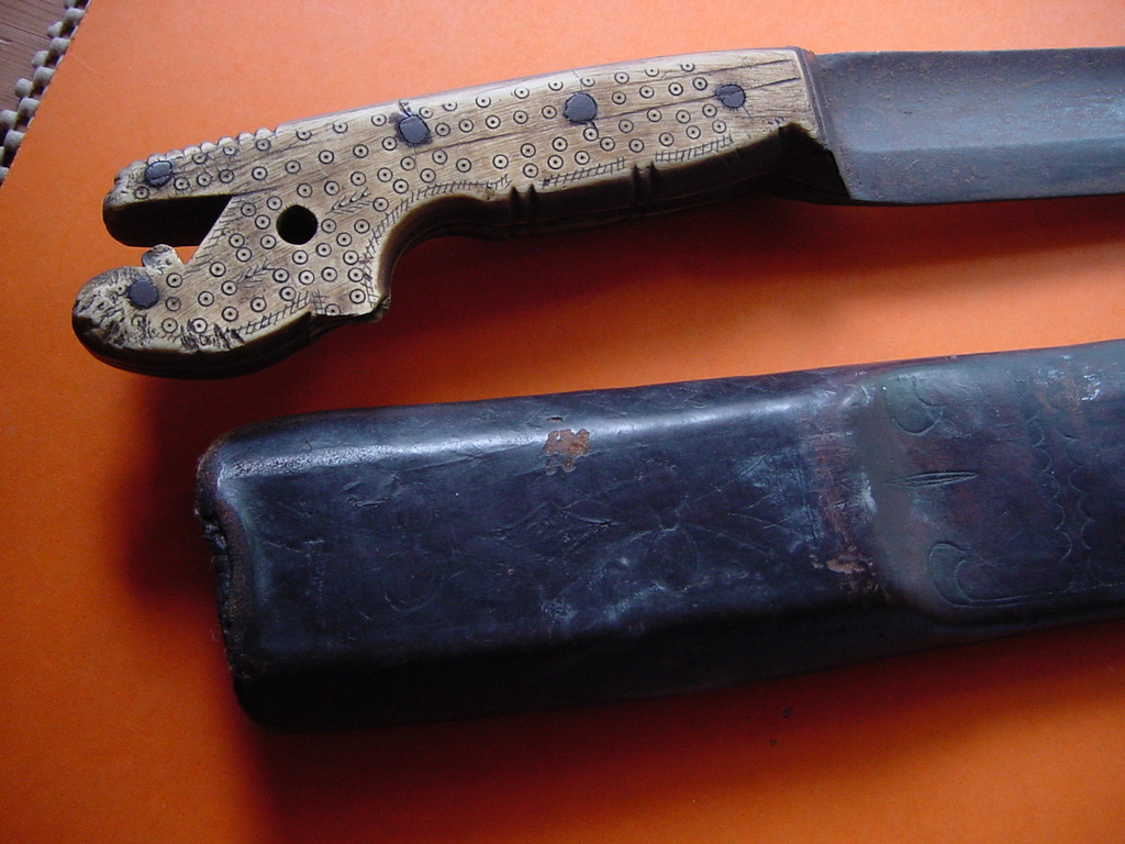

Hi, Here I was thinking another addition to Moroccan family with a rather rare sword when the sheath is complete. Now as you both have pointed out out It's worse than the mixed origins of the various Koummya styles. I'll read it all thorough, but, I need to peek at the ending has the forum found a conclusion?
This one just came in and needs a lot of oil to remove tiny raised rust spots. The right hand fuller may have very faint makers mark and maybe and armors acceptance stamp. we'll see what oil can do. Thanks, Steve

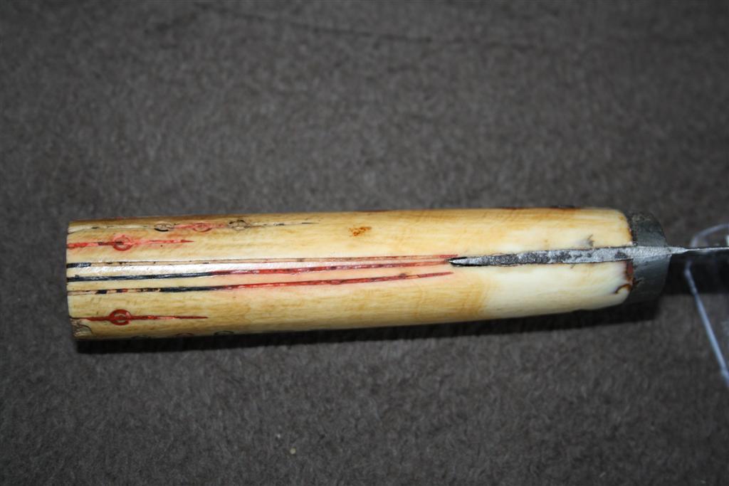

One thing these swords seem to share is a 'pinched tang' tapered to fit between the hilt slabs .
This would not seem to be the original configuration of these recycled blades .
The clipper-ship bow shaped point of many of these reconfigured swords seems quite un-Spanish also .

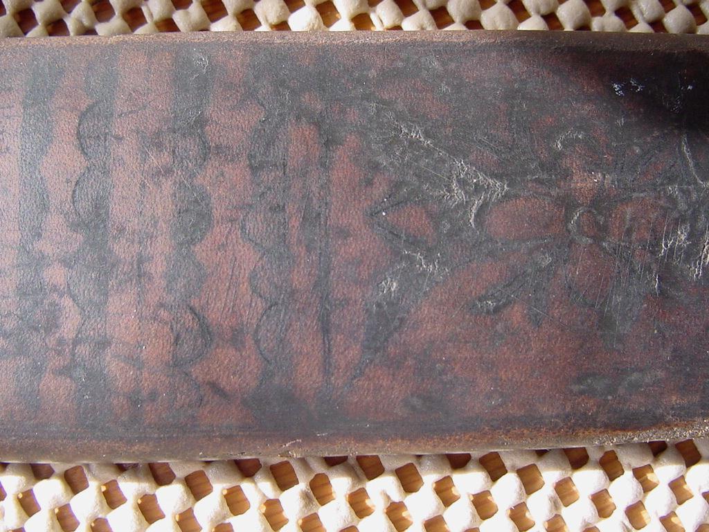

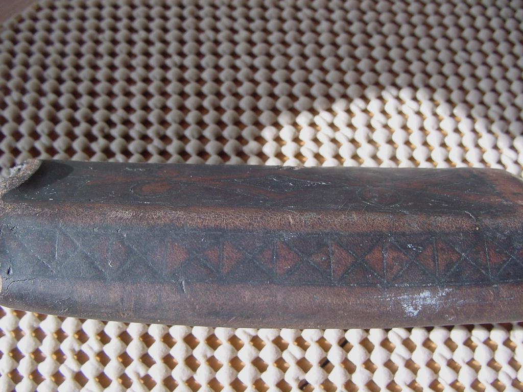

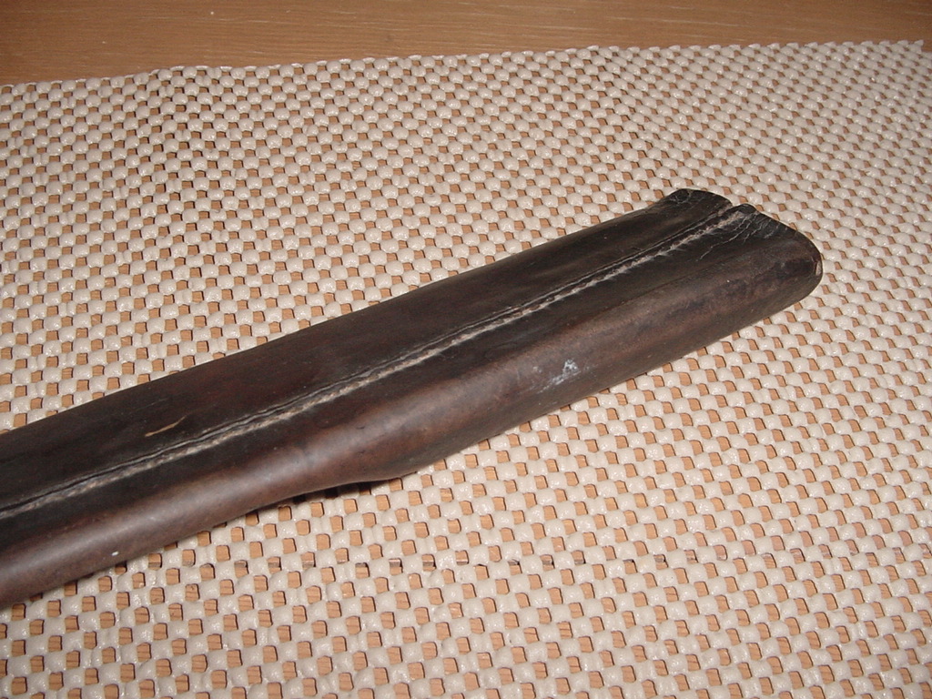

archer
Posts: 373

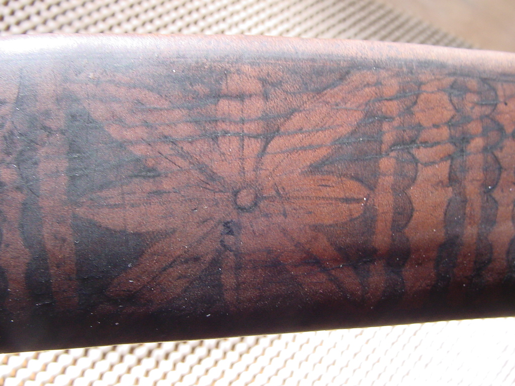

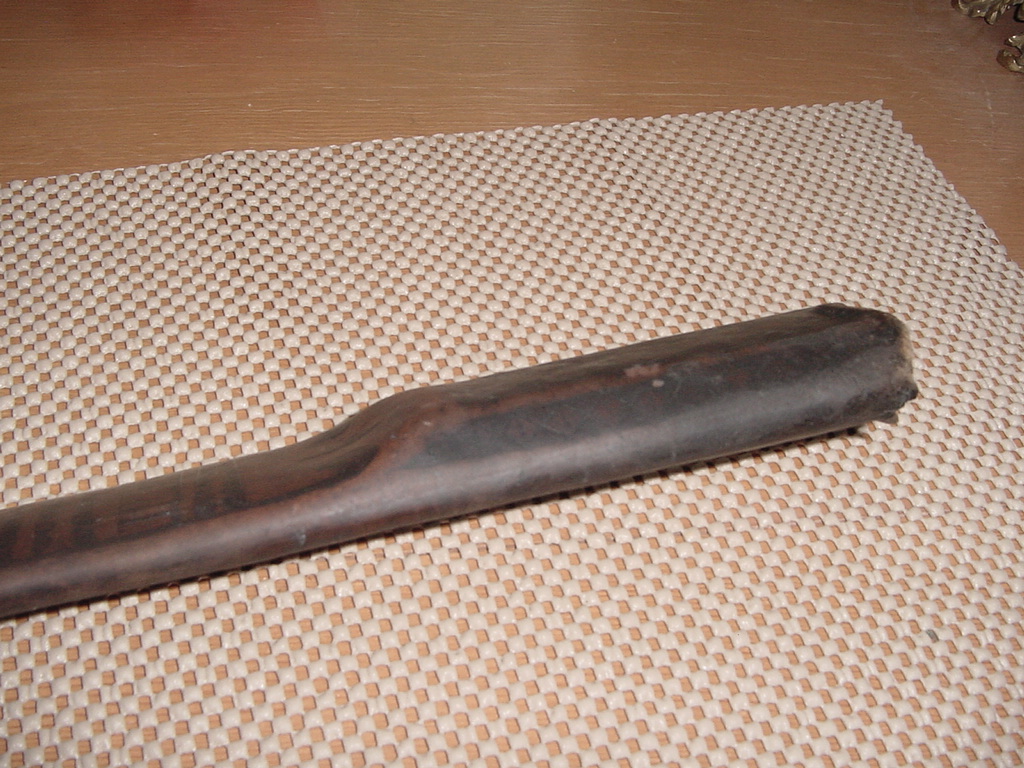

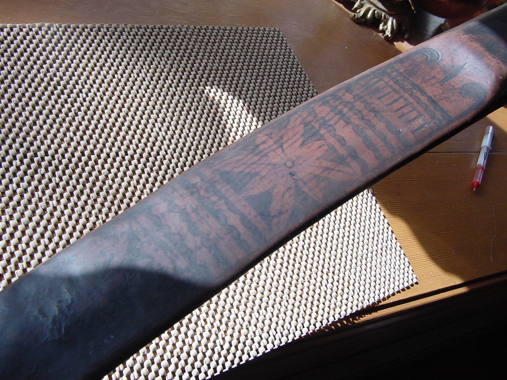

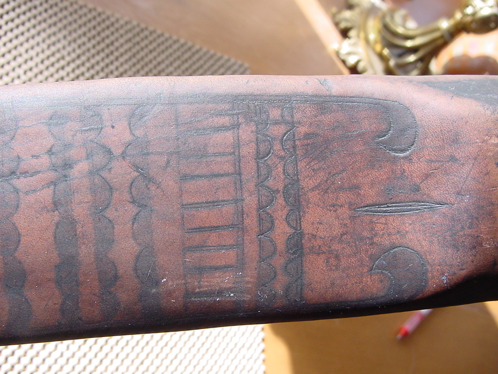

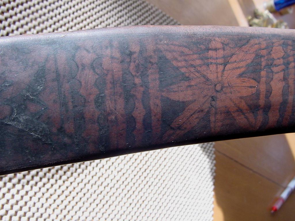

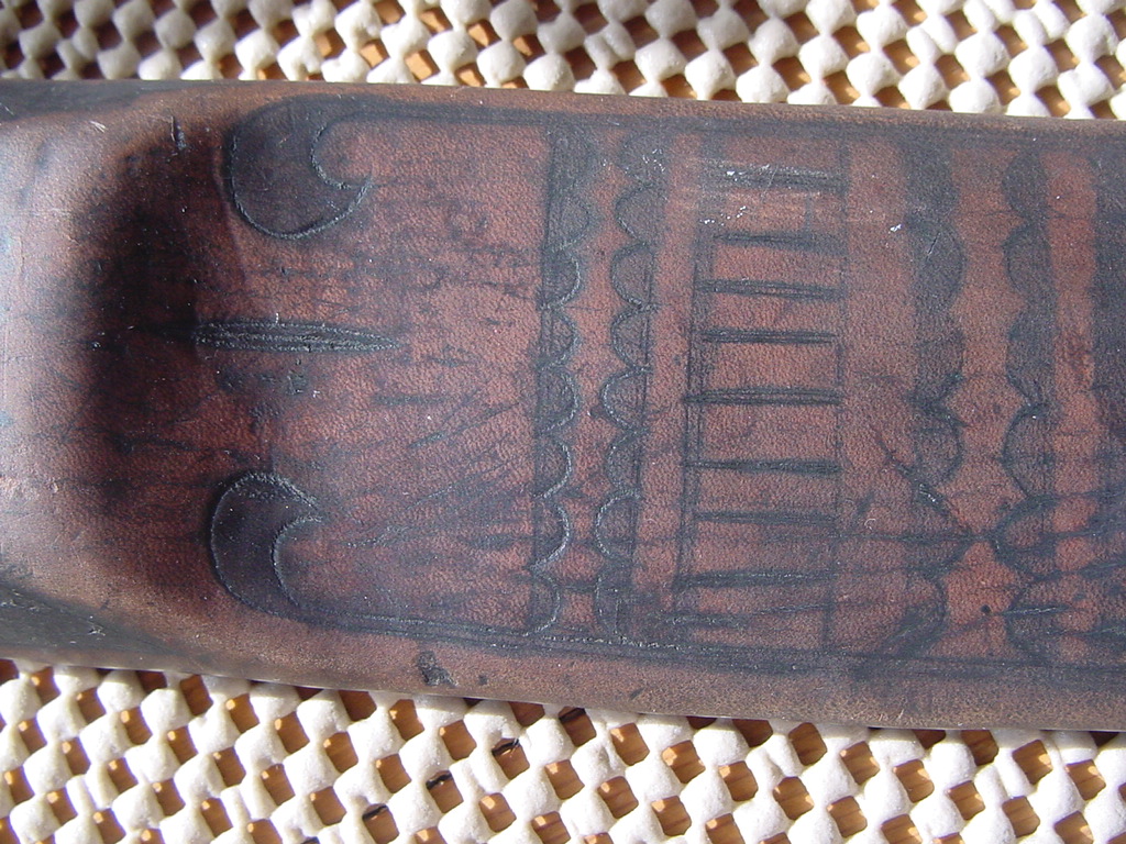

After some cleaning clearer designs began to emerge. Perhaps patterns will be identifiable to an area the sheath was made. I haven't had a chance to begin looking yet. Rick I think the Pinched tang is a good start. The vague patterns in the rust, were connect the dot types, no help, the blade remains unmarked. after thought the leather work is a bit primitive, simple cuts and dye. Almost like scarification.
Regards, Steve

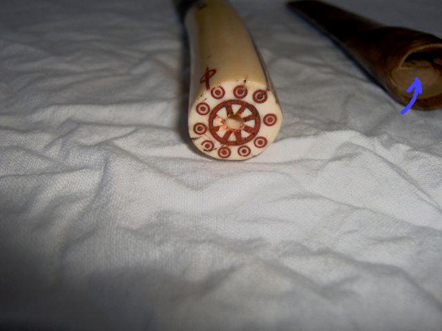

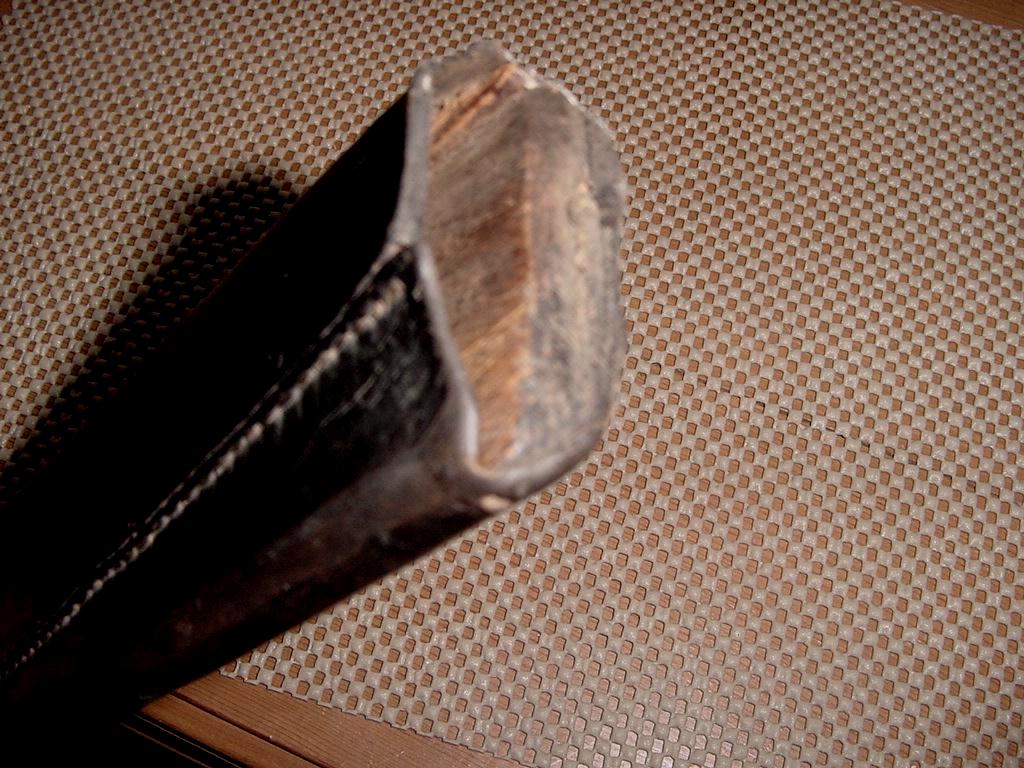

This is a link about circle decorations:http://vikingsword.com/vb/showthread.php?t=16661 look at the knives sheath. It appears to have only one wooden insert, as does my swords scabbard. The circles are kind of understandable as a simple design to make.
The second link provided by Richard G shows an odd tapered tang! http://www.vikingsword.com/vb/showthread.php?t=14832 This thread as Kanjar 1 had stated earlier pointed to Algeria and Northern Africa as a possible source of the knives. What do you think?
Oh, one more thing the odd steel shown on this knife reminds me some better quality Koummya's can have a similar odd looking steel. Regards, Steve

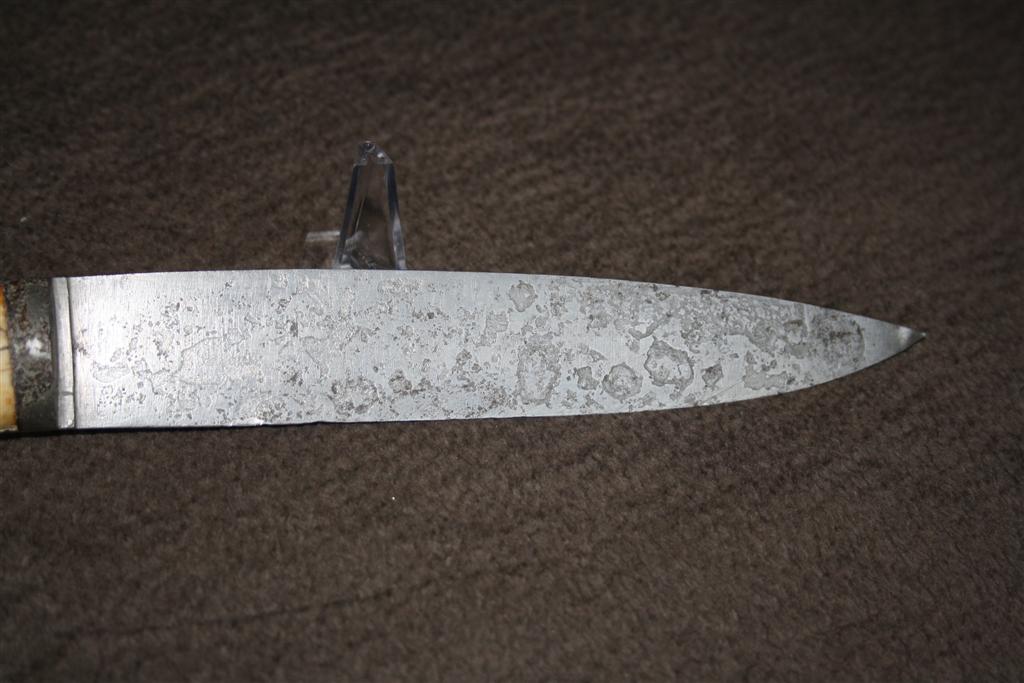

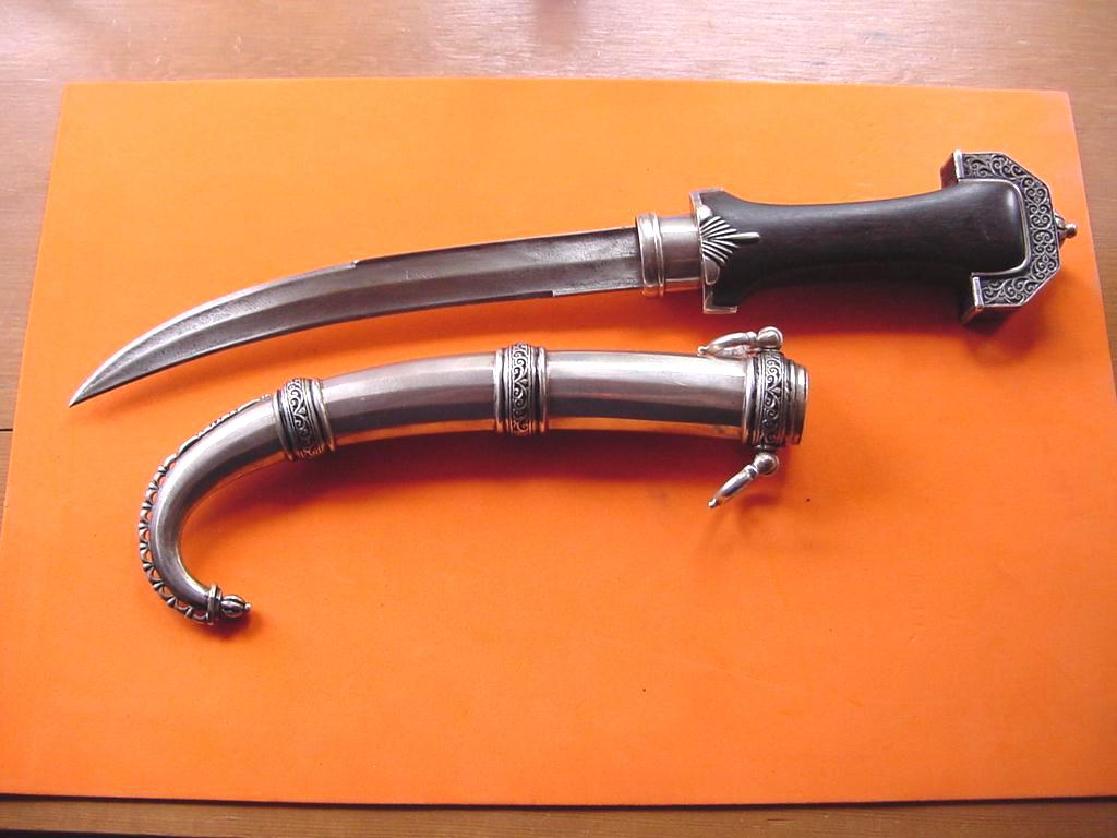

Default Another Koummya Blade

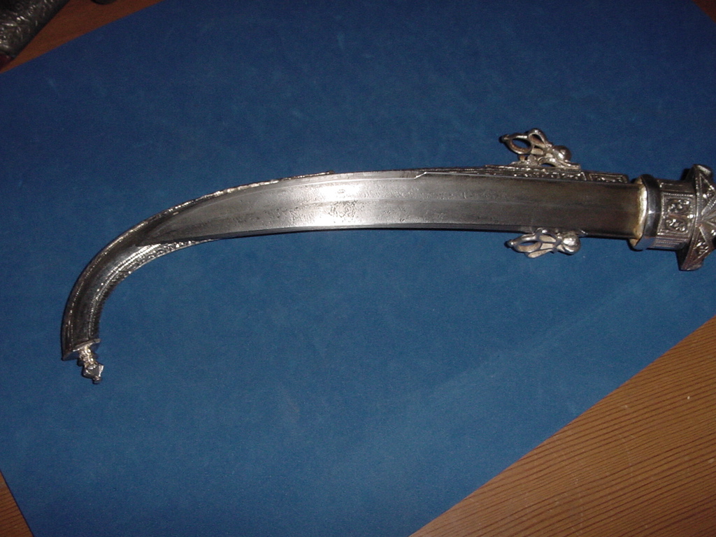

This Koummya was purchased from France (E Bay) seller, said it was from North Central Morocco bordering Algeria. Note dagger with the same oddly rough textured steel.

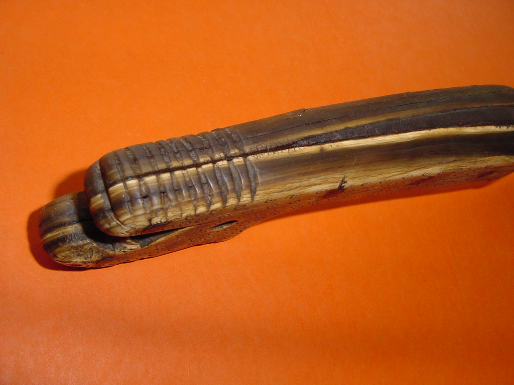

My example appears to be layers of leather topped off with horn scales, and the decoration seems to have been burnt in .
They certainly resemble nothing else I have ever seen in 16 some years of collecting .

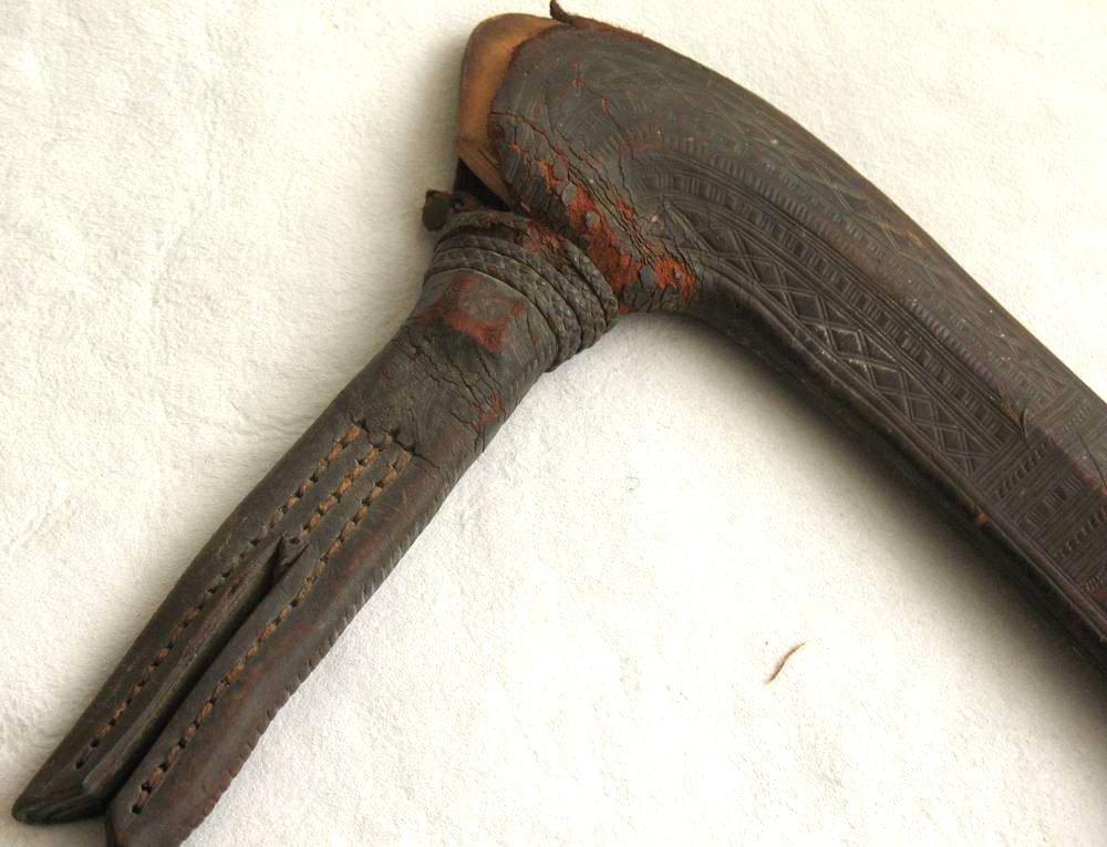

Default Questions

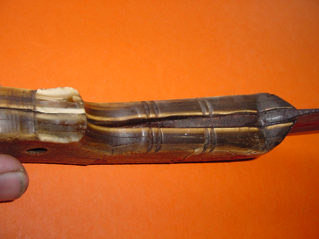

Do the sabers with Spanish motto's, etc, also have the tapered tang? The Berber photos are a stretch, but, if you look at the shadows cast by the hilts, the silhouettes take on to my eye the proper shape.
M Eley, Do the scabbards follow this odd blade protected by wood insert and a layer of leather on the outside and only leather on the inside? More importantly were both tangs tapered? Do the M1796 British Sabers have tapered tangs? Thanks Steve
I added a few photos that may help on origins?

Every example of Brazilian espada/cutlass I have seen lack a scabbard. It could be that none survived or that they were never intended to have a scabbard (if a true naval cutlass, they shouldn't). Getting back to the scabbard on yours, my Berber saber had a similar raised 'toe'. The hilts on these are all very similar, of horn slats pinned together. Not to confuse matters, but espada ancha also have similar hilt constructions (horn or bone slats with a tang sandwiched in the middle with pins/rivets holding them in place. The tang on my Berber was tapered, but I can't see the tang on my Brazilian piece as the horn hilt fully covers it. I've heard the theories of m1796 blades being used, but not sure what their tang was shaped like. Certainly, the tangs might have been altered/flattened to allow for the horn slats. After all, many of the Berber sabers had their points purposely clipped to form a 'crescent moon' shape. I assume you might have already looked up the thread 'On the origins of the so-called Berber sabre'? Some very interesting info there...
