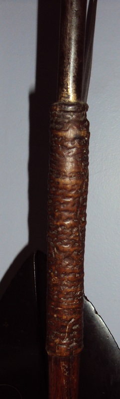

One of the ways is to shrink wrap with tubular animal tissue. Metal wire weave and rattan like material is also used. I have to say I think the animal parts is best reflecting the cattle based economy. I have not added the whole picture of this spear as it is not a true Iklwa but the fixing is the same.

The ribbing does not seem to be formed by binding under the animal tissue. As I said this is not an Iklwa. This spear is to the north and east, I believe as far as the Kenya Sudan border regions but essentially the same fixing as the classic Iklwa. The ribbing is tool worked like the baldric on this Seme. The Iklwa is not worked. Somebody will have an example to show, all mine have gone. Here is the spear it total-
http://www.vikingsword.com/vb/showth...turkana+shield

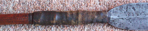

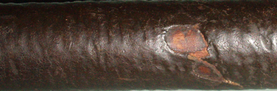

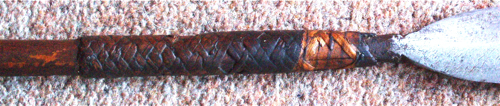

Here are some of mine which may help. Two complete with cow tails one with the binding only and one of the head only. Hope this is of some help.
Norman.

nice collection .....the second one down....is there a twine binding (whipping) underneath the hide sheaf ? I have seen some where this type of binding is used. The sheaf is placed over the whipping and shrunk over it. But, I have also seen some where there is a texture created by applying the cord over the top of the wet hide, which is left to dry/shrink and later the string removed leaving the imprint of the cord. It's possible that this texture improves grip to aid removal from the poor victim but do not know for certain

Hi David,
You're dead right, the 2nd one down does not have any binding underneath, see photo. I would suspect your deduction may have some creedence.

Hi Norman ,
sometimes the sheathing covers/holds the lower section of the spearhead shaft ...I believe that this 'overlap' is deliberate and is bound tight around the metal shaft (with a strip or cord to compress) to compress and mould the wet hide to tightly fit and support the spearhead shaft further .....later the strip/cord removed, once dry and shrunk.

Hi David,
On the two with 'cow tails' that I posted both shafts are partly covered/gripped by hide.
