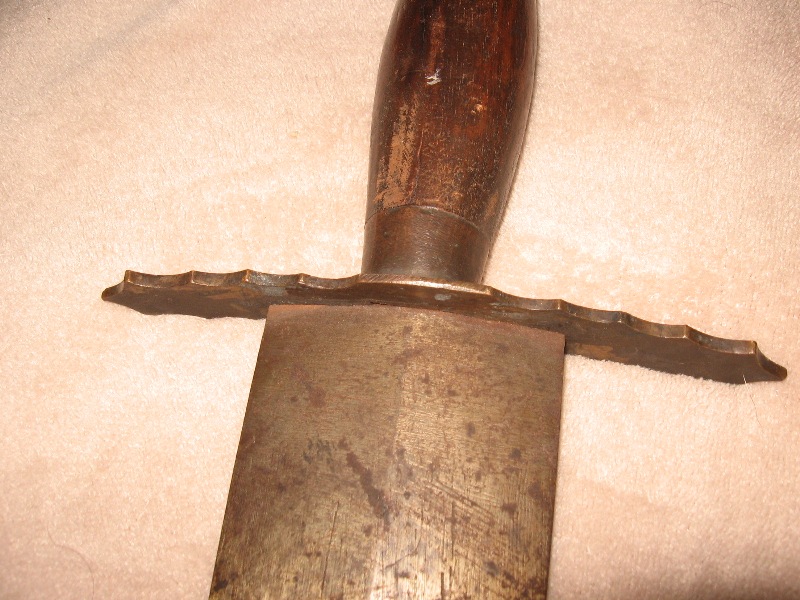

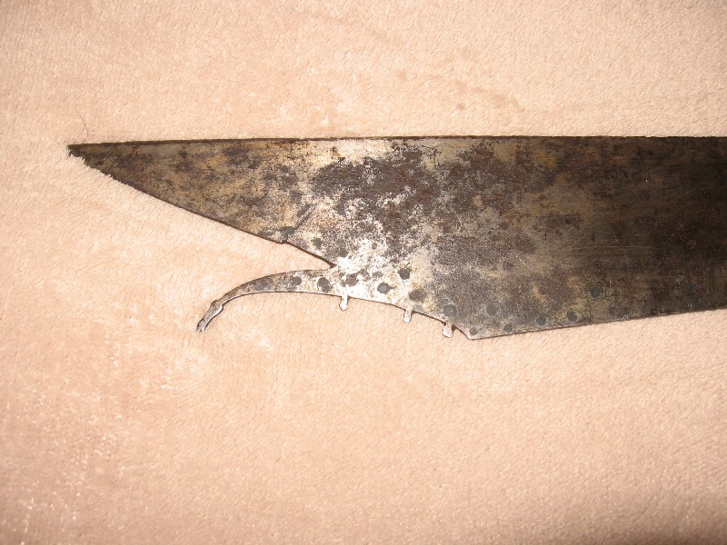

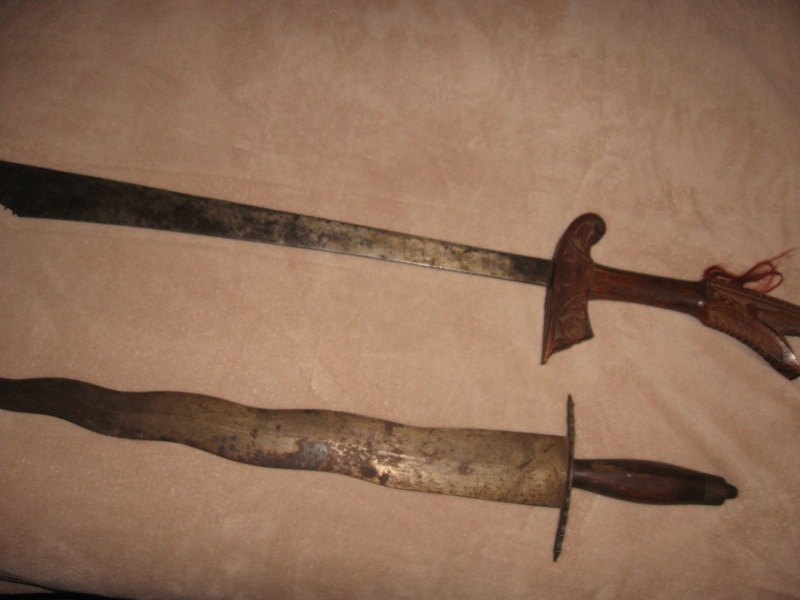

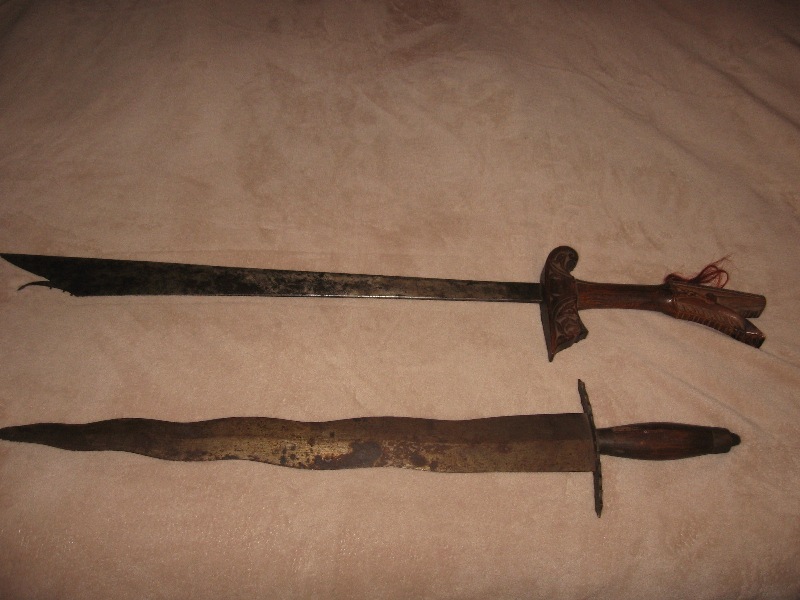

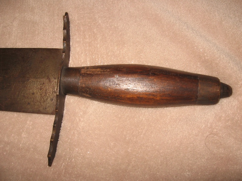

I found and old guy who was vet, and had these old blades sitting at his place. I got the two for good price. The story goes they were brought back by a couple of GIs after WW-II. Both are missing their scabbards. I would like to clean off the rust, what is the best way to clean and then restore these blades?

Nice kampilan and Luzon "kris"/sword. Great find.

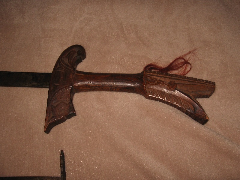

Until I have further evidence, I think your Luzon sword maybe from Ilocos Norte region.
The kampilan is not rare, but certainly not that common either, based on the style of the less seen guard. |

I can post so more pictures on the hand guard, if it would help, on the blade there is a saying that someone started to grind off. It gets me to wonder what it said and why someone would do that.
