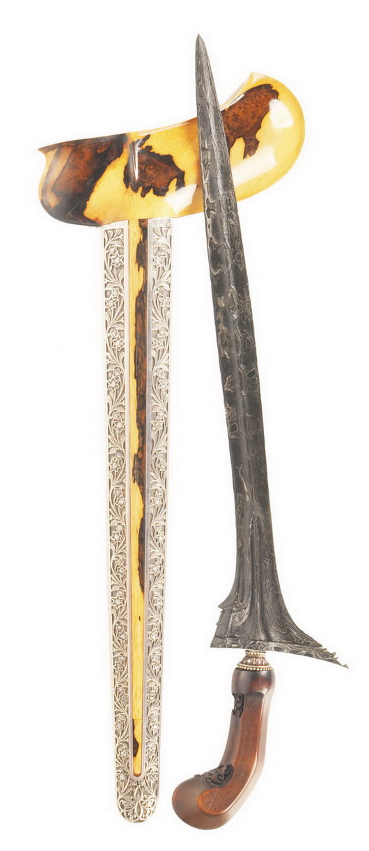

Default What pamor is this?

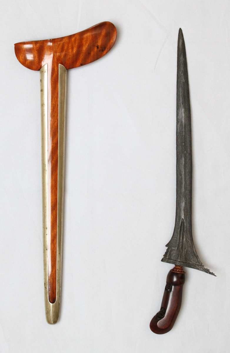

What do you think is the name of the pamor of this keris? It kinda looks like Wiji Timun, but then it has some sort of "wings" surounding the ellipses.

I think this is Bali origine Blade

I don't think so Asian. What makes you say so?
And it looks like a basic Wos Wutah to me, but maybe someone else knows differently.

To me it looks to be a Javanese blade with dapur Pasopati.
Regarding the style of pamor, it is impossible to guess it accurately from the picture, we need more detailed ones to see the details, especially if the pamorless areas in the median part of the blade are due to wear or are original.
Best regards

I just found that this kris is shown on page 132 of the book "Tafsir Keris", and is said to have belonged to the late General Subroto. It is described as having a dapur Pasopati and pamor Wos Wutah and to have been made by Empu Supo in Blambangan.
hmmm....interesting indeed...

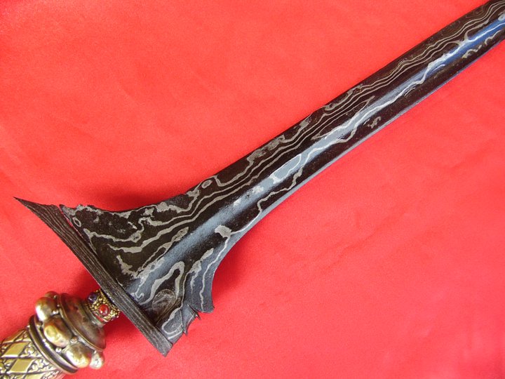

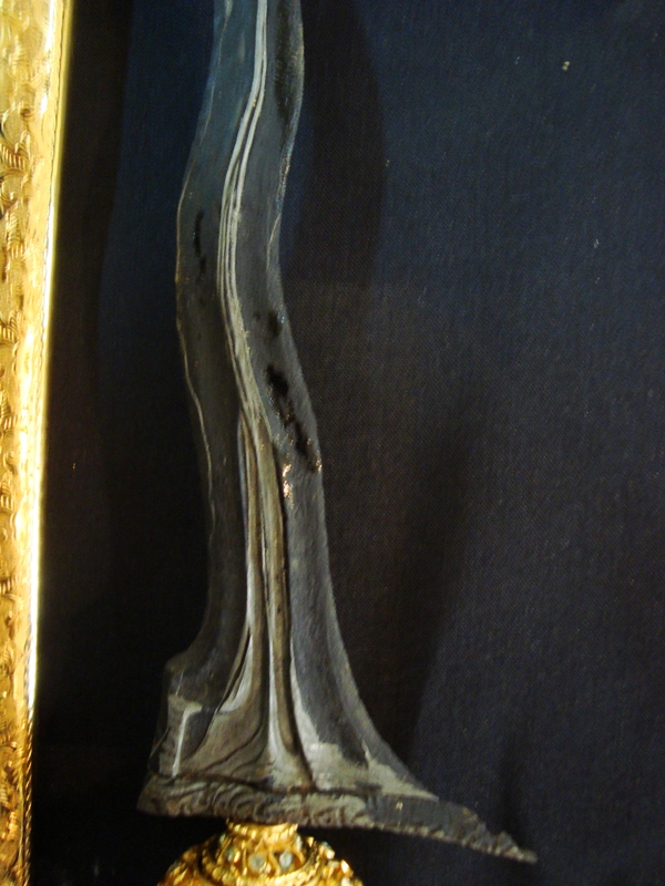

According to the book, this kris is deemed to have very strong magical powers and to select its owner, and it is only said to have been made in Blambangan by Empu Supo, not to be attributed to tangguh Blambangan.
I attach the picture of another kris with dapur Pasopati and having some similar features (and differences of course), it was made somewhere and some time ago by Empu Tartempion (well-known to French collectors only ) and it selected me as its new owner

So Ferrylaki, if i understand you correctly, from this one overall photo viewed on a computer screen you have been able to determine the following:
1. The gandik has been re-formed
2. the pamor layers are thin, which means this is a Bali keris
3. the blade is thin which makes the odo-odo look tall
4. The sogokan are "very, very deep"
5. the greneng has not been re-formed (does this look like Bali greneng to you?)
6. the tagguh is not Blambangan (though that was never stated)
You can really see all that in this one photograph? I am quite impressed by this skill.
Do you have any provenanced Bali keris to show us to help support your belief that this is an old Bali keris? Can you support your ideas in any way other than your own observations based on this one photograph?
Do you have any response to the fact that the very keris in question apparently appears in a notable book on keris attributed to Mpu Supo and described as Dhapur Pasopati with pamor Wos Wutah?

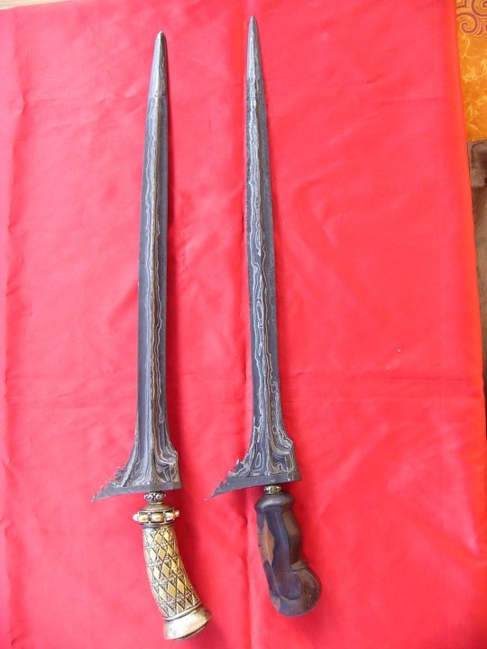

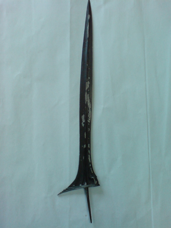

Found similarity in the book from karsten Jensen (1998) pg 136
And one in keris di Lombok from Djelenga (2000) pg 168
These are carita dapur one’s but have the same candik and ada-ada(rim)
This blade has been polished (typical bali)
counter is the pamor used for the ganja . On bali, ganja’s are black (or small stripes)
Pamor at the base beras wutah and stretched to the tip.
Still confused Or is this an recent mixture
asian-keris is offline   Reply With Quote

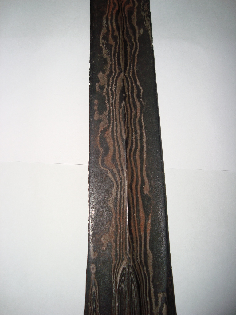

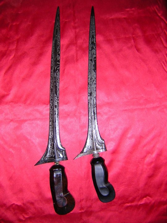

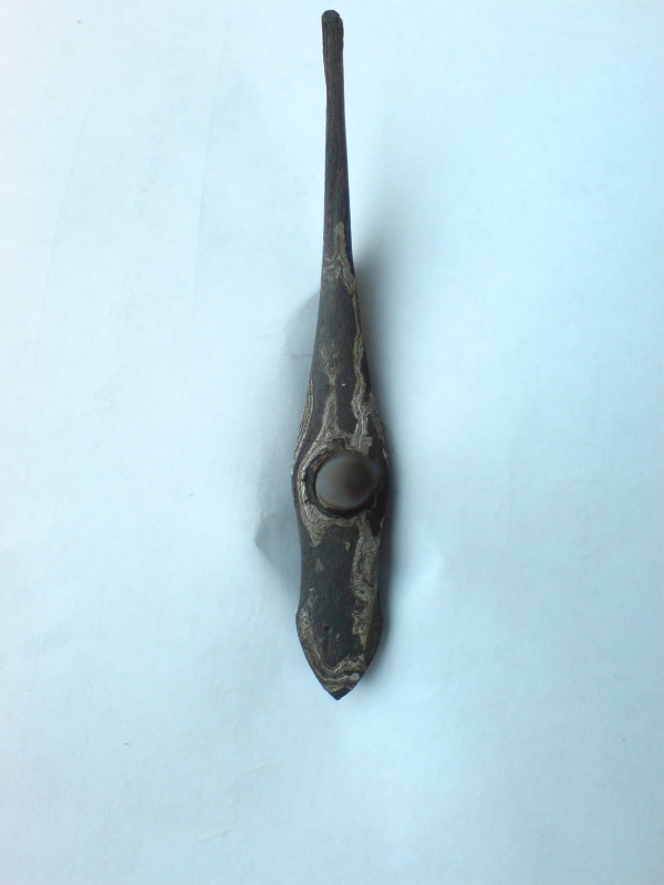

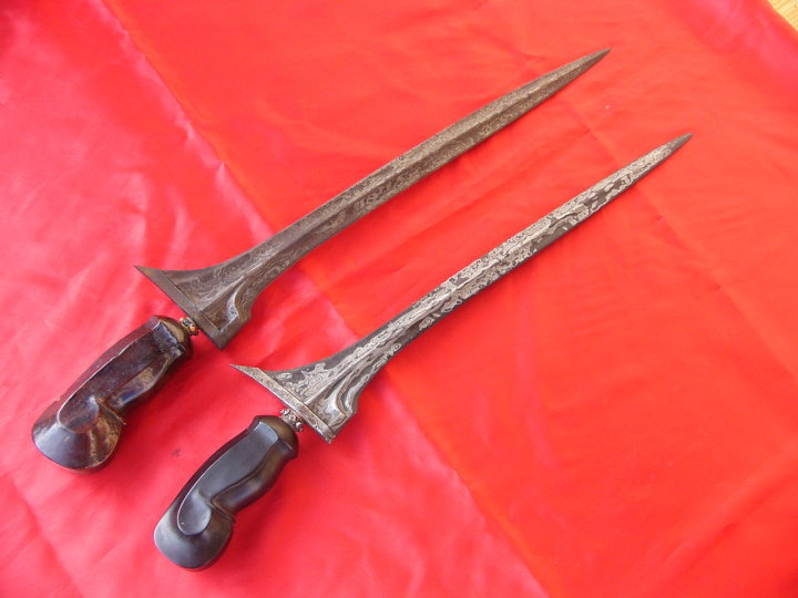

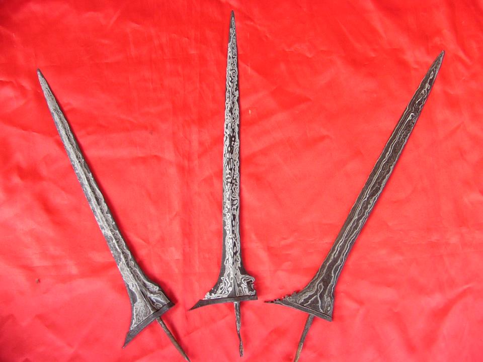

I must say that
1. the gandik it just fine. it hasn't been re-formed.
2. the pamor is consist of only a few layers of thin pamor which indicate it is a bali keris. since bali keris applied this method of pamor making cinsistently.
3. yes I can see that all in a slight view from a photograph. and I've been study keris like crazy this last three years. I found that there is a very remarkable consistent keris making method is applied in each era and tangguh. even in the same periode of time and the same region as PBIX and mangkubumen the keris making methode on appliying pamor is quite different.
Lets continue abaout the picture of pasopati.I'd like to ask you all to observe the pamor. how many layers are they? howe thin every layer is. how is the tipe of wos wutah pamor applied? in point of view, the wos wutah is quuite different from javanese wos wutah , sultan agung or senopaten or majapahit tipe of wos wutah. off course this keris can't be a nomnoman .
these are some picture I found from the internet shiwing the consistent Bali wos wotah would look like.
ferrylaki is offline   Reply With Quote

ferrylaki
Posts: 285
Originally Posted by David
Well Ferry, i would not argue that any of these examples you have now posted are from Bali (or Lombok). That much is clear in these examples though none of them are the same pasopati dhapur. I will continue to argue that the original example in this post is not from Bali....that there is very little you can discern from the one image we see about the true nature of the pamor...that it is a blade out-of stain anyway and could use some warangan to show it's true form and construction....that the dhapur of this original keris does not look Balinese and that when you compare the gandik, the form of the lambe-gajah, the form and shape of the greneng, the type of pamor present on the gonjo, the over shape of the gonjo.....sorry, this just does not read as a Bali blade to me at all. Even if it were possible to tell more about this pamor from the photo and it does use the lesser layers of the Balinese technique, i would still doubt a Bali origin for this.
Of course, you have also failed to address the fact brought forth by Jean that this very same keris is identified on page 132 in Tafsir Keris and that the blade apparently has some provenance. The book apparently lists not only the owner, but claims to know the Mpu as well.
Well David. I have to admit that I 've fail to give you a reasonable explanation. I'm pleased to have this discussion with you. Let's continue this fun .
I do have a picture old dhapur pasopati with similar over all shape. and I guess its has the same majapahit tangguh.only with a slight different tipe of pamor. the gonjo also fill with pamor, which I can guarantee for sure that its gonjo is the original. I also attach the picture taken from the gonjo. to show you all the peksi hole which still has its "peg" . and I must say it is a very nice shape of "wuwungan gonjo" hope you enjoy it. but plesa do not put any comment about its kembang kacang.
But I do agree the keris we discussed could be categorized as majapahit era .
once again I must admit that I was too hasty laying my eyes to the thin pamor layers.
Please continue this remarkable discussion. I will always feel pleased to join keris warung kopi.
I hope Alan would like to join us here. What You say Alan?
Dear Ferrylaki, if we are looking only on Blumbangan on both keris (your latest picture and the initial one): I am fairly sure, yours isn't Boto Adeg, and the initial one also don't look like boto adeg. Tangguh Majapahit should have Boto Adeg Blumbangan.

I'm sorry Ferry, are you still maintaining that this original keris is from Bali in spite of what seems like a very well provenanced history provide for the keris in Tafsir Keris? Are you denying that history? You're right, this is fun!
