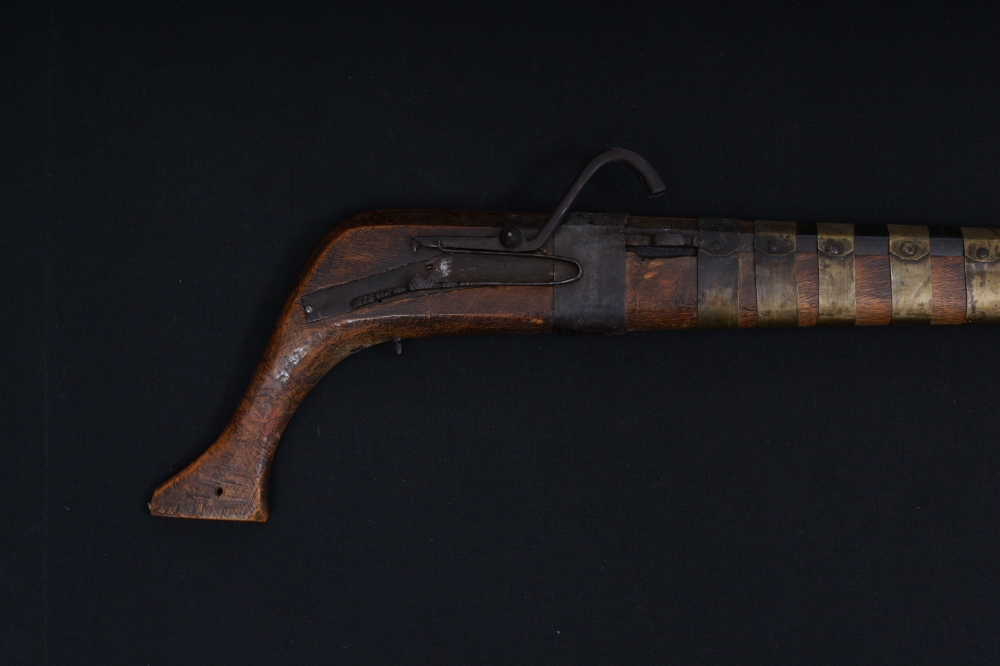

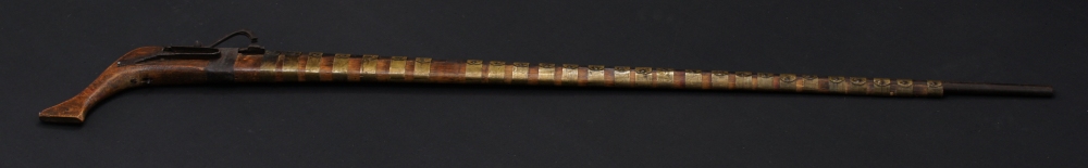

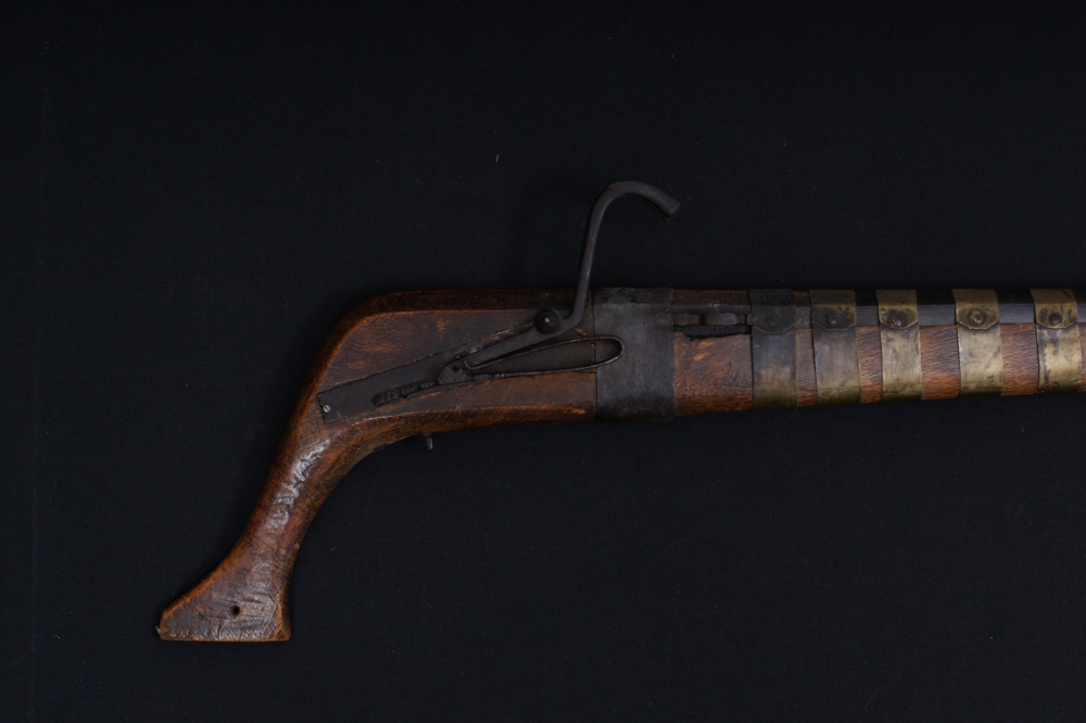

Hi folks

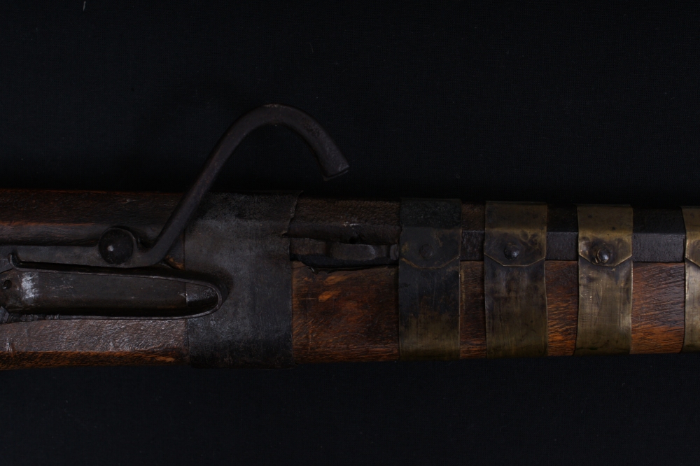

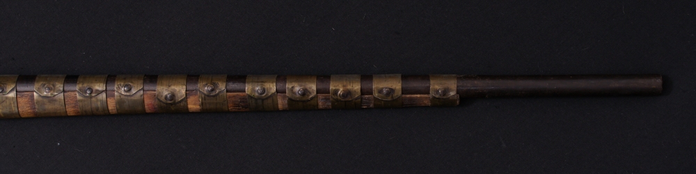

These don't seem to come up too often so I thought it might be worth sharing. I believe this to be a Chinese gun. Total length 136cm. Bore 13mm. The sprung matchlock mechanism is working. Although the peg that holds the spring in 'ready' position is worn and I would be very afraid of carrying it loaded, lit and cocked
The barrel is held by 29 brass bands (and one is missing), plus one sheet metal steel band securing the breech. The barrel is padded out by three leather circles to get the correct distance between serpentine and pan. The pan has no cover, neither can I see any evidence that there ever was one. The barrel itself is octagonal becoming round and is pretty crudely formed. No marks of any kind that I can see, and no sight. I think that the barrel is rather older than the rest of the fittings since corrosion around the breech end, and round the pan suggests a long and useful life. The rest of the barrel is in very good condition and has a very nice black patina.
Not sure what the hole in the 'pistol grip' is for. It looks old and not one made by a previous collector for wall mounting. No ramrod.
I am assuming this is 19C, but I'd be eager to hear from anyone with more knowledge of these.

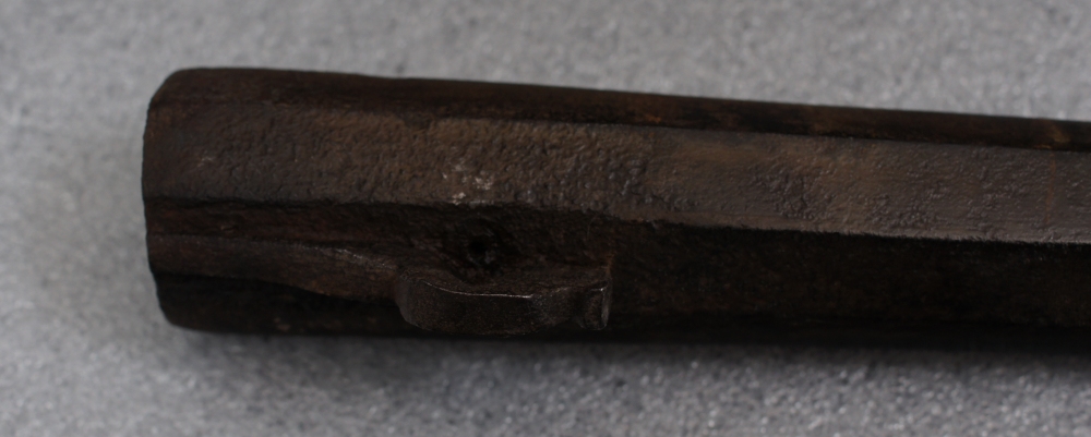

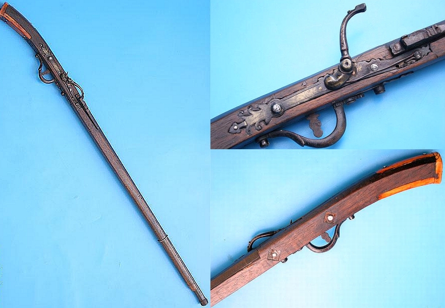

Here are a couple of Chinese matchlocks to compare, do you have any pictures of barrel the end, is it sealed shut or does it have a threaded barrel bolt like the Japanese matchlock.

Unfortunately I don't have a picture of the breech end of the barrel from the end, just this attached picture from the side. However, it is the sealed shut type with no discernable markings (although you can see the corrosion which might have obliterated any that were once there).

At best you might have a made up gun(Old barrel new wood)but even that looks a bit unlikely. I do not think it has any age. As to where it comes from as I don't think it is chinese, will only ever be a guess.

This is an interesting gun. I recommend taking at look at the matchlocks shown in Stone's glossary. I suggest that it is "south" Chinese or Indo-chinese. A neat piece.

Definitely Chinese/Formosa, to Southeast Asia. Very nice. The hole in the grip, could be for a sling swivel of sorts. The Southeast Asian guns, don't have provision for a rammer.

It looks pretty "right" to me, Chinese matchlocks always look a bit odd and put together. I think it is part of the traditional disdain of the Chinese for military stuff.

Exactly what sort of gun it is I am not 100% sure, but it seems that there is broad agreement about the general region.
I am also pretty certain that this is not a 'new' gun, even the woodwork is not new, although newer than the barrel. It has been important enough for someone to repair the stock which had split and strengthen the repair with a screw - you can see it behind the trigger. The barrel shows signs of this being fired (a lot), and the corrosion that you can see is associated with this or is primarily under the barrel rings, especially the large steel one. When I got it there was a lot of active rust under there. The matchlock mechanism also shows signs of wear, at least suggesting that the mechanism has also been used a lot.
I guess this is not military, at least organised military since it does not have any markings, but it really is just a guess.

The piece is right. China or the surrounding area is the location with that lock and form of stock. Age is a question. Guess from pics would be 19th century. A very similar form with a detachable lock was used by the montanyards and other various tribes in vietnam,annam,etc. Those particular ones were still in use during the vietnamese war and afterwards. Nice example.

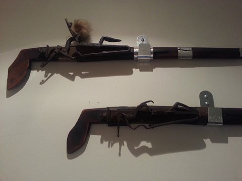

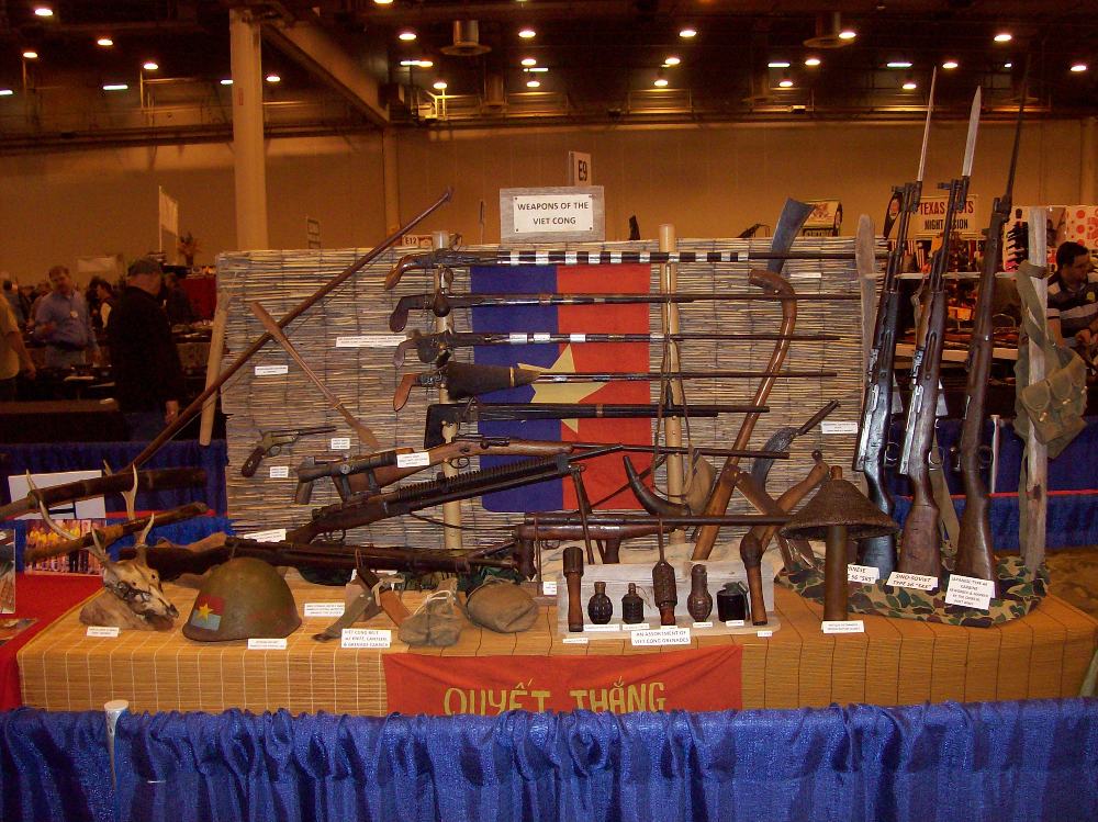

The percussion gun in this lot, is of unknown origin. The flinters are all from Southeast Asia. Sorry for the far away shot. Couldn't get the closeup to upload.

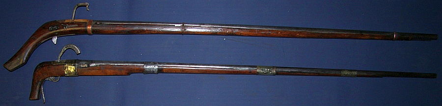

A Vietnamese matchlock.

Indeed that looks like a very fine gun estcrh! Clearly not all these are roughly made items
Great display of Vietnamese weapons. There clearly is a lot of variation here so I guess attributing individual guns to regions and times is going to be particularly difficult in these cases unless we have some kind of provenance with them.

This is from Artzi at oriental arms, with no mention of age, very small at 39 inches total and 28 inch barrel. I would guess from 18th to 19 century.
Great picture, I would like to see that close up, send it to me and I will edit it down to an uploadable size and post if you want. Were was it taken, was it a gun show exhibit?

I'm having some email issues. Here's a link to the post with the display. http://www.vikingsword.com/vb/showthread.php?t=16348.

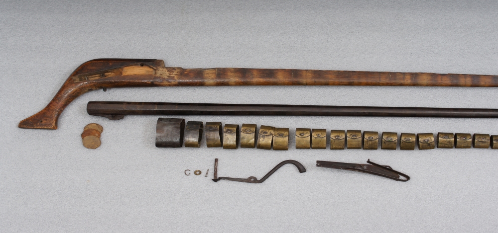

According to the sample of the same type which is kept in Artillery Museum in Sankt-Petersburg, Russia, it was for the thong to carry the gun on the shoulder.
The next one is obviously missed. You meant one band missed - it could be the band with the ring for the thong.
I have the similar but a little bit longer matchlock. It was brought to Russia in 1900 by famous scholar Rudakov (he was sent to China to study the Boxers movement). Then it belonged to the late Prof. Artemyev who excavated the fort of Albazin in Amur basin. Then I bought it from his widow.
May I use the picture of disassembled gun in my paper regarding matchlocks used for tiger hunting in Manchuria and Korea? I do not want to disassemle mine

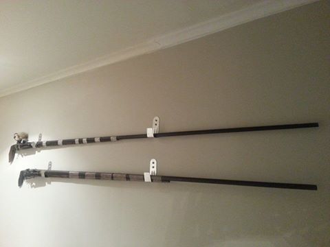

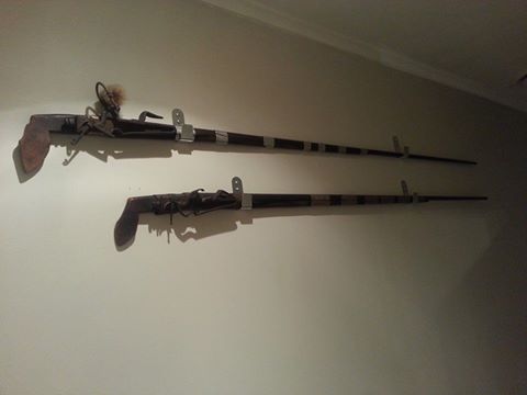

Default 2 OF MY MONKEY GUNS FROM LAOS
AM PUTTING UP PICTURES OF 2 OF MY MONKEY GUNS FROM LAOS,BOUGHT INTO NEW ZEALAND BY AN AMERICAN C.I.A AGENT POSTED THERE IN THE 70s

Very nice BANDOOK!

THANKS TRENCH,HAS A PART OF MONKEYS TAIL ON THE IGNITION AREA,MAY BE FOR GOOD LOOK OR TALISMAN

Yes, all four of mine, have monkey fur frizzen covers.

The gun in question is most likely from the Miao people, an ethnic minority living in large parts of southern China, including Hunan, Yunnan and Guizhou.
Miao soldiers were feared gunners, William Mesny faced them while leading Qing troops in the area and he hailed their skill as snipers.
Identifying features are the shape of the stock and the multitude of sheet metal bands holding the barrel in place. The standard Chinese musket had far fewer, and often narrower bands and a slightly different shape of stock.
Some interesting passages on these people, their muskets, and their skills with them are described in Ian Heath's Armies of the 19th century; China. (The original sources it quotes are long out of print and hard to get.)
