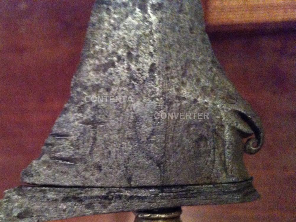

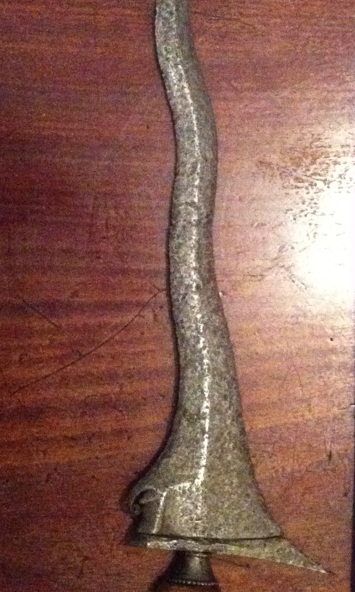

I have recently aquired a keris. But I am not sure of its from west java or from east java. It's seems to have some feature's specific to west java blades, and some specific to east java. When I look at the surface of th blade it looks without pamor or at least very few, I think it will be pamor keleng.

I would be glad If I could some comment bij this two pictures of my keris.

The mendak is Madura/East Jawa.
The blade is out of stain and lacks rondha. I'm not prepared to classify this blade at this time.
We might be able to say a little more when we see the keris.

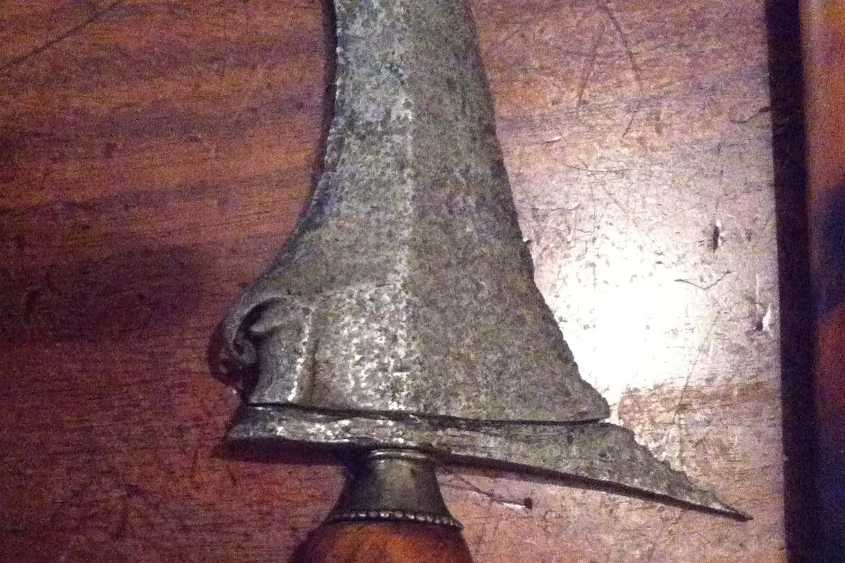

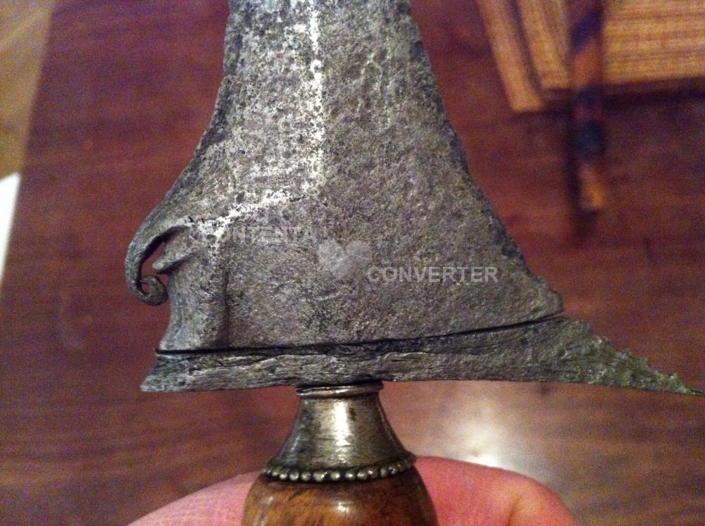

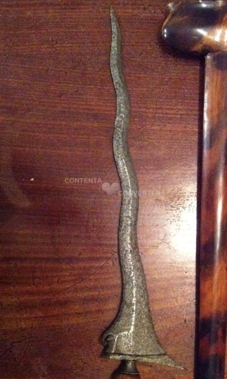

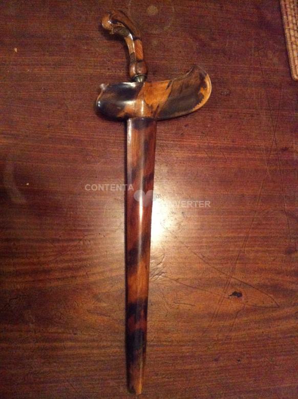

Everbody Thanks a lot for all the help, I have been strubbeling to get the pictures in the right size. But at last it worked. Here are the rest of the pictures. I hope it gives a better reflection of the keris. It is alway difficult to say something about a keris. When you dont have them in your one hands.

If i look at the dress I would say Surakarta Solo. I love the wood. About the pamor you can say anything. You should stain the blade with warangan. Then you can see the pamor and don't be surprised you will see a complete other pamor. What you see now and mistake for pamor are the lines of forging.

Stylistically this scabbard and hilt are definitely Surakarta, however, the workmanship and presentation does not look like Jawa Tengah to my eyes. From the photos I cannot give a supportable opinion, I'd need to handle it before I could be certain, but my immediate reaction is that this scabbard and hilt were made in East Jawa, possibly Surabaya.

Henk, as I have already said:- "from the photos I cannot give a supportable opinion", thus what I am saying now is only based on an overall impression, to be relatively certain I would need to handle it. If I handled it I'd be looking at things like the way the gandar was fitted to the atasan, the cross section and weight of the gandar, the way the sculpting of the atasan had been done, how thick the atasan was, how the inside of the atasan was finished --- all detail, detail, detail, and things that simply cannot be seen from photos. Similarly with the hilt, I'd be looking to see if it fitted a more or less standard Solo blak, I'd be looking at the form from front and rear, I'd be looking at the cecekan.
My overall impression was formed because the scabbard has a sort of a clumsy appearance, it seems not to flow very well, almost as if the maker was struggling to produce a copy of something, rather than working from an ingrained pattern in his own head. Additionally, it is quite unusual to find fairly recent Solo wrongkos that are not fitted with a pendok. Much older Solo wrongkos usually come with a pendok too. An all wood gandar without covering is not usual with this form of wrongko.
I fully agree with Alan, the presence of a pendok or not is a very distinctive indicator of the origin of the sheath. And accordingly the gayaman sheaths from East Java have a thicker gandar (and often atasan) than those from Solo.
