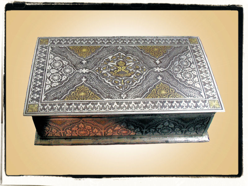

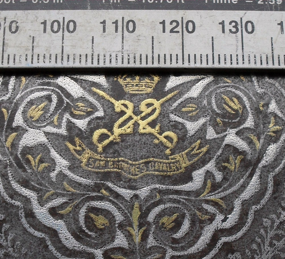

I thought you chaps might enjoy seeing this anglo-Indian steel cigarette box decorated to the 'legendary' Frontier force during it's time as the "22nd Sam Brownes Cavalry" (1904-1921).
It's of interest to us for several reasons of course. Not just the connection with the frontier force, but also the quality of the koftgari is very good and is directly comparable with that which was used to decorate the weapons that we regularly discuss. It's also interesting to see an example of early 20thC koftgari art that's datable to such a short period. I love these 'fusion' items. All comments welcome of course. Sam Browne's 22nd Cavalry Last edited by Atlantia; 2nd February 2013 at 04:15 PM. |

I was once told by a Sikh that Sialkot was (and probably still is) the centre of manufacture for koftgari on steel of this type.
Regards Richard |

That's interesting. We see this exact type of Koftgari on many Dhal, Kula Khud and other items that I've long thought were made to supply the British in the first half of the 20thC. Regards Gene |

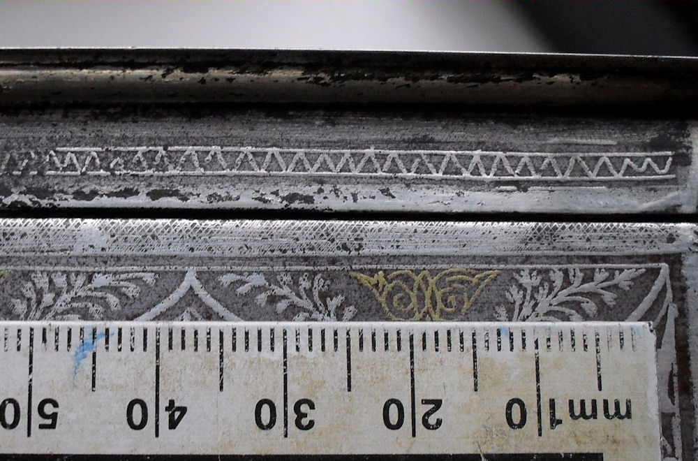

Well mate, as you know, I've been appreciating this - it's stunning to say the least - and I'd love to see some close-up photos of the koftgari posted in this thread as well. ![]() Was the design engraved/chiseled into which wire was hammered (as with bidriware) or was it hammered flat into cross-hatched grooves? ![]() Best, Chris |

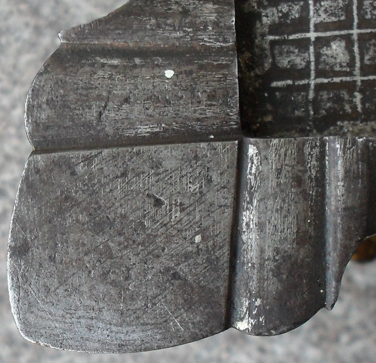

Hi Chris, Thanks for coming in on this one ![]() Excellent question. This kind of kotfgari is characterised by the mixture of the broad leaf (hawthorne?) pattern that is now so familiar because fo the modern koftgari work's heavy use of a similar style and the very fine and far more labour intensive koftgari often seen on earlier pieces. If we look closely at the two pictures below, I've tried to illustrate the construction techniques involved using worn areas of the koftgari. The ruler is in centimetres and millimetres to show how fine this detail is. The larger silvered areas and leaves are applied into finely incised crosshatching, as are some of the finer foliate patterns. However, much of the very finely detailed work has been applied into patterns punched into the steel with a fine point. Where the koftgari is worn or was heated until liquid in the original application process the 'pin holes' in the steel underneath have become visible. The modern koftgari artisans would save considerable time by avoiding this process and concentrating on the crosshatching and larger pattern technique. Last edited by Atlantia; 10th February 2013 at 12:21 PM. Reason: typos |

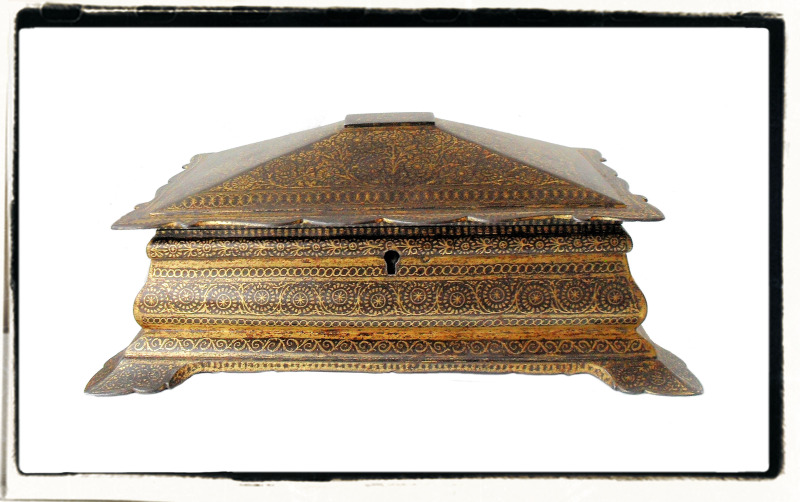

LOL, that's how it starts! With one spear ![]() The white metal inlay is of a reasonable silver content and oxidises to a dark grey quite quickly (as is often the case). The 'gold' coloured inlay doesn't tarnish unless stained by rust from the surrounding metal. So possibly actually gold. Possibly a very yellow maleable copper alloy ![]() If we compare this box, which was clearly made to cater to Eurpean 'colonial' tastes, with an earlier more traditional type the contrast is stark. The construction of the earlier box is of pieces of indivicually shaped wrought iron (lots of them) held together with carefully recessed handmade screws and brazed seams. In the close-up picture below of the bottom of the foot, the 'ripples' in the wrought iron and the patterns of crosshatching where the silver koftgari from the underside of the foot has worn away are clearly visible, giving us a tantalising glimpse into the construction of these fine pieces. Best Gene Last edited by Atlantia; 10th February 2013 at 02:16 PM. |

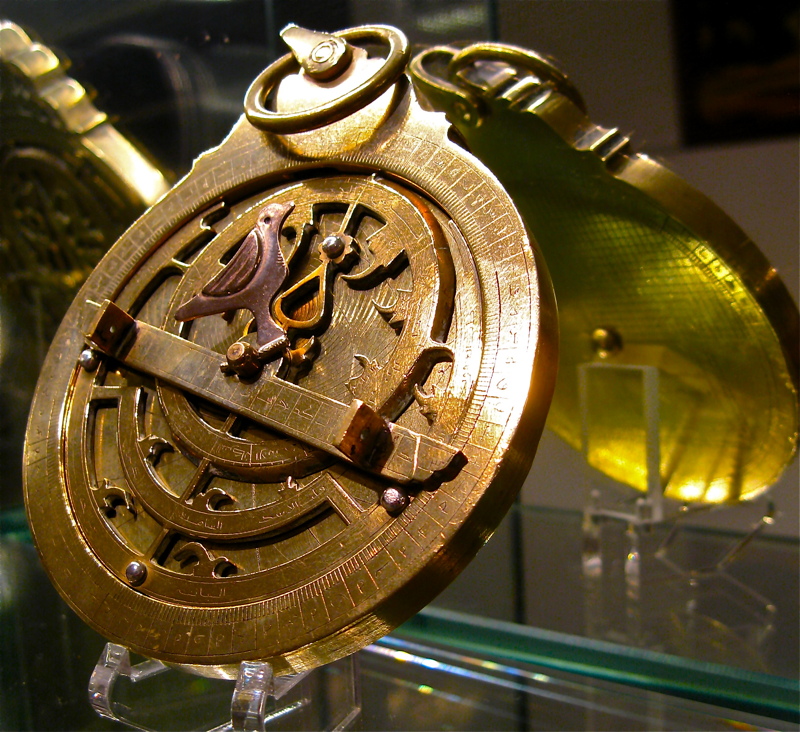

don't flash on my astrolabes, all are just a replicas, my personal capital didn't allow me to buy a genuine one at minimum 40/50 KEuros, it's hopeless, at least for me ![]() no one has a Koftgari work Quote:
gave a date, and think remember me, a Sultan name inside a thugra ![]() all the best à + Dom |

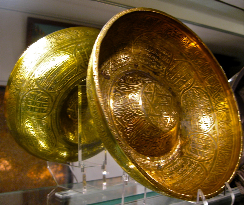

![]() here my most beautiful Islamic astrolabes 2 over 9 ... (replicas for indo-Persian) and my third treasure, an Islamic talismanic bowl in "tombaq" (Ottoman antique) enjoy ... as well as me, when every day, I see them with pleasure ![]() all the best à + Dom |
