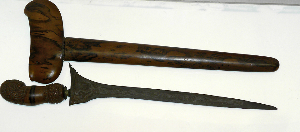

I casually threw out a bid on this keris simply because i liked the hilt. Kind of a bet an forget thing. The blade is nothing exciting and the sheath needs a little re-furbishing. But it was this hilt that caught my attention. And the price was right. Any thoughts?

Interesting hilt - not seen this type of carving on this kind of hilt before.

Very nice hilt with the kandit, I think this style is from the late 19th century. The price was indeed a very good one. I want to go for the other "keris" from the same seller, only for the hilt, but it went to much up. Please post pictures after your maintain.

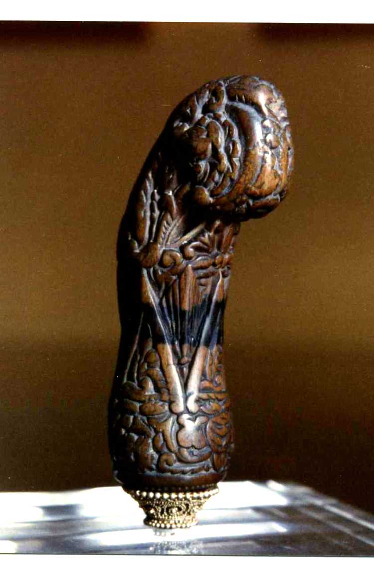

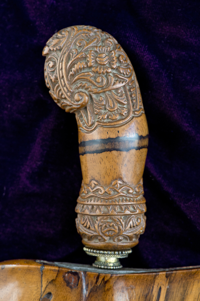

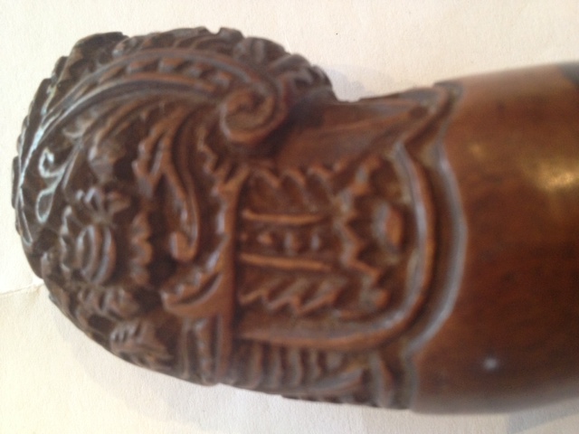

Since Battara and perhaps others are unfamiliar with this type carving I am attaching a similar type hilt (sorry about the photos, the piece is in the vault at the moment and I can't get to it easily for new photos)
Erik

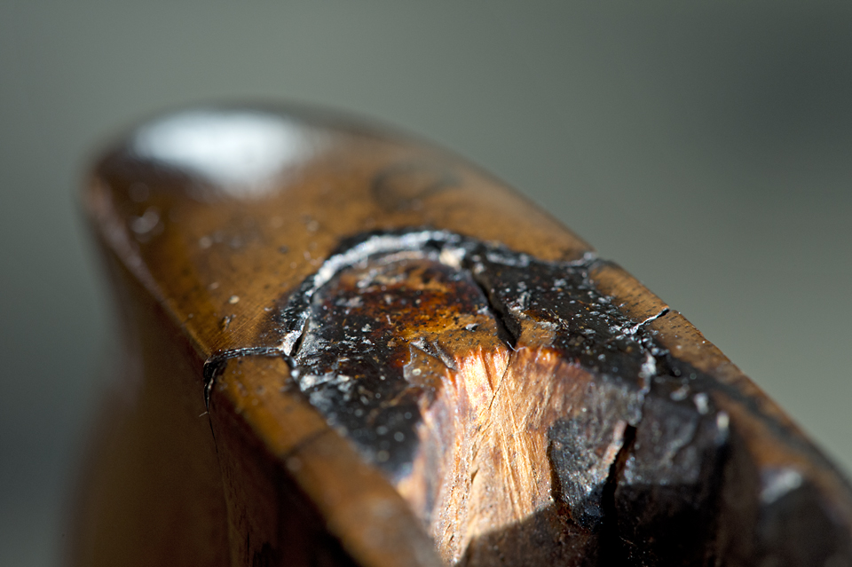

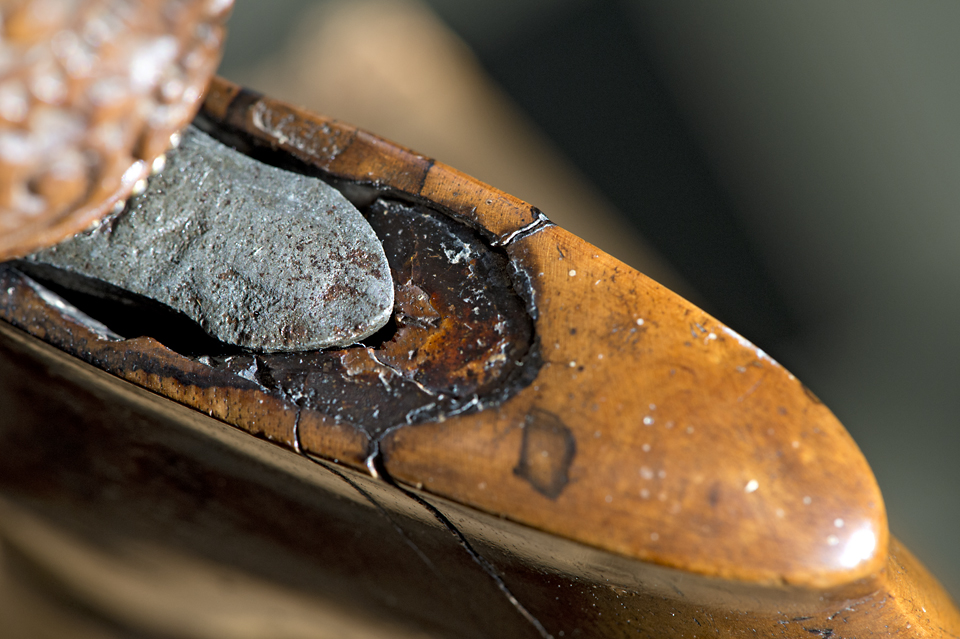

David, has the fill been done with wood or with shellac?
In the photo it looks like shellac.
A. G. Maisey is online now   Reply With Quote

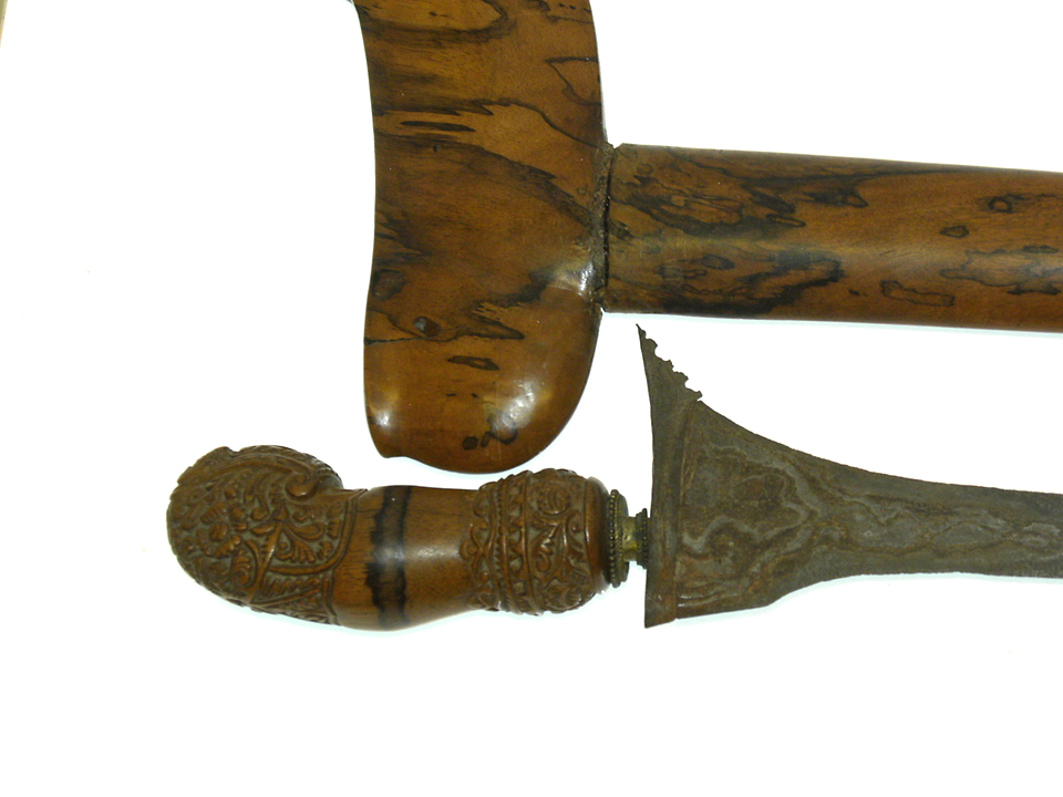

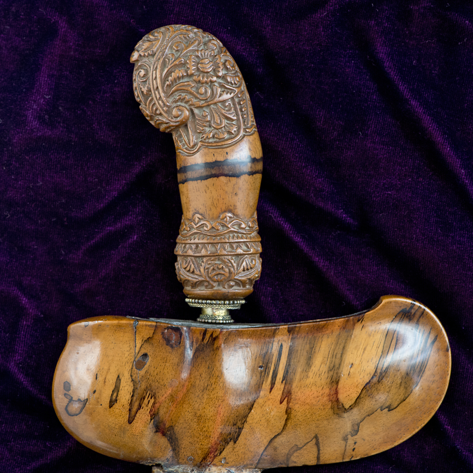

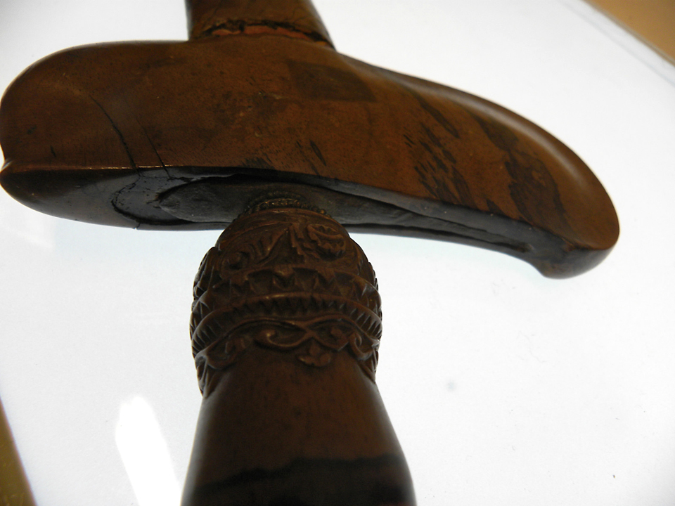

This keris arrived today and is proving quite interesting to me.
Alan, it looks to me that the wrongko refitting was done with wood. I think what looks like shellac to you is just the finish they put on the top part to help match it to the sheath. I will see if i can get some good shots of this tomorrow if the weather is good.
The hilt is really nicely carved and i'm fairly certain the kendit is true as well as the pelet wood of the sheath.

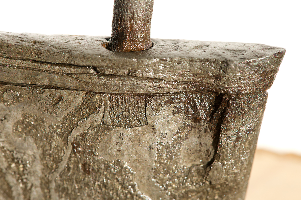

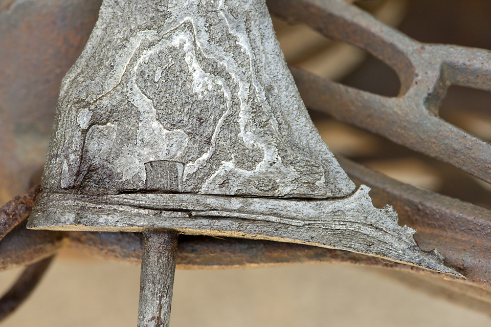

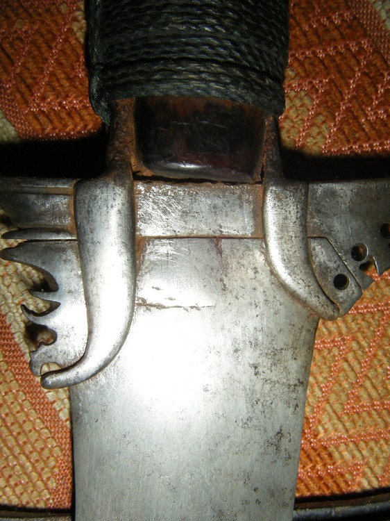

The interesting surprise i am having is that it would appear that the pesi might have been expertly replaced with an insert. It's a really nice, clean and tight job of i style i have seen done on Moro kris before, but not Indo. The blade is of better quality than the eBay photos show and it has some interesting pamor material. I will try to provide some close-ups of this when i get a moment and some good light.

I would have very surprised if the kendit was other than natural and if the wrongko was not from naturally marked wood. This particular type of hilt is quite scarce, I cannot recall ever seeing a bad one. You really did well with this keris, David.
I know of several ways in which a pesi can be repaired, I'll be interested to see what has been done with this one.

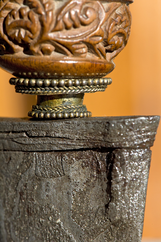

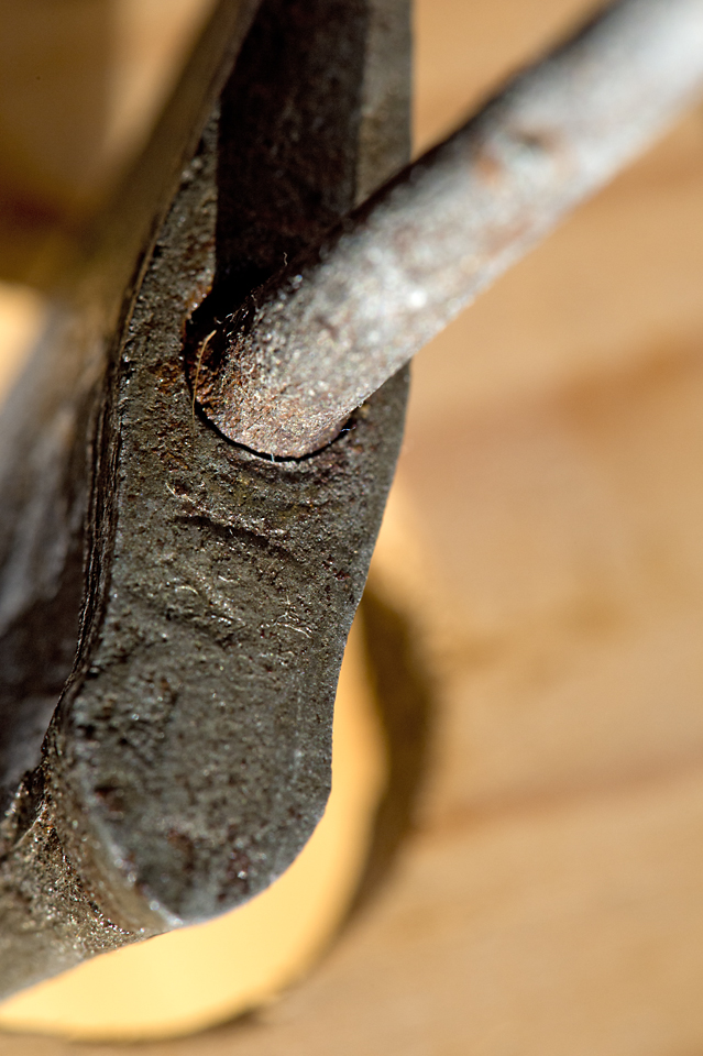

Here are some shots of the pesi repair as well as the old re-fitting of the blade to the wrongko. Alan, it looks like a wooden piece to me that was then possibly received shellac on top to help match the wood.
I find the pesi repair very interesting.
The blade has obviously had a hard life, but it has some features i quite like. I have only given it a preliminary cleaning to remove the active rust. Some of the pamor material is very bright and silvery and has some interesting characteristics. I think i will have to wait for warmer weather to stain this blade, but i think this is worth working on further.

Yeah, the wrongko fill is self explanatory.
I've seen that pesi job a few times, and frankly, I cannot make up my mind if its a repair or an alternative original method. A couple I've had have been a perfect match for iron, which makes me feel its original. If a bakalan was undersize, fitting an add-on pesi like this would save a lot of material.
When you forge the pesi into a bakalan you either forge down , and then you lose a lot through flaking, or you cut the pesi out of a bakalan that has not been forged down, and again you lose material. A pesi needs a lot more material to start with than you'd think.

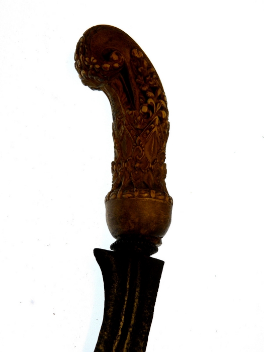

Nice keris ... with a very similar hilt I have into my collection .

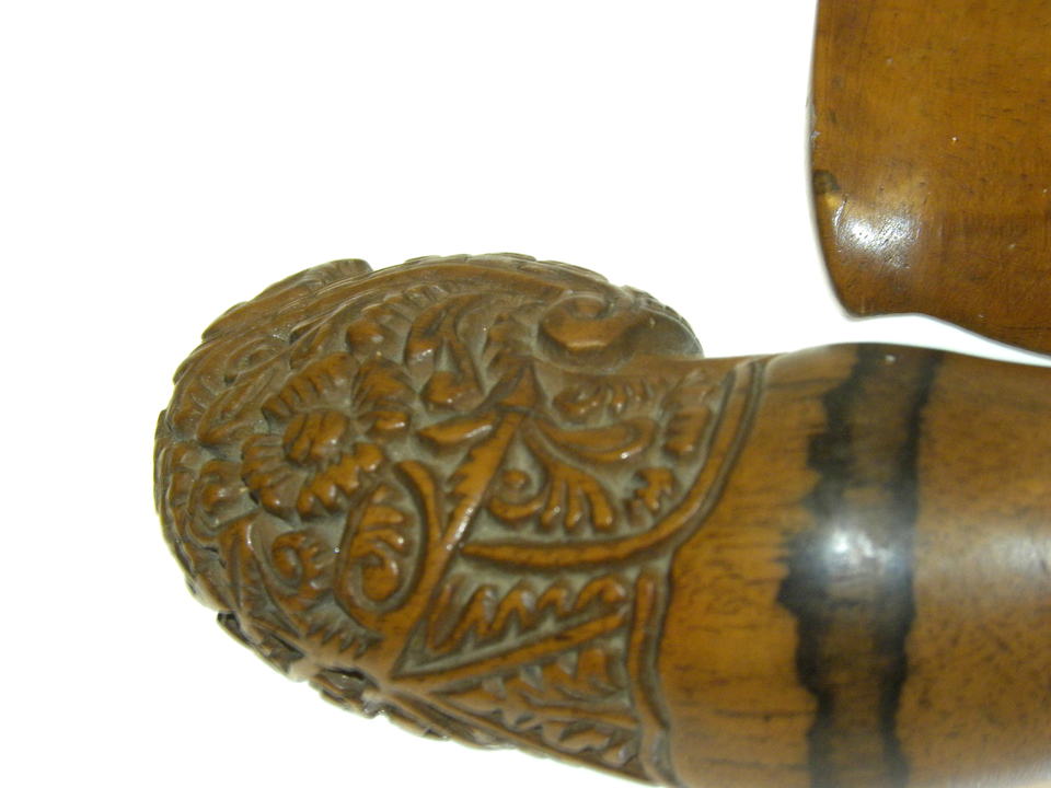

Posts: 6,441
After seeing three of these hilts in this thread that have a kendit ring in almost exactly the same place I'm coming to the conclusion that it is a staining rather than natural .
Well, i'm pretty certain that mine is natural having it in hand and Erik's looks pretty good as well, though his photos aren't so detailed. Not sure about Henri's, but my filling is that this style of hilt seems to be just for kendit wood. Does anyone have an example without the belt?

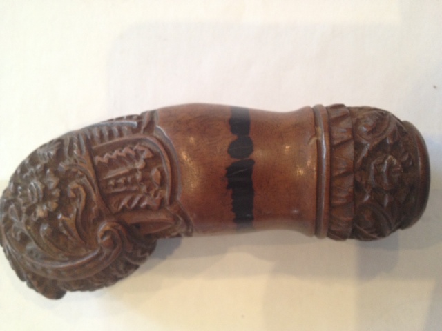

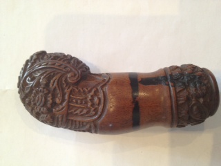

This one once was mine (stolen from my home).
This is only to complete the range of this kind of hilts.

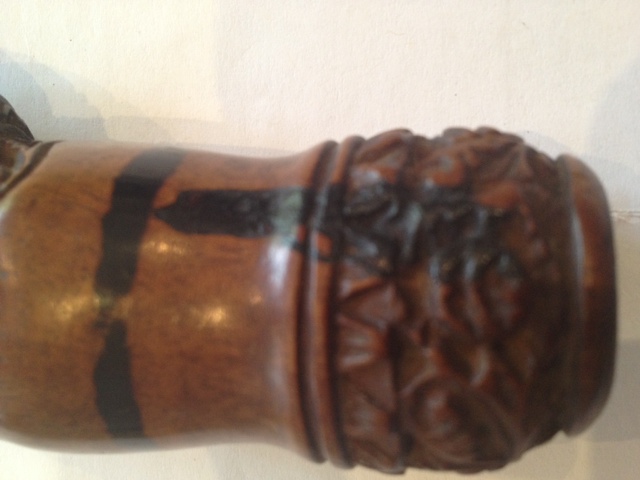

Please apologize. I forgot the pic

Gio, I like your hilt, but i would say that while it is a relative it is not quite the same style.You have too much carved area in the middle of the hilt while this style leaves that section uncarved. And your photo may be deceptive, but your kendit looks to be an add-on to me...

my intention was only to show the natural black stripe of the wood. I believe the hilt is Madurese.

Okay....are you sure this stripe is natural. It looks inked or stained on in your photos, something that is rather commonly done to create this effect.
