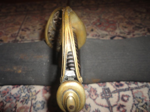

Greetings all!

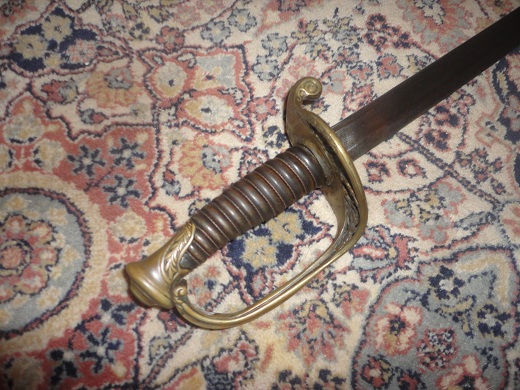

I believe I have here, a German Made French Model 1850 Foot Officer's Sword. This model of sword/sabre was also in use in the United States army until 1872. This sword was made by Samuel Hoppe in Solingen, Germany. The ricasso is marked on the right side; ‘S. Hoppe FI Solingen’ with the Hoppe beehive mark. The spine is marked Manuf re Nlle de Chatellerault. Blade is in very-good condition with a dark patina. I cannot see any with French proof marks. This example features a single-edged 77 cm blade with what looks like a false edge (never been sharp) extending back from the point. The blade is 2.6 cm in width at the hilt. There are two fullers, one broad and running from the ricasso to within 4 cm of the spear style point and a shorter narrow one from the hilt at the back of the blade. The grips are wire bound Bakelite that may have been once covered with fish skin? Although the wire is still there (may have been replaced). The pommel is of the “Phrygian helmet pattern” (need confirmation?) And is decorated along its forward border with oak leaves? The knuckle-bow is ribbed and pierced for a sword knot where it joins the pommel. As it turns upward toward the blade it expands to form an oval counter-guard, the reverse of which is plain, the obverse side decorated with a pierced floral design. All metal parts of the hilt appear to be brass. This example is missing the scabbard.
Can anyone confirm the model? Or help me with my enquiries? I am also puzzled by the marking FI (or perhaps FH) next to the maker’s name.
Kind regards,
Chris
P.S I apologise for the photos, they are not the best. Will upload better pics if needed.

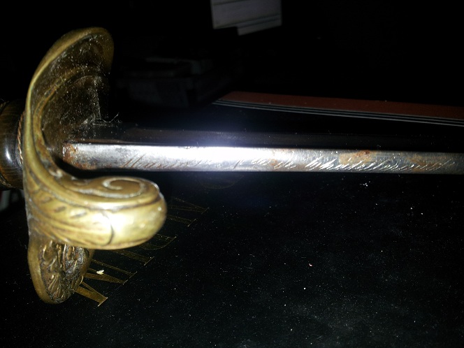

Default More pics
Hello William,
Thank-you for the interest regarding this sword. It is an older thread; but I am still (and always) looking for more information on this piece.

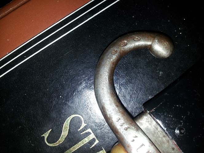

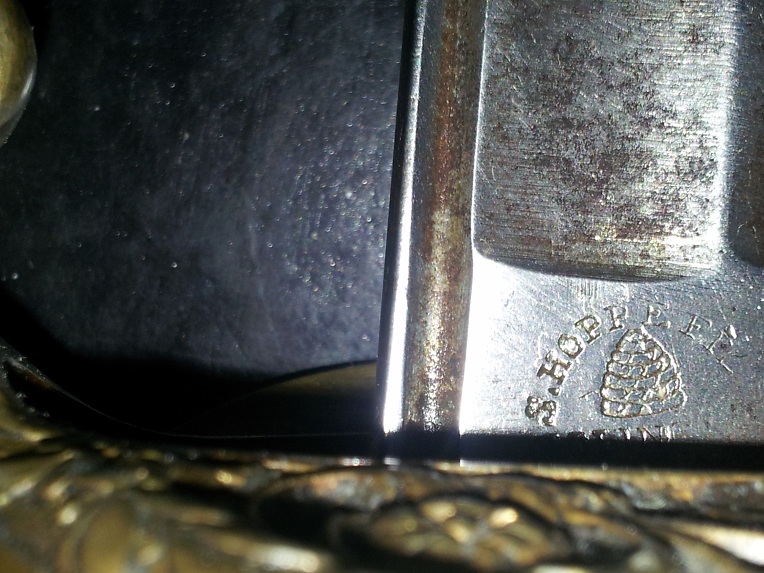

My good camera expired the other day, so I have taken these with my phone camera, I apologise for the fact these photos could be better. Regarding the makers stamp, I am still unaware of any relevance considering the mark that begins with an F to the right of the S.Hoppe. Additionally, I thought I would use this chance to explore the potential reasons behind the fact that this sabre has no armoury markings, I feel it perhaps slightly unusual that a military sword of this period would have no such markings. I have posted a photo of armoury stamps that mark the quillon of my 1866 chassepot bayonet. I have seen these stamps (or very similar ones) on other Model 1855 infantry officer's sabres and often ponder the reasons why my example would not be marked.
Any help you could give me to ascertain the possible history of this piece would be greatly appreciated. Thank you.

thanks for the good pictures, they are absolutely ok for me.
I can't tell you why the weapon has no unit markings (or acceptance marks) but I have a guess...
Some weapons were private purchased, so they belonged to the (normally) officer and not to the unit. This practice was quite common in Germany.
Getting back to the marking, I can clarify this one: S. Hoppe Fils. The children (french: fils) of Samuel Hoppe took over his business and used this marking. If you look carefully you can still see the lower part of the letter "L". It's a quite rare marking (seen only one of them so far). Even though I have no idea why the firm S.Hoppe should have worked with a French manufacture. They had their own hammerworks...
So far from me, I hope I've been of some help.

Thank you for the information, fantastic observation, this is very interesting! Regarding the unit markings/inspection marks, or rather the lack of, I agree that the most logical reasoning behind this lays with this being a private purchase. I always thought these were regulation officers sabres, so I wonder what advantage lies behind a private purchase, as an officer would be issued an identical sabre anyway?
Thank you for deciphering the makers mark, very interesting! I actually speak French quite well (my father is French) and it made great sense once pointed out. Indeed it would appear to be a rare mark, as I can not easily find others to research/compare. I thought I would mention, that FILS in French is actually translated to SON, so it would appear (and make sense) that Samuel Hoppe's son was the next manufacturer to take over the business. I wonder if the fact that this is a rare marking, means that the son either went into another business or decided to just stick with marking in his fathers name.

in fact the father never used the beehive as his marking. The son Ferdinand Hoppe (who took over the business) got it in 1847 by marriage to a Julia Köller, I suppose as part of the dowry. Since then the marking was used by S. Hoppe and Son(s).
And regarding the epee itself: I think it was personal fashion to wear his own weapon rather then a regimentally issued one. I'm not sure (I collect fencing and dueling weapons, so the military is not my area) but I think that an officer wanted to show his wealth when carrying a personal weapon belonging to him. And of course he could take it home as a souvenir of his time in the military....
