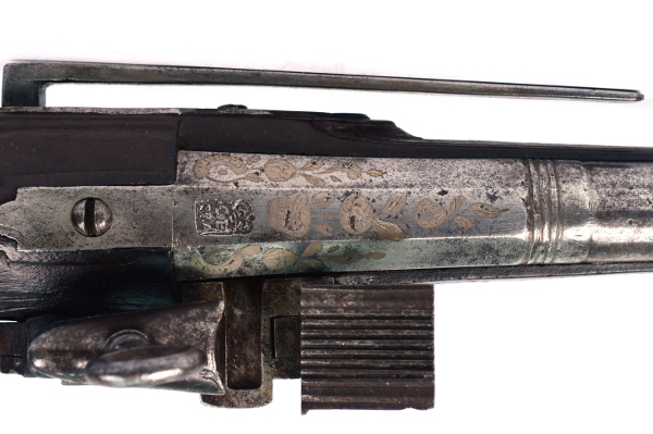

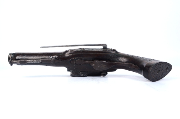

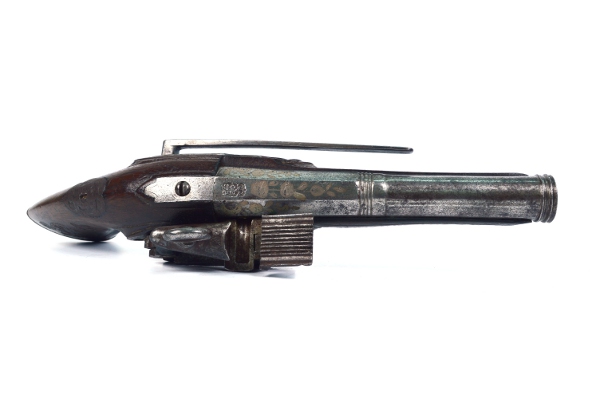

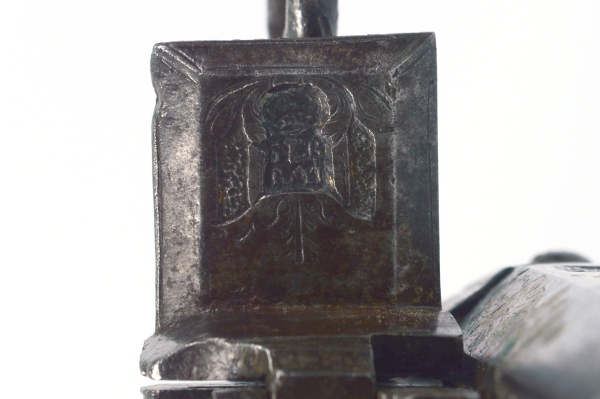

This Miquelet Pistol is one of a pair. It has a patilla style lock, a gold touch hole, a two stage pinned barrel, a steel ramrod and a side plate with an attached belt hook. The stock is Catalan style. The furniture was once blued with gold leaf in the relief. Very little of the gold leaf remains. The floral decorations on top of the barrel look like they are silver. There is a makers mark on top of the barrel and on the front of the battery. Both marks have a little gold leaf remaining. I haven't been able to locate the marks in the books that I have.
Overall Length: 11 2/8 inches
Barrel Length: 5 15/16 inches
Barrel Diameter at Muzzle: .640 inches
Weight: 1 lb, 8 5/8 ox
The only other thing I know about these pistols is that they were purchased at one of the first MACA Baltimore gun shows.
Can anyone tell me something about the barrel decorations or the maker marks? Any other comments or corrections would be appreciated too.

Old 4th December 2012, 04:17 PM   #4
At first reaction i realized these could be Portuguese; the tradional so called "egg butt" pistols. This eventuality brought me a significant enthusiasm . But after consulting someone experienced in this area, who dealt with several egg butt pistols from both XVIII-XIX century, with the three different types of lock, i was told these could be indeed Spanish versions.
If you have James Lavin "A history of SPANISH FIREMARS", you may be interested in observing gunmaker's mark #96 (page 277) named Seria. Maybe this is your guy.

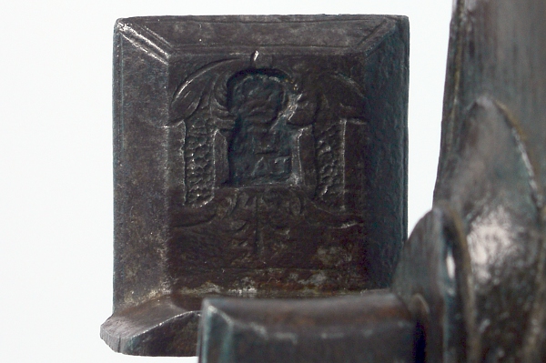

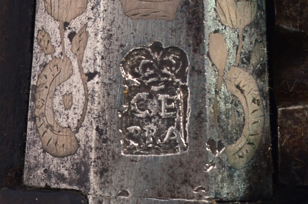

I guess that could be a "Y", It looks like a "T" to me and the style seems 17th century. These marks can really be critic. Looks like the barrel mark says CERRA. Have you seen a place name in one of these marks?
Here is the mark from the other pistol in the set.

You are quite right in that these things are often a dilemma to solve.
Weapons smiths weren't necessarily fine writers; the are lots of their names wrongly spelled.
The barrel maker is often a person other than the lock maker; the similarity in both marks lettering would just be a coincidence.
Cerra doen'st sound spanish (Castillian); Cierra would sound better ... but Sierra would sound best.
Serrat is a Catalunian name and matches with the lock mark letters; who knows?
XVII century ? I would be deeply surprised .

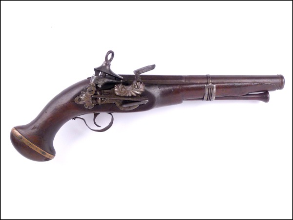

Old 13th December 2012, 02:10 PM   #20
Watch out for automatic translations. The term you got for 'butt' was the brazilian vulgar term for women's butt (bunda).
The actual portuguese name for these pistols is 'pistola de coronha de ovo'; it would be 'cureña de huevo' in Spanish. But i guess that, even this butt shape originates in Spain, the term coronha de ovo is genuine portuguese, with no pracrical translation.
Therefore the only chance to find the term in the internet is in portuguese. I have found a couple pistols in auction sites but the image was gone, as the items were sold.
I will be back with further info.

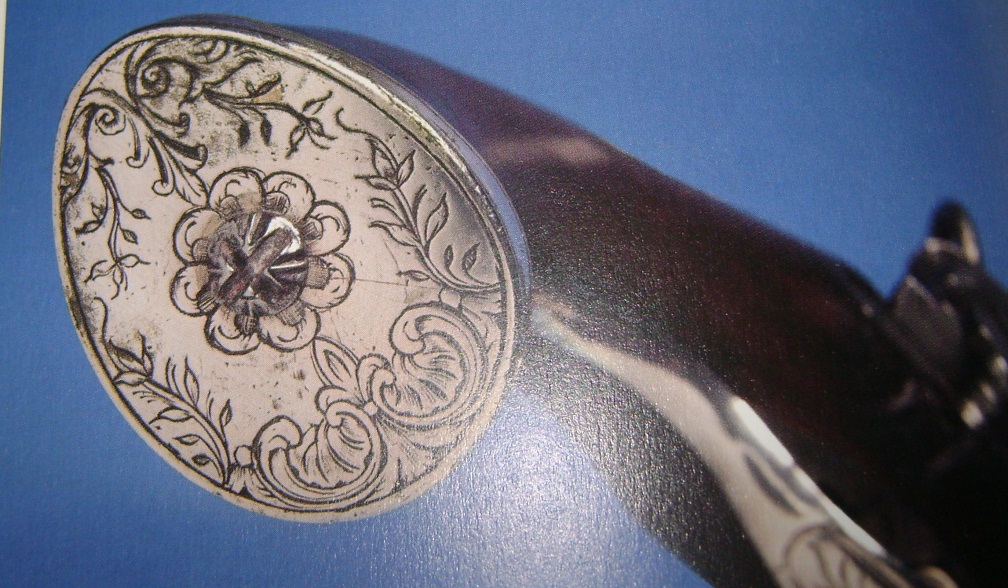

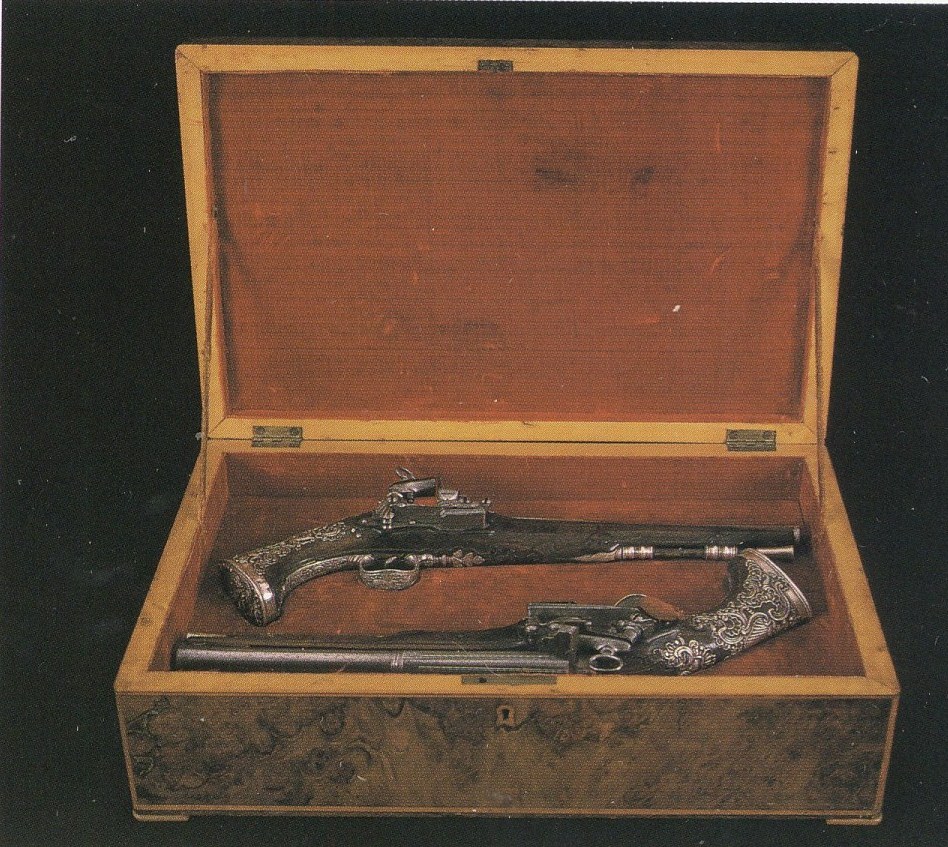

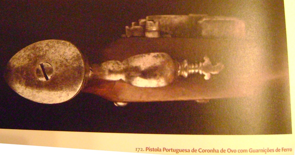

Old 13th December 2012, 05:45 PM   #21

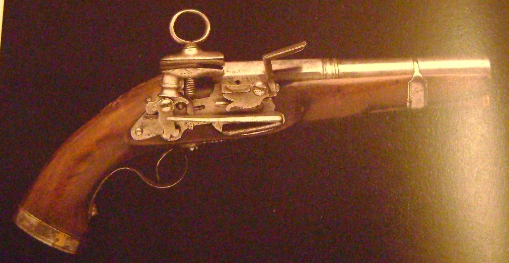

Here you have them of all kinds; ignition systems of all types ... patilla variations, 'half French-half Portuguese', 'Goats foot', English type, percussion and converted to percussion. Iron and brass butt plates ... and even one with rotary barrels.
One thing in common is the egg shaped butt ... that can be pointing to either direction.
One of the details that distinguishes Portuguese pistols from Spanish is that, the butt plate in the Spanish models is limited to the butt shape whereas in the Portuguese pistols there is a rim 'folding' to the stock
Sorry for the poor pictures. The book is a bit to heavy and large for me (one handed) to handle on the scanner.

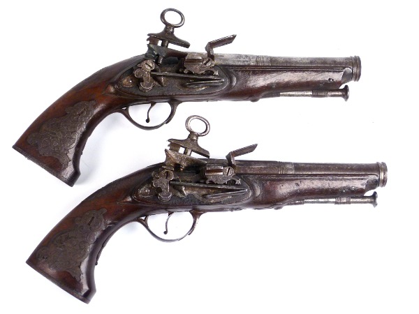

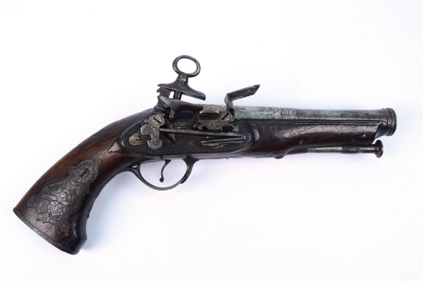

Old 14th December 2012, 04:35 PM   #24

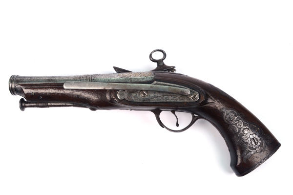

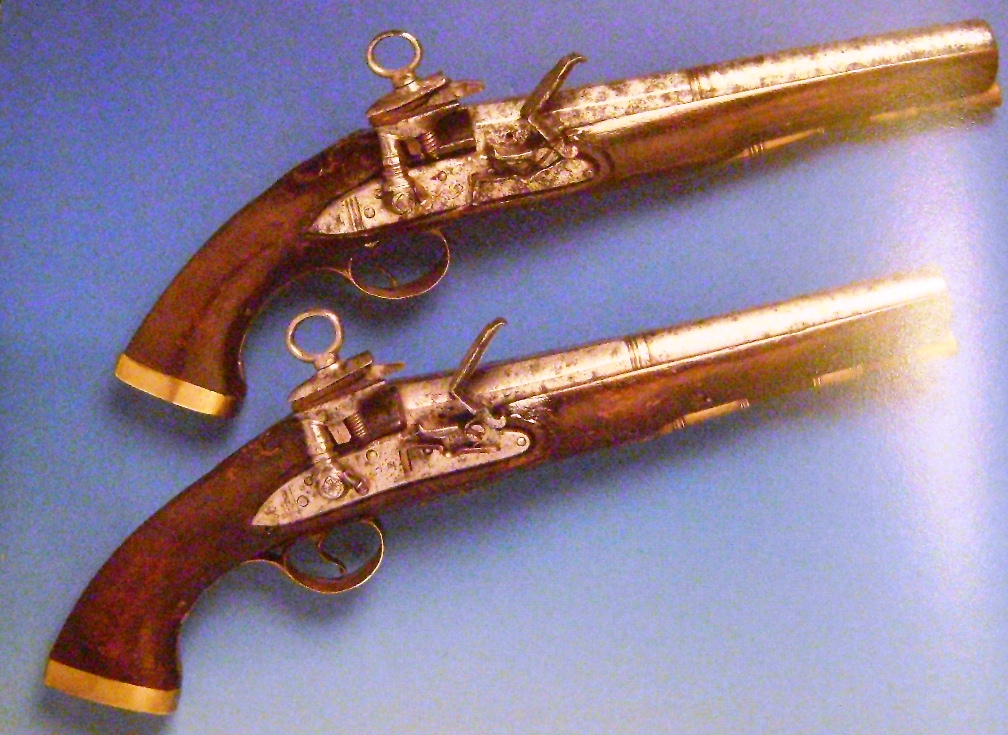

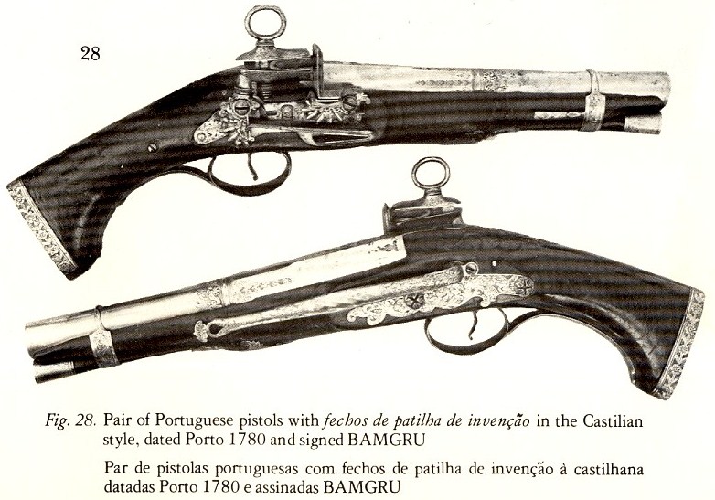

We also had our share of this stock style in Portugal.
The attached pair, dated 2nd half XVIII century, fully mounted and decorated in chizeled silver, belonged to General Povoas (1773-1852). Having later belonged in the collection of Dom Fernando II, is now in the Ducal Palace of Vila Viçosa ( House of Bragança).

That really looks like a Ripoll style lock. Do you think / know that they were made in Portugal?
dana_w is offline   Reply With Quote

I wonder what that piece is decorated, retained by a screw, located in front of the bowl (pan) and its flange (bridge)
Affectionately. Fernando K
Old 14th December 2012, 07:00 PM   #27
Hello, Fernando
There is also one in front of the hammer base. They are finely filed. They are described as mirrors (espelhos=espejos). I ignore their pourpose ... decoration, protection, dust guards.
I can see similar ones in a pistol made in Oporto dated 1780 and also in one made in (Ex-Portuguese Indian territory) Goa in 1776. I will try and find out what they are for.
Old 14th December 2012, 07:03 PM   #28
Yes,
The pistols described in post #27 are Portuguese and have the same type of stock. The one made in Oporto also has an egg shape butt, pointing upwards (quoting).
