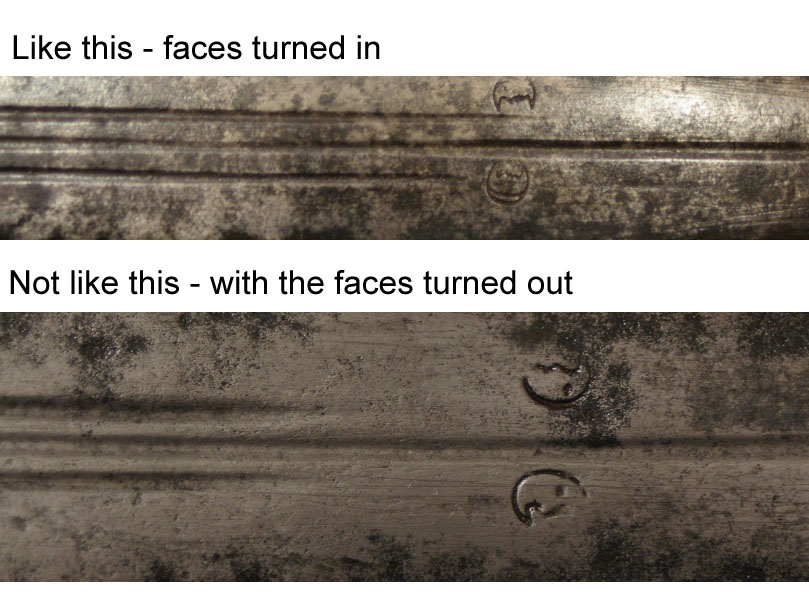

Hi guys,
I'm chasing down a potential tidbit of info related to the half moon (dukari) marks.
Very specifically I am looking for examples of triple fullered blades where the half moons are facing each other - as in the picture I am attaching.
Many thanks if others could post similar examples!
Iain

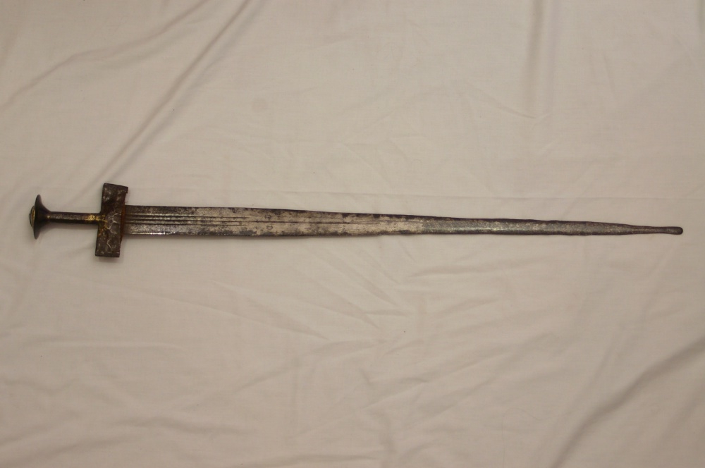

Posts: 3,191
Iain
As requested .

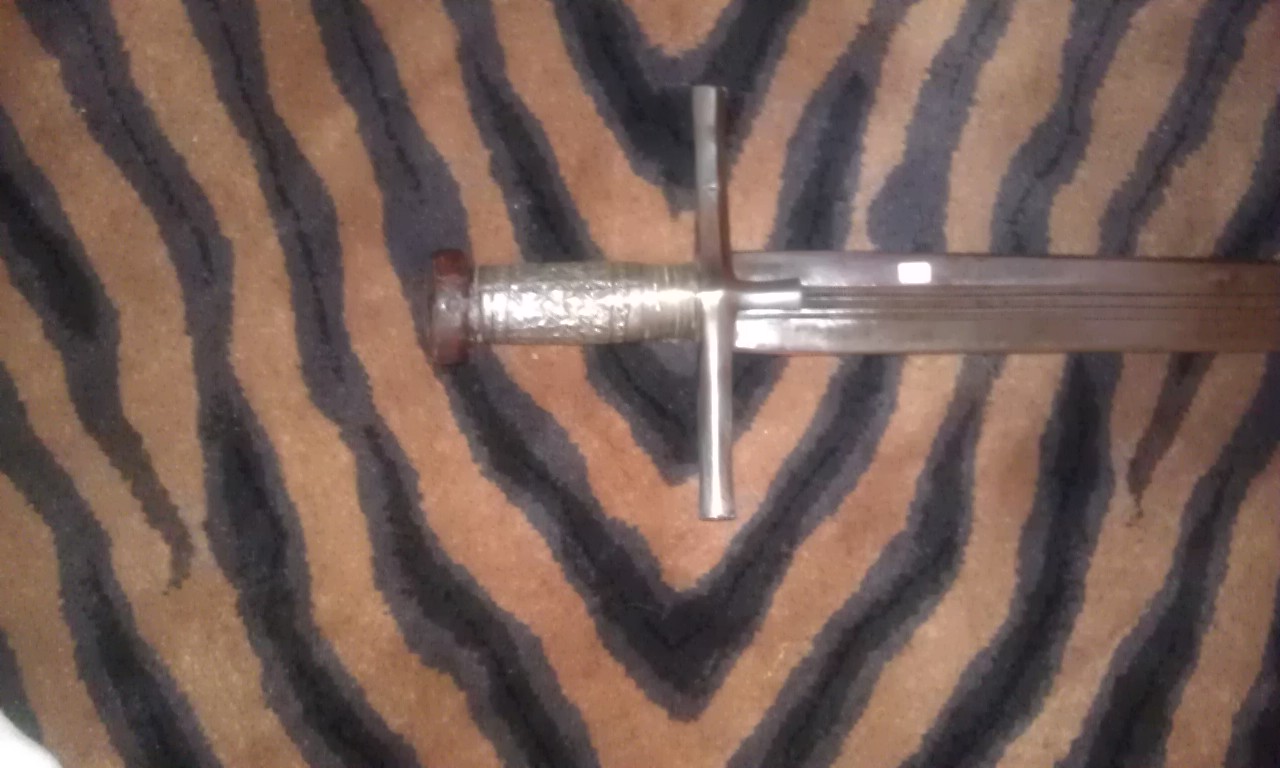

Old 18th November 2012, 12:44 AM   #3
regihis
Join Date: Nov 2010
Posts: 39
regihis is offline   Reply With Quote
Old 18th November 2012, 12:29 PM   #4
That one doesn't seem to apply.
Iain specifically requested examples of the "missionary position":-)

Thanks Lew for posting your kaskara - exactly what I was interested to see.
The reason I asked folks to show examples was because I ran across a reference in "Publications of the Princeton Expedition to Abyssinia" from 1910 regarding sword marks and their associated local value.
1. The "Rhinoceros-hoof Mahawl" is valuable. Its marks
are: three lines, a span long, above its pommel, and two
crescents with their openings facing each other, and also
the hoof of a rhinoceros. It is costly.
2. The "Running-stream Mahawl" however, has the lines
reaching to its point; it is cheap. Or, again, if one of the
lines is a little longer, and the two others are shorter, and
if the crescents face outward, it is [also] called the "Running-
stream Mahawl, and it is of little value, too.
Essentially it would seem that if the crescents face each other the value of the sword is higher - and thus likely to mean better steel etc.
I was intrigued by this because the only example I had pass through my hands with the crescents facing each other was an older Tuareg piece that had exceptional steel quality. And one I thought had a decent chance to be European.
So I thought it was worth seeing what else would turn up among the forums members.

I have started to suspect almost all half moon marks I encounter though. It seems that a blade being European is no indication the stamps are.
I have seen several examples now of thuluth blades where the half moon stamps are well struck, the blades are European, but the half moons are applied after the thuluth. Unless makers like Clauberg were doing the thuluth themselves the only conclusion is that within Africa, before resale, the blades were being stamped. Even if they were European blades.
That is why I am trying to find more examples of verified European swords (not just the blades) where the two moons have the faces pointing outwards.

Yes that is the generally held idea - the more detailed and well struck the marks the more likely to be European originals. I would have to say the marks on your sword are exceptionally well made.
One of the things I look for is if the marks are of an even depth - struck when the metal is hot. A lot of the native marks are unevenly struck due to being done "cold".
An interesting thing, is that of the triple fuller blades that appear to be European that I have seen, most have not had half moon marks at all! But rather nothing, or astral engravings (moon, stars, etc).
