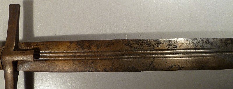

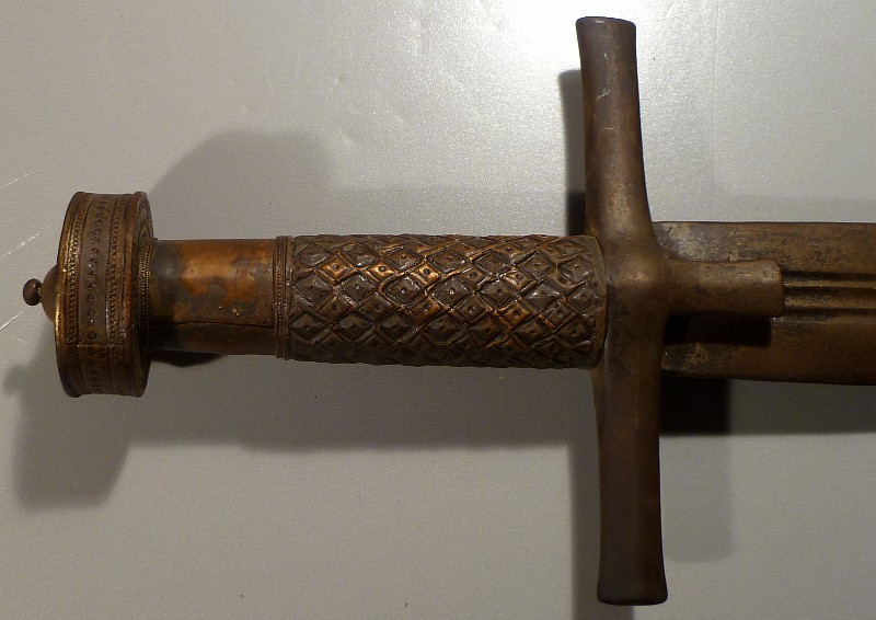

I believe this is a Kaskara, but what I would really like to know is how would one date the piece?

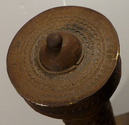

There are no symbols or names or writing that I can find. It has a stamped (?) copper grip – the design is of diamond shapes with indentations in the center of each and the pommel is stamped a different repeating designs in each of the concentric circles on the top, as well as circles of designs on the side. It was displayed with 2 other swords on a wooden plaque – either a shield or device for displaying a crest and had a note on a small string tag saying '3rd crusade' and I always thought it to be a ‘decorator’ piece.

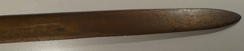

Length is 42", the guard is a hair over 6" wide, grip and pommel about 5 3/4" long. Any help confirming identity and age would be of help.

I am intrigued with the diamond patterning on the hilt.....very similar to one I own. As to the reference to the 3rd Crusade ....it was falsely believed that some crusader swords had become re-hilted as Kaskara

Nice example Longfellow! and as David has well noted, the notion that kaskaras were typically carrying blades from the crusades is possibly key in the note on the string tag, as it is a quite old 'chestnut' perhaps indicating this one is from a very old collection.
It is known that some old European blades did indeed often occur on kaskaras but those as far as I have known were quite rare and those blades disappeared into collections back in the 19th century. More modern European blades exported into North Africa during the 19th century and even in degree into the early 20th were well known.
This blade appears to be a native made product of the triple fuller type which was seen throughout trade routes linking Sudanese and often Saharan regions and is possibly of the period around 1890s or more likely into the pre WWI period. The hilt characterizes style associated most with Darfur with the lozenge pattern silverwork and discoid pommel.
Swords of this form became produced in more modern times around 1960s in Kasalla, but I think this is an early example from pre WWI, possibly as late as 1920s. Is the string tag note an old one?

As noted, your kaskara appears thankfully to be untouched and as such, clearly static in collections or stored for quite some time. It is unclear exactly when this diamond type motif and the discoid pommels became popular, but we know they were in Darfur and at the time of Ali Dinar, who was killed by British forces in 1916. These apparantly became quite popular with Hadendoa and associated tribes in later years, but the style seems generally held to be from Darfur and Kordofan regions. The triple fuller blade is distinctly native in form, probably Hausa, and should have small crescent moons stamped at the base of the outside fullers.

Hi Jim, this blade looks a little heavier than most native takouba blades I've seen. But of course photos can be deceiving. Unfortunately while I've found a lot of good period accounts regarding trade and blades within the western Sahel things drop off a bit trying to find out more about connections between the blade industries in places like Kano and how that translated to kaskara in places like Wadia, Darfur and Sennar. Bornu was the buffer state between these Sudanese states and the Hausa states.
