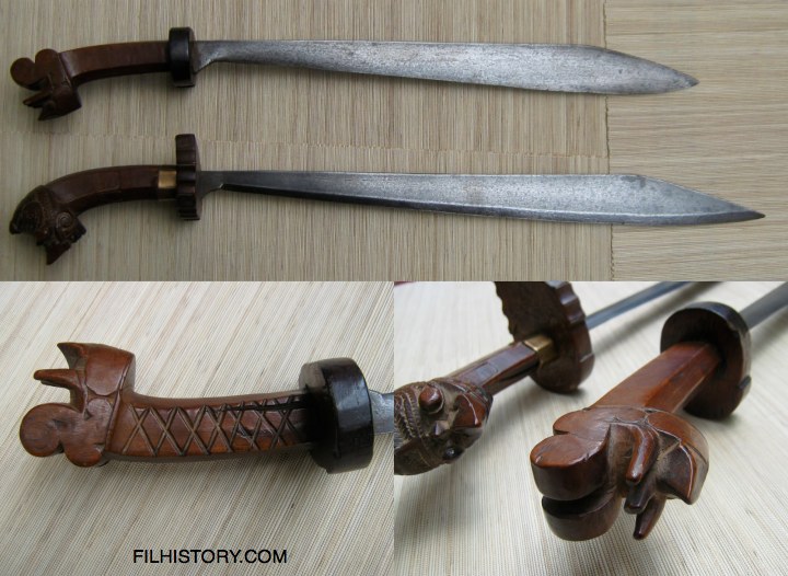

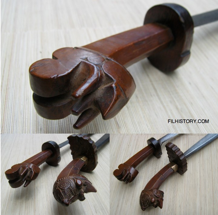

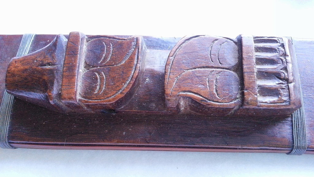

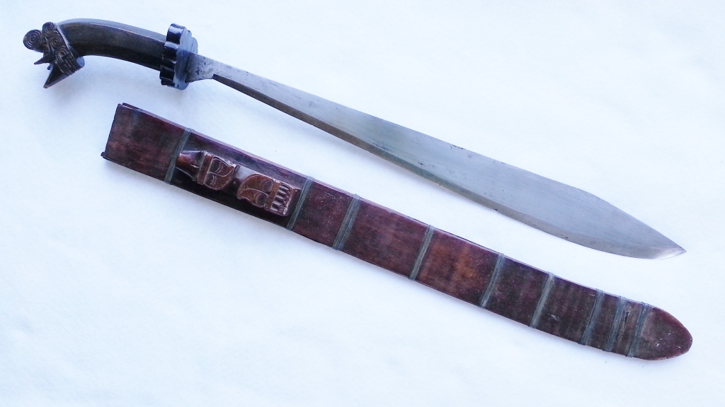

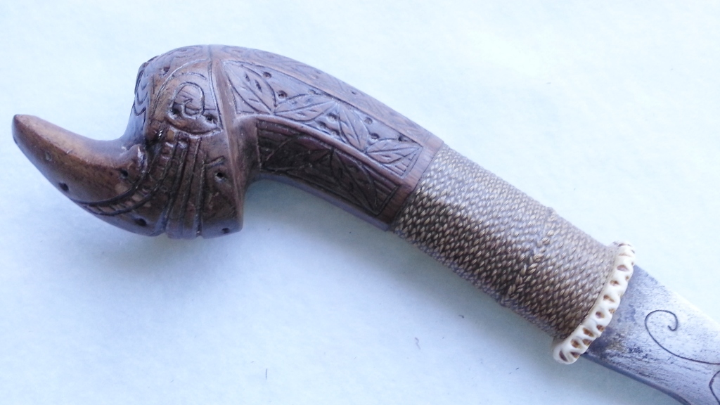

I just picked up this old Panay Tenegre.
Except the rare Bat-style of the Bakunawa-hilt it also has a rattan binding at the handle I haven't seen before.
Any comments and other reference pictures of these features?

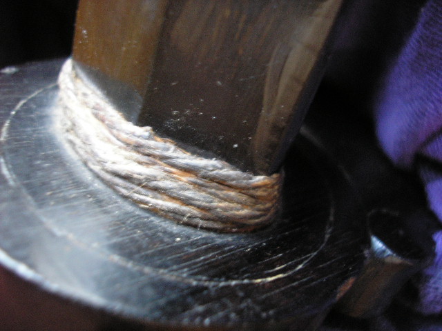

do you have this on hand, michael? it doesn't appear to be rattan; rather, it's twine, similar to the one at the base of the handle on mine. love the carving on the grip of your handle tho.
p.s.
photobucket is acting up and couldn't resize my photo. will try again when i get home

Ron,
I will be back home tomorrow and inspect the binding closer.
Look forward to see yours, too.

A BEAUTIFUL SWORD I HAVEN'T SEEN THAT EXACT HANDLE BEFORE I LIKE IT A LOT. I AGREE IT LOOKS MORE LIKE CORD THAN RATTAN PERHAPS SENNET (COCONUT HUSK CORD) OR SOMETHING ELSE STAINED TO LOOK LIKE IT. PUT ON TO IMPROVE GRIP.
THE SCABBARD LOOKS NEWER BUT STILL HAS SOME AGE AS IT HAS THE PROPER FORM OF RAISED DESIGNS. I HAVE OFTEN WONDERED WHAT THESE DESIGNS MEAN ARE THEY SYMBOLS TO IDENTIFY THE TRIBE OR ARE THEY A TALSMANIC SYMBOL FOR PROTECTION? THEY STRIKE ME AS SOMETHING MORE THAN SIMPLE DECORATION.
THAT IS SOME BEAUTIFUL WOOD IT IS LAYING ON TOO IT TOOK ME A WHILE TO NOTICE AS MY EYES WERE DRAWN TO THE SWORD.

Thanks Barry,
I don't have a clue about the designs on the scabbard either.
Maybe Lorenz or some of the other collectors have some ideas?
The wood it's laying on however is my dinner table.

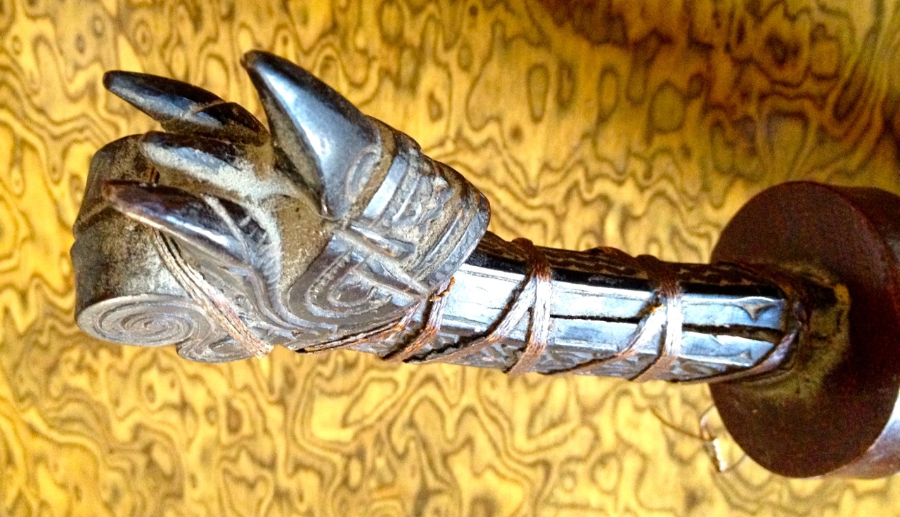

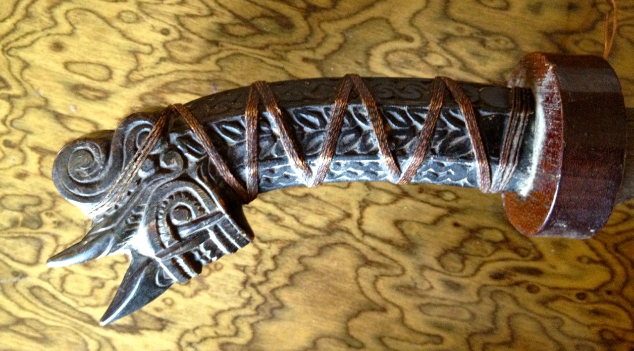

ok, photobucket is back in session, lol.

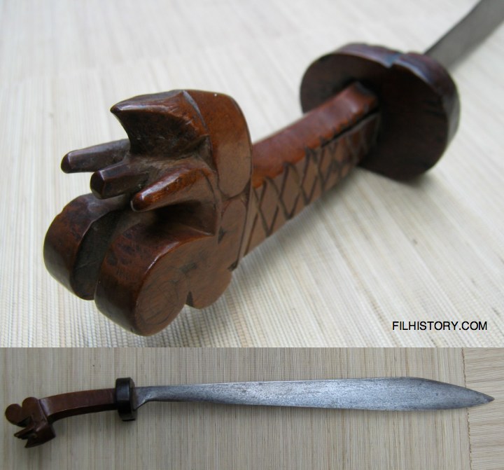

notice the twine at the base of the handle. i believe it's similar to the type used on yours. notice also, on another visayan handle: similar type of twine, i think...

I am not yet sure what the green items on the scabbard are. I will check closer when I am back home again.

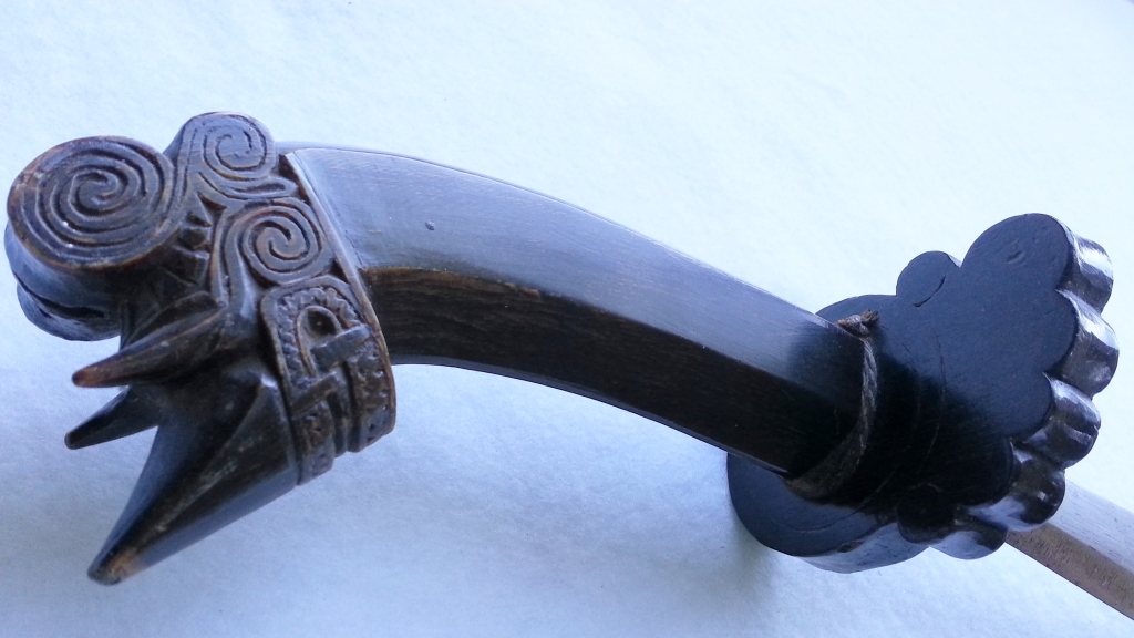

Nice references, Ron.
Do you see any traces of that your resembling sword also had twine all the way along the handle like mine?
What is the guard on your second one made off?

My guess is that the green stuff is from some kind of a beetle.
Old 16th September 2012, 10:45 PM   #11
Congrats, Michael & Ron: Very nice examples!
Without having had a chance to handle these, my first guess would be that the (laquered?/shellac?) twine on Michael's hilt got added to keep the developing crack from becoming larger (for an original design idea it distracts too much from the nice carving IMHO) while the twine at the base of Ron's hilt may just help to keep the guard from wiggling...
That looks more like a late, non-traditional addition to me. Is there any precedence for the use of beetle wings in Visayan culture?

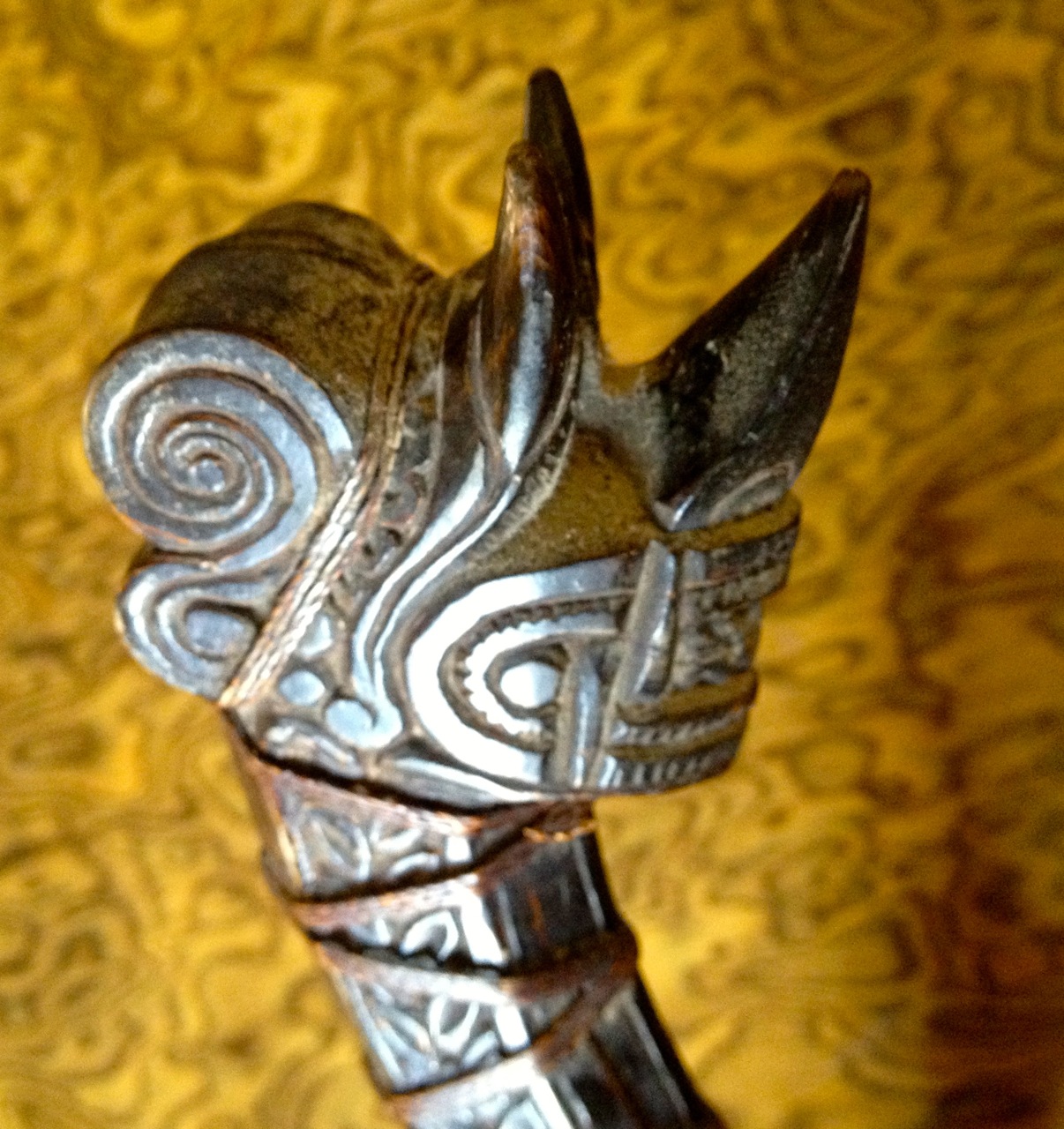

no trace on the handle itself, but as far as the twine between the handguard and handle, i believe kai hit it right on the head. pics enclosed are close ups of the twine. notice how it was wrapped around haphazardly (pics included).
i haven't figured out what it is yet. i keep thinking it's ivory, but freebooter might be right, in that it's a piece of antler.

you know, the handle on your piece reminds me so much of how some barung handles were wrapped in a similar fashion...

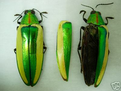

ITS LIKELY BEETLE WING COVERS FROM A BEETLE IN THE FAMILY BUPRESTIDAE. THESE COLORFUL METALIC BEETLES ARE USED BY TRIBES IN MANY AREAS OF THE WORLD FOR DECORATION AND JEWELRY. HERE IS A PICTURE OF A SPECIES FROM BORNEO, I COULDN'T FIND A SPECIFIC EXAMPLE FROM THE PHILIPPINES. NOTE ONE WING COVER REMOVED.
I have seen a mandau once with a piece of beetle wing cover under a rattan winding. I think it must be pure decoration. I can not recall that beetles have some spiritual meaning

It seems as Kai found the answer for the twine and Barry found the family of beetles.
When I use a loupe the wings on the scabbard have the same kind of dented surface as on your picture.
Ron, I was also thinking about the wrapping of the barong handles when I first saw it.

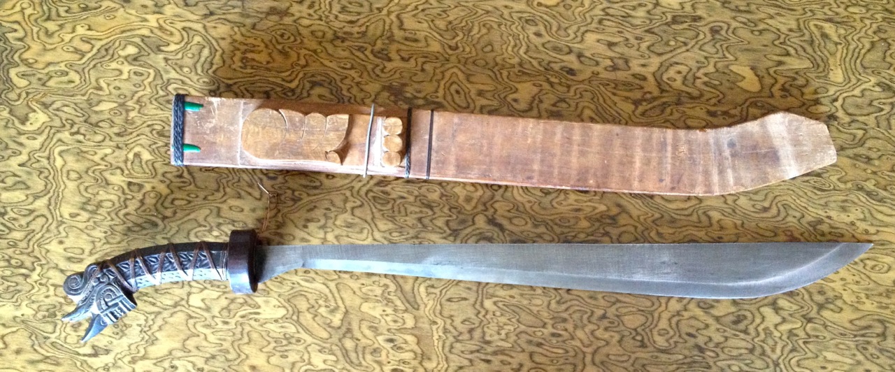

I have yet to figure out whether there's a special name for these 'bat'-pommeled Visayan swords. And I'm also still finding out whether parts of Luzon adjacent to the Visayas also used this sword (because some of these swords are not chisel-ground as we all know, like my example below).
My only input is that the pattern of the cord binding on the hilt is similar to the carving on my similar sword. Thus it sure looks that Michael's example is the older one. And my example would then be a latter less ornate version, and in which hilt the style of the cord binding was mimicked.
