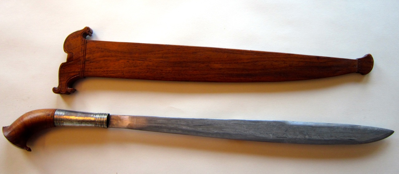

I picked up this sword at a local auction this Summer.
It's quite small, has twist core and I assume it's 19th C?
It also has a false edge.
What do you think it is?
Could it be a remodeled old twist core kris??
Do you have any reference pictures of similar swords???
PS I have had BIG problems etching it and have tried both FeCl and household vinegar.
Somehow I don't manage to get enough contrast. Any hints?

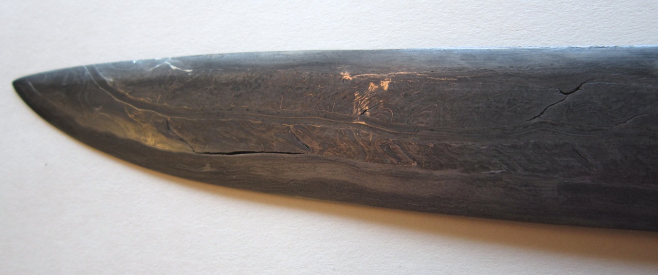

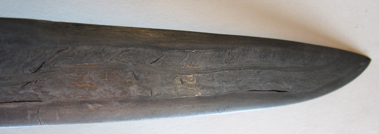

Wow, interesting piece! It looks as if the pattern weld is starting to come apart. Could this be the result of unskilled hands, i.e. the re-forging done by a smith who was perhaps unfamiliar with the principles of patterned steel? The handle and ferrule looks similar to that of a barong.

I'm pretty sure those are cold shuts showing on the blade .

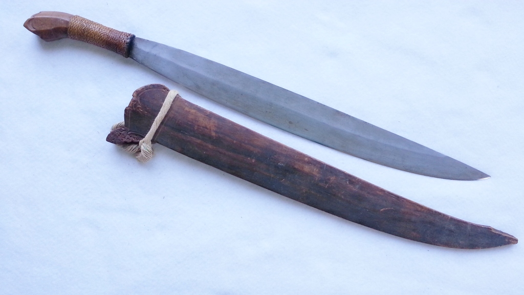

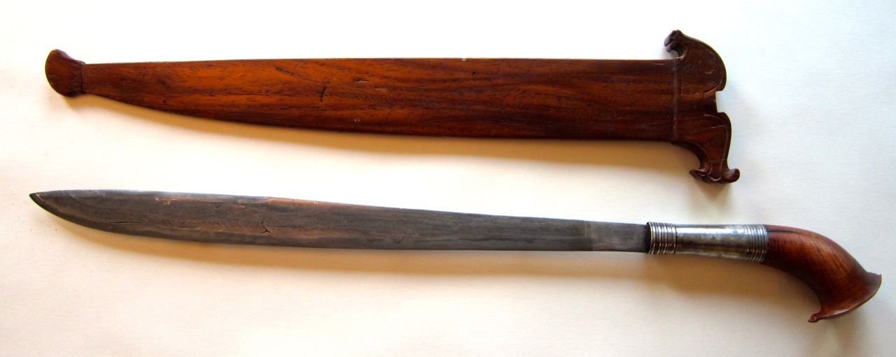

yup, that's moro. i believe it's similar to this here newer version, tho not as pretty as yours. the local term escapes me at the moment (those darn Sulu terms, lol), but yeah, it's kinda like a barung on weight watchers. yours does looks like it was salvaged from a twistcore kris, but then again, what's the dimension of this beaut you got?
btw, your would be the double edge version, while mine would be the shandigan type...

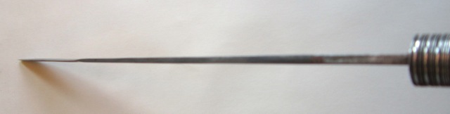

Mine is quite small - 22" with a 16" blade.
The width is 2 cm closest to the hilt and then reaches 3,3 cm.
On the sides it is like a barong, thick at the back and then an edge all the way on the business side.
It doesn't have any shandigan traits at the center of the blade etc.

so it's only 3.3cm wide at its widest??? mine is about 2". blade length is 19", total is 23.5".
i guess just like the barung, the older ones were shorter overall?

I know nothing about this type of knife, but I know very well forge Damascus: first, seeing the tip of the blade was forged for this knife, I think, the sharp reports, go to the tip. The welds are not perfect original. Even reforged, damask does not split like that. I also think the heat was too high and the temper of the blade badly made: the edge is split.

you know, the more i look at your piece, michael, the profile reminds me of an itak. yes the handle and scabbard are typically used on barungs, but i'm wondering if this particular piece was inspired by a non-moro sword.
