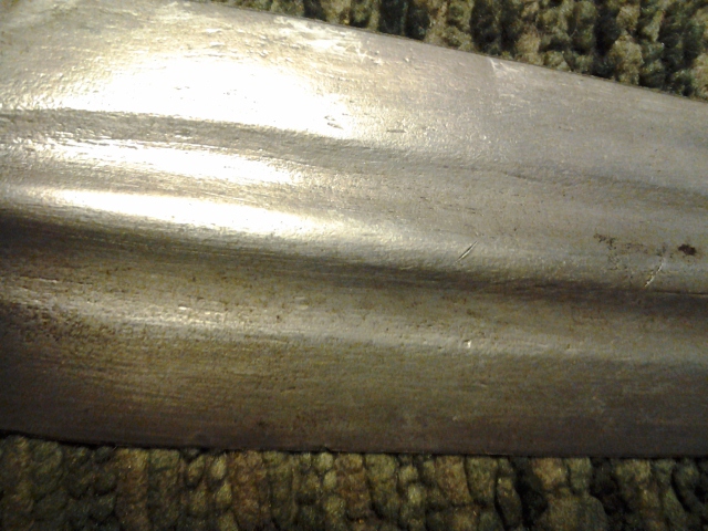

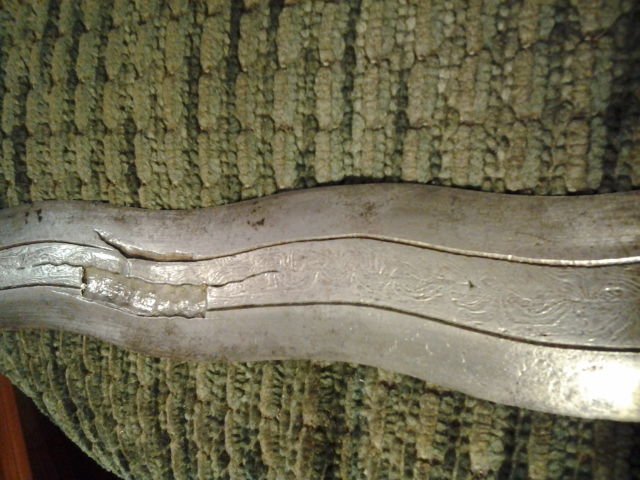

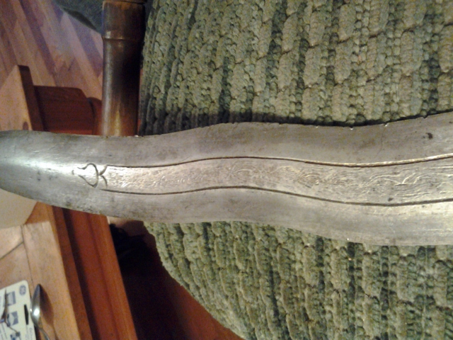

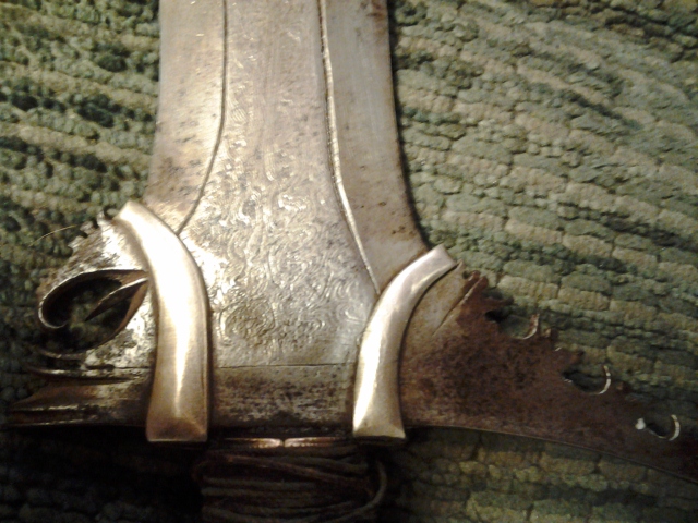

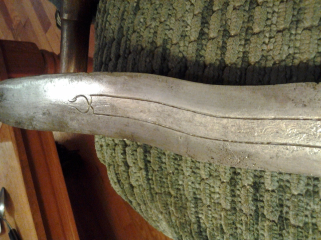

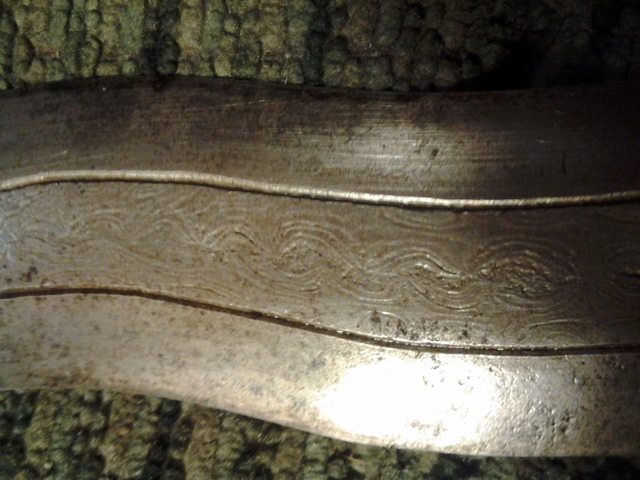

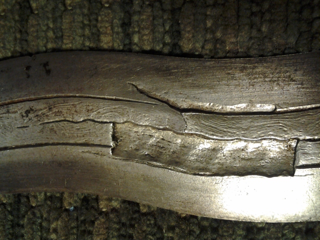

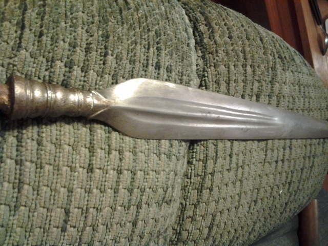

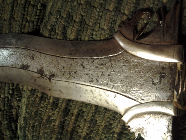

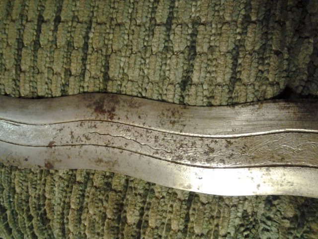

Ok guys been working a while on this now. ive still got a little bit of deep rust but veey afrqid it might get rid of the etching on the twist core. i noticed i only put one side of blade on here so here is orher side. yes it is cracked on the twist core. from what my grandfather has told me his father actually used it in battle and it came from that. is that a good possibility? looks like it got struck in that area. but i also got all rust off the spear. here are a couple close-ups on that. i myself cant see a twistcore yet. and ps. getting a family members journal or copy there of is almost impossible with the state of ks. but keep trying. what do people think so far on the blades?

Those are forging flaws that seem to have failed and delaminated .
Most likely from being under stress .
I think these pictures tell us a lot about construction of some twist core blades .
The spear is nice but has no twisted core .

I agree with Rick. Did not know that the damage was that significant. Still I think an etch on both of them would reveal the laminations better.

even if the welds were weak, the only thing I can think of to cause that sort of failure would be a severe bend and subsequent straightening with bending and hammering. Pretty interesting.

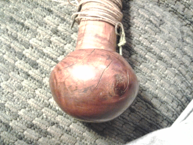

I used a laq. Natural jute thread to rewrap the handle. i dont know if there are any certain styles of braiding i could do. any thoughts would help

I agree. Forge flaws usually do not have such nice clean rectangular lines. It looks to me like a repair was attempted somewhere in this blades past life. Of course it's possible a forge flaw caused the repair to be necessary. One reason I like these blades so much is they where so hard to make. A very cool blade with history for your family and a story to tell!
