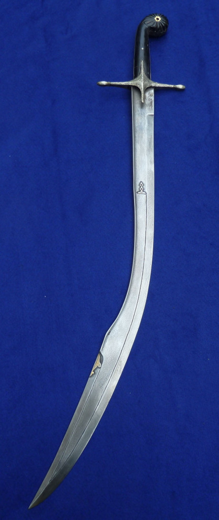

This "Pala" just sold on eBay for $4K (Item# 280935749770). The handle and crossguard are new. Anyone else thinks the blade is new? The buyer obviously did not realize it:-(

These are not my specialty. However, the wootz does remind me of the "eye" swirl of the modern Indian stuff. Still........maybe real.

Yep, a new piece. Infact, Kult of Athena website sells one very similar. What a shame really, totally not worth 4k.

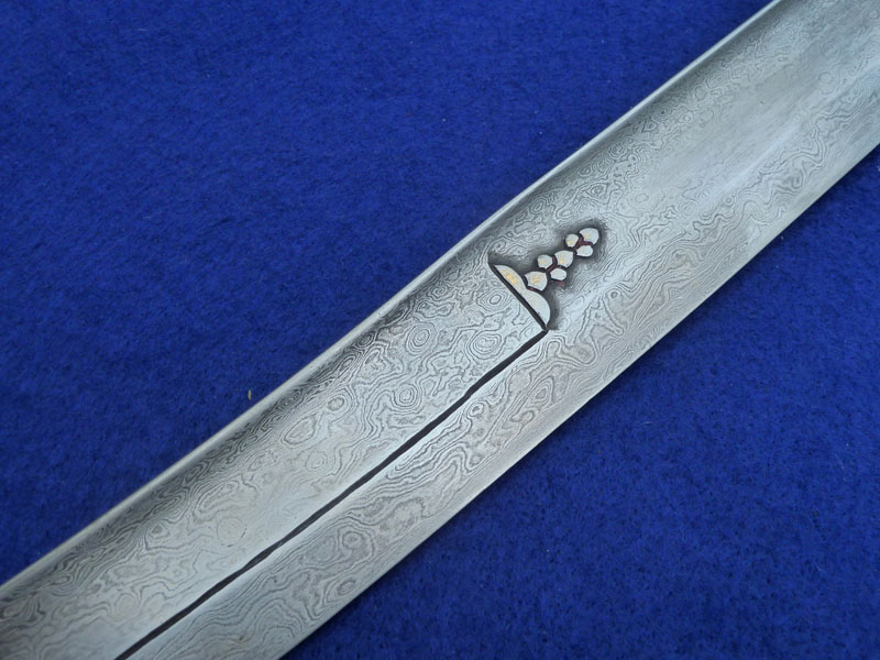

I'm gonna go with newer, it is not wootz but pattern welded damascus steel. $4k imo is lots of cheddar for this item.

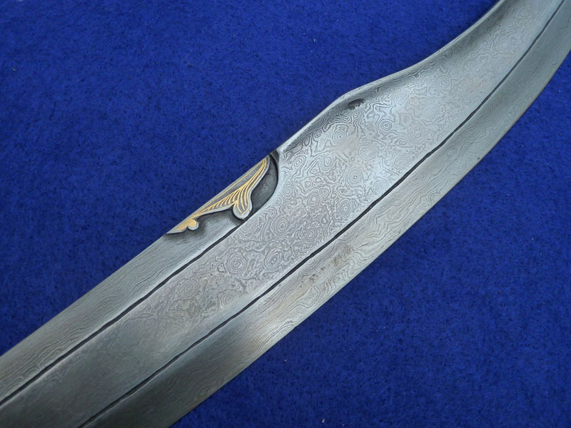

Signes of etched 'grey' even under the hilt scales, no wear, no oxidisation, no patina etc.
But very nice work on the blade.
The day is nearly here when pattern welded blades will all be suspect.

It is easy to blame the seller. But most, if not all, responsibility shall be on the buyer. With this particular Kilij, any "collector" should be able to spot the fake. If not, they're not ready to collect, and need to gain more experience, knowledge and expertise before plunging their money.

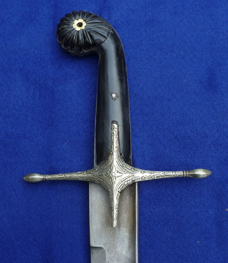

edged weapons.I find some remerkable good comments as well as some ridicilous ones.On this occation (the Indiian made pala ) all is new ,ıt is a cheap imitation including the cross guard.Please give a good look to the Koftgariwork ,3rd class ,nothing to do with Ottomans.Similar were up on sale at some of the famous Auction houses.I warned two of them and the items were delisted,

Good catch. I meant pattern weld.
I also noticed that upon second look the koftgari is more of the newer wire style used in India today.

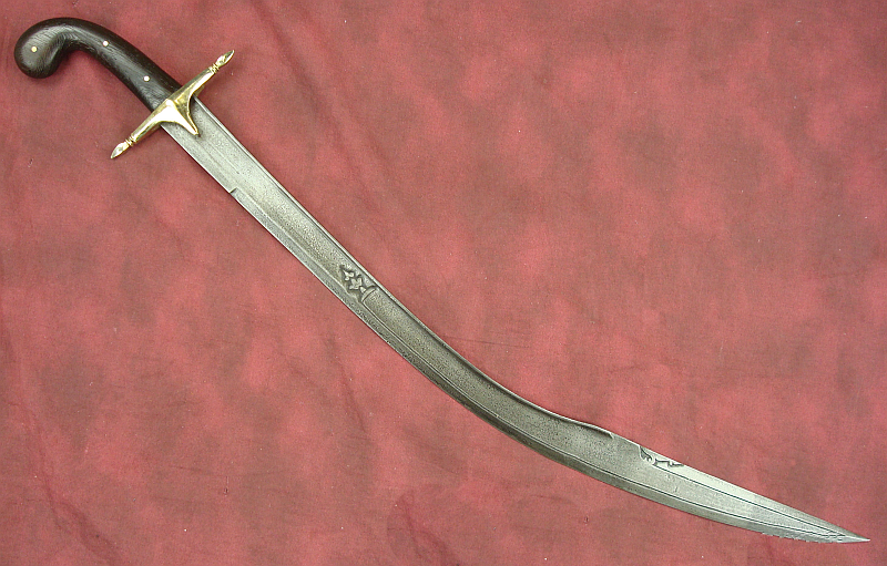

reminds me of this current indian made one for around $549.50 (plus $18 to sharpen it) i've been considering buying. they have a few in stock.
even comes with a nice scabbard. shipping from the USA is a bit steep tho. guess the tidbit of koftgari adds a few thou...
