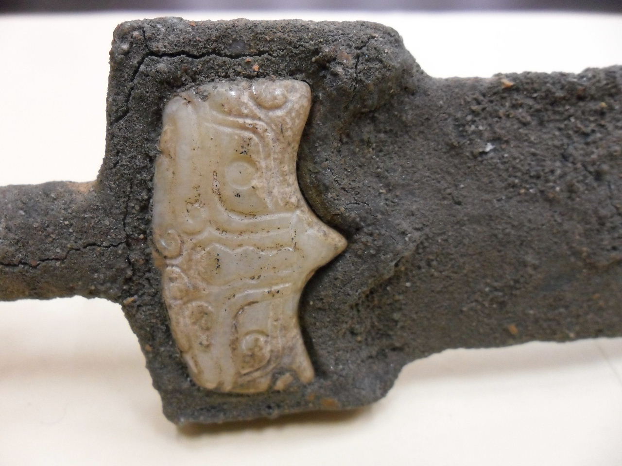

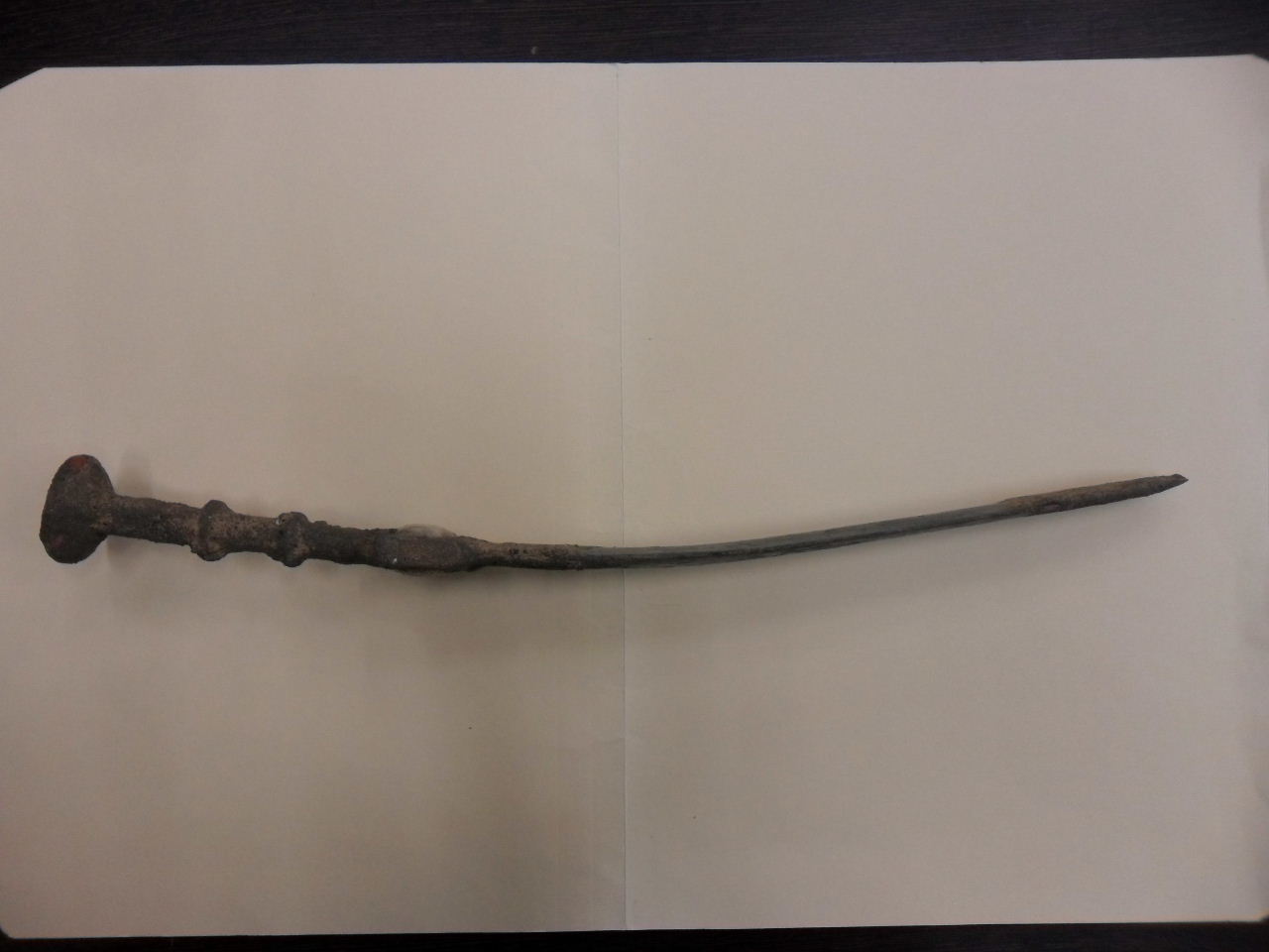

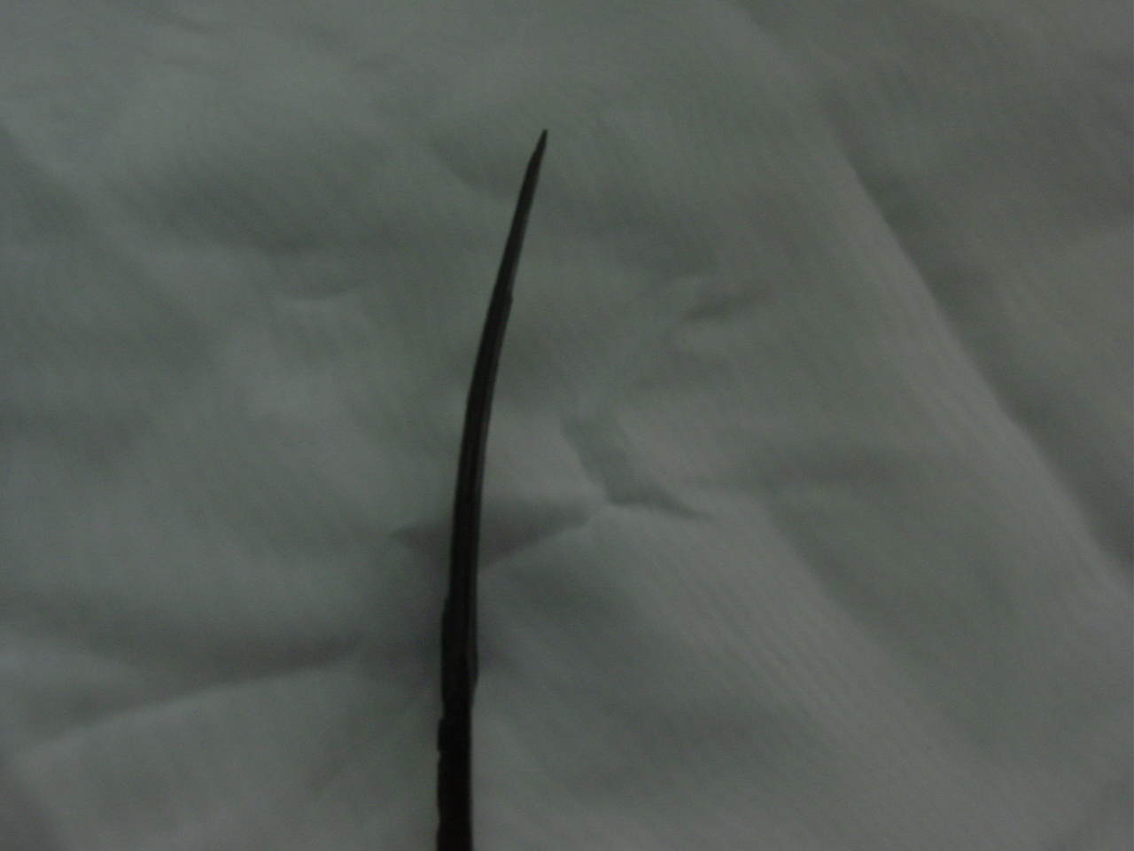

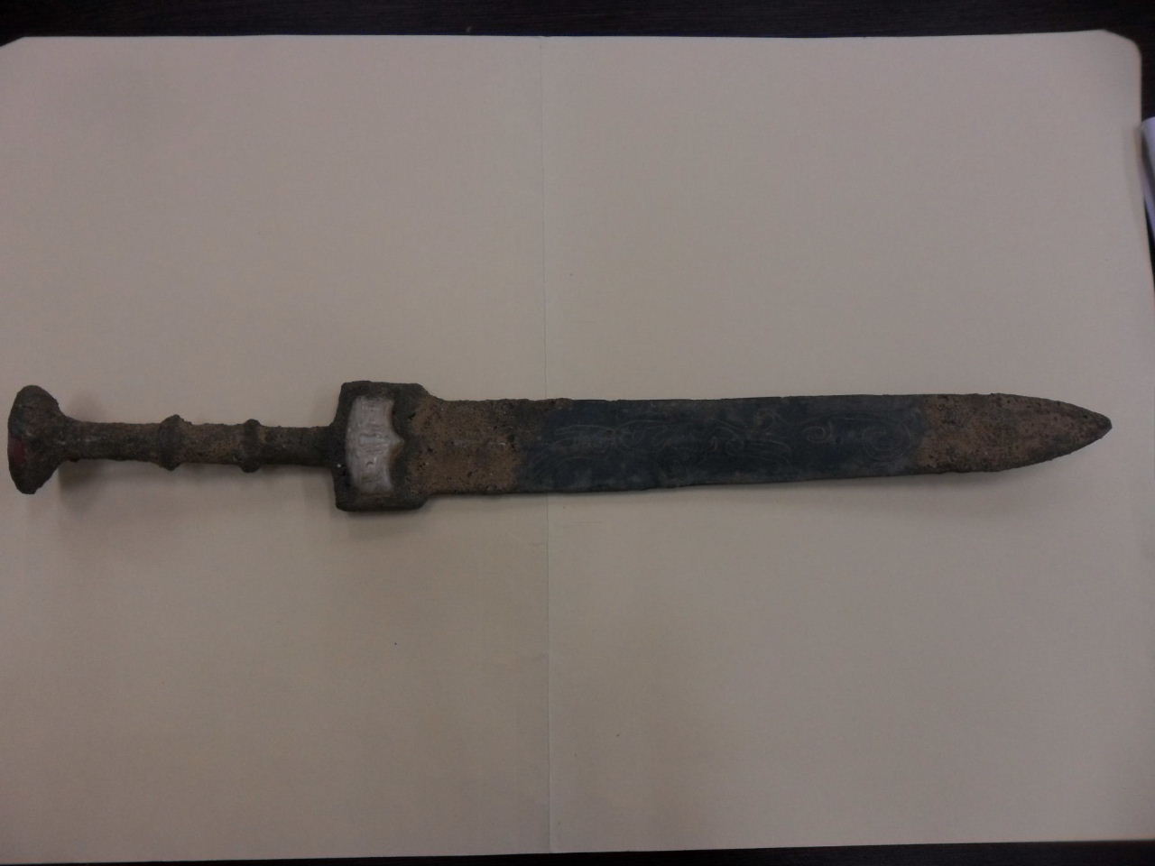

A friend of mine owns this dagger, is was straight when he obtained it & over the years it has bowed quite badly. I examined it & explained that one side is corroding badly & that side is expanding & causing the bend.
He wishes to stabilise it (assuming the damage cannot now be reversed) what is the best treatment to do this? Coat it with wax?
Any advise gratefully received. Adrian

Adrian,
I would advise your friend not to bother attempting to fix, reverse, or restore anything, as IMHO there is nothing worth restoring.
At present, I have in my possession about a dozen bronze artifacts, half of which are Bronze Age pieces. Two of the bronze artifacts are early ritual vessels from China (one Shang Dynasty, onr T'ang Dynasty) and four more are edged weapons.
Furthermore, while I cannot attest to having held a period-original Chinese Bronze Age sword, I have had the chance to see several exmaples in curatorial collections, and to see the corrosion process is parallel to ritual vessels of the same period.
Unfortunately, with regards to your friend's sword, I see several severe 'red flags' that would have resulted in a 'pass' should I have encountered it myself at auction.
Nevermind the fact that I have never once seen a bronze artifact that 'bent' like that over time. I am not a metalurgist and would be interested to hear from one about this rather bizarre claimed result of oxidation, on bronze or otherwise, though as I understand the corrosion process as it occurs on both bronze and steel, an 'expansion' shouldn't happen (aside from possible delamination).

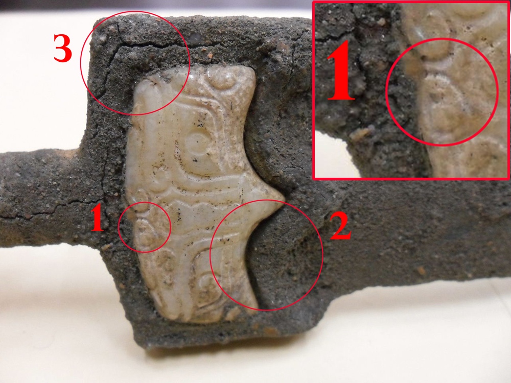

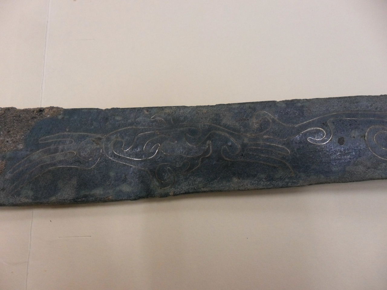

I found three severe concerns, each enumerated in the below photo.
First, no. 1 (shown up close in the insert) shows a clear 'ladder' artifact in one of the cut grooves that is a clear indication of a drill having been used to create this particular channel. Not only is the technique incorrect for the period, but the regularly-spaced intervals indicates the use of an electric drill, and thus modern manufacture. That would be enough for me to walk right there.
Second, no. 2 shows the fitment of stone to metal is crude compared to what one would expect from period work. Nevermind distortion from the 'bend' of the blade; there is simply too much variance in the tolerance between the two materials in any given section for it to be period-original work.
Lastly, the presentation of crackling of the epidermal layer of the encrustation (no. 3) is bizarre to say the least, and if - and that's a big "if" - it is a natural by-product of the corrosion process, it is a statistical outlier, something that in and of itself would raise concern IMO, and in conjunction with all the other red flags that present on this piece, makes me inclined to say with near certitude this is a knock-off of recent manufacture.
Sorry to be the bearer of bad news, but this field of collecting is nothing if not a learning experience for all of us...

Thank you both, 'Nando & Jim... It's always a pleasure to find an oportunity to contribute what little I can. Since opening our shop/gallery, we've had more Chinese lithics come in than I can count, both for consignment and purchase, and in that time I've spent more time analyzing "jade" through a loupe - and chasing down my observations - than I care to imagine...
With lithics, it's simply an issue of looking for tool marks that would be inconsistent for what an item represents itself to be. While this has the benefit of requiring a smaller tool kit than knowing & assessing accuracy of style, unfortunately the best fakers are able to render any sign of modern tooling invisible in the absence of proper lab equipment, making lithics the hardest category of antiquities to easily authenticate IMO.
With old bronze, it's more or less as with any field of collecting in that it's a matter of osmosis as a function of time and experience... primarily knowing how different accretions present themselves and how the patina changes over time - much as with any of the materials used in the edged weapons we study...

Hi Gents, thank you for responding & especially to Chris for his detailed reply.
Certainly the idea that the dagger is a fake was not previously entertained by me.
The swelling of what appears to be an underlying metal is odd, a magnet does not detect iron.

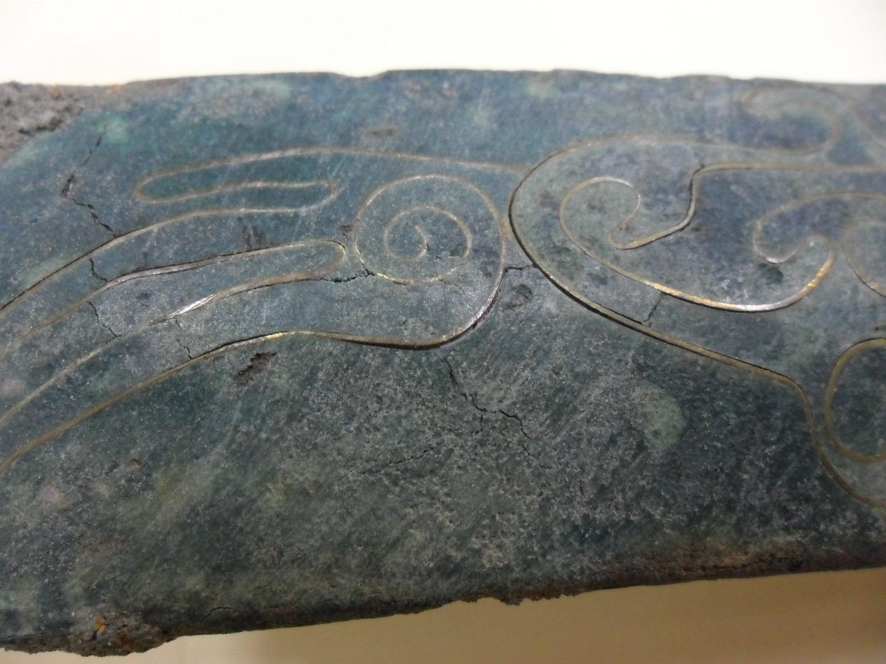

Chris with your knowledge of reproductions can you please suggest how it might have been made as I'm intrigued as to why it has bent over the years since it was acquired - supposedly this has happened since it was "excavated" & whilst I can imagine that happening I cannot so readily imagine it happening to a new item.
I have contacted the owner, supposedly this object came from a new dam site in China. Apparently objects found in excavations & discovered in buried caves etc that were to be flooded were given first to museums, the choice pieces, & the rest to workers etc to keep. Perhaps this is a familiar story does anyone know?
He theorises that the markings Chris points out are from cleaning the encrustation from the most attractive parts of the object - this does seem perfectly logical & can explain such marks.
Fernando perhaps its best to post in the correct section of the forum (my apologies for not doing so initially) & lets see if experts there can clarify the pedigree - or lack thereof - of this dagger.
Adrian

I, too, have encountered at auction houses items with a similar background story to your own, with a claimed provenance of having been uncovered over the course of the Three River Gorges Damn Project. However, not one is uncluded among the aforementioned pieces I referenced in my first reply, as with the exception of one lithic, I sincerely doubt the authenticity of the others sharing the same background story. Don't get me wrong - I have no doubt that artifacts are uncovered on a routine basis, as this is the norm in any archaeologically-rich environment.
However, I firmly place my faith in the credo that you 'buy the sword, not the story.'
With regards to this piece, I cannot speak to the 'cleaned' surface... old bronze simply presents itself with too much variation - due to differing alloys, environmental conditions, etc. - to speak with any degree of certitude by looking at a photograph. However, the aforementioned issues provide enough visual clues to reach a conclusion.
With regards to the distortion of the metal as a result of corrosion, that's a first for me... Like I said, I've seen delamination due to oxidation, but not this kind of deformation. Let's hope one of our metalurgists can chime in on this.
Lastly, I rarely doubt the veracity of someone's claims on the face of the claim alone (or at least express my doubt on record), but I have to question your friend's claim that he is responsible for the artifact I highlighted in my earlier reply. I have a very hard time believing someone - anyone - cleaned out the channels of the face of the stone insert with an electric drill and that the result just *happened* to present itself very similarly to every modern Chinese knock-off lithic I've seen in which electric drills were used to create the finished product.

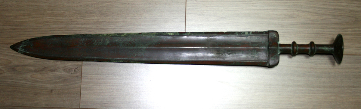

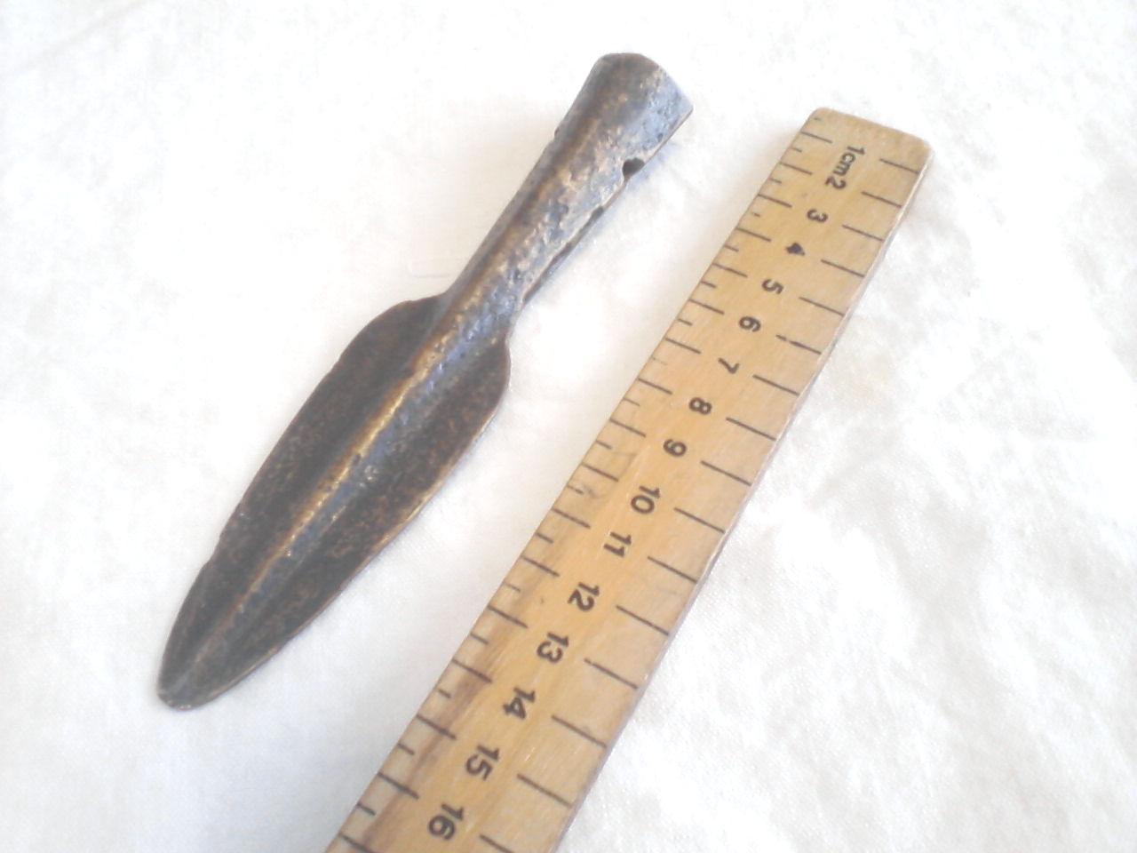

I have one almost exactly like it (not pictured). I got it back in the 90s here in Korea; it was brought in from China. Mine's a fake, but interesting. Actually, I used to pick up imitation Chinese bronzes, as some of them are very well-made and look nice, even if not original. Attached is one of my favorites; I often use it in my Korean history classes so students can feel the weight of a bronze sword. Many years ago, I used to have a reproduction "bipa" (an ancient musical instrument) shaped bronze sword, which was used in NE Asia, but someone else wanted it a lot more...

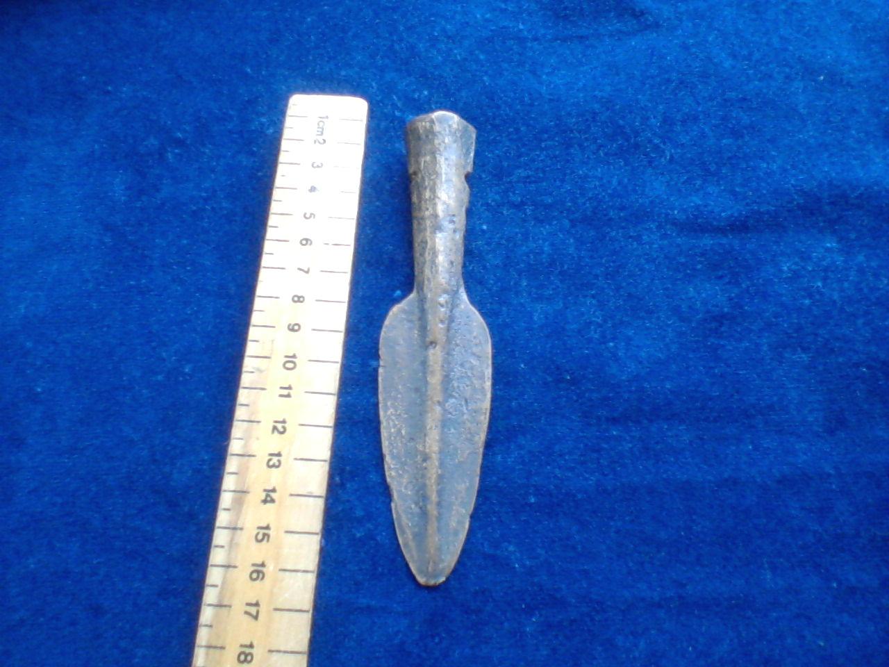

Other common bronze fakes are arrow points and bronze mirrors. Fortunately, I came upon a cache of original bronze arrow points before faking became popular. There used to be some fantastic original bronzes available here in Korea, but not anymore. As an antiquities expert and friend of mine once said regarding Chinese bronzes, "It was probably made in a certain Beijing alley last Tuesday".

THE LAST PICTURE POSTED IN THIS THREAD APPEARS TO BE A GOOD BRONZE REPLICA CHINESE SWORD I HAVE SEEN MANY SUCH ITEMS AND THE ONES I HAVE HAD FOR MANY YEARS HAVE NEVER DEFORMED OR CRACKED.

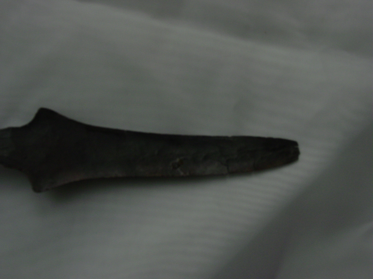

HERE ARE PICTURES OF THE GREEK LETTEROPENER (SORRY FOR THE POOR QUALITY PICTURES I TRIED SEVERAL TIMES BUT THESE WERE THE BEST I COULD DO AND I DON'T HAVE THE ABILITY TO LIGHTEN OR INHANCE CONTRAST). THIS GREEK ITEM IS MADE OF A POOR TYPE OF POT METAL AND WILL NOT DRAW A MAGNET THE PATINA HAS BEEN APPLIED TO THE OUTSIDE THE INSIDE RESEMBLES YOUR ITEM IN COLOR. NOTE THE BLADE HAS BENT AND IS BRITTLE THE TIP BROKE OFF SO IT CAN'T BE STRAIGHTENED. THERE ARE CRACKS THRU OUT AND IT CONTINUES TO DEGRADE.

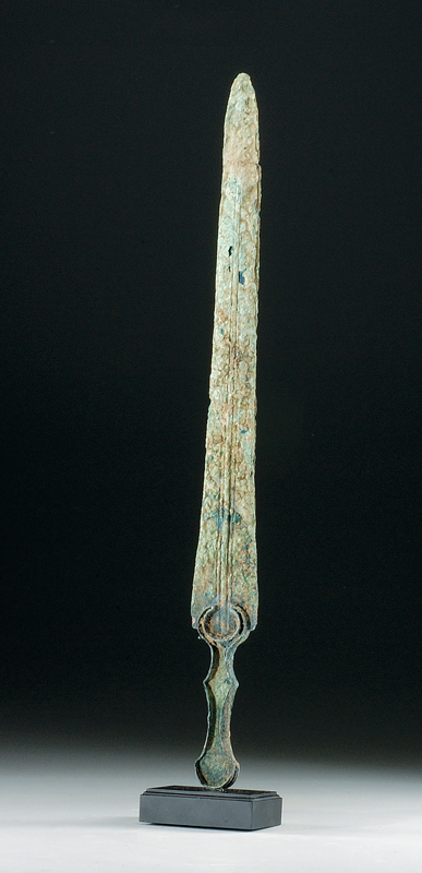

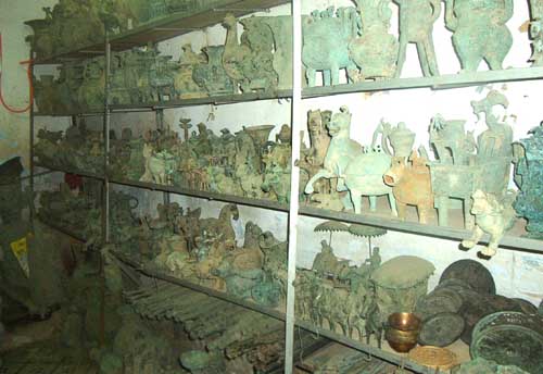

A PICTURE OF A TYPICAL CHINESE SHOP OF WHICH THERE ARE CERTIANLY THOUSANDS IN CHINA JUST ONE OF MANY SHELFS IN THE SHOP.

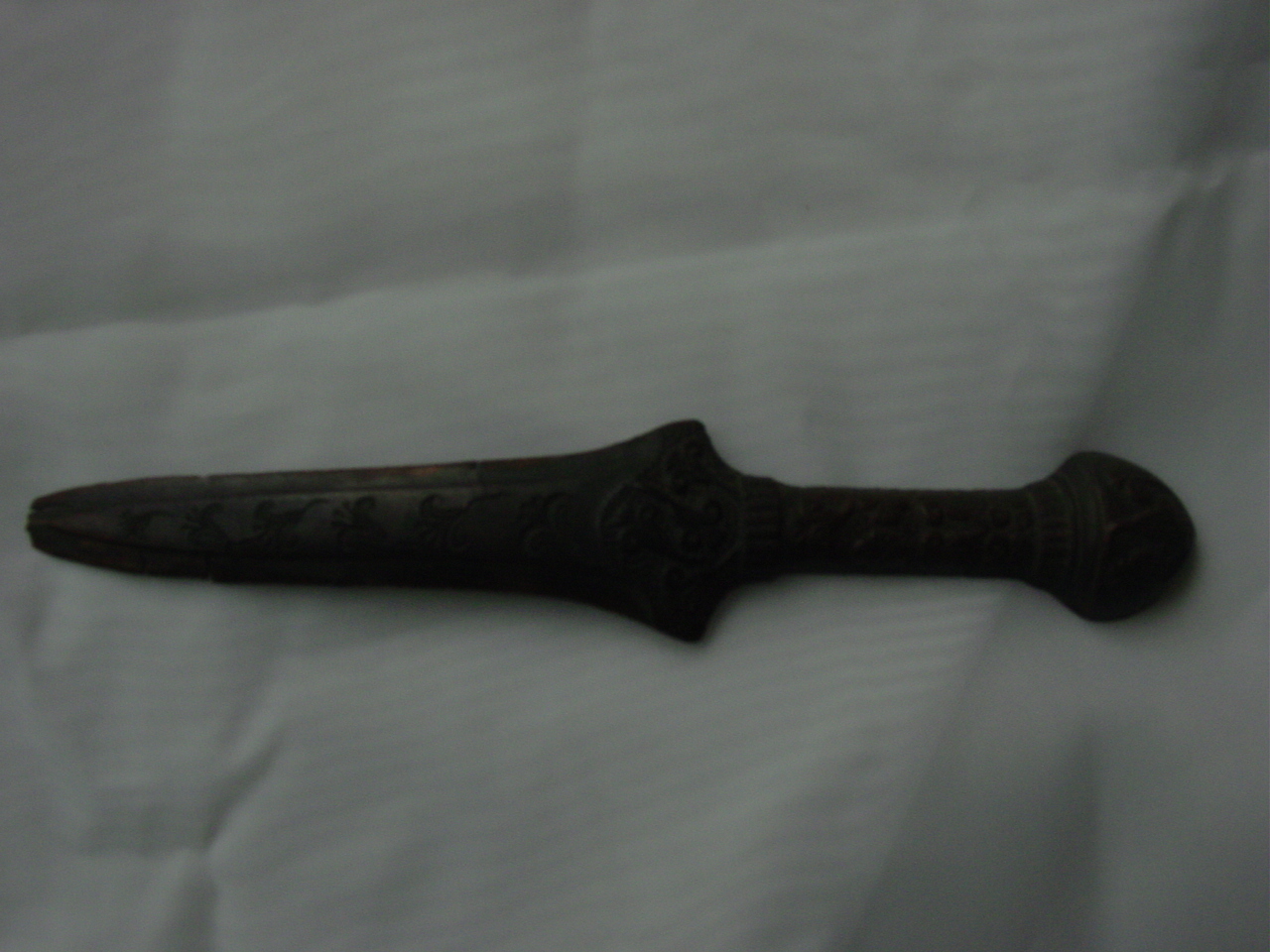

A PICTURE OF A LURISTAN SWORD 20.75INCH LONG. NOTE THE HANDLE IT HAS A RAISED BRONZE FORM TO HOLD A INSERT OF HORN, WOOD OR STONE AS IS USUAL FOR MOUNTING INSERTS. YOUR EXAMPLE APPEARS TO HAVE HAD THE STONE PRESSED IN WHILE THE METAL WAS STILL SOFT.

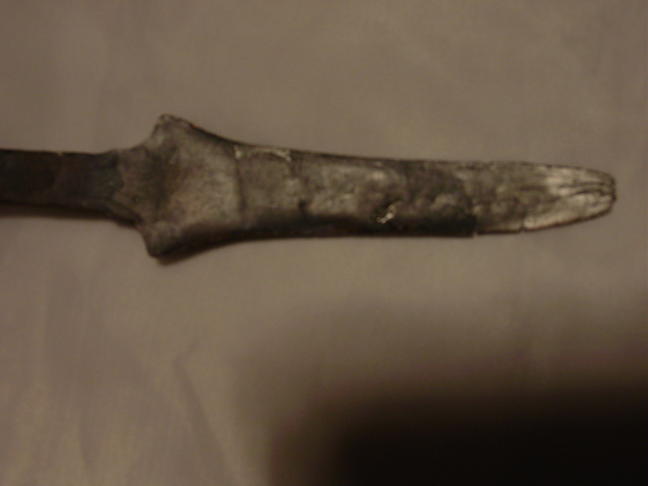

While we are on the subject of replica bronzes, here's one I bought in Denmark. Sold to me as a Museum REPLICA and one of a limited run, cast from an excavated original.
Yes, it is an excellent replica, which is why I use it in my Korean history and culture classes as a show-and-tell item regarding bronze weapons.
