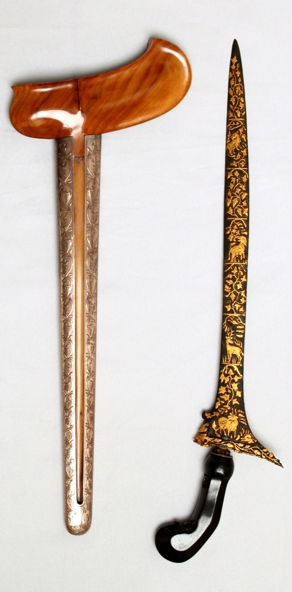

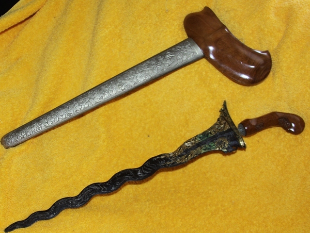

have bought this keris: http://www.ebay.com/itm/251108487966...84.m1439.l2649
There have been only a few expressionless pictures posted but what I am able to see is that all, the blade and dress as well, are good worked.
What do you think?

Hi Detlef,
What a great looking Keris. All the elements look really nicely made, congratulations.
I look forward to seeing more pictures when you have it with you.

I look forward to better photos when you receive this. I could be wrong, but i am not sure this looks like pre-WW2 kinatah work to me. I hope you bought the kerns and not the story...

The photos give me the impression that the kinatah is brass, but this can be very deceptive. I hope that you find otherwise once you have the keris in hand.
If the story were correct and this was brought back from WW2 you would have done quite well on this one, as this would then have to be a pre-WW2 blade. That might be just a bit too good a deal to hold out hope for, i'm afraid...

I would agree with David regarding the materials of the kinatah, I apparently see some traces of "vert de gris" (green copper compound) on the reverse side of the blade, which should indicate that the kinatah is from brass (may be gilt).
Regarding the estimated age of the piece, the seller just says that it was brought to the US after WW2 but this is not a very accurate statement From the pictures and if it was my decision I would categorize the kris as probably from tangguh kamardikan muda Madura but of course I can prove wrong and the piece is quite well made.
The seller also proposes another kris with a kinatah blade of similar quality.

this is what I see as well and I think when the brass is gilded it is a good catch by this price. I don't think that it is kinatah mas, otherwise it would be too much luck!

in the eighties keris of this type were fairly common in Jalan Surabaya. I would make this about 30 years old giver or take a few year...

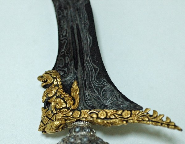

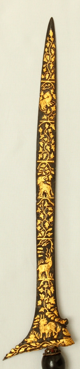

Attached is the picture of a probably recent blade with 22Kt? gold kinatah on a brass base. I realized it recently because the kinatah is peeling off at one corner due to the lack of care from myself so I could see the underlying brass base, but the gold coating is quite thick actually. Your comments will be welcome.

Hello Jean,
nice keris of good quality! Do you know if the kinatah work is a traditinonal motif? Also when the pendok is of good quality I would change it against a closed one since the sheath isn't iras.

Hi Jean,
From your explanation, i agree this is recently Made.
If you are reffering that if this is the standard for the one on offer for over $10,000. Short answer is No.
For this price, the keris is well made and carved with full gold underneath, correctly executed (not welded like Madura work) but for experienced Collectors, still can be identified. The gold could be over 100gr, remember you need more gold than you have to, if you asked someone else to do it.

Hello Detlef and Rasjid,
I never saw such a kinatah motif before so I suppose that it was created from the imagination of the maker but I find it very decorative. The quality of the kinatah is not excellent but still quite good IMO and the amount of gold is significant.
I agree that I should replace the pendok blewah by a closed one but it needs to be golden colour for matching with the kinatah blade and I did not find a suitable one yet (only bling-bling pieces).
Rasjid, we should not discuss about price or value in this forum, let me just say that I paid the price of a brand new Mercedes Benz for this piece but a miniature one!

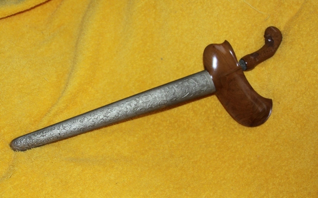

rasjid
Join Date: Jun 2008
Location: Jakarta - Indonesia
Posts: 114
Default Kinatah work
I can't put someone else keris in this forum and discredit them

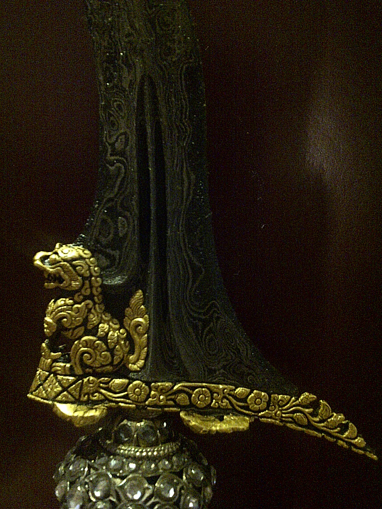

Yes David, the Keris is sold as old keris but I wont argue about the keris and its depending the buyer if they are prepared to spend and risk their money on it.
How many more out there good keris with old Kinatah work ? I'm talking long before 1900's
This is my own keris with Kinatah work, so any comment is welcome. I hope this one dont have "free" brass underneath.
Sorry for the low photo quality.
rasjid

Old 1st August 2012, 06:40 PM   #30
Posts: 7,302
Looks beautiful and well executed regardless of age.
