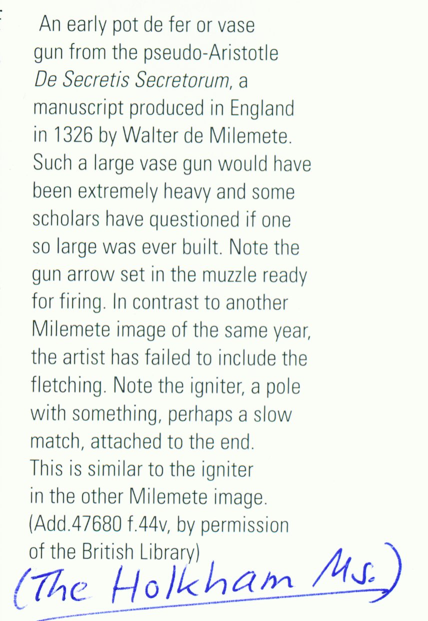

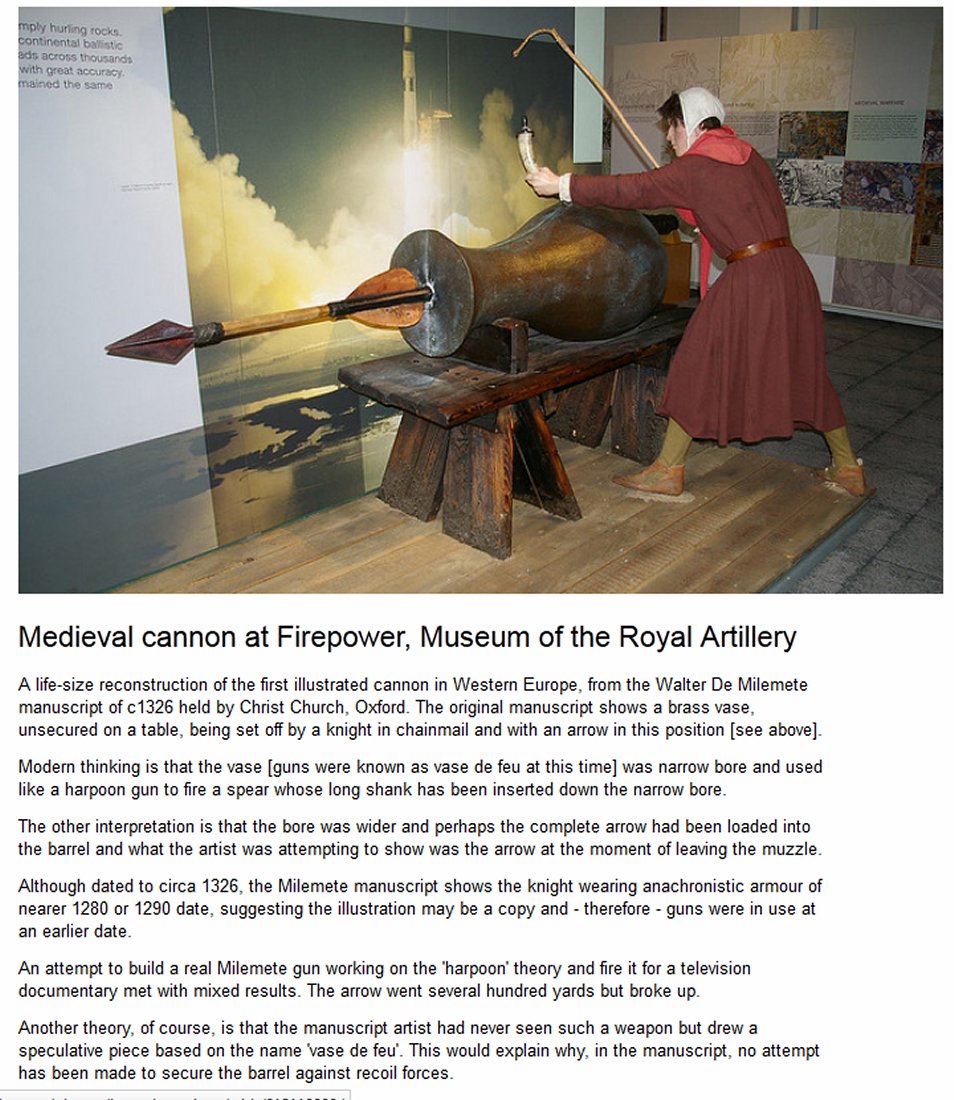

The two oldest illustrative sources on gun arrows are illuminated miniatures in manuscripts by de Milemete:
the 'Holkham ms': De secretis secretorum, 1326, Bodleian Library Oxford, ms 458, and the 'de Milemete ms': De nobilitatibus, sapientiis, et prudentiis regum, 1326-7, Christ Church Oxford (top attachments).
In both depictions we see a vase-like gun (pot de feu), most probably of cast bronze, at the very moment right before the ignition by means of a linstock clamped with a piece of matchcord or tinder, and with an arrow protruding from the muzzle - but not yet leaving it.
In the older illustration of the two, a group of people seemingly show great respect to the act of ignition, standing back with their bodies bent backwards; the igniting device seems to be a glowing iron put directly in the touch hole at the rear.
In the second illumination, an additional fuse is seen placed in the touch hole, with the gunner's linstock touching it.
What nobody seems to have noticed so far: in both miniatures the tip of the arrow head is sharply pointed, and characteristically flared in the older picture. Most important though is the fact that in the second illustration, the thin-pointed arrow head clearly consists of several clasps comprising a glowing incendiary mass. Although this mass is not depicted in the older illustration the flared, fragile shape of the tip suggests that it is definitely not a conventional strong piercing tip but must be an incendiary arrow solely designed to get stuck in straw or wood.
Thus the earliest gun arrows actually were incendiary arrows, fired at the roofs of a besieged town - which also makes more sense regarding the poor ballistics of these arrows, due to their heavy heads!

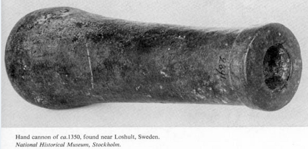

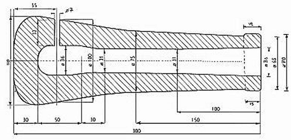

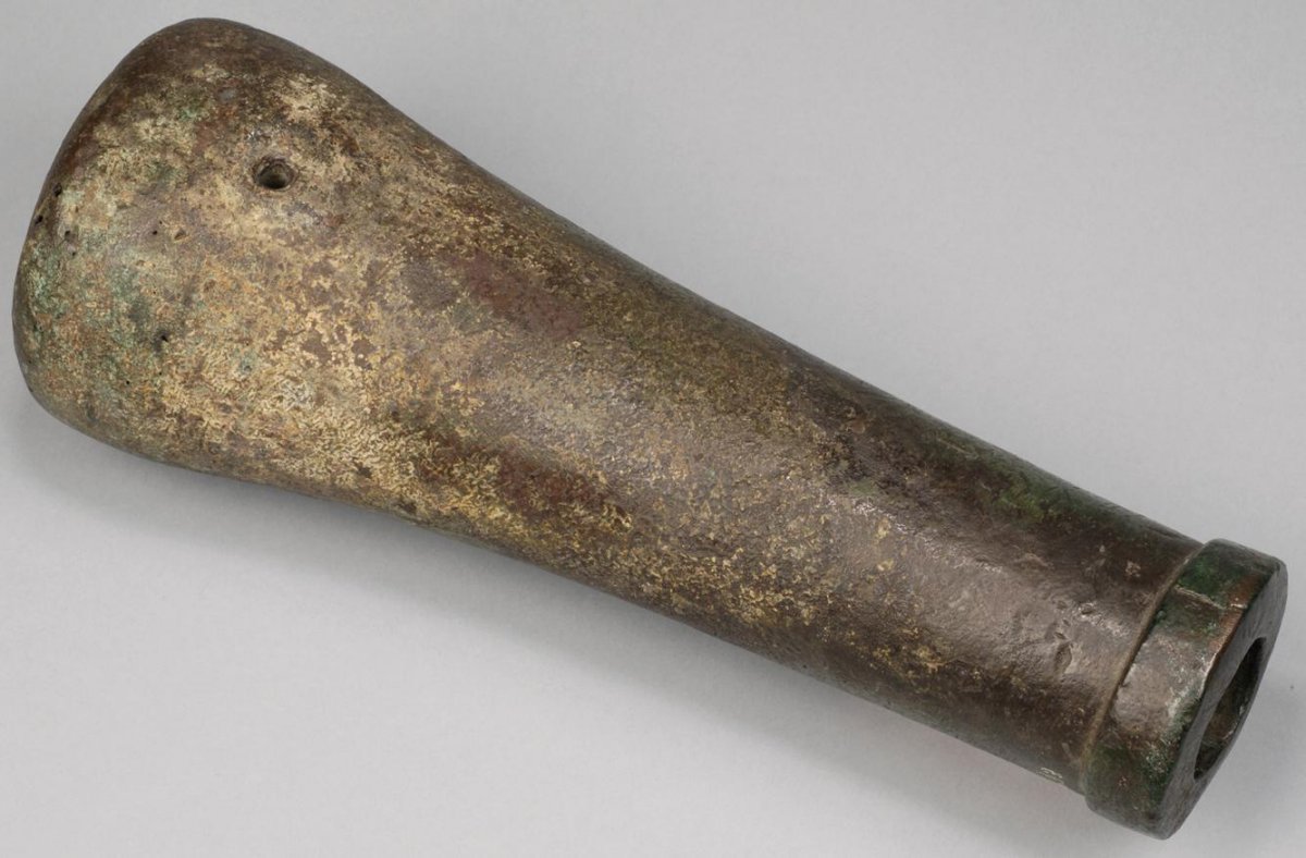

A cast-bronze vase-shaped gun barrel very close to those pictured by de Milemete has become famous as the world's oldest known gun, the so-called Loshult gun, and is now preserved in the Statens Historiska Museet Stockholm, inv.-no. 2891 (attachments).
It is generally dated ca. 1330-50 and measures 31 cm overall, at a weight of 9.050 kilograms; the bore at the muzzle is 36 mm narrowing down to 31 mm on its way to the rear, which seems ideal for firing arrows featuring a cord binding for a tight fit in the muzzle, to minimize gas loss.

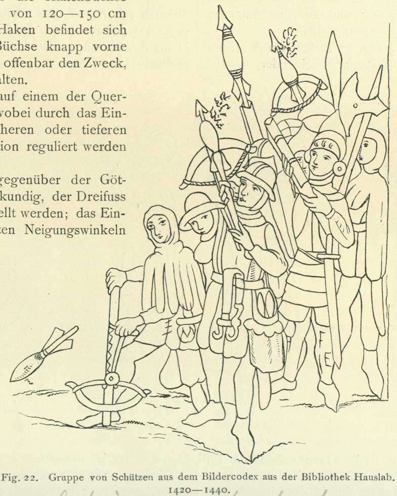

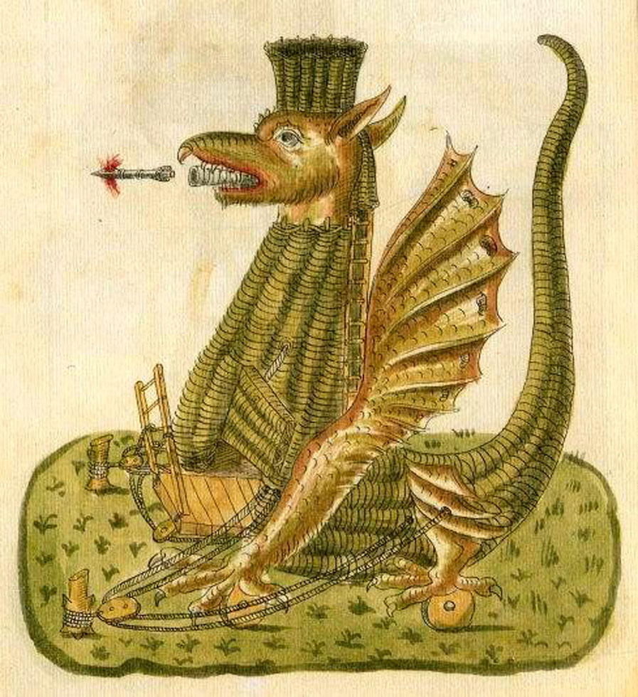

After these records of 1326-7, it takes almost one hundred years to find the next-in-line illustration of a gun arrow - at a time when lead and iron projectiles, first appearing as clod shot chopped off a bar, had established themselves long since. After all, the earliest records of clod shot are from the Netherlands, 1375:
http://www.vikingsword.com/vb/showth...ight=clod+shot
It is also possible that clod shot was used as a sabot for gun arrows.
This second-oldest illustration, also depicting a - rather tiny - vase-shaped gun, is from the Streydpuech (Book on War), ca. 1410-30, Kunsthistorisches Museum Vienna, P 5135, fol. 9v (b/w line illustration, next-in-line attachment).
What is most remarkable about this illustration is the fact that, for the first time ever, the arrow head is now depicted looking like that of an average crossbow bolt: stout and pointed, obviously designed to pierce metal, and without an incendiary mass!

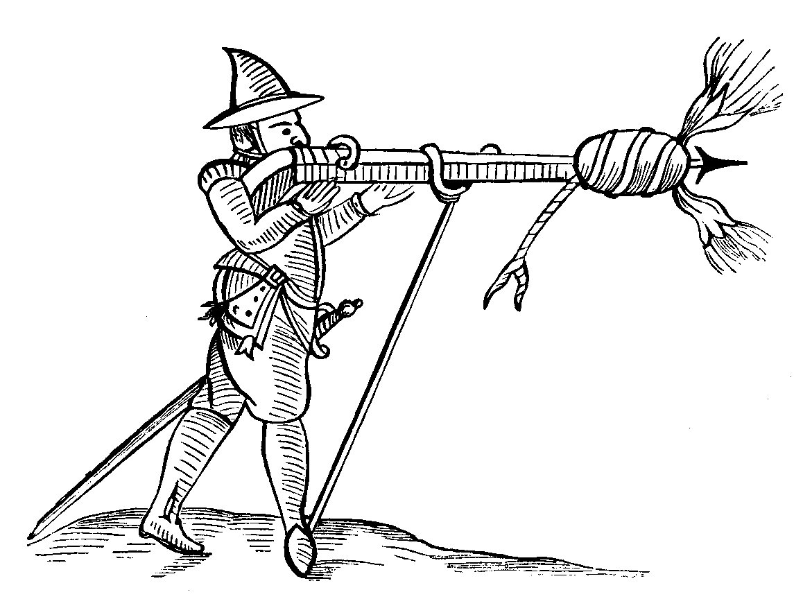

Only more than a century later we find another illustration, and seemingly the last on this topic, showing a Spanish musketeer of ca. 1570-80 firing an incendiary arrow from his matchlock musket (attachment).
In summing up the illustrative sources, it seems that the primary use of gun arrows over the centuries was throwing fire in a parable across town walls by incendiary arrows, the delicate but sharply pointed tips getting stuck in the roofs thatched with straw or wooden shingles, causing an inferno in the narrow-built medieval town.

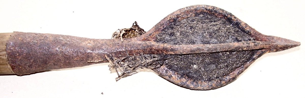

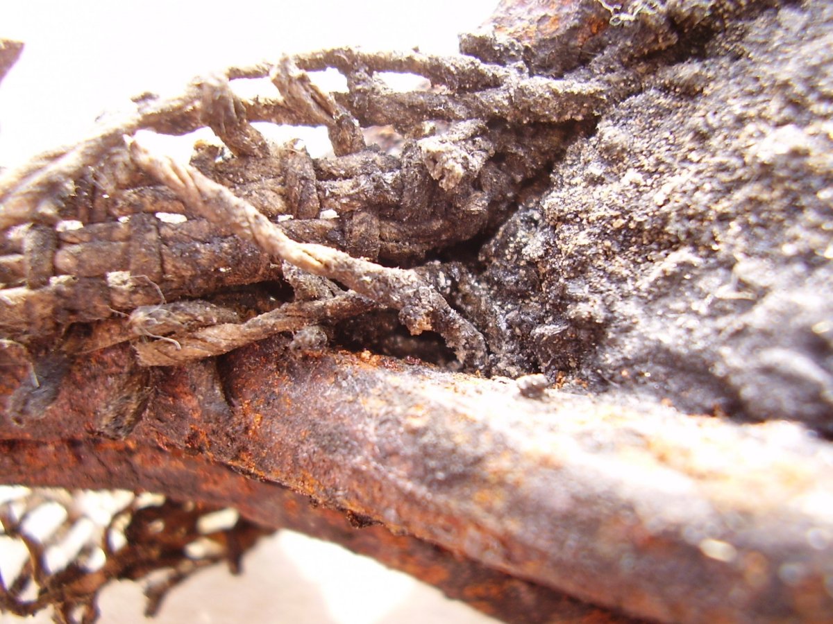

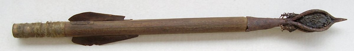

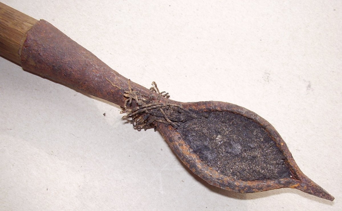

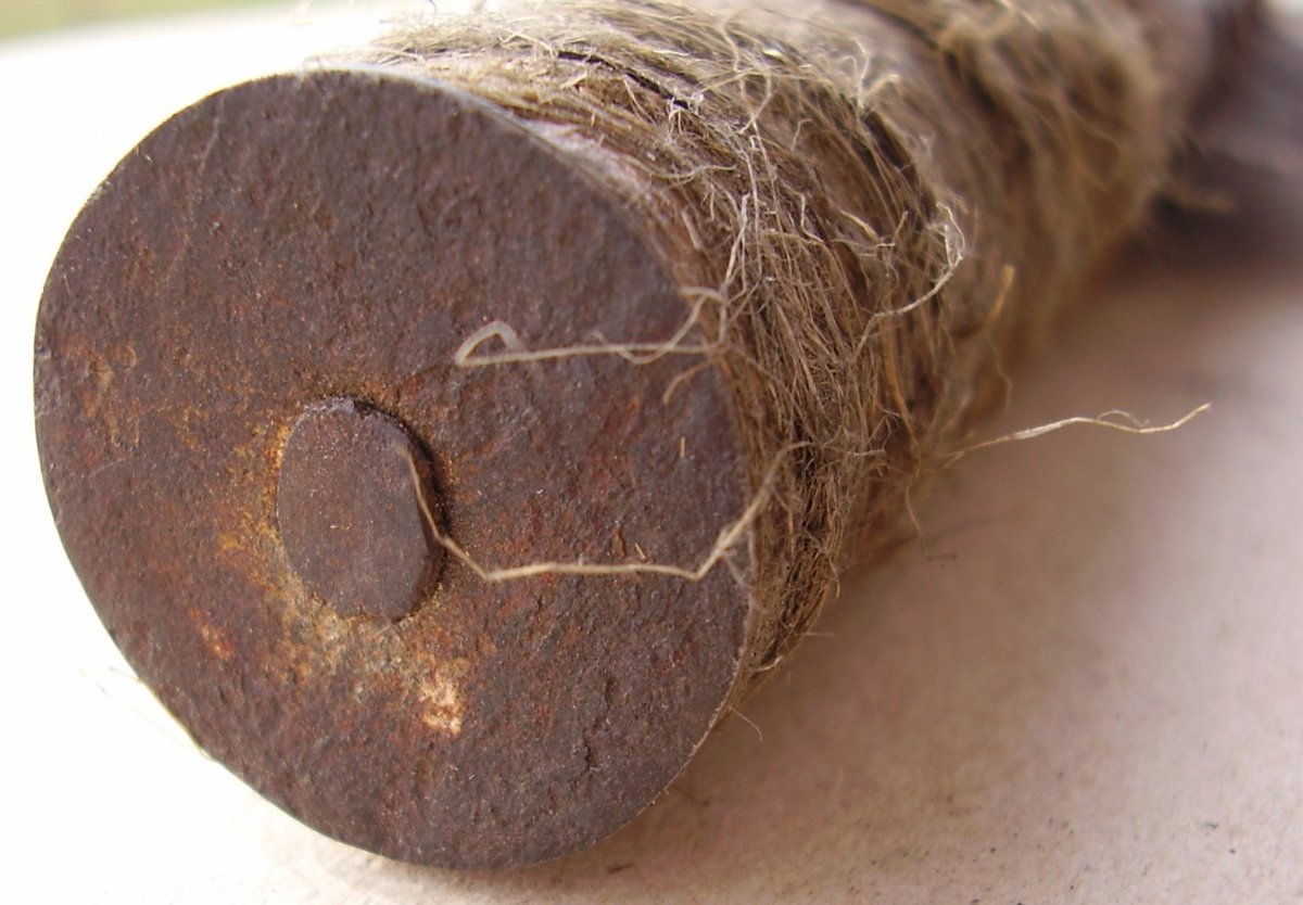

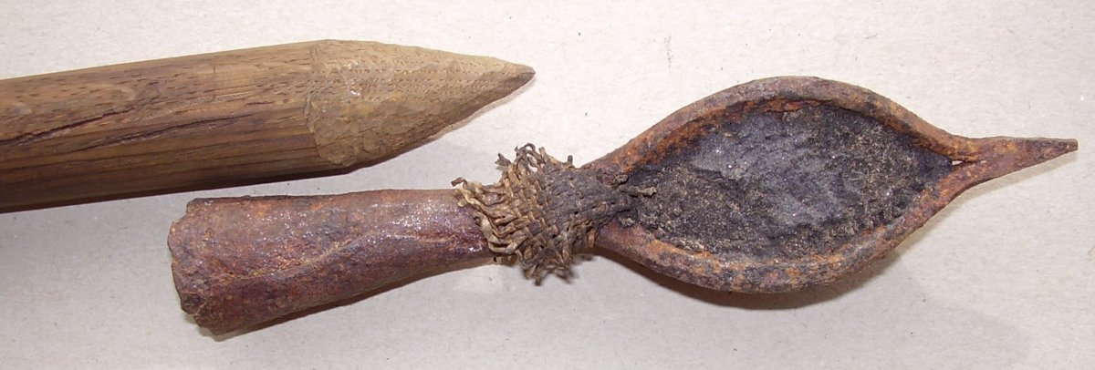

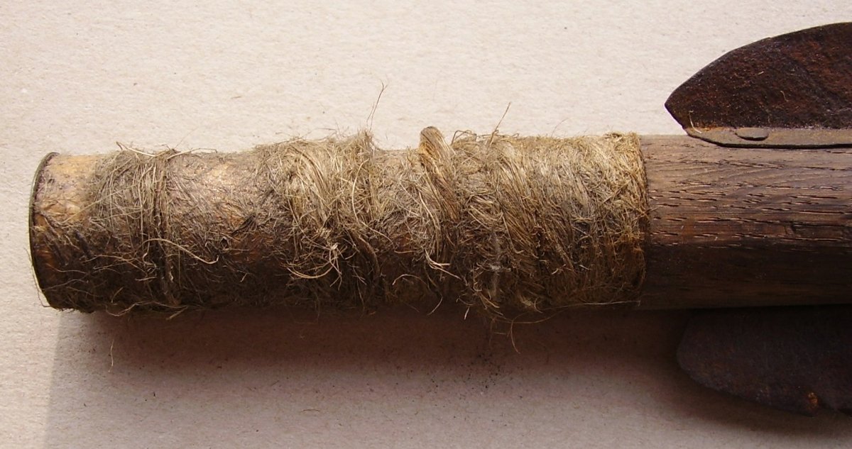

For a couple of years, one of two sensational extremely fine and authentic specimens of an earliest type of incendiary gun arrow has been in the author's collection: the pointed head constructed of four clasps retaining much of its original incendiary mass wrapped in raw linen, the matchcord probably originally attached now missing. The oaken haft retains two thin iron flights (damaged), much of a fragile cord binding in the rear section, probably of hemp, and an iron reinforcing plate pinned to the bottom.
This incendiary gun arrow closely corresponds to those illustrated by de Milemete in 1326-7, and the construction of its haft, flights and reinforcing iron bottom plate is consistent with the few other remaining gun arrows which, however, are of later type.
The incendiary mass seems to be largely the same used in contemporary quoits and incendiary arrows for crossbows:
http://www.vikingsword.com/vb/showth...endiary+arrows
What is remarkable is the fact that the socket of this arrow head is not attached by a nail but just put on the pointed haft, as is the case with crossbow bolts! When the wood was still fresh this certainly provided a tight fit but as the wood has shrunken it is loose now, just like on most crossbow quarrels (see attachments).

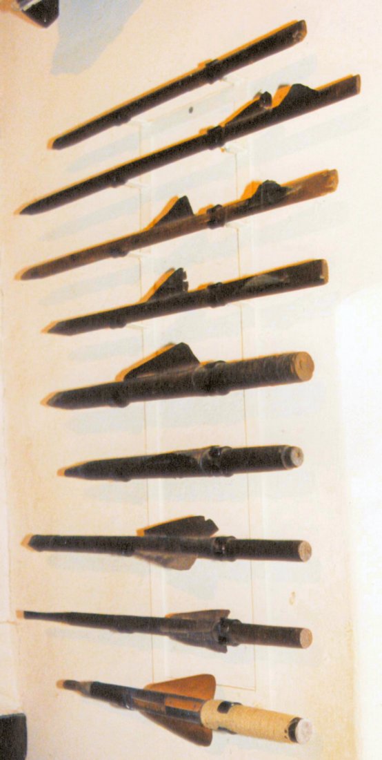

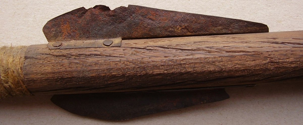

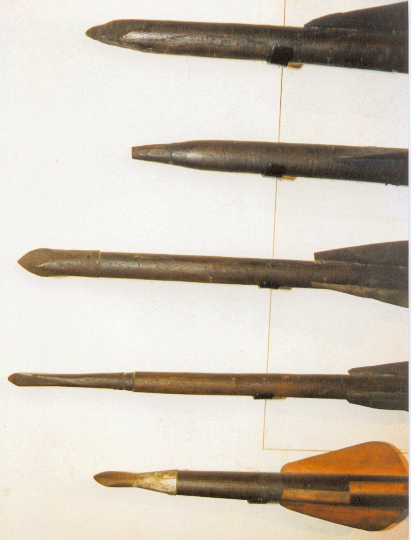

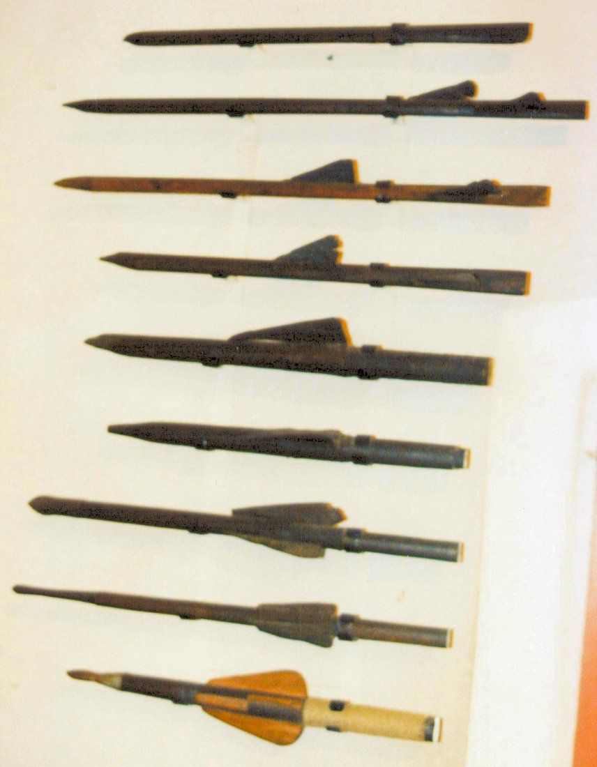

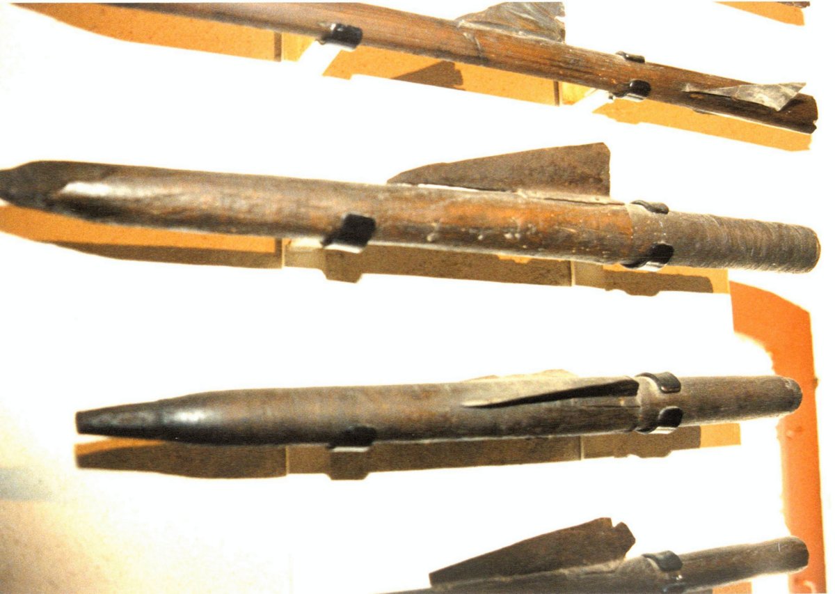

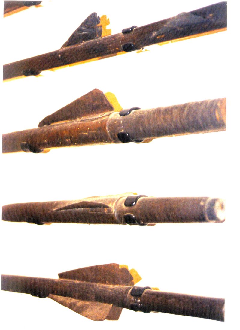

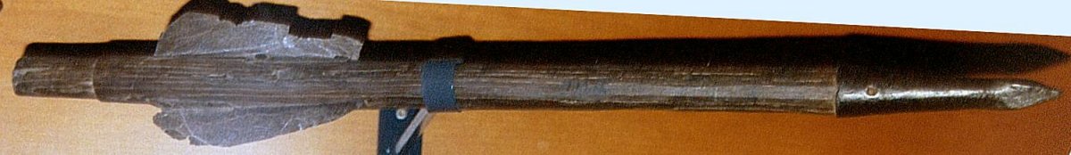

On July 3rd, 1987, the author attended the collections at Burg Eltz by special appointment, and still holds a written document to prove that he was the first to actually identify eight original gun arrows preserved there (following attachments).
Some of their heads are missing but all remaining heads are of the characteristically stout, pointed, metal piercing shape known from crossbow bolts but not recorded for gun arrows prior to ca. 1400. Most Eltz specimens retain their original hemp binding, their iron flights and pinned iron reinforcing bottom plate.

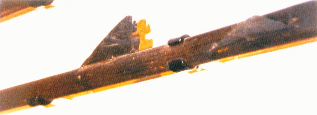

Three of the Eltz gun arrows are interestingly equiped with three iron flights each: two arranged the usual way, and the third placed in shifted position behind them.
The usual number of flights seems to have been two, just like on conventional arrows and crossbow bolts.
The one displayed at the bottom, on the photos showing the group of nine, is a modern reproduction (attachments: all author's photos of July 3rd, 1987, still showing the old display arrangement).
These gun arrows, their provenance still being unsettled, have been tentatively attributed to a historic feud taking place at Eltz Castle in 1331-2. At least one of them was claimed to have been an excavated find from castle ruins. This statement has meanwhile been disclaimed and should be seriously doubted, regarding the fact that all of these arrows are preserved in identical condition, and that organic material such as hemp would have hardly stood hundreds of years of burial. The author, on the grounds pointed out above, doubts the early dating and is convinced that they should be correctly dated 'late 14th to early 15th c.', on the grounds of the illustrative sources presented.
No earlier date can be proven for them but the sources quoted by the author suggest a date of ca. 1400 by the earliest.

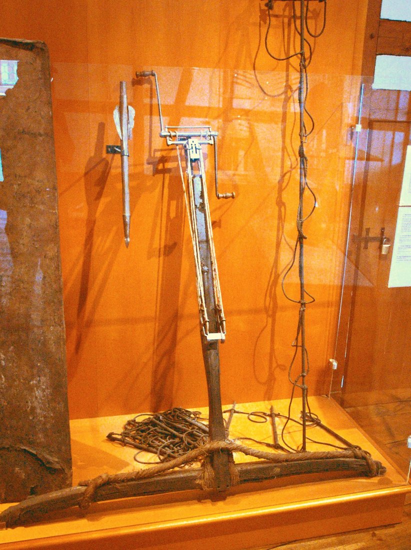

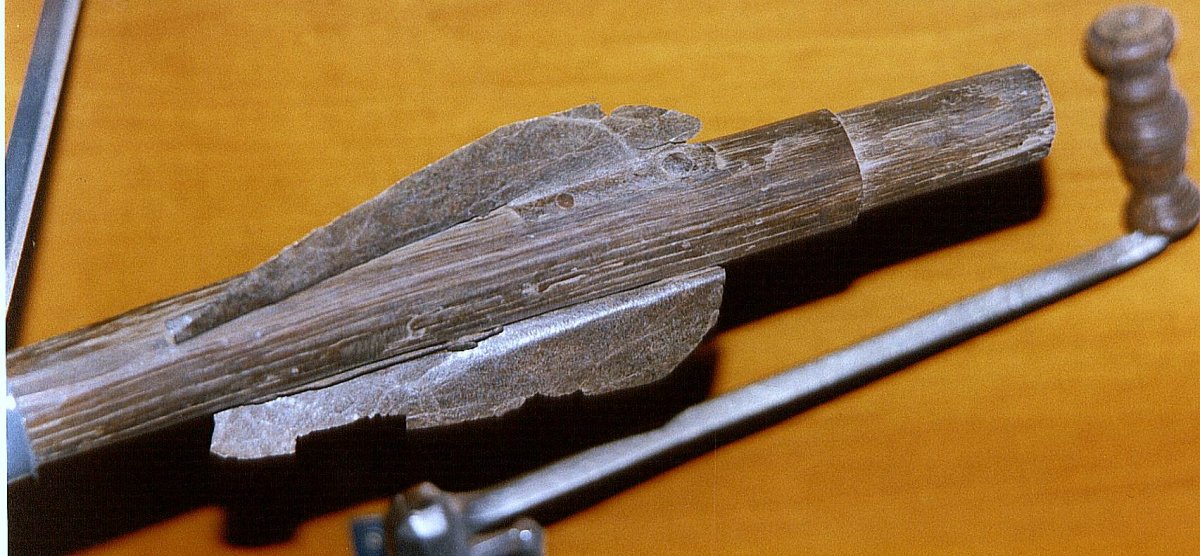

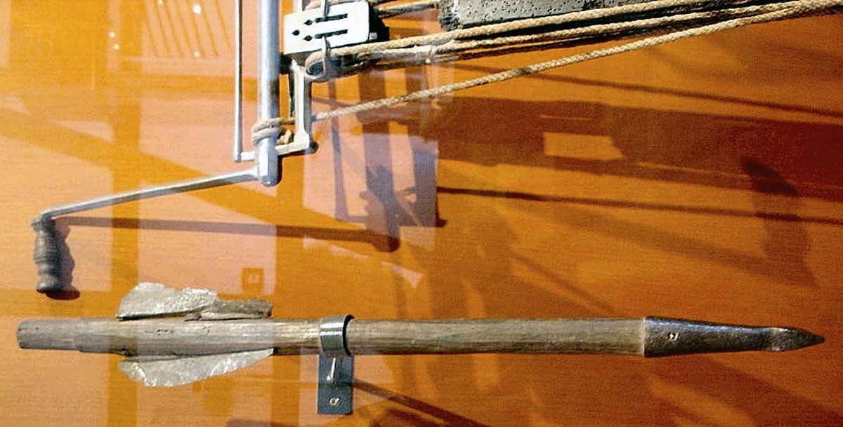

Another specimen, larger than most of the Eltz arrows, was spotted by the author in the drawer of the reserve collection (Depot) of the Germanisches Nationalmuseum Nuremberg some 25 years ago, where it was regarded to be a wall crossbow bolt. At that time, the rear section even retained a remainder of a cord binding, in addition to a pinned iron bottom plate which would make no sense at all on a crossbow bolt.
The author pointed those facts out to the guy in charge, arguing that it obviously was a gun arrow - in the presence of a witness. His argument was rejected, and about ten years later he found that very same gun arrow displayed next to a wall crossbow in the Imperial Castle at Nuremberg - labeled as a crossbow bolt. The recess at the rear of the oaken haft where the binding used to be was now clearly visible but the remainder of the binding had gone! (bottom attachments).
Interestingly, the socket of the arrow head shows a piercing for a nail but actually no nail has ever entered!
Well, Nuremberg seemingly does not wish to be aware of the fact that they possess one of the rarest items of antique ammunition: a gun arrow of late 14th/early 15h c. date ...

P.S. As is often the case with my computer, b/w jpg attachments of line drawings do not show up on the forum.
In case you cannot open the two line drawings of ca. 1410-30 and ca. 1440 respectively via the links given at bottom, they can be seen in Tittmann's essay - please see link provided above!

The latest known depiction of an (incendiary) gun arrow: a Spanish musketeer, ca. 1570.
The only known surviving specimen of an incendiary gun arrow, probably ca. 1330-50, in the author's collection.
Eight original gun arrows of ca. late 14th to early-15th c. date, at Eltz Castle (and one reconstruction at the bottom); photographs by the author on July 3rd, 1987.

More of the Burg Eltz arrows.
And the gun arrow at the Nuremberg Imperial Castle also identified by the author, displayed next to a wall crossbow.
Interestingly, the socket of the arrow head shows a piercing for a nail but actually no nail has ever entered - see close-up at bottom!

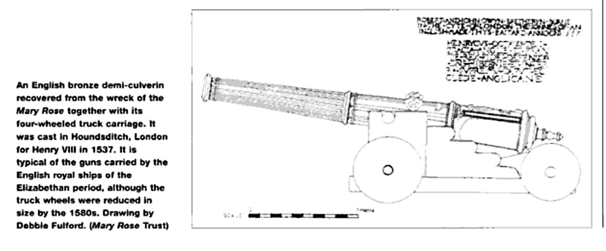

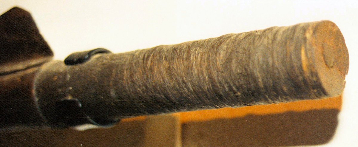

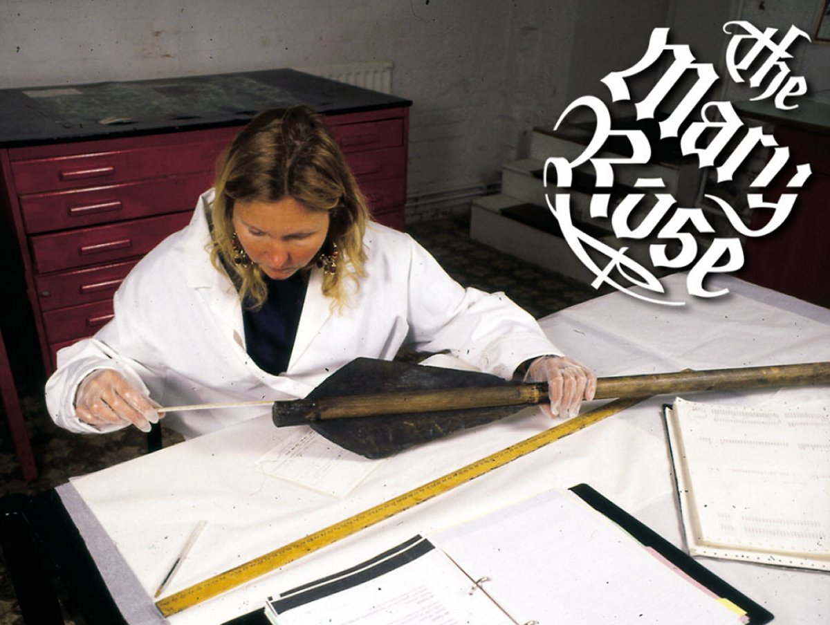

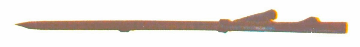

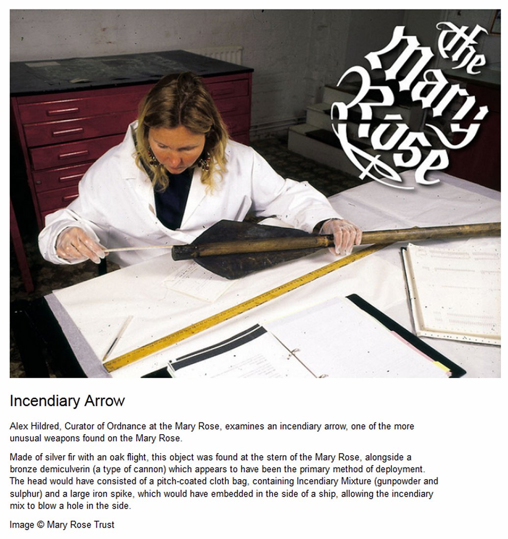

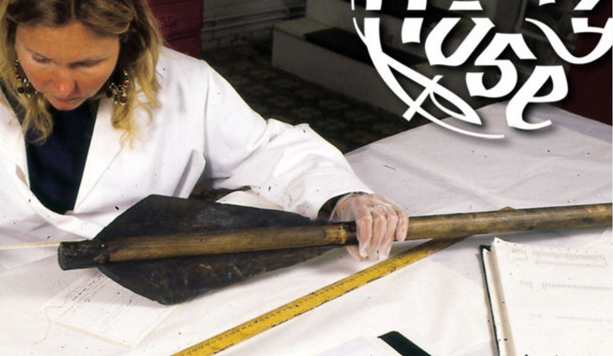

A huge incendiary gun arrow was salvaged, alongside a bronze demiculverin (!), from the wreck of the Mary Rose (sunk 1545).
The haft is of silver fir, the flights are oak.
At the extreme rear end, right behind the flights, a dark area is visible, most probably the former place of a hemp or cord binding gasket.

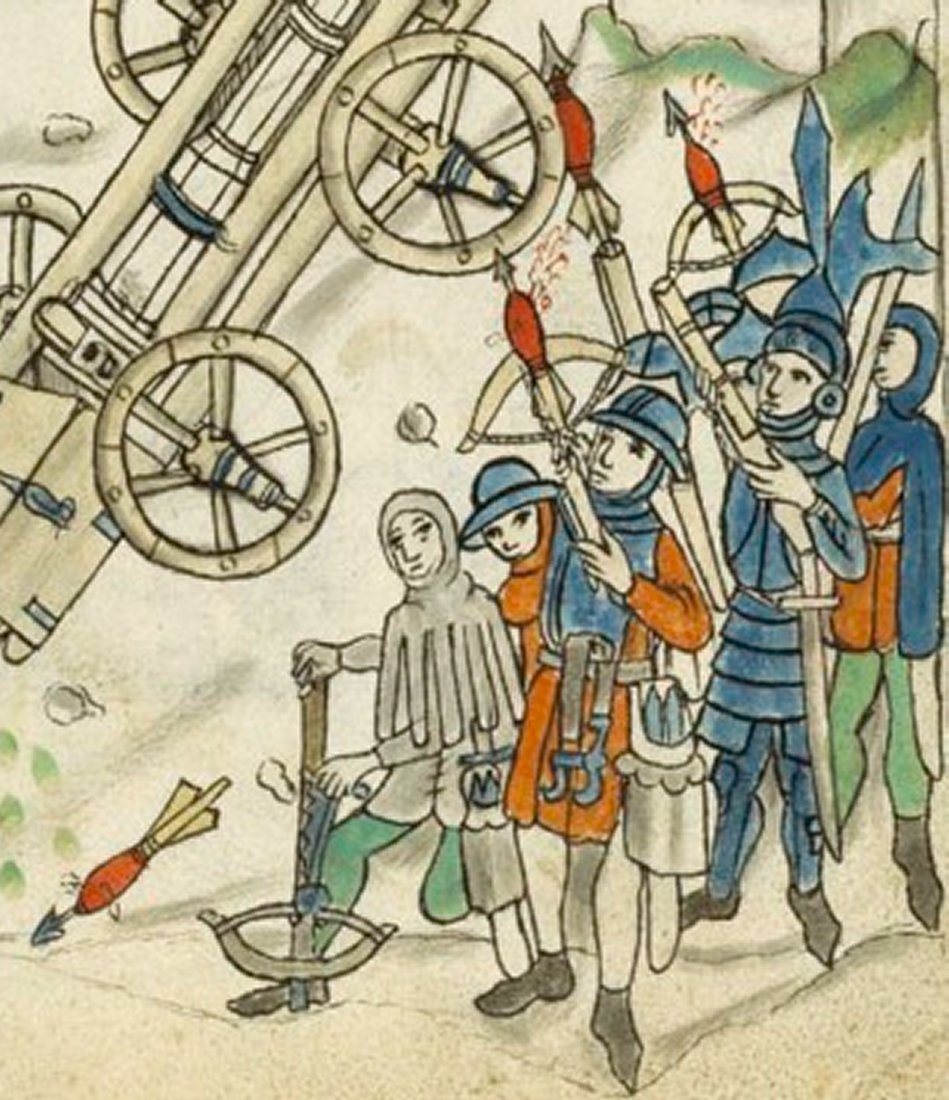

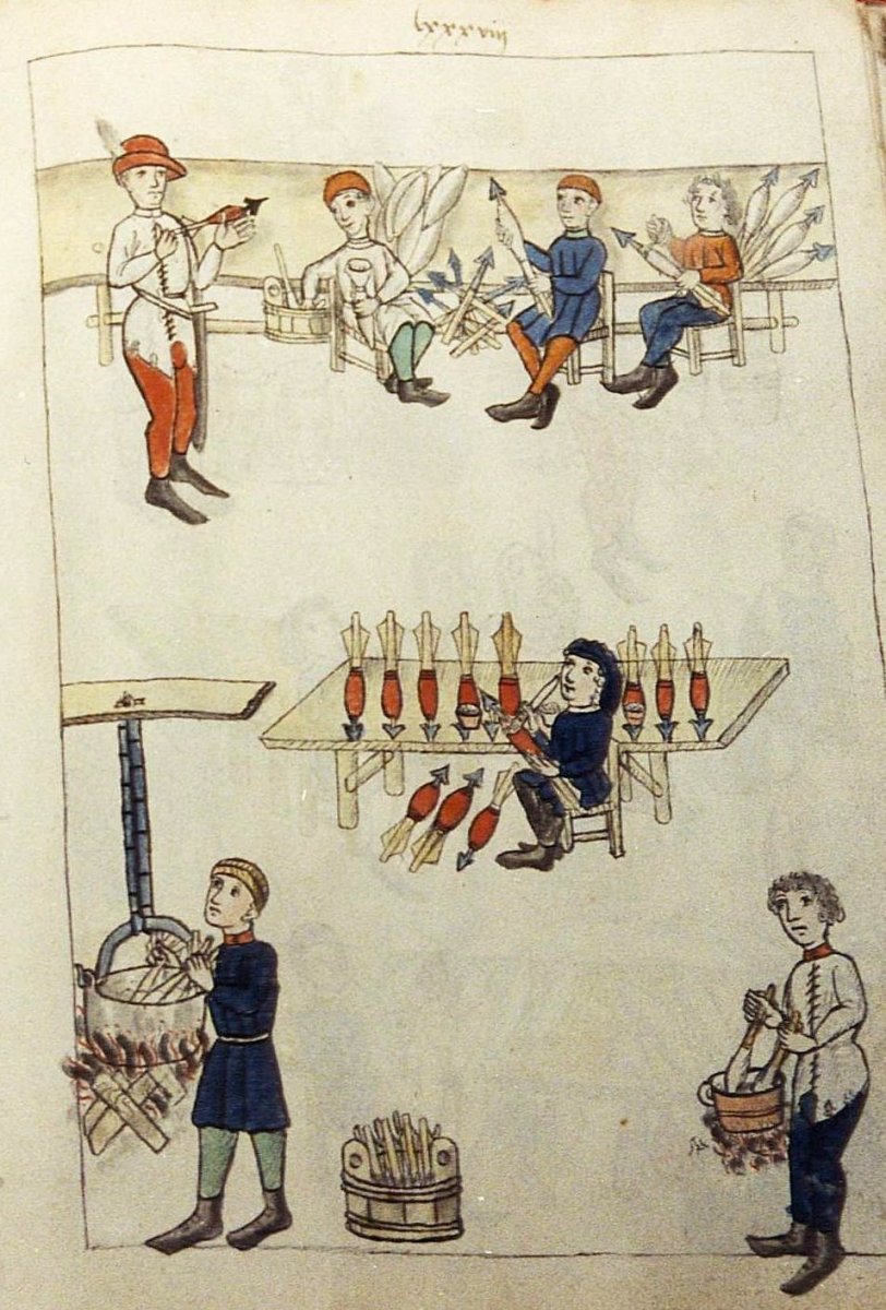

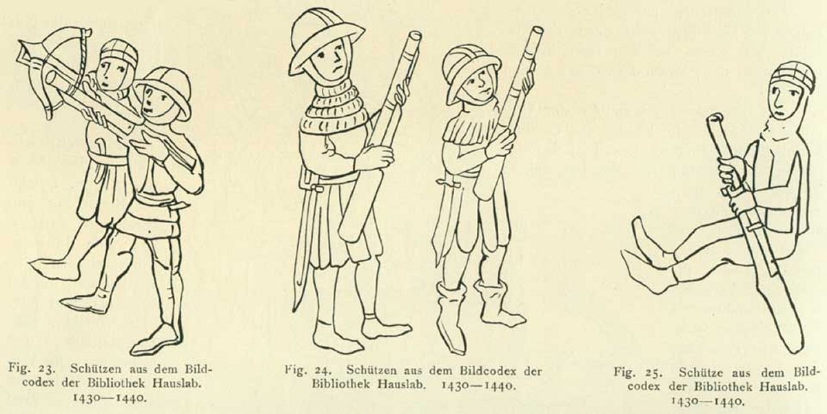

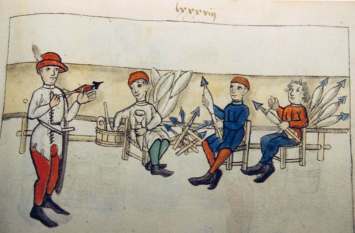

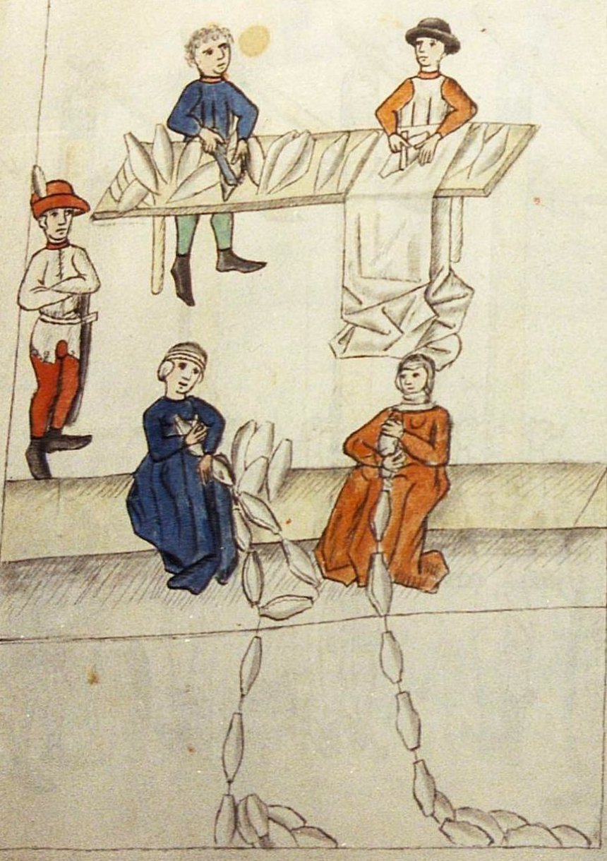

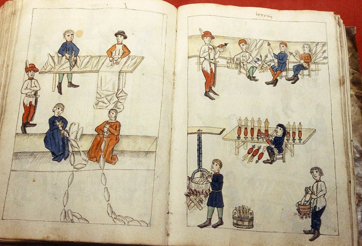

Incendiary arrows for both guns and crossbows, and how they were manufactured:
from the famous Hauslab manuscript, 1442, now in the Royal Armouries Leeds.
Author's photos, apart from the top five attachments.
Two of the Gun arrows from Eltz castle were finally examined using the C14-method in 2010. One specimen could be dated within the 14th or 15th century, but the probability curve of the analysis suggests a production around 1330 or 1400. The other bolt was dated to "ca. 1200", but it´s obvious that the craftsmen used old timber to produce the arrow. I have to say that the hypothesis of the relation between the Eltz gun arrows and the Elz feud of 1331/33 seems dificult to me - because of the lack of information about that war.
Finally, they´ve named that bolt a gun arrow a few years ago - without refering to Matchlock. Too bad he won´t be able to notice this change of information.
