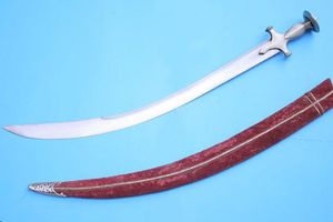

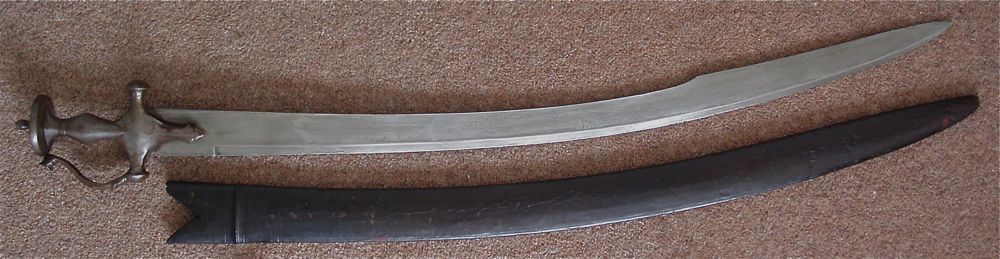

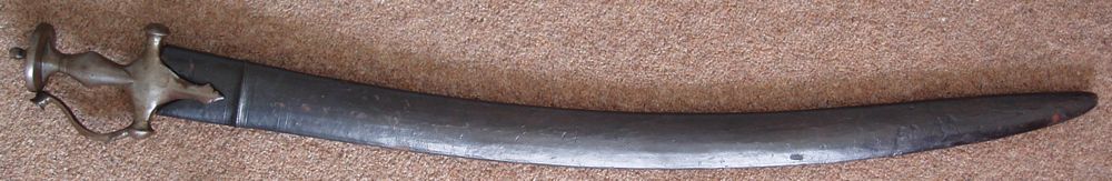

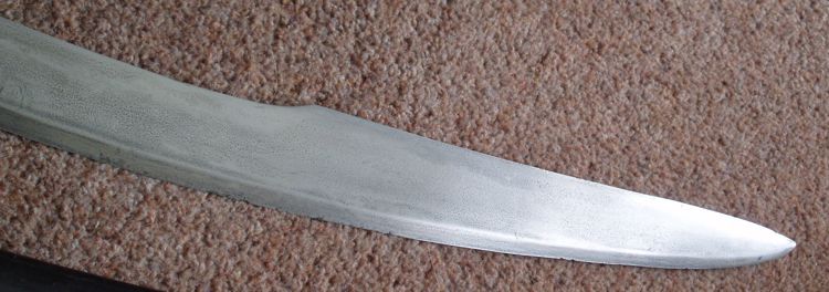

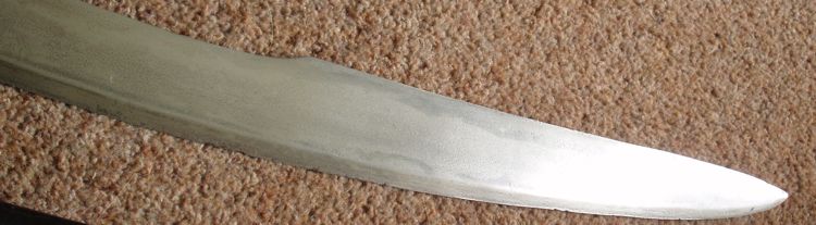

Hi,
A new addition to my Indian collection. Total length 38 1/2 inches, blade 33 1/4 inches, thickness at greatest 9/32 inches, width 2 inches reducing to 1 1/2 inches just before Yelman. The Yelman is 11 inches long and the back edge is sharpened for the first 3 inches. This is the 'meatiest' and sharpest Tulwar in my collection and the heaviest, needs a good arm to chuck this around. I don't want to speculate on age, origin and blade type/make-up but eagerly await members views and opinions. I look forward to hearing from any and all Forumites.
My Regards,
Norman.

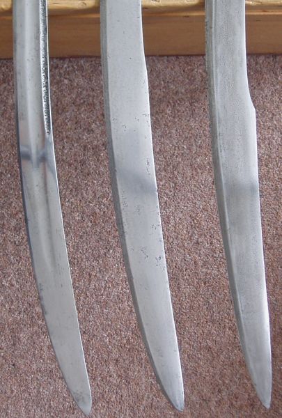

P.S. I have included photos of three Tulwars of mine with varying degrees of 'Yelman' the most pronounced being the one in this thread. I have also included photos of the hilts of the three swords in the same order to show the difference in ricasso widths.

Thank you for sharing, these are great tulwars!
Regarding your large tulwar, I would guess that this sabre may have been primarily for cavalry use I had not yet seen one of that design, size and heavy weight. Great find!
Regards.

All nice mate, but that new one is a stunner! What a blade. Seeing as you've already given it a light clean... how about a gentle FeCl? to see if it brings more out?
I love it! The form is fantastic, is that differentail hardening I see. I drool with envy, what a sword.
Are we going to call it a Tegha?

Hi Christek,
Thanks for your interest, it is certainly long enough to be used from horseback although whether primarily designed for this purpose I'm not sure.
My Regards,
Norman.

Hi Gene,
Thanks for your kind comments. It certainly looks like differential hardening, there is a scarf weld halfway up the blade and the activity in the blade is much easier to see in real life so things are looking pretty good. I too love the shape and it feels good so am desperate to have a go on a watermelon but I won't. The etching will have to wait, I'm in an apartment now, will ask my friend if I can use his garage. Thanks again.
My Regards,
Norman.
P.S. Don't think it is right for a Tegha, but will wait on the 'expert India wallah's' for an opinion.

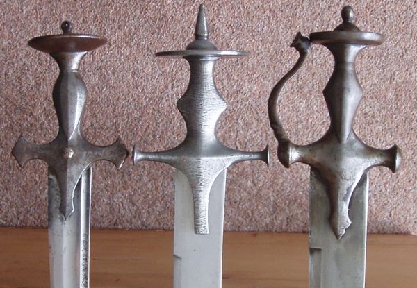

Norman, not only is this a superb example tulwar, but this triad of them is to me a quintessant grouping of excellent fighting tulwars! You have also presented them perfectly showing good hilt views as well as lower half blade views, and best of all included a view of the pommel dish top. While typically through the years tulwars have been observed wholly and usually without any note of these pommel dish features. It was Jens some years ago who noted this apparant oversight, and saw the interesting and possibly important variation in the features and motif in these, and began cataloguing the pommel caps along with other views.
While there are really no definitive classifications for tulwar hilts that may be categorically applied, there are some reasonably reliable guidelines which can establish some degree of identifying description. These are best used with careful consideration of various features, decoration and comparison with other provenanced and catalogued examples. I have spent a little time going through notes and some references very much inspired by these three outstanding sabres.
The first on the left, is what I would consider from northwestern regions from Sindh, Baluchistan, Punjab and notable is the fixture at the center of the chowk of the guard which seems typically found on tulwars which have had similar features to Afghan paluoars. The flueret (palmette) quillon terminals are often regarded as Mughal or Deccani features, but they seem as well to be found on some tulwars regarded as Talpuri (from Sindh).
The second and center tulwar is of the type typically regarded from Pant's classification as Udaipuri (Rajasthan) and often the thin wheeled quillon terminals have been stated 19th century. It should be noted that while many of these may be 19th century, they are simply more modern versions of the form which existed in the 18th century, possibly earlier.
Your newly acquired example with knuckleguard seems clearly Mughal and corresponds to hilt forms of the latter 17th century. The domed quillon guards are considered Ottoman affectations, as would be the stylized dragon or makara head.
While the Mughals were highly influenced by Persia, there were strong infusions of Ottoman culture as well in the 17th century.
The blade on this tulwar has the pronounced yelman of Ottoman influence and again corresponds to similar blades of the 17th century, with these used into the 18th. The other two examples have much more subtly integrated yelmans in the widened tip very much like other Central Asian shamshirs of the 17th century.
The unwritten axiom is that the heavier blades tend to be earlier, and I would say all three of these reflect earlier dates from latter 17th into 18th, with the newer acquisition earliest of the three. The other two more toward end of the 18th in my opinion.
I think the 'tegha' term is less than useful and so vaguely described in most sources it's actual application is questionable. Most of the swords I have seen with the term used have been excessively broad bladed and often regarded as 'executioner' swords. These however are likely in most cases of ceremonial or bearing type use.

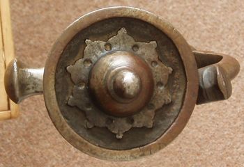

Many thanks, once again, for your insight and your time. It was a mucky old warrior when I got it and I'm delighted that apart from the basic historical and form interest it may be earlier than I had hoped. I do think the blade has more to reveal about its construction and make up. I did notice that after cleaning the blade was very quick to oxidize taking on a darker shade when left overnight. This obviously has to be a product of the metallurgy of the blade itself which must contain a reactive element. I have attached photos of the pommels of the other two Tulwars for comparison and completeness, the colour should point to which belongs to which. Thanks again.
My Regards,
Norman.

My pleasure Norman, I enjoy the opportunity to see excellent examples like this and try to learn from them. Naturally my views are speculative but I feel fairly soundly based on what I can see and on notes I have looked into.
Again, I appreciate you showing the pommel dish interiors. It has been another of the mysteries of these fascinating sabres as to just how much inherent symbolism may be held in the varying motifs and designs within these disc arrangement, in addition of course with the floral and geometric motifs often in the overall decoration.
The Mughals are known to have selected various botanical themes as dynastic totems so there are possibilities, while Rajput clans similarly are aligned with various celestial and elemental themes. All these things simply add to the intrigue of these Indian arms and it is great to see interest in them among collectors. Thank you so much for sharing these.

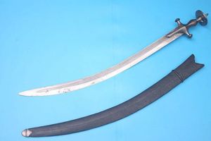

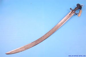

Some interesting similar swords>
All sold so not current sale items.
http://antiques-arms.com/sold-indo-p...er-sword-es194

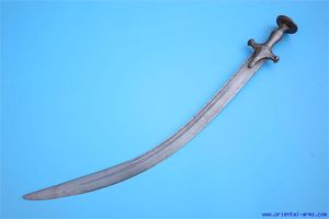

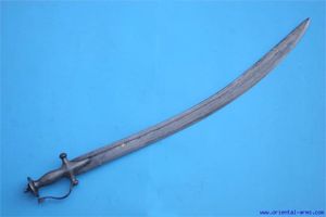

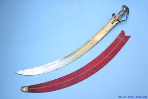

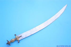

http://www.oriental-arms.com/item.php?id=2852
http://www.oriental-arms.co.il/item.php?id=2763
Old 27th June 2012, 08:32 PM   #13
Norman McCormick
Norman McCormick's Avatar
Posts: 1,657
Hi Gene/Jim,
All the swords illustrated here are sold items gleaned from the www.Oriental-Arms.com site. All have the word Tegha in their description and only one is described as over 2 inches wide and in this case I suspect not by much. Blade lengths vary from 25 inches up to 35 inches. I would not normally or necessarily have associated these blades with the term Tegha but my knowledge is limited. As has been noted the Tulwar that is the subject of this post is most certainly a fighting sword extremely sharp and showing signs of use where one would expect and not the bearing/ceremonial/execution? item that I would normally associate with the description of Tegha. I look forward to further input with interest.
My regards to you both,
Norman.
P.S. The three swords with the D-guards have the longer blades 29-35 inches with only one of the others similar at 30 inches, I'm not aware whether this has any significance or not.

Old 29th June 2012, 01:32 AM   #24
Posts: 6,436
I'm seeing a different profile here with the kicked up yelman; one that reminds me more of a Kilij than a Tegha .
A conservative Kilij, of course .

Old 30th June 2012, 02:06 PM   #28
Posts: 10,862
So this tulwar/tegha is now a kilij????
Oops, I got lost.......ended up back on the original post, Norman's tulwars.

Hi Norman,
It seem as if the discussion has chosen a track of its own, and I think we should try to get it back, to discuss your latest sword (see how easy it is not to mention tulwar/tegha) .
The blades I have seen of this kind have been curved a bit more or less, but never to an extreme. The yelman can be more or less pronounced. They have no fuller or only a broad single one. They are all broad and heavy blades, and they are 17th or early 18th century blades.
Jens
