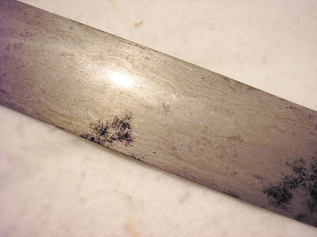

Default Unusual Etch on a Moro Blade

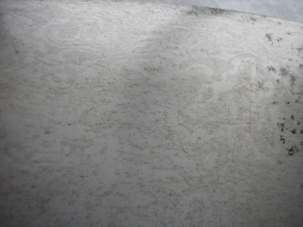

all the years i've tried etching moro blades i finally honed a certain technique in which i can bring out the lamination; visibly obvious, yet subtle enough so as not to overtake the overall aesthetic of the blade. good examples are these barungs.
i use the usual stuff: dishwashing soap and acetone to strip the oil, then vinegar and baking soda. after achieving the desired etch, i would run hot tap water on the blade to thoroughly was off any chemicals left on the blade.

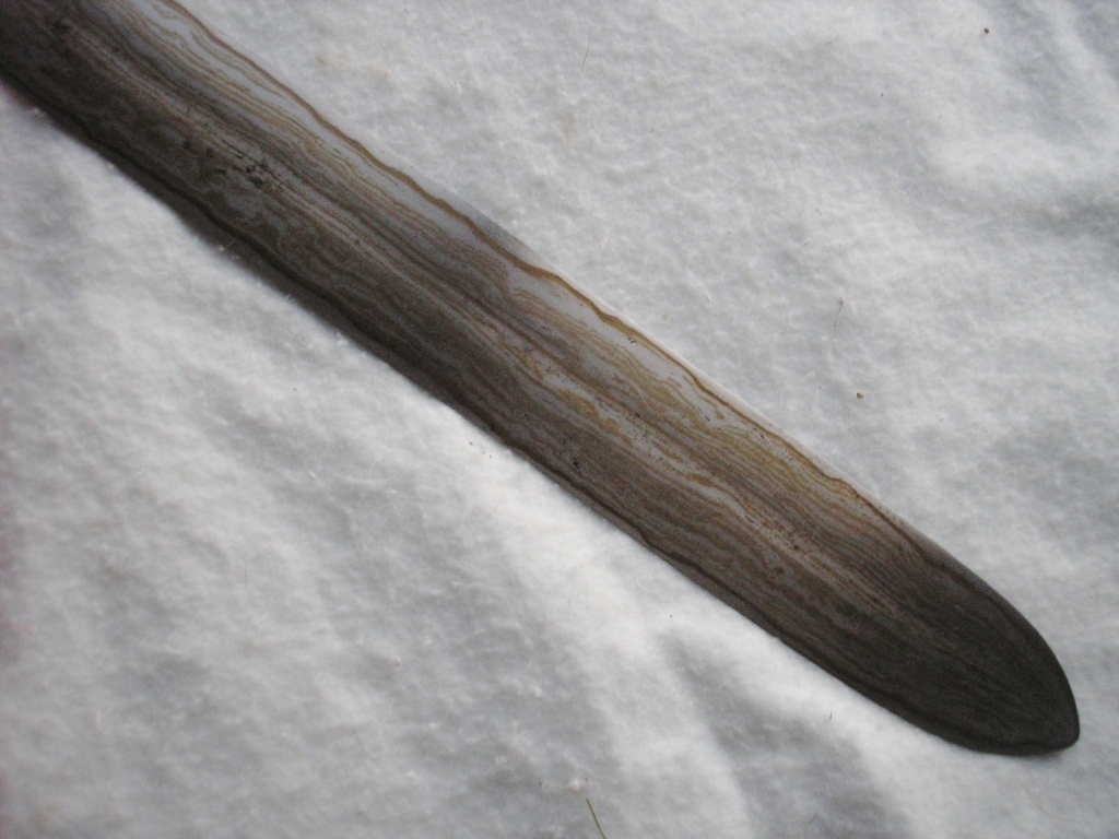

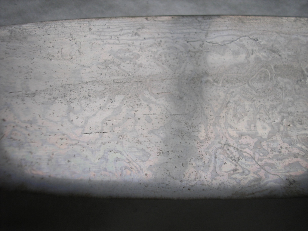

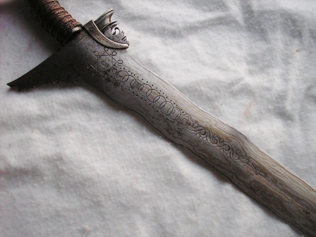

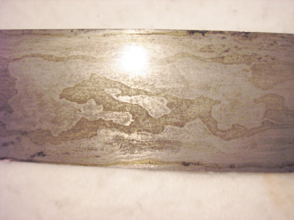

and then this happened...
i was etching this kris as i thought i saw some squiggly lines along the edge. after spending an hour applying vinegar with a stiff nylon toothbrush (my preferred method), i finally started to see some lamination patterns in the usual typographical pattern. vague, but it was there. another hour spent applying vinegar with the toothbrush, but it seemed like this is about as bold as it will get, so i decided to neutralized the acid. after that was done, i ran hot tap water to wash off the baking soda. this is where it got weird. these unusual snake like lamination patterns started appearing all over the blade. the longer i applied hot water, the bolder the patterns got. it even overtook some of the typographical patterns, as in these darker lines were on top of the previous patterns. i've never seen this happen before. anyone ever had this experience? any explanation on what would cause these? one thing that is neat tho, it has this monochromatic scheme going; brass handle and baka-baka, darker brass collar, copper wire handle, and now these brown lines.
p.s.
for the record: i've handled moro blades for years, and i could honestly say that this is the very first time i've been "bitten" by a moro blade. weird.

Nice barung Spunjer!
Ive had the same expierience etching kukri, my conclusian was hot water & air promote an oxidisation that highlight the otherwise low contrast laminations, due to some layers or lamination lines of the bladel oxidising more rapidly than the others.
As a technique I think of it as controled oxidisation highlighting.
Guess it needs a heavy oil soaking afterwards.
Spiral

@spiral: thanks! I do have this habit of running a hot water test on these blades to see if they're laminated. When I did it initially, none of those patterns came out.
On your multi, did pattern stayed, or did it eventually fade? Yes, you're right: healthy dose of oil was applied right after...
@dave: It's brass, I'm pretty sure. It's just that it is the lighter shade type, not to mention I went against the grain and decided to clean it up. Of note is the weight of this beast: it's heavy, comparable in heft with kampilans.

A weird color but looks like fold patterns to me.

i would normally use a heat gun (use to strip paint) to warm the blade, not hot to touch, before applying my first layer of warm vinegar. you're right, in that it does emphasize certain areas of the blade when etching. never tried phosphoric acid, dave. pretty much stayed with vinegar.
mross: yes it does. but what i don't understand is why is the opposite side has a different pattern? was the core sandwiched together?

my impression is that silica type impurities took that golden hue from the etch, revealing a normal folded and welded structure. Was your etchant brand new and clean, or had it been used before?

somehow i'm beginning to think the pandays of old had these pre-made blank billets lying around so when it's time to make a kris, he picks up a couple to sandwich a core.

I agree with mross. The "random" pattern is the proof of a laminated construction.
If there is no sign of lamination between the edge and the first brown line, this could possibly be a sandwich construction with central single steel (not sure, according to your two last photos which seem to show uniform lamination on the whole blade).
A good reason for sandwich construction is that a combination of non "quench-able" materials (ie : low carbon steel and nickel) was often used for lamination, in order to get good etching contrast (steel goes dark grey and nickel remains bright). If the laminated material canot be correctly hardened, this leads to sandwich construction which allows to have some good steel at the edges. Also good steel was much more expensive in the old days than common iron, so the less steel used the better it was for economical issues.
I cannot say what are the materials used for the construction of your blade. Might be iron + steel...

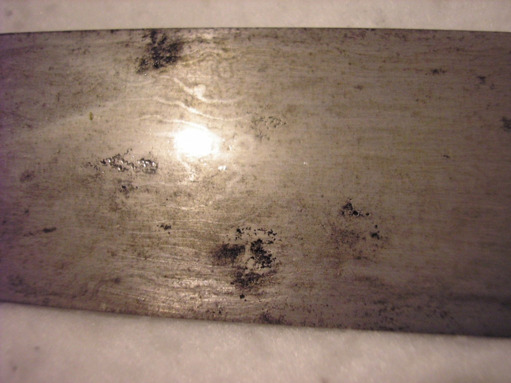

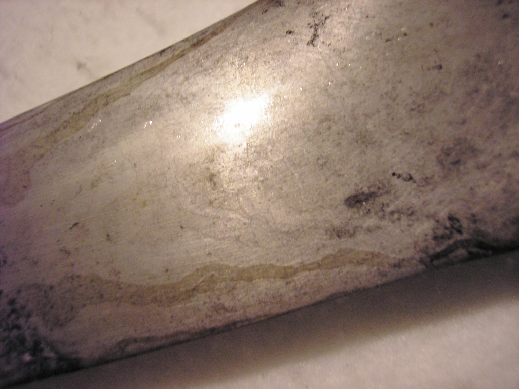

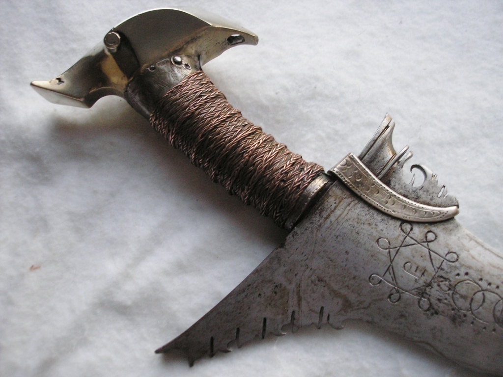

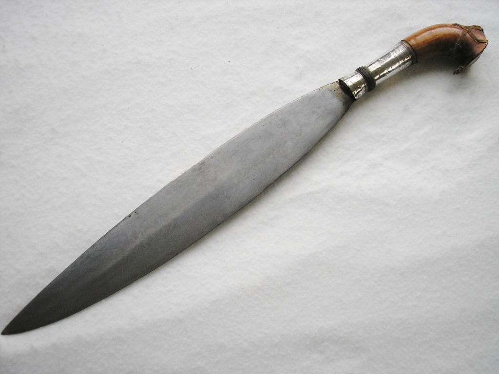

thank you, delor, for a thorough explanation in the lamination process! would you say that the core is a solid piece, or would it resemble a tuning for (with the edges as tines)? ,
the last two photos are actually from a different kris i etched on the same day. i added the additional photos as a comparison to the original kris that was posted

When a blacksmith didn't want to use rare good steel for the whole blade, he had to choose between two kind of construction :
- sandwich : 3 welded layers, with central good steel layer (first photo)
- welded edges : 3 welded bars, with good steel at the edges only (second photo)
Sandwich is much stronger because the welded surfaces are wider. Weld lines are quite irregular because of the strong hammering for the welding of the whole surface. I believe this is the construction of your blade.
(Welded edges are easy to detect because they show very regular and straight weld line because of the light hammering).
Of course, each of the separate parts can either be homogeneous or composite material (laminated & twisted core being the most traditional structures).
