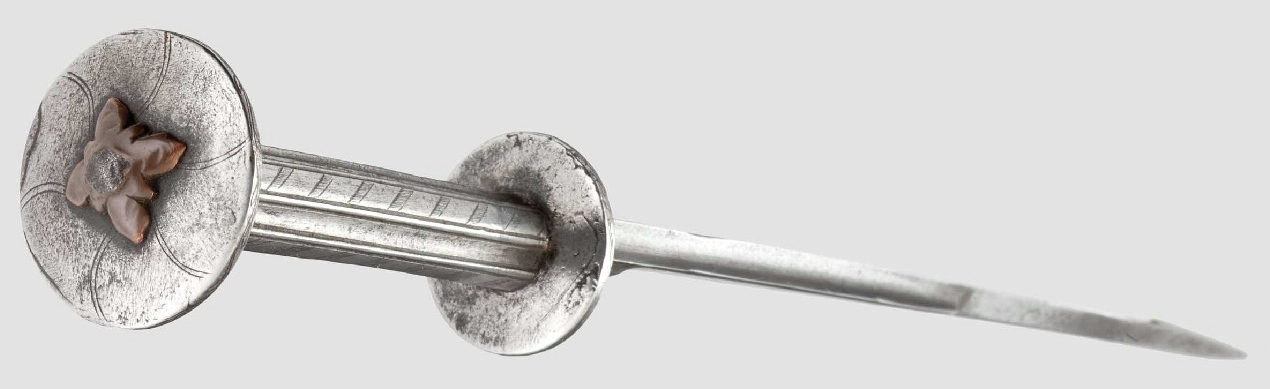

All the following Daggers were sold at Auktion.

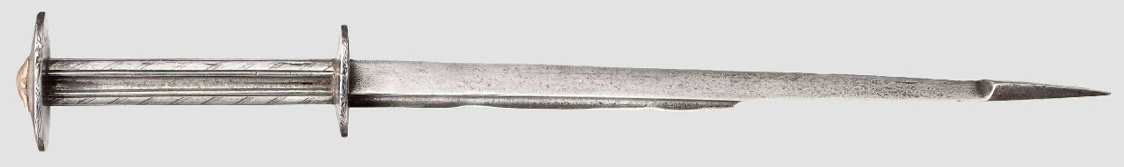

Rondel Daggers, second half of the 15th century.
Sorry, the first is the same as in Matchlocks thread, but my thread was already prepared some weeks ago.
But with the discussions about daggers in the other threads, its now the right time to publish it.

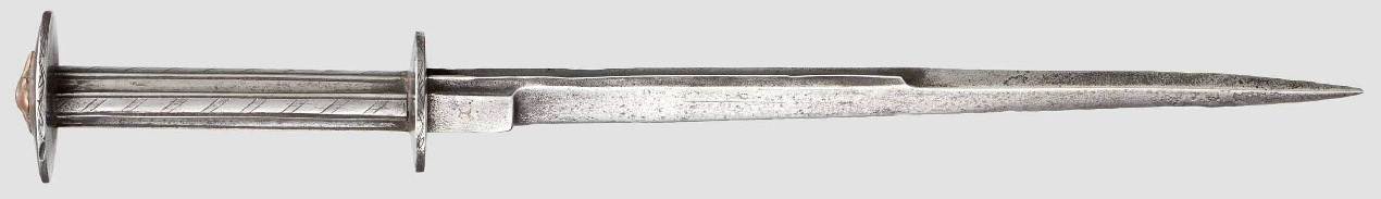

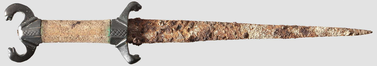

Antenna Dagger c.1400
Unfortunately I have only found an excavated example, but nevertheless interesting.

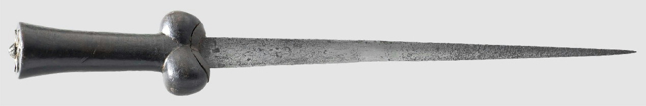

Ballock Dagger c.1500

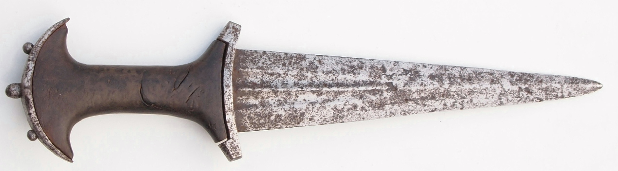

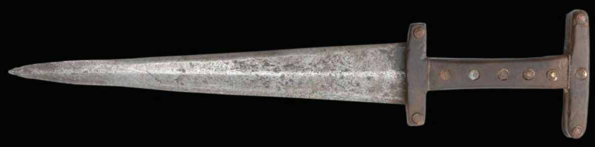

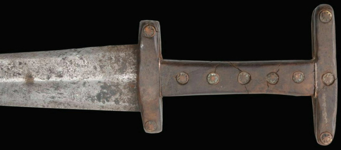

Baselard , North Italy or South Germany,14th century.
The rivets stamped with Maltese Crosses.

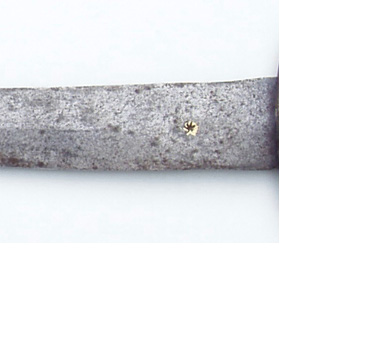

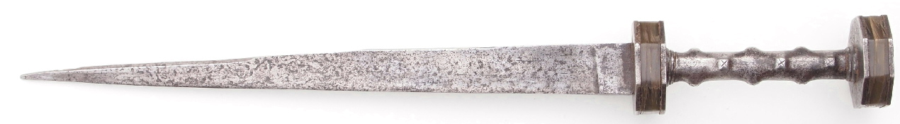

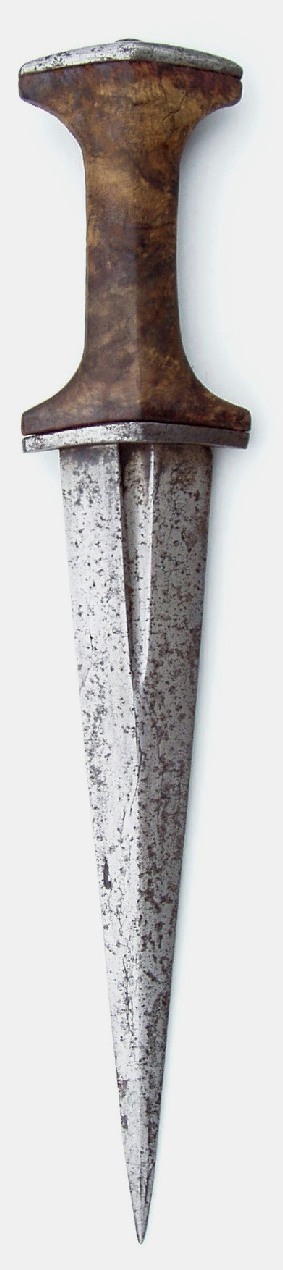

Dagger, South Germany,14th century, wrongly called 'Schweizerdolch'.
Also the two nails, which fix the grip, are most often wrongly called rivets, rivetting is a completely other method of fixing something as with a nail!

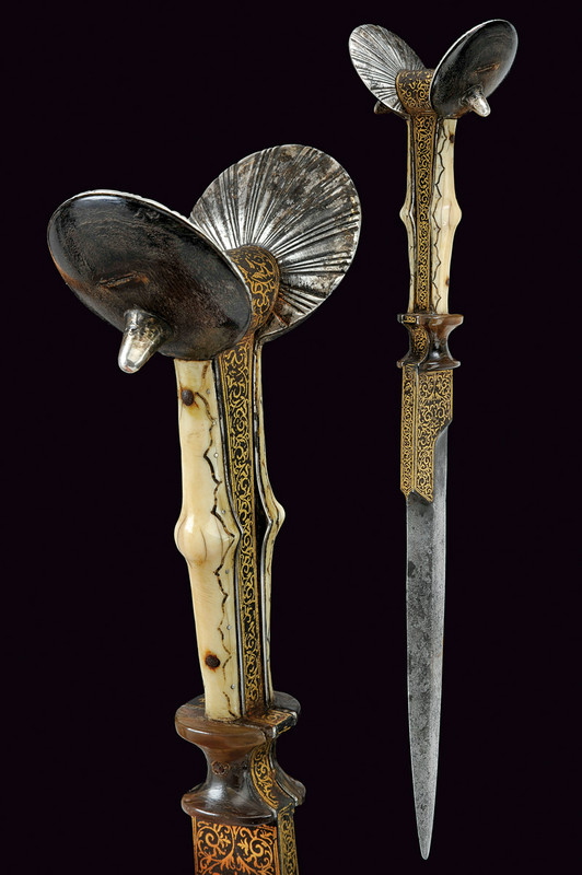

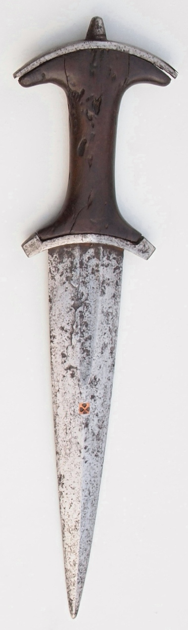

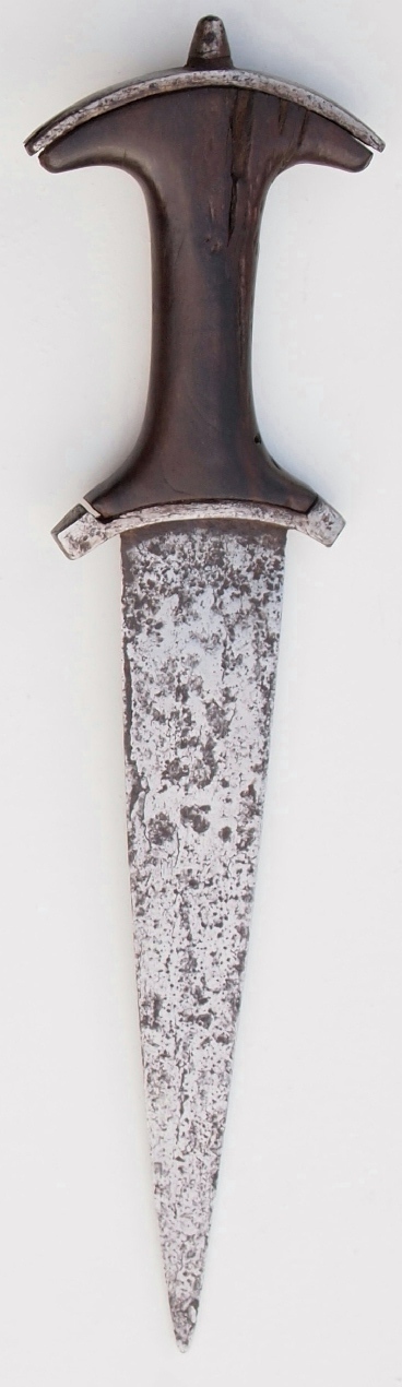

Ear Dagger, Italy, first quarter 16th century
Swordfish is offline   Reply With Quote

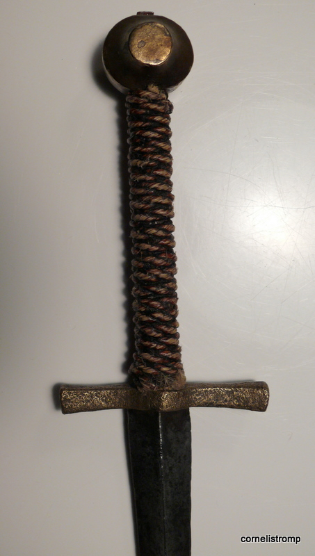

type 1A?

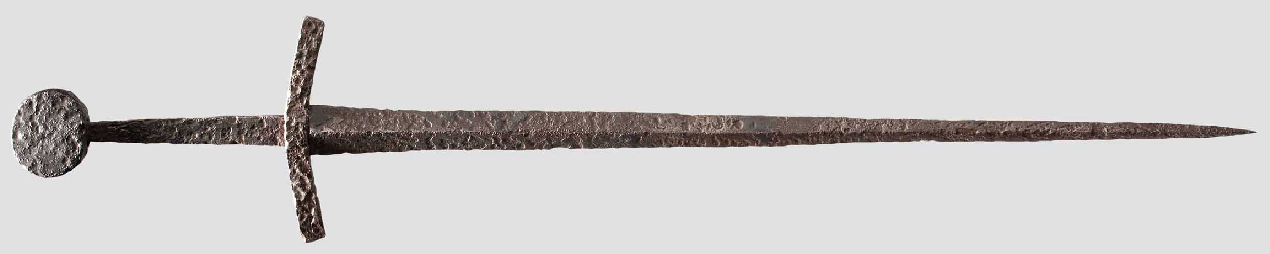

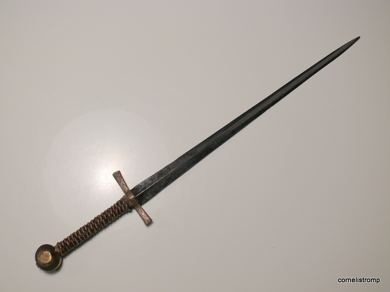

Dagger in the shape of a Sword, first half 15th century, from the castillon find.

yes nice one I handled it during the last London Park Lane A&Af 2012, I believe the dagger, or with 63cm length perhaps a short sword? no it is not, has gone from German to English property.
Sir Guy Francis laking first mentioned the term Guillon dagger in a record of european armour and arms through seven centuries.

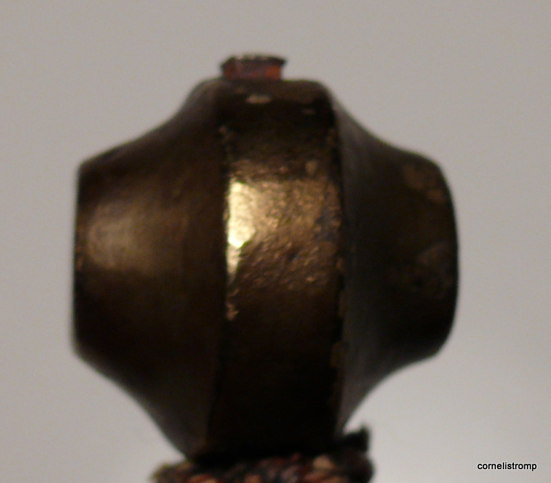

Old 21st April 2012, 08:33 PM   #11
Swordfish
Join Date: Oct 2010
Posts: 129
Sorry, you are right, surely a short sword an no dagger. What is the blade length of yours in the previous post?
Best

I need to find where I've stored it away, however, despite being dredged up from a Dutch river complete as the picture (of course w/o the roping), I suspect that the blade is later than pommel and guard.
Nevertheless, daggers with wheelpommels and crossguards are very rare.
oh Michael it is somewhere in my house.
best,

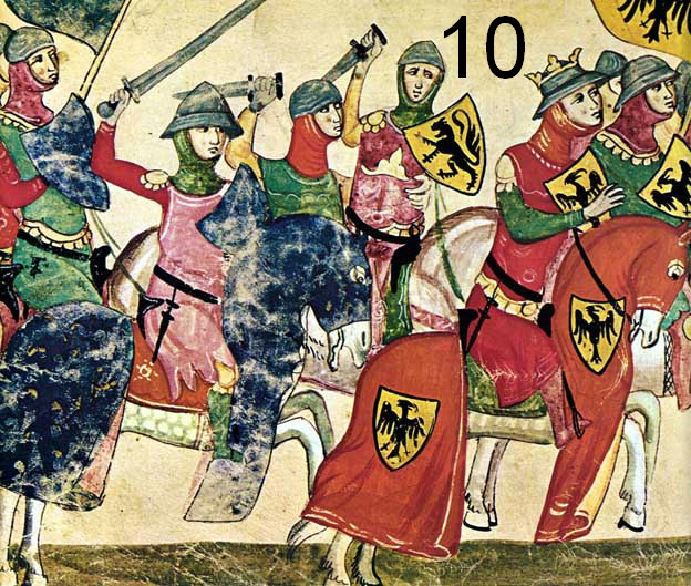

Iconographic sources paintings

10 Vatican Library 1348 Baselard

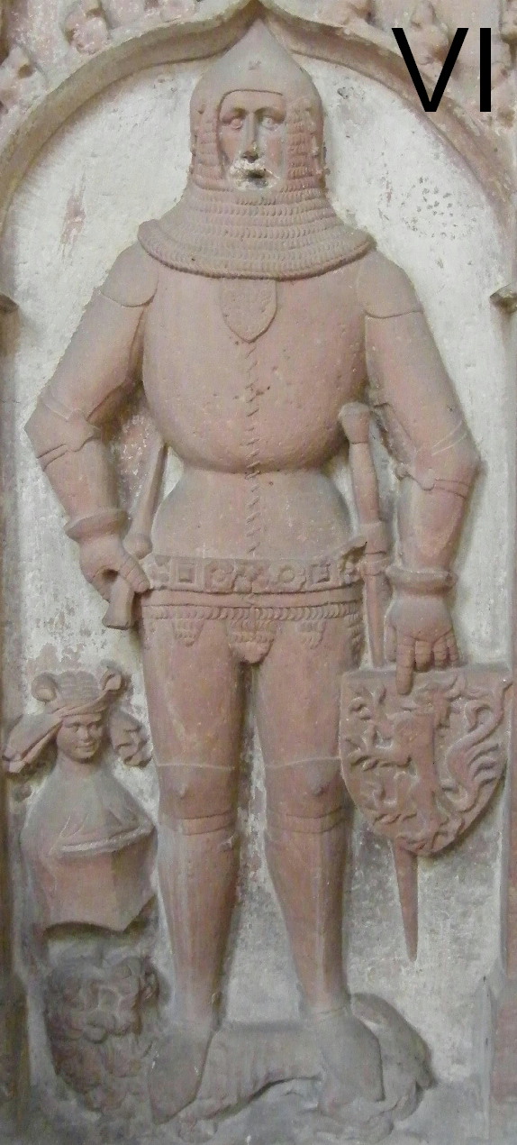

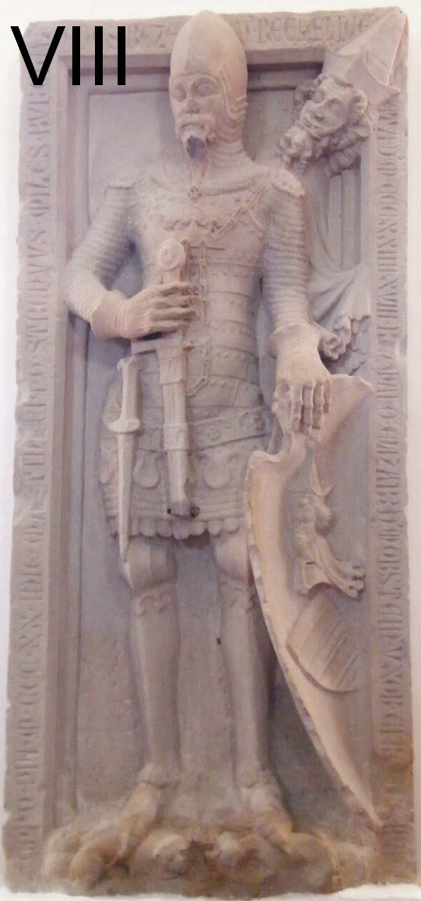

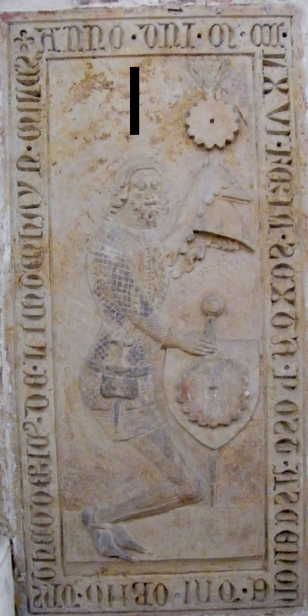

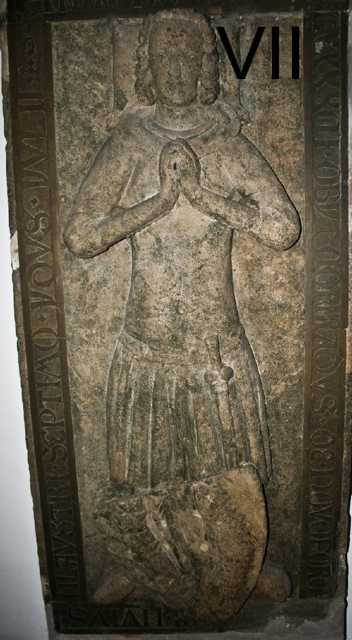

Iconographic sources effigies.
I Theoderich v. Lichtenhain+1368 Type 1g
II Albrecht v. Hohenlohe +1338 Type 1g
III Heinr. Beyer v. Boppard +1355 Type 1g
IV Heinr. v. Seinsheim +1345 Type 1g
V Herzog v. Sachsen c. 1340 Baselard
VI Konrad Kolbe v. Boppard +1393 Ballock Dagger
VII Konrad v. Neumarkt +1296 Ballock Dagger
VIII Rezzo v. Bächlingen +1360 Type 1g
IX Weikard Frosch +1375 Rondel Dagger?
What is the location for this dagger, if known? Any additional info? Thanks.
Old 23rd April 2012, 09:12 PM   #24
Swordfish
Join Date: Oct 2010
Posts: 129
It was sold at auction in Italy last year, its present whereabouts is unknown to me.

Old 29th May 2012, 04:24 PM   #26
cornelistromp
cornelistromp's Avatar
Join Date: Mar 2009
Posts: 1,071
Both of type 1f with short and strong blades, very broad at the hilt, strongly tapering to the tips and with short fullers in their upper thirds.
The first has a guard without elevated and reinforced tips, the pommel cap and the guard are only slightly arched towards the blade. The blade is of flattened diamond section. The grip is made of bright burl-wood. This dagger is a very early one, dating to the second half of the 13th century or early 14th century.
The second dagger has a roof-shaped blade, the front side with a midrib and a copper inlaid mark. The back side is quite flat. The pommel-cap and the guard are strongly curved towards the blade. The guard has elevated and reinforced tips of the usual form. The tang is riveted over the pommel-cap with a tall tang button. It dates to the 14th century.
Best
Beautiful swiss-daggers, thanks
the four-leaf clover beaten in a square of latten in Dagger 2, is very unusual for a blade mark! Do you think it is a later addition ?
Jasper
Old 29th May 2012, 09:47 PM   #27
Swordfish
Join Date: Oct 2010
Posts: 129
The shape of the mark is similar to the mark on No. 382 on the scan from Hugo Schneider's book, but rotated 45 degrees. It is brobably inlaid in copper to highlighten it,this is rarely seen but not unusual. I know other medieval items, also South German or Swiss with marks inlaid in latten. One such item I will show later in a chapter about short swords.
It is clearly a cutler's mark and I have no indication that it was added later.
Please note that the book scans are from the chapter 'Dolche und Dolchmesser des Hochmittelalters', not from the chapter 'Schweizerdolche':
Best

Old 30th May 2012, 09:44 PM   #28
cornelistromp
Join Date: Mar 2009
Posts: 1,071
Best
are those marks also struck in softer metal , latten/ copper similar to dagger no2 ?
or struck in the iron (blade) similar to no 382 and the mark is afterwards filled with latten/copper?
best,

Sorry, I have used a wrong description.
The marks I know are not inlaid in copper or latten, but struck in the copper/latten, which was before inlaid in the metal of the blade according to dagger No.2
Attached an other mark struck in latten on a Swiss short sword late 15th century.
