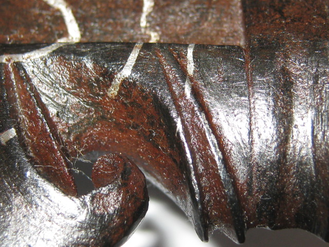

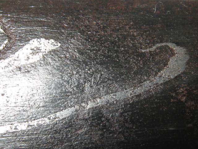

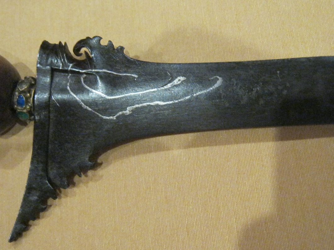

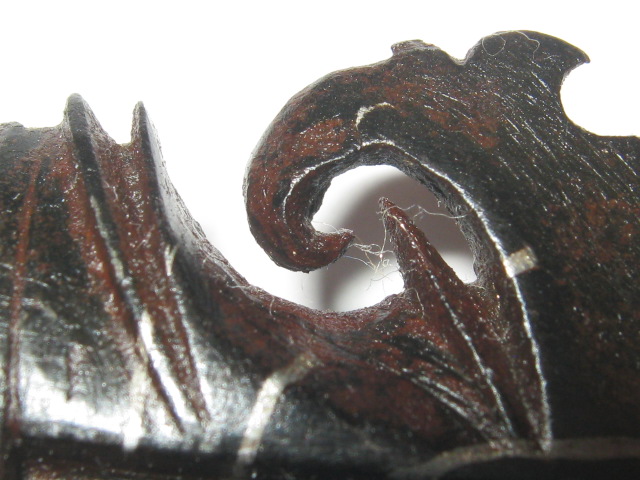

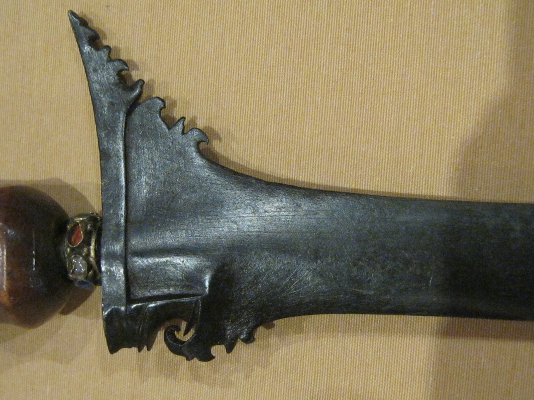

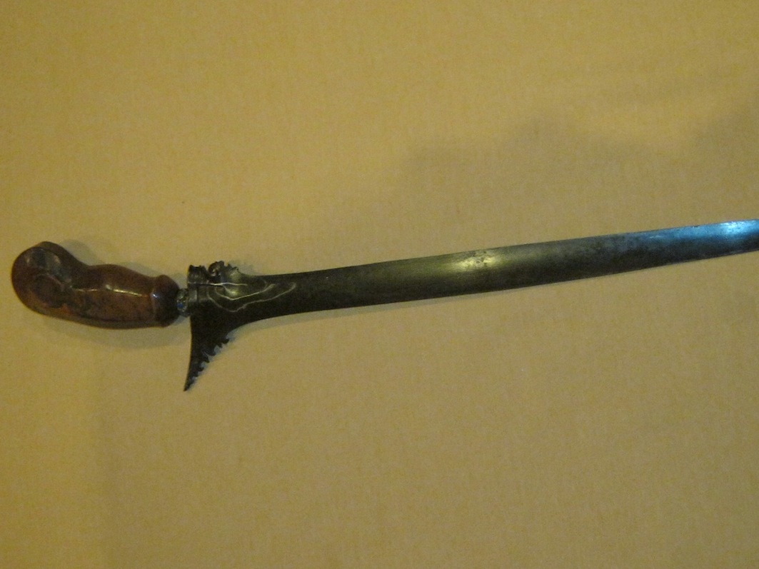

Dear members ,
This keris from Bali with a very smooth and black shining blade has a strange pamor on one side only .
Is that a mistake from the maker , is that a " fantasy " , or is that something we could classified ....
Thank you for your thoughts
Henri

Hello Henri,
Such a unsymmetrical pamor is called pamor tangkis, see examples on Google.

Hello Henri,
best and shortest explanation you will find here: "Tangkis- a means of warding off, or a shield; a blade is said to have pamor tangkis when
it carries a different pamor motif on each of its blade faces, and this is considered to be a talisman against black magic."
It is a citation from a site of a member here but by some reason don't want to provide the link.
BTW, nice blade!
This has always been my understanding of the definition of "tangkis". It is not the name of a specific pamor pattern per se, but when there is a different pamor on each side of the blade. I am not sure that this Henri's blade qualifies for the category since there seems to be no pamor on one side.
I could be wrong, but his appears to be an accidental pamor. Such pamors are usually considered special due to their accidental nature i believe.

If this was a Javanese blade, I would compare the motif with known ones described by Tammens or Van Veenendaal for instance but this is probably not applicable for a Balinese blade.
This blade is well made and I doubt that the maker would have left an unwanted motif but I don't know whether it is a planned or unplanned one. The pamor motif looks to be superficial so it may have been made more recently than the blade itself.

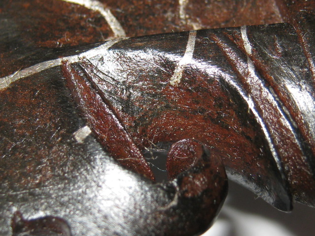

"The pamor motif looks to be superficial so it may have been made more recently than the blade itself."
It's funny that you say that - my eye is untrained and my knowledge fits on the head of a pin - but, when I first studied the pamor, that exact thought entered my mind. It just seem "off" to me.

Yes, Jean, I agree: The pamor looks very superficial -- almost like painted on ...
Frankly, i have seen at least as couple of Bali keris that people have painted "pamor" patterns onto that were that were actually half way decent keris, not the tourist crap where you'd expect that, probably because that thought they could sell it for more that way. So there is precedent for that. I also thought that the pattern here looked a bit superficial at first, but the photos alone just don't give me enough information to form a strong opinion either way.
And Jean, my use of "accidental" was to mean "unplanned", not "unwanted".

David, I agree with you, although the picture is clear it is not possible to determine if the pamor motif is genuine or fake (applied or etched with acid) but if the case, it is more smartly made than usually. It also seems odd to do it on one side of the blade only but who knows?

Thank you guys for your comments .
From " fake " to " painted " or etch applied " .... when I take this keris on hand and look at this pamor very very closely I can assure the pamor is real but yes the nickel is not dep into the blade ( photos below ) . This keris was part of a lot of 10 I bought sometimes ago to a collector in the UK who passed away and pretty sure he has not bought this one in a tourist shop during a visit in Bali ! But .... never never know !
Henri

Thank you Jean . After consulting some documentations I agree we could called this one "tangkis" . I have got in the past a similar pamor on a Bali keris but both sides of the blade . I am still surprised by the very thin layer of nickel for this pamor . Not painted ! Not an easy job for the swordsmith to shape and keep the pamor ...

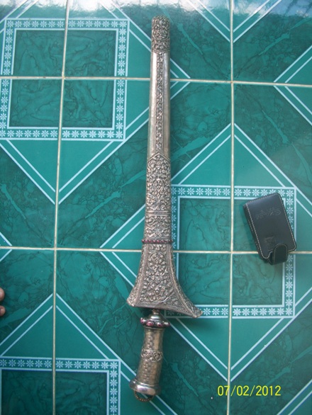

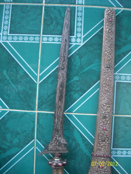

dear forum ,

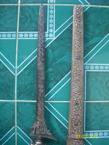

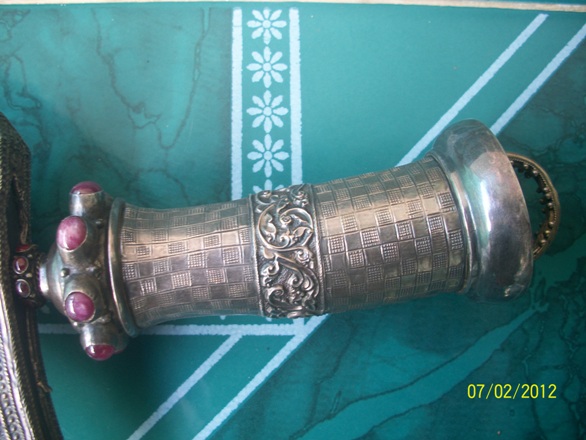

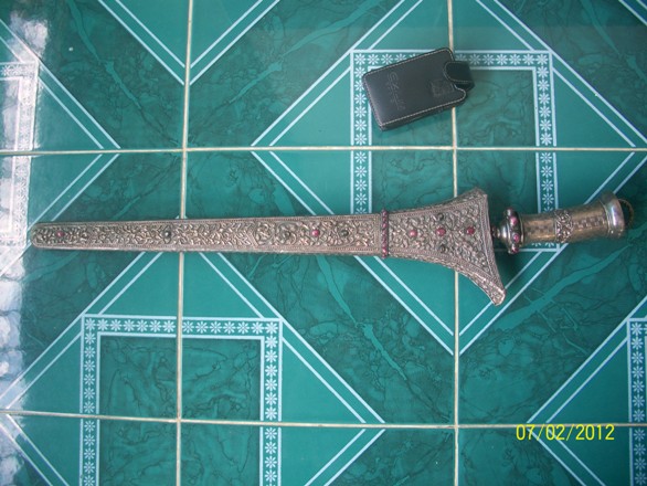

firstly i would like to thanks to the admin and all member for warm welcome to me.
as a newbie i want to share some pic's of my keris (it's been sold ) , pamor tangkis ;related with the topics.
thank you.
Ganja Iras
