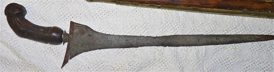

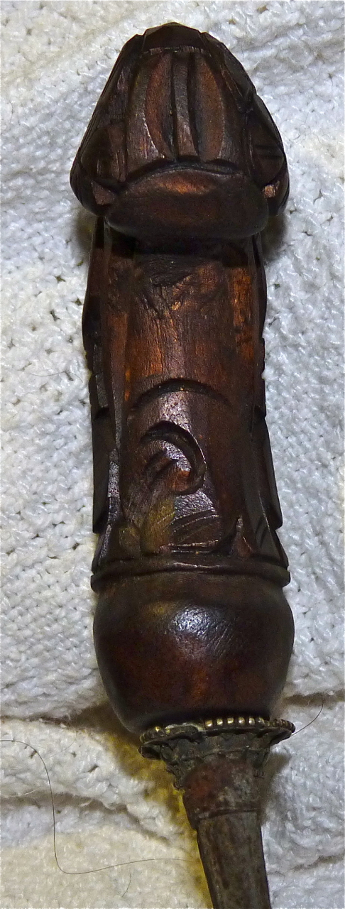

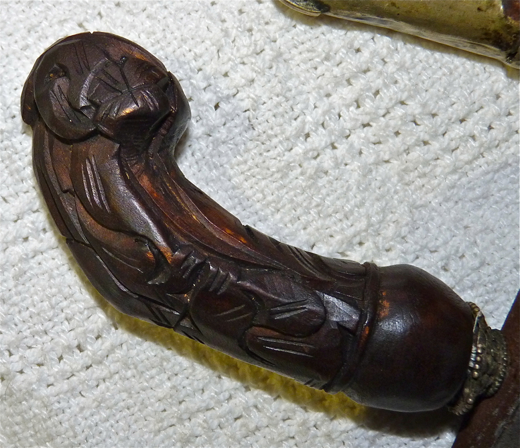

Hello again. I am posting them one by one for comment. This one I know little about other than it may be fairly old due to the wear from many ritual cleaning. I like the hilt, is it just normal Javanese?
Thanks!

Hello Dan,
The hilt style is Madurese but the carving is very rough for Madura standards - possibly village work and a genuine combo.

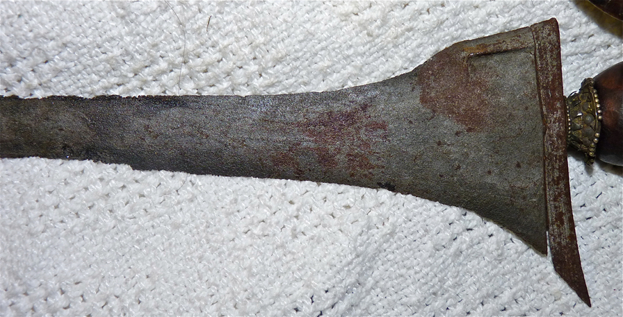

I believe the blade needs staining before we can give detailed comments.

Hi,
Agree with Kai, the hilt is just a poor quality and probably recent Madurese piece IMO, you can notice the rough carving.

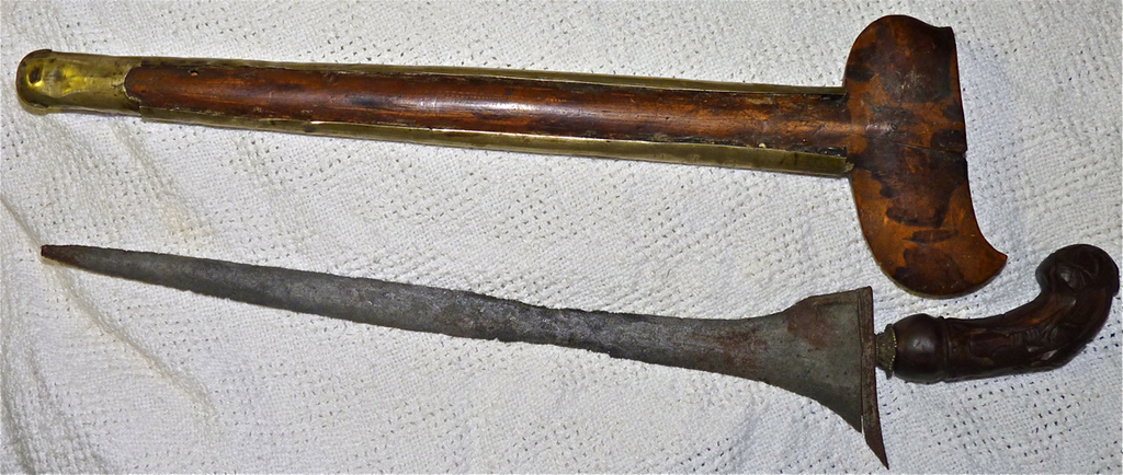

This is a keris from Madura. The whole piece has some age. The ukiran is a recent replacement. Replace the replacement for a good maduran ukiran, stain the blade and give the sheath and the mendak a polish and you have a fine madurese keris.

I have some concerns about staining the blade as it very thin in spots.

Sorry, I doubt that this blade will show after staining a good visible pamor since the blade have had to much corrosion.
like the others I have to say that the hilt is a cheaply worked recent one, not worth to keep.
There are a lot of much better Madura keris offered everywhere so I think that the complete ensemble is not a "keeper".
Sorry Dan, but I think that a open word regarding this keris is much more helpful for you.

Sorry, it is a "keeper" to me. I happen to like this keris for several reasons. This is a keris with it's own history and character that I can appreciate. Perhaps I am a home to unwanted kerises? If so, I am proud of that.

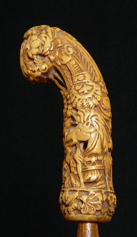

Hi Dan,
I can fully understand that you like the blade & sheath of your kris in their original condition because of their age and history, but no way for the hilt!
I attach a picture of a Madurese hilt which your piece is suppose to copy and expect that you can notice the difference in craftsmanship.

This keris was rehilted since the blade and sheath are old but the hilt is much more recent and really unskilled worked.
A second point: The keris itself coming from a high culture and need care. Repairing the broken wrongko, polishing the wood and the pendok and changing the hilt would be the minimum what i would do with this keris when I like it. I have collected several keris in Indonesia and ebay as well which has been in a pitiful state. The most of my keris are not worked from high skilled empus or pande but I have tried to bring them in a status which is worth to keep them for coming generations.

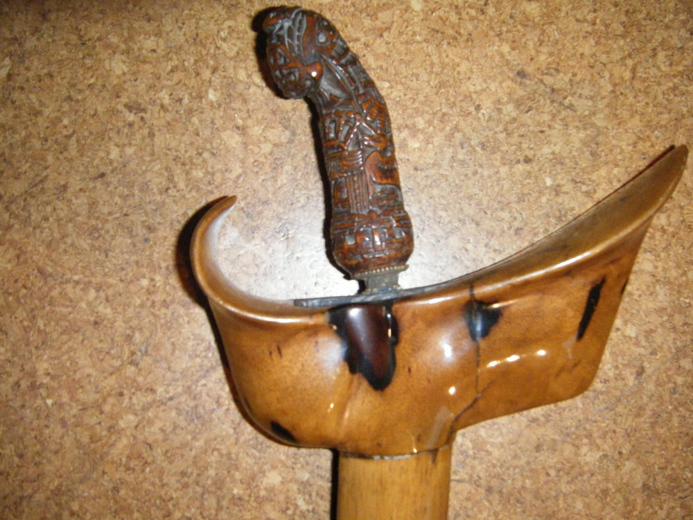

Look for example to this keris. I have bought it years ago for very low money in Indonesia. It was in a very similar state as your keris. The blade have had corrosion, the sheath was in a real poor condition and the hilt was a similar one you have at your keris. The blade was cleaned and have get a new stain, the sheath (the break repair was before) have get some care (the worm holes in the back was filled with wood filler and it has get a polish with some coats of shellack), the mendak and hilt was replaced by better ones. Now, also when it is not a keris of high level, it is one which have a cultural worth (IMHO).
When I have written before that your keris isn't a "keeper" it was based upon the fact that I have the opinion that you and nobody else will be able to bring the blade alive. And the blade is the heart of every keris.

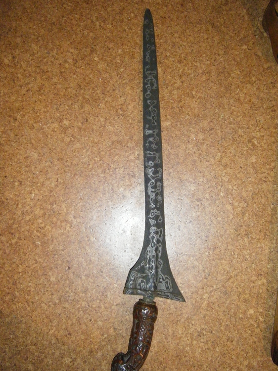

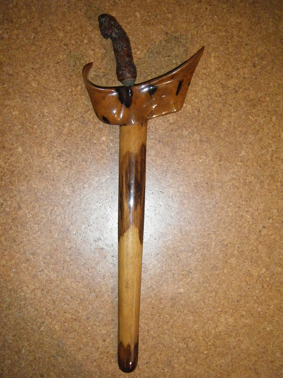

Here is the story. Early on, I bought this keris, and one other, that are in terrible shape - I paid practically nothing for them and they were local so there was no exorbitant shipping costs from Indonesia.
At this point, with my limited funds, I'd probably rather use the money to buy better examples of kerises, with knowledge I am gaining and guidance from folks who know what they are doing.
I can appreciate that the posters here are trying to protect the newbie and I welcome that.

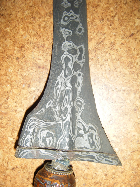

Thanks Heinz. To let you know, these picture are older and since I took them I cleaned the blade a bit with lime juice and then oiled it quite liberally.

Hi Dan, fine that you cleaned your blade from that rust; this was my most concern about your keris. Regarding the hilt, if you really like it just keep it, because you are the only one who needs to like it -- nobody else!

Staining this keris if done properly won't harm the blade. This keris would be certainly for me a keeper. I would clean it to bring back its well deserved glory.
Jean,
Yes, I can see a HUGE difference! I was looking on-line. I see the Madurese hilts as very ornate. Is this the trait of the hilts from this locale?

This is only one form of Madurese hilts, there are a lot of others. But Madura hilts are normally masterpieces of carving.

Cleaning of a blade can be done with a fresh lemon or lime. It takes some time. With a rusty blade i brush the blade with the fresh lemon or lime. Put the piece of lemon on the rusty spot and pack the whole thing in plastic and let it rest for some time. The unpack it and scrub again with the lemon until the rust is gone. Staining is done with warangan like Detlef said. Search for it on this forum.

Personally i use pineapple juice because it is less aggressive than lemon or lime acid. With this blade, less aggressive might be a good idea.
