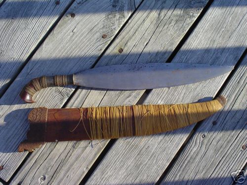

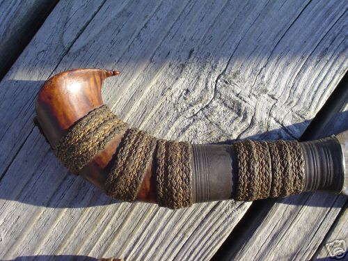

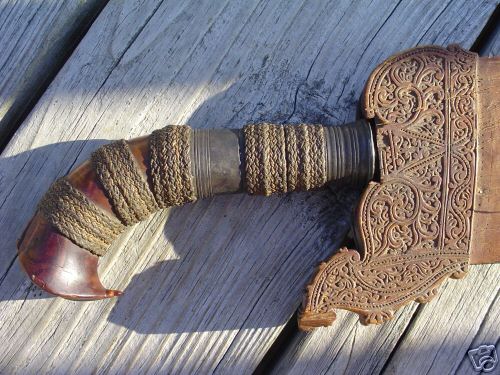

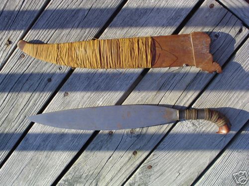

Just picked this up off of ebay. I'm not to fond of the screw but other than that it looks pretty good to me. It was described as "THE BLADE MEASURES 15 AND 1/2 INCHES LONG WITH THE HANDLE MEASURING ABOUT ANOTHER 5 AND 1/2 INCHES FOR AN OVERALL LENGTH OF 21 INCHES. THE WIDTH OF THE BLADE IS 2 AND 1/2 INCHES. THE TOP EDGE THICKNESS VARIES FROM THE THICKEST 1/4" AT TO 3/32" AT THE THINNEST NEAR THE POINT". All comments are very welcome.

i believe zamboanga referred to this as pungkul barung, prolly of samal origin. looks like a no nonsense, in your face type carried by a commoner. is the toe on the scabbard broken, or is it rounded off like that? regardless, it's a beautiful piece; and congrats btw...

Thank you for your reply. The toe of the scabbard was described to me as being rounded with carving and unbroken. I will post a picture on it when the sword arrives. At the moment I am not able to etch the blade myself. Is there someone that you could recommend to do the job when it gets here? Thanks again.
